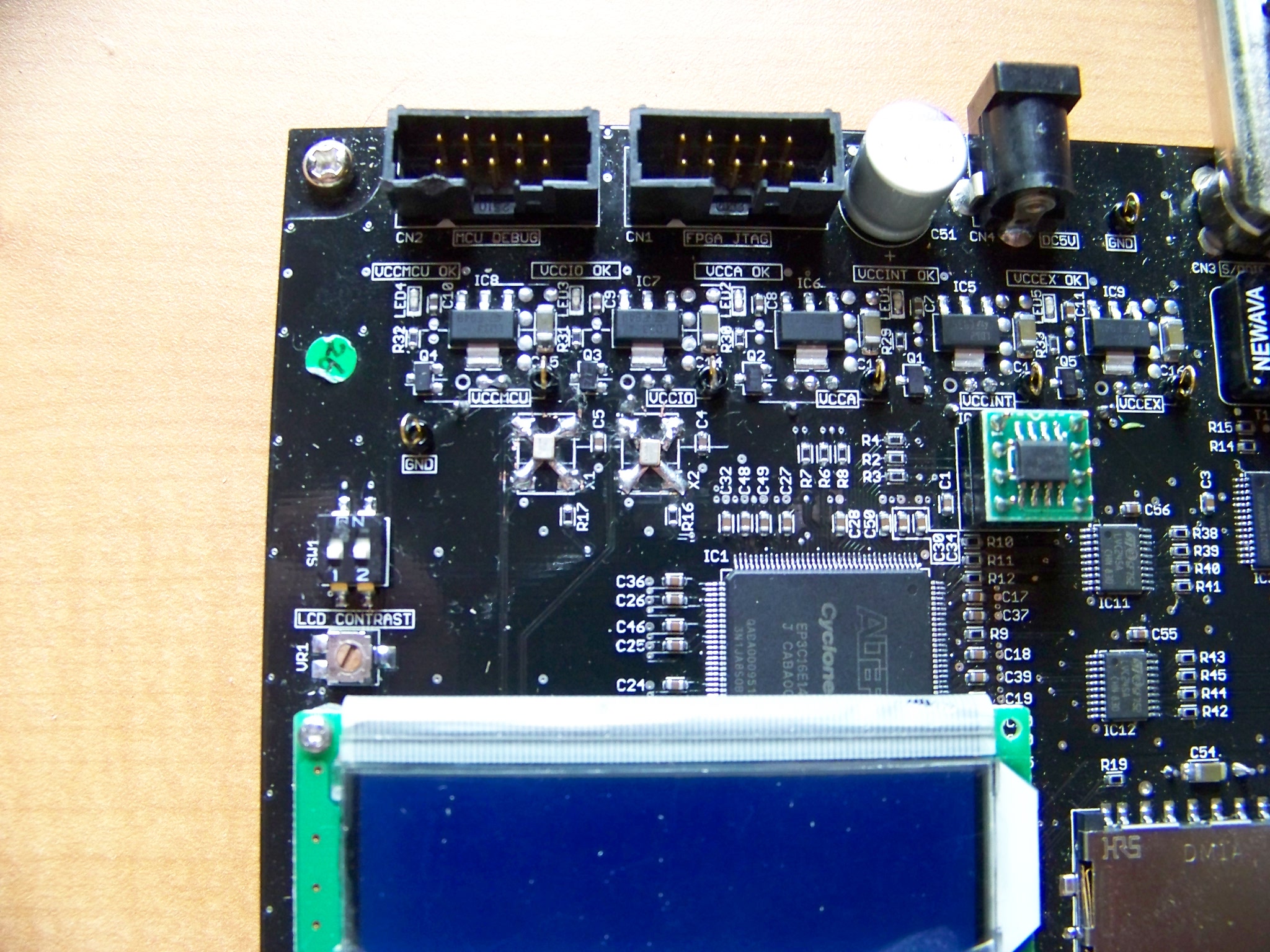

Today, I listened to a power supply updated version of Rev. 2.1 by RayCTech. The SDTrans192 has NDK oscillators already. DAC connected are Twisted Pear Audio Buffalo II with IVY III and Wolfson 8741 Evaluation Board.
The effect of JFET voltage regulators with audio grade caps designed and implemented by RayCTech is excellent. The best sounds I have ever heard though my experiences are limited. Very pure and clear.

How many regulators did you use for the SDTrans192, and what were they supplying? How did you power supply the Buffalo2 and IVY3?
SDTrans192 have five typical 3-terminal regulators;
VccMCU: +3.3 V for MCU
VccEx: +3.3 V for DIT
VccInt: +1.2 V for FPGA
VccIO: +3.3 V for multiple devices
VccA: +2.5 V for FPGA
In my case, I use Kenwood PW18-1.8Q (versatile power supply for laboratory use) for Buffalo II and IVY III.

I think your understandings are fairly correct. However, as I am not an expert, I will forward your questions to Chiaki. Chiaki once told me that he only used specifications in public. Therefore, current performance is limited.
Dear Bunpei:
thank you for letting me know. Five discrete JFET regulators to feed the SDTrans192 is quite a number. I wonder if there is one of these five that is most important. It would surprise me if all five are needed. But it is of course a lot of work to find out which one is the most important (if that is the case).
Laboratory PS are usually not the most good-sounding power supplies. A few JFET regulators might do some real good for the sonics of both the IVY3 and the Buffallo II.

The clock reg did a small but clear difference.
The remaining regs made a clear difference,
but the 3.3 volt for the MCU made a major difference...
This may be correct or wrong as I replaced them one by one and only in one order. To know exactly I would have needed to swap regs in a pattern..
As I replaced the clock reg first and the MCU reg last the result could have been the other way if I had changed the clock reg last..
As for Buffalo or more correct the ES9018 chip...
JFET regs improves the performance on all voltages..
I have played with JFET regs on the ES9018 since released and had never heard a Buffalo DAC until two weeks ago when I borrowed a Buffalo II DAC to possibly make a JFET regulator upgrade.
I was extremely unhappy with the sound quality when connected and have now run it on continuous burn in since and it have improved a little...
I have made a JFET regulator board for the Buffalo II that I will connect in a couple of days as I had to order the connecting pins for the headers as I want to be able to compare the difference easy.
Please observe that I have not said anything negative about the Buffalo II,
only described the disappointment when I was used to the JFET regs and then downgraded to the standard regs and possibly a not completely broken in unit..
A identical disappointment was observed when I replaced a SDTrans with JFET regs with a SDTrans with standard regs..
