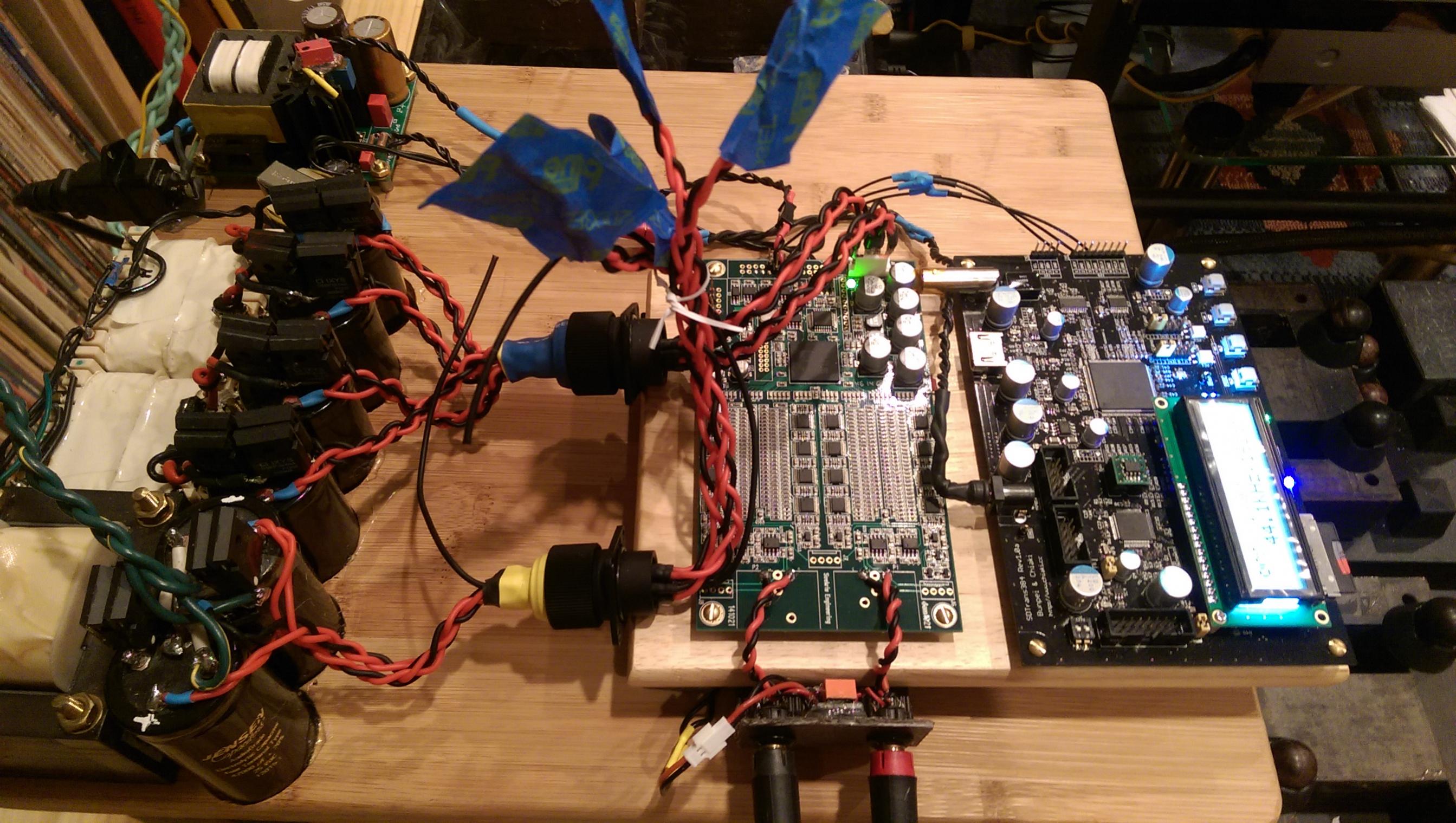

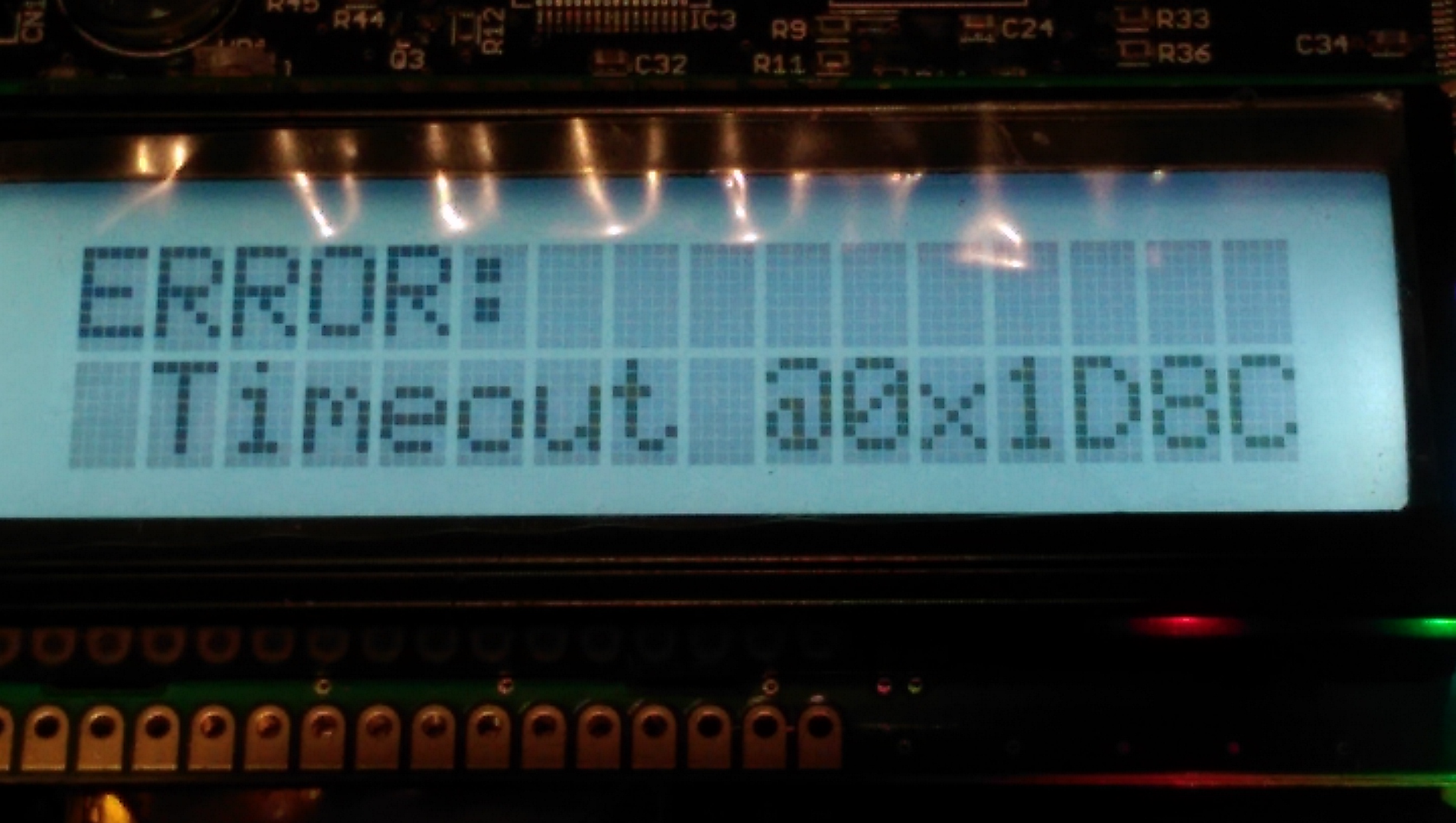

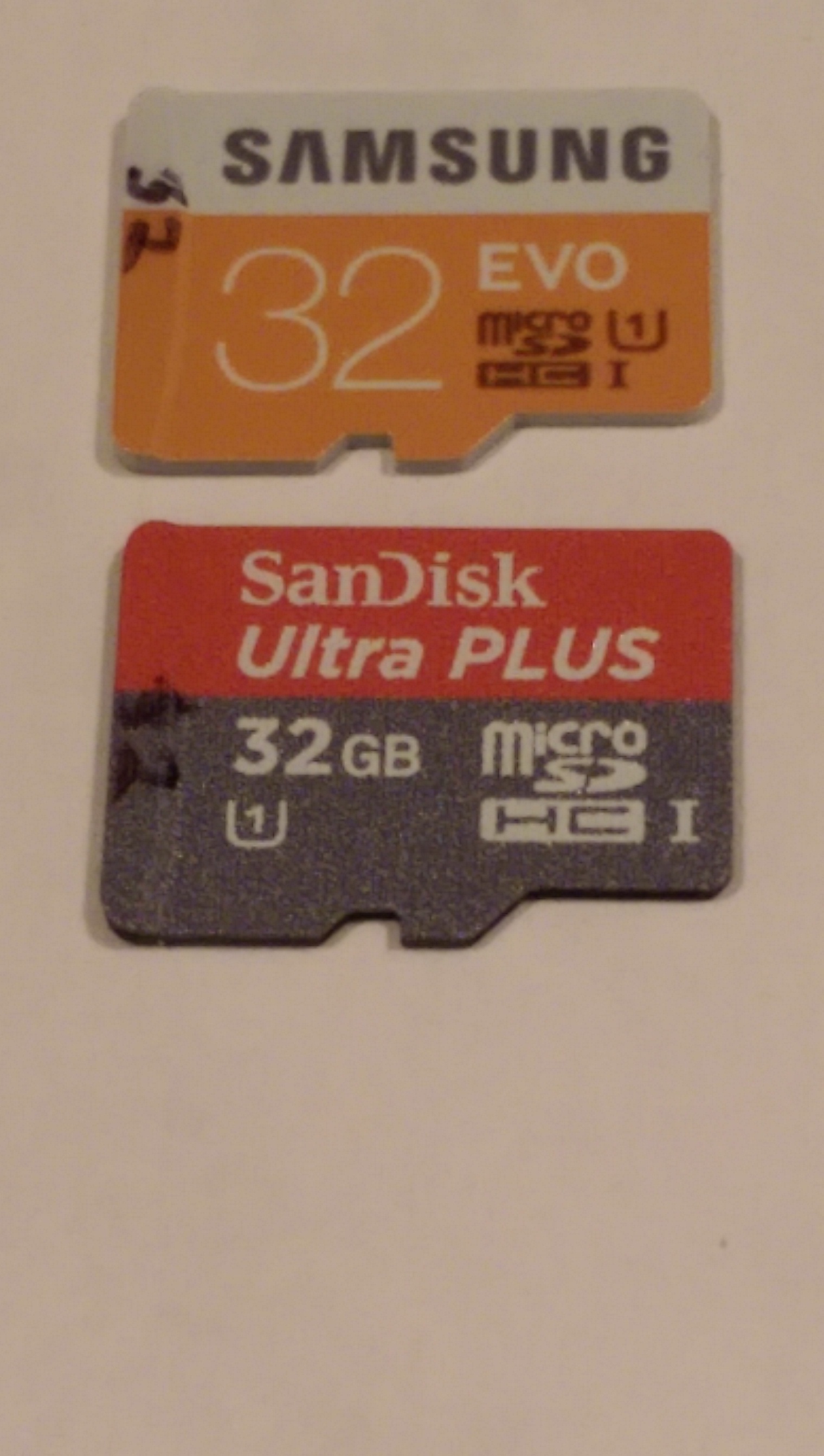

Second, I have a question regarding my SDTran384. I have been enjoying exploring very high-quality digital playback with this device connected to a Soekris DAM DAC. But I received an error last night trying to play back music I had transferred onto SAMSUNG Micro SD Cards. I tried several cards of this brand and model. They are all recognized ok, but I receive a Time Out error when I press play. The Sandisk card shown in the picture works ok and has been setup in the same manner using the same hardware.
I plan to reformat one of the cards and re-copy some music onto it using a different card writer. Anything else I should try?
Many thanks for any suggestions!
Greg Stewart

A quick update... I tried re-formatting the Samsung card and copying some music back onto it. No dice, it still does not work.
I got several of this brand/type card to use in the SDTran, I'm hopeful there is a solution.
THANKS!
Greg in Mississippi
Hi Greg,
My experience with mine was that indeed some grade of cards did not go well with the SDTRANS and indeed sound changed between some of those that did.
I ran extensive tests and find that medium speed cards are best, i tend to stick to those that give best results.
The fact that we always tend to use the "best" high speed cards is not relevant here.
I use various samsungs and the work flawlessly but have lower read speed than yours.
I found that LEXAR were among the best so i stick to that as much as possible.
hope this helps you somewhat.
