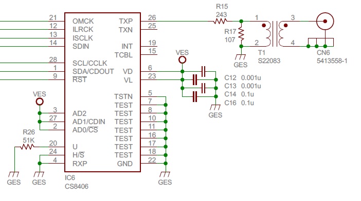

What is the technical side of SPDIF transmitting?
In cd-player modding to transport you can remove all the "unnecessary" stuff from SPDIF output line like separation transformers, series capacitors etc. to make the SPDIF trace "cleaner" and more square.
Have you looked at the trace how does it look like in scope?

Hi, na!
I have no idea on the "speed" of S/PDIF signal. Please let me know a definition and any measurement methods for that characteristic.
Unfortunately, I have no scope traces of S/PDIF output of SDTrans384 because I have no DAC of S/PDIF input.
Please speculate possible points to be improved by looking at the S/PDIF output circuit of SDTrans as attached to this post. The pulse transformer is made by Newava Technology Inc.

Well first i have to say that i am hobbyist, not an expert!
To my eyes it looks "pure" output design. Is the R15 there to drop the SPDIF to 0,5V?
Newava shoud do the job, and i have seen some waveforms comparisons of different pulse transformers and 22083 didn't look half bad in that shootout. I guess it galvanically isolates also?
I wonder how much effect there is if trying different R15? Is it surface mounted?
I guess the SPDIF should sound great if the power supply is up to it.

... Is the R15 there to drop the SPDIF to 0,5V? ...
Its circuit design is based on a reference design shown on CS8406 datasheet. The value of R15 is selected to maintain a proper output voltage level for +3.3V power.
... I guess it galvanically isolates also? ...
I wonder how much effect there is if trying different R15? Is it surface mounted? ...
Yes, the pulse transformer isolates SDTrans and your DAC. The R15 is SMD. You can replace it with a resister of your favorite brand.
An output section of SDTrans has an independent optional power supply terminal. You can apply your own power supply to CS8406.
