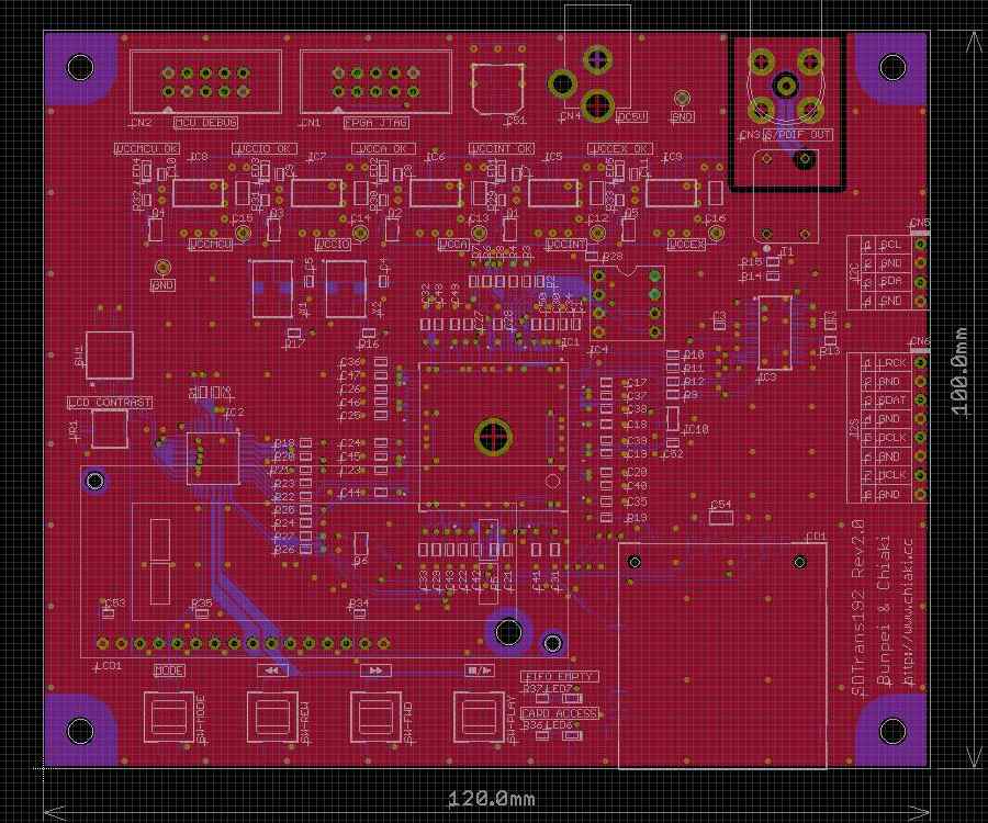

We are very sorry that we have provided no news for a long while on this thread.
We'd like to announce Chiaki's PCB version of SDHC Memory Card Transport, "SDTrans192".
<http://www.chiaki.cc/Transport/images/sdtrans192r20-pcb1.jpg>
He designed the PCB by himself and outsourced PCB production. Surprisingly enough, he finished all soldering by hand in spite of the use of numerous surface-mounting parts.
He has just finished two as of now and will expect additional three as a first lot.
He added a LCD that displays a play number and WAV file parameters and
error messages if necessary. A "gapless playback" is not supported.
<http://www.chiaki.cc/Transport/images/sdtrans192r20-ui1.jpg>
As a human interface, 4 buttons and 2 LED are employed.
This transport has both I2S and S/PDIF (BNC, 75 ohm) interfaces.
<http://www.chiaki.cc/Transport/images/sdtrans192r20-i2ci2s1.jpg>
<http://www.chiaki.cc/Transport/images/sdtrans192r20-spdif1.jpg>
Main devices are MPU, SiLabs C8051F361 (25.4 MHz, 100 MIPS) [left in the following picture] and FPGA, Altera CycloneIII
<http://www.chiaki.cc/Transport/images/sdtrans192r20-mcu1.jpg>
Chiaki selected such high-precision components as two TCXOs and five voltage regulators.
<http://www.chiaki.cc/Transport/images/sdtrans192r20-pwr1.jpg>
If you want to try this "SDTrans192", its price is 350 USD and additional delivery charge. Only payment via PAYPAL will be accepted.
If you do not satisfied with its quality of the transport in an initial one-month trial period, we will provide a refund after your return.
For requesting details in this distribution plan, please contact to Bunpei by e-mail.
bunpei<at>ta2<dot>so-net<dot>ne<dot>jp

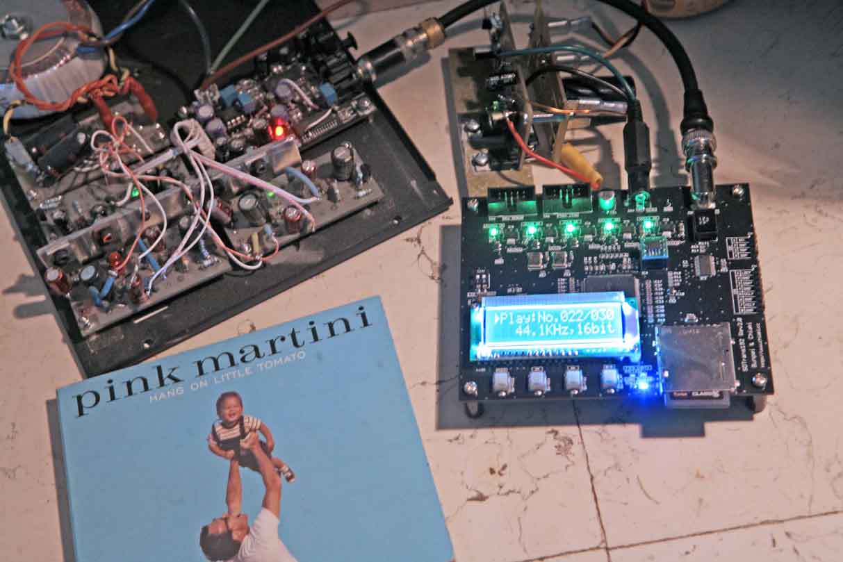

at last I have this transport in my system running. First impression is very positive but I need more burn in and time for criitical listening .
Here is a picture with the transport connected to a naked dac
