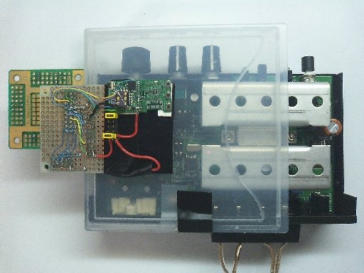

Bunpei said:
Chiaki and I are making a concept for the next step. My requirement is 24bit 192KHz I2S output.
Chiaki has almost completed making his new prototype board (in the left side of the following picture) for playing 24bit 192kHz WAV files. Though Bunpei has not listened to its output sounds yet, he expects a good result.
The new board has quite a different architecutre.
A. SD memory card slot is adapted instead of MicroSD memory card
B. SDHC memory card can be used
C. FAT32 readable ( in progress )
D. RIFF WAV files of 8/16/24/32 bit, mono/stereo, 32/44.1/48/88.2
96/176.4/192kHz are supported (however, no FLAC, MP3, WMA, AAC)
E. Both I2S and S/PDIF (RCA) output.
F. User interface with three button and one LED (no LCD display)
No VS1053b chip is incorporated in this version. For PCM to I2S conversion, FPGA Altera Cyclone III(EP3C25E144)[The biggest chip in the picture above] is employed.
A microcontroller is Silicon Laboratories C8051F361 (100MIPS 8051 architecture machine of 100MHz clock). It reads WAV PCM data from SDHC memory card.
For S/PDIF output, Cirrus Logic CS8406 is used with a pluse transformer, Newava Technologies S22083.
As soon as Bunpei confirms its sound, a new report will be posted here.
Bunpei
In terms of high-precision clocking, Chiaki implemented the following mechanisms in the design.
1. Two separate TCXOs, 22.5792MHz for 44.1kHz x n and 24.576MHz for 48kHz x n, are employed.
2. Two master clocks (MCLK for I2S) are from the TCXOs.
3. I2S relevant clocks, LRCLK and BCLK, are derived from the master clock by simple scalers formed in the FPGA.
4. PCM to I2S conversion is achieved in a dual clocked FIFO in the FPGA. I2S output side runs exactly synchronizing to the master clocks described above. It's independent to PCM input side clocking.
5. I2S signals are synchronized again at the last stage in the FPGA.
As a result, the intervals of I2S siginals are to be very independent to activities of the microcontroller side.
However, we have measured neither phase shift noise nor Allan Variance of I2S signals yet. Therefore, we have no objective evidence for a "low jitter" profile of this equipment so far.
Bunpei
Today, Bunpei received the 192kHz 24bit WAV file compatible, SDHC Memory Card Transport from Chiaki.
Chiaki is publishing his achievement on his web page (in Japanese).
http://www.chiaki.cc/Transport/sdtrans192.html
New pictures are available on his web page.
<Connected to WM8741 Evaluation board>
In this picture, S/PDIF is used, instead of I2S.
<Solder surface>
You can see 5 black power regulators and two TCXOs( two light purple rectangular components along the left margin).
Bunpei listened 192kHz 24bit sources obtained from
Hires 2L: http://www.2l.no/hires/index.html
and
Lin Records: http://www.linnrecords.com/catalogue.aspx?format=high&sort=releasedate&order=desc
using Etymotic ER-4S earphones connected to WM8741 Evaluation board employing an I2S interfacing method.
His primary impression is "sounds are more smooth, fine and continuous than that of 48kHz 16bit down-sampled ones" and "less-digital taste".
Strings in orchestra are resolved well enough to enjoy them.
Chiaki is planning to design and release a new PCB board kit with necessary components. Please let us know your opinions.
bunpei<at>ta2<dot>so-net<dot>ne<dot>jp
(The improved version may have a simple LCD display.)
Bunpei thinks this kind of players including ecdesigns' one are much worth trying and listening.
