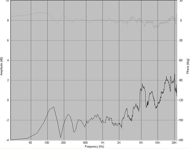

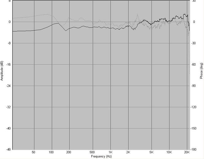

I think I got Speaker Workshop to measure some frequency response. I did not do the calibration. Not sure how it's done, yet. But I have a rough farfield graph of my speakers in room response. I will post it under my other thread about the boominess of my speakers. Or I guess it makes sense to post it here. There is a peak at 115-140 Hz then a smaller one at 250 Hz. These peaks are not present in nearfield measurements of the woofer.

What's the faint curve and what's the bold one?
Is one nearfield and one farfield?
If not, can you give us the nearfield curve for the woofer?
The faint one is suppose to be phase.

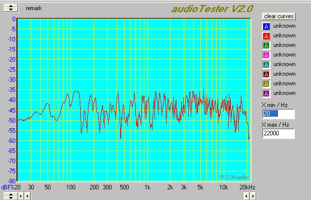

I think my mic does not work for Speaker Workshop or I don't know what I'm doing in Speaker Workshop. I forgot to check the FR graphs when there's no sound and they're the same as when there is sound. So I figure the mic does nothing.
I will try Audiotester tomorrow, see if I have better luck.
Be sure that you have the reference (acoustics tab of preferences) set to "none", or you will be comparing your soundcard's noise spectrum to itself. I found this hint buried somewhere.

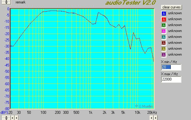

I still can't get Speaker Workshop to work correctly. But I know my mic works now in the mic input and the line-in input. The correct input was not selected in control panel. Turns out Audiotester 2.0.9 makes these changes in the mixer and control panel for you. Although I could not figure out how to smooth my graphs or the feature is not available. Here's a farfield graph of sweep FR at 400 steps. I don't think the db scale is correct. But you can tell what happens below 150 Hz pretty well.
Here's the nearfield of the woofer from about .25" away from the dustcap. Speaker Workshop help file (not AudioTester) said that measurements are accurate from 300 Hz down for the woofer depending on the size of the woofer. My woofer Sd is about 235 cm^2, don't know what upper Hz value this mean it's accurate to, but maybe others know.
Hello,
in a NF measurement, the mic should be placed at a distance from the dustcap = or < : D*0.055, where D=driver diameter in cm. (D.B.Keele)
The useful max frequency depends on the driver diameter by this formula: Fmax=10950/D where D is the driver diameter in cm.
