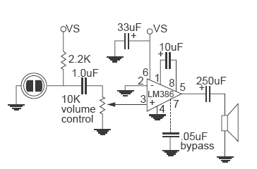

Judging by this circuit that Digi-Key put on top of the listing of the WM 61 b and the rest of the series, 1 uF is the answer. I wouldn't make it an electrolytic.
That LM386 is an inexpensive, common little audio amp that has been used for a long time.
Judging by this schematic, I would think you could connect this up to a soundcard directly, I don't think the LM386 has any particular circuitry just for mics-if it works with an LM386, I guess it works with a soundcard.
I beliefve you can dispense with the 10K and connection to the ground. Just hook the end of cap to the soundcard.

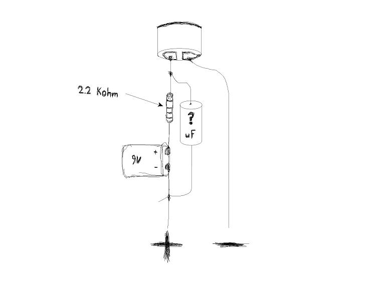

kw: Gee, and I just scanned in my hand-drawn sketch. Yours is cooler.
Jimmy: Depending on your sound card, you may not need the opamp circuitry. Try it first with just the battery, resistor, and 1 uF cap.

I see the 1115.pdf is where you got that picture from. I had trouble viewing that file, mainly I couldn't see anything, but I downloaded it now and it has that confusing wiring schematic in it. I don't know how to read something like that right now. I had enough troubles and still have some slight problems with my gainclone, I don't know if I'm ready for another amp adventure.
I did not know what "kw:" was I almost thought you were hilusonating, complementing my drawing. If I need an opamp I think I will just give up cause it's going to drive me crazy I already know it. My soundcard is a Creative SB 16. Sy, can you post that sketch you scanned, if it is not too much trouble?

I think you miss the point. The LM386 is just an inexpensive amp used for years. It does not have a particularly sensitive fornt end.
My point is that if this mic can feed an LM386 and drive loudspeakers without a special mic preamp, then it should be able to drive your soundcard without a special preamp.
I was not suggesting you build the LM386 circuit. Only suggesting that if the mic directly drives an LM386, then it should be able to directly drive your soundcard.
In other words, the mic preamp might not be necessary at all.

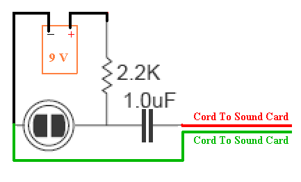

I have modified the drawing I posted earlier. Get a cord from Radio Shack and hook the two wires up according to the following diagram. I am not guaranteeing that it will be enough to drive your soundcard, but give it a shot. It's cheap and easy enough to do, lol. 😉
PS: Make sure that 1 uF capacitor is not an electrolytic. Radio Shack has nonelectrolytic 1 uF capacitors, or else get two 0.47 uF caps and wire them in parallel.
Get a mono cord, 1/8". It can either be 1/8" on one end and bare wires on the other, which is preferred, or get 1/8" on both ends and snip one end. Not expensive either way. There should be two wires in the cord.

How close does it have to be to 2.2 Kohm. I made a 2 Kohm resistor is ths okay? And I also read the way you identify a non-electrolyte cap is because it's labeled 105 instead of 1.0 uF, is this true?
Boy, I was way off on my picture if you saw it on page 3.

Jimmy:
Go to Radio Shack and get this resistor, #271-1121:
http://www.radioshack.com/images/ProductCatalog/ProductImage/271/271-1121.jpg
Also get this capacitor, #272-1055:
http://www.radioshack.com/images/ProductCatalog/ProductImage/272/272-1055.jpg
Pick up a mono 1/8" cable with open ends or snip off one end, and hook the thing up.
Yes, you can hook up two 1K resistors in series, (one after the other), but at these prices, why bother?
