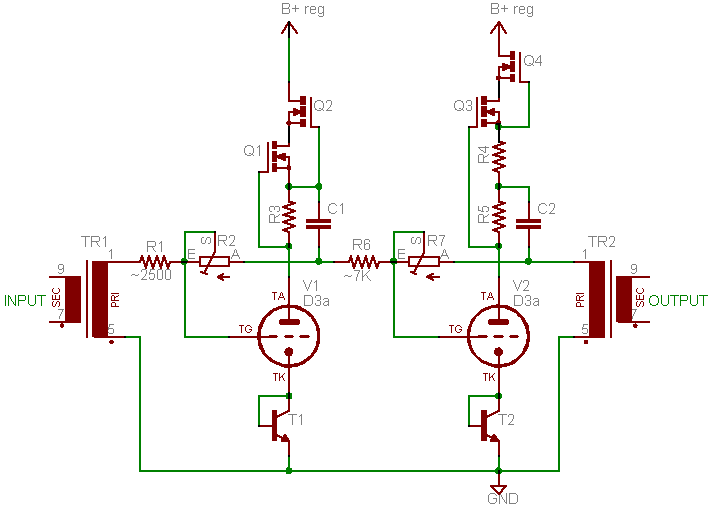

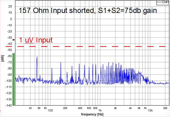

Hi Ian,
Great questions. In the spirit of DIY, here's what I'm up to:
The active loads are MOSFETS; here's a simplified signal path schematic, not showing grid/gate stoppers, etc.
The feedback is a divider from plate to grid, referenced to the input. As a result, input impedance to each stage is relatively low; 2500 ohms for the first stage and about 7K for the second. I'm planning on reducing the first stage Zin to about 1600 ohms which should reduce the input noise somewhat over what I measure now.
This unit is the prototype, and I'm in the middle of working on the noise, so this is very much a work-in-progress.
The EIN depends on both the basic amplifier EIN and the switchable input transformer ratio. Here's a sample of what I'm currently seeing at the output referred to the input level, at the 75 dB overall gain setting with 1:4 input step-up ratio . The RMS input noise voltage over 22 KHz bandwidth is about -131 dBu or a little over 200 nV. It's a little less than I expect for what I work out to 150 ohms ENR. Particularly strange that it doesn't look like thermal noise...
Clearly I have some more work to do, with obvious "opportunities".
Michael

Hi Michael,
Thanks for being so open about your circuit design.
MOSFETS in the plate load makes good sense.
The feedback mechanism I am not so sure about. This is basically shunt derived, shunt applied NFB where the input impedance is effectively determined by the input arm of the feedback network i.e. 2K5 on the input stage.
With the transformer input shorted, its secondary is shorted so the only noise source is the 2K5 resistor (plus the presumably small secondary resistance of the transformer) which will produce about 1.1uV of noise. The noise gain with the set up you measured is 75dB minus the 12dB of the transformer or about 63dB. The 1.1uV of noise is about -122dBu so at the output you would expect it to be 63dB higher or -58dB. What you get is about -56dBu or 2dB worse which implies your amp only adds a couple of dB of noise which is very good indeed. You should be able to verify this by repeating the experiment with the transformer secondary shorted which should give a near identical result.
However, the big problem I see with this topology is that you will always have the input resistor contributing to the noise. With your current set up there is also another potential problem. The 2K5 reflected by the 4:1 transformer appears as about 156 ohms at the primary (your note says 157 on the noise graph so I guess I am on the right track). That will be OK for mics with a 50 ohm source resistance but not for 150 ohm mics which will lose 6dB of signal level. For these you will need to change the ratio to 2:1 or even 1:1 to give them optimum loading. This reduces your overall gain by 6 or 12 dB but not the noise gain for the 2K5 resistor so your EIN will get 6 or 12dB worse.
Don't get me wrong, I am not being deliberately critical of your design. It is a topology I have considered myself as it has some key advantages in terms of gain staging that other topologies do not. I am just not convinced of it noise performance.

All great comments which get to the core of the design tradeoffs. Basically, the idea here is that with switchable input transformer ratios, the noise contributed by the input resistor is acceptable. The "real" design is for 1600 ohms instead of 2500 (I just used the resistors I had on hand to get something going) and will have switchable 1600, 400, and 100 ohms input resistances. This gives a theoretical EIN of about -120 dBu at 1800 ohms (assuming 200 Zs), -125 dBu at 500 ohms, and -131 dBu at 133 ohms. It does add a couple of dB noise to mics that are in the 10-12 dB(A) self noise class at typical sensitivities. Whether this is a problem or not depends, but I don't expect a huge issue in most cases.
Another factor is that R1 value decreases at higher gain settings and is only 680 ohms when the stage 1 gain is at maximum of 33 dB. Is R1 effectively in parallel with the feedback resistor?
The whole set of goals and tradeoffs include high gain, good power gain, and headroom (over +30 dBu input level capability) using a simple 2 stage triode circuit. Power gain is useful for driving low impedance outputs. Using D3a tubes I can get good gain margin with a nice triode characteristic and low enough plate resistance to drive 600 ohm loads present on many vintage signal processors e.g. LA-2A or Fairchild 660.
The currently measured "noise" includes excess 60 Hz and multiples thereof; just that the analyzer was apparently confused as to the sample rate. Changing to the proper setting shows the same result with everything lined up on 60 Hz. I should be able to nail this easily.
Michael
The load seen by the microphone is R1 divided by the transformer turns ratio. This means that as you vary R1 to vary the gain, the load seen by the microphone varies. Even if the transformer ratio is 1:1, a 680 ohm load is too low for 150 ohm mics. They like to see a nice constant load of around 1200 ohms.
Cheers
Ian
I should have been a little more clear. R1 and the feedback resistor are both varied together to affect the gain in 3dB steps while keeping the input impedance constant at 1600 ohms.
When the stage gain is at maximum (33db) the value of R1 will be 680 ohms, but due to the larger plate feedback resistance, the input impedance is still 1600 ohms. In this case the ENR should be 680 ohms + 65 ohms for the triode plus a few ohms rbb of the bias transistor + the DCR and reflected source impedance.
Michael
Michael
I am struggling to understand this. 33dB is about 45 times so the plate feedback resistance should be in the region of 45 x 680 = about 31K. Since in triode mode, the mu of a D3A is about 80 the feedback resistor 'looks like' 31k/mu from grid to ground or about 390 ohms. This plus the 680 gives an effective input impedance of 1070 ohms, a lot less than the 1600 you calculate. As far as I can see the '65 ohms for the triode' (whatever that means) and the rbb of the bias transistor don't come into it. Or have I missed something??
