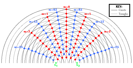

The chart exactly represents what I wrote in post #7, so I agree.I post here two figures from D'Appolito book Testing Loudspeaker to more specifically illustrate the intent of my question.
Based on the Figures, the implication is that based on the distant from the speaker to the microphone, the relative phase difference between the various drivers will change.
The other implication is the further the mic, the relative phase difference is getting smaller and smaller as calculated on the chart. Can everyone agree on this?
The chart represents reality as can be measured or heard at the various vertical off-axis listening positions.
The phase angle changes with the relative vertical off-axis angle.

In the polar response charts below, it is easy to see the null in the crossover range deepening between 1kHz and 2kHz as the vertical angle increases thereby increasing the arrival time of the woofer in relation to the tweeter, while the horizontal dispersion, equidistant between the two drivers, stays consistent over the same range.
At a 30 degree angle up from "on axis", that null is around 6 dB deep- whether that is "hideous" is a subjective observation, but it is certainly measurable and can be heard when listening that far off the vertical axis. With the speakers oriented "normally", tweeter over woofer, not a problem when moving laterally, but if the speakers were turned "sideways", the response "suckout" would "suck" by comparison.

First, "Null means having no value; in other words null is zero"
Second, although there are dips (of course), but that doesn't mean you or anybody can predict them with a tape measure (AKA Euclidean-like distances), as kimmosto wisely posts and for the reasons I earlier provided.
Thanks.
anyone who has done actual tests will confirm that the phase between the drivers will change when measured at 50cm and then again at 75cm.
unless you have access to a large space measuring an 8ft is not possible.
as a compromise, measure the tweeter at 60cm (or so to get enough data) then lower the mic down to the next driver (whislt maintaining same baffle distance)
Perhaps Dr D'Appolito intended those two figures as a starting point to explore the complexities of any math solution -- and didn't intend to imply that there is an exact, comprehensive mathematical solution.
In any case, it is certainly easy to get lost in the trigonometry ...
If you're still bothered by all this -- that an oversimplification might confound more than illuminate -- keep in mind that Dr's diagrams are only valid if all 3 drivers are getting phase-matched stimuli at all frequencies that they reproduce!
