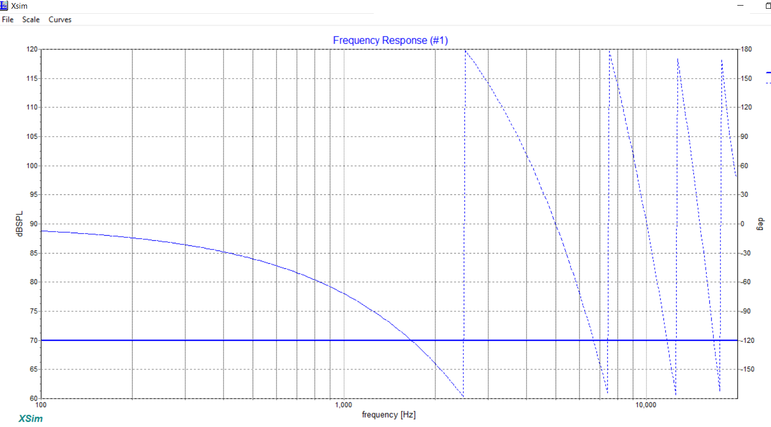

Suppose I have a baffle with two tweeters. Please ignore diffraction or any reflections from the surroundings. One tweeter is mounted on top of the baffle. The other tweeter is mounted at 2.7 in. below the top tweeter. Also 2.7in. happens to be the wavelength of 5KHz sine wave tone.
Now if I place a microphone right at the tweeter on the top, then:
1. Play a 5KHz tone to both tweeter. Will the sound coming from the tweeter at the bottom be 360 degree delay vs. the top tweeter at the microphone?
2. Now if I play a 2.5KHz tone to both tweeter. Will the sound coming from the tweeter at the bottom be 180 degree delay vs. the top tweeter?

Don't you trust the formula you have been using?
edit: this is a sim of a driver delayed by 2.7"
Thank you. To be honest, I can't be too sure.

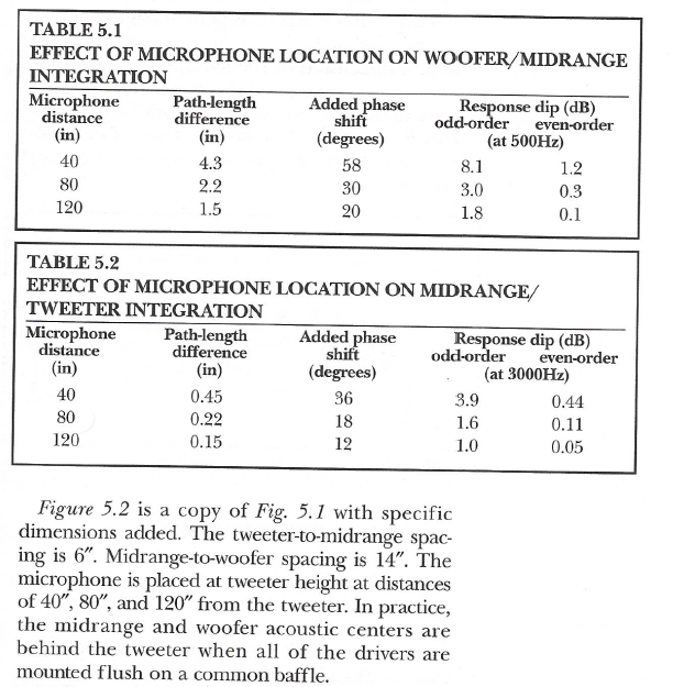

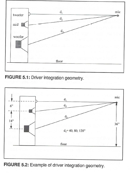

Thanks for all the responses so far. I am trying not to get too far away from my original question.
I post here two figures from D'Appolito book Testing Loudspeaker to more specifically illustrate the intent of my question.
One Figure is the picture of the microphone with respect to the 3way speaker at tweeter axis. The other Figure calculates the phase difference between the mid driver vs. the tweeter at mic position distant, and likewise, the woofer with respect to the tweeter.
Based on the Figures, the implication is that based on the distant from the speaker to the microphone, the relative phase difference between the various drivers will change.
The other implication is the further the mic, the relative phase difference is getting smaller and smaller as calculated on the chart. Can everyone agree on this?
Thanks.
Thanks.

I got the picture from D'Appolito Testing Speaker so I figure it has some merits because he's a speaker design and he might have some insights into speaker design. Now you say it's all wrong so I am kind of confused. Either he's wrong or you're wrong.
Yes. We may have different ways of doing it.Based on the Figures, the implication is that based on the distant from the speaker to the microphone, the relative phase difference between the various drivers will change.
It's not black and white. Delay/phase calculation by distance works quite okay, but it's not accurate if shape of magnitude response changes when distance or especially off-axis angle changes, or acoustic center (at target frequency) of radiator travels while off-axis angle changes. Those depend on radiator's size and shape and wave length e.g. small radiator at low frequency is more reliable to estimate by distance only.
For example moving mic in D'Appolito's example causes magnitude and phase response changes to all drivers but mostly to woofer at HF. You could get decent result by distance, but not exact without measuring at each mic position.
As mentioned earlier, decent XO simulator is able to visualize these changes: calculate SPL change and phase summing including magnitude response and phase response and acoustic center changes if measurement data of drivers covers off-axis angle range including rotation of drivers and moving of microphone.

I understand that but should we at least begin at some theoretical starting point even if the real world condition is a bit more complicated. The Figures I posted assumed that the xover at 500Hz and 3000Hz and the calculation was based on that assumption and the mic location. If we start to include multitude possible real world conditions, then it's hard to finish a design.
It's just simple illustration on how the phase can get affected by mic position. It does not pretend to be any more complicated than that.
