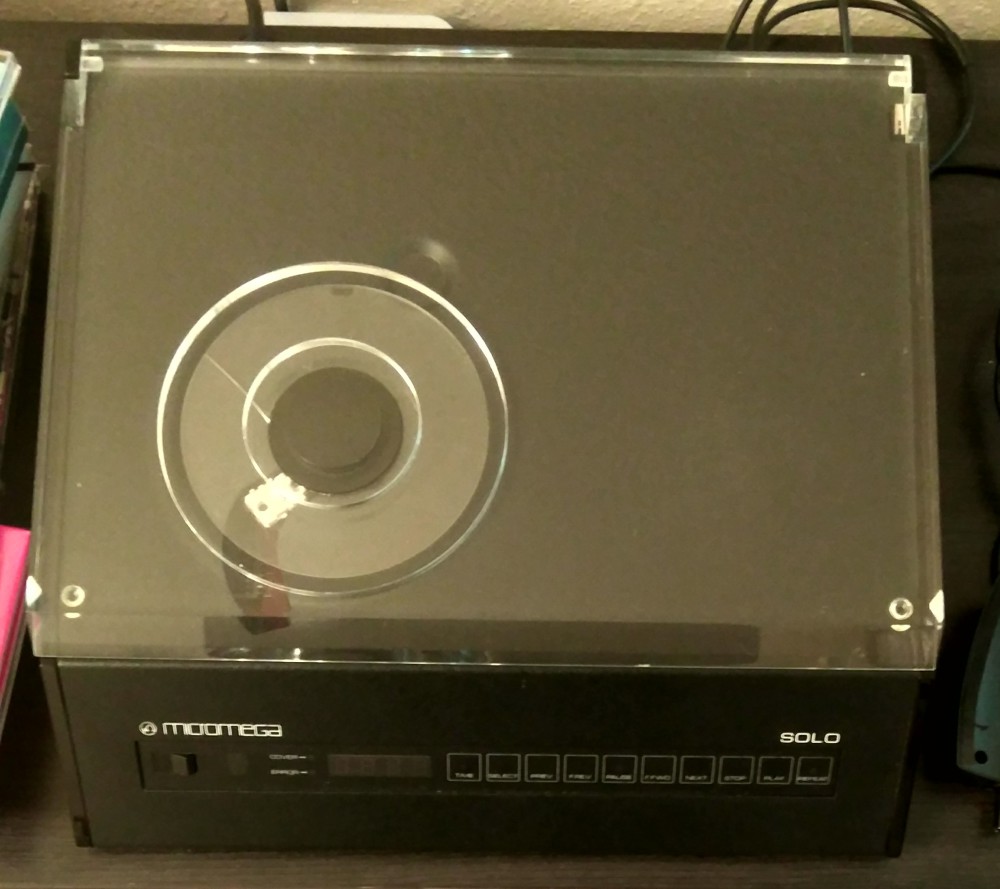

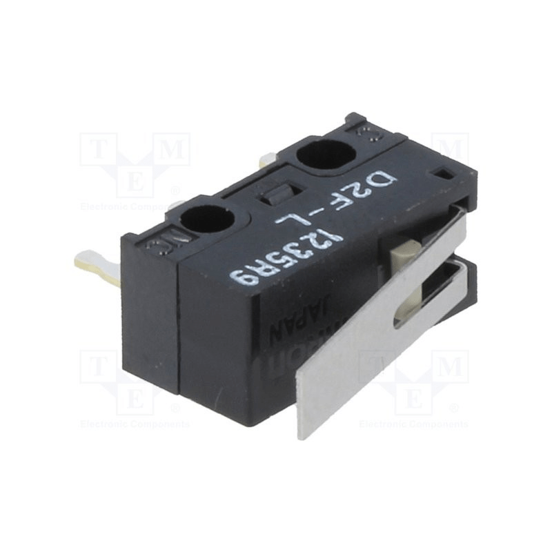

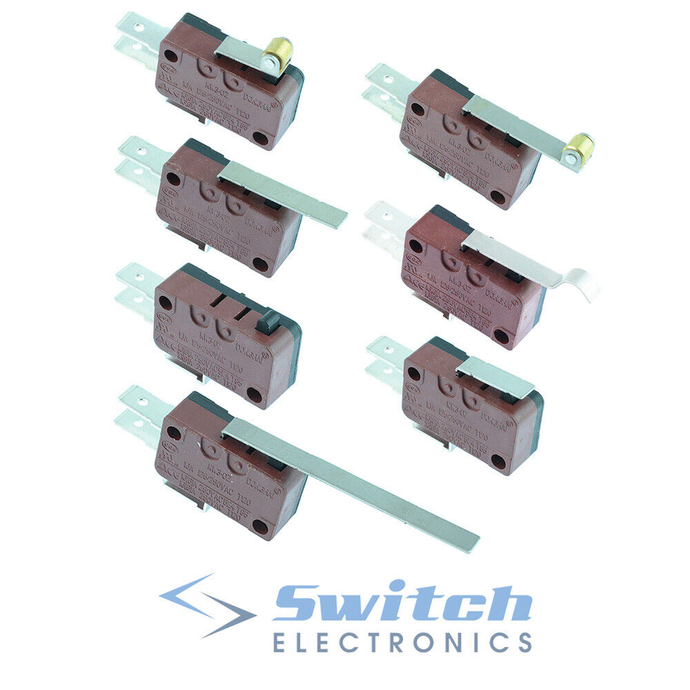

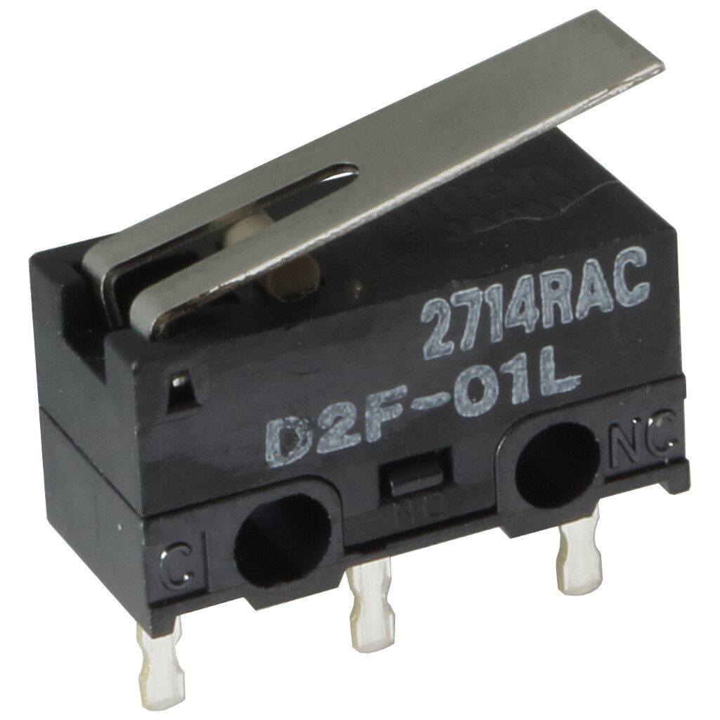

I am looking for exact model naming of micro switch used for switching "ready" while closed plastic glass dust cover.
It looks very similar to those of attached images and this one under
https://sps.honeywell.com/de/de/pro...basic-switches/large-basic-switches/be-series

The right keyword is "Snap Action Switch with Bump Lever"
Actually I need only the bump lever - the existing one from my device (and also from the model "DUO" from a friend) was lost. Unfortunately I haven't the data of length and wide of the genuine bump lever.
it must be a standard length, micromega took a lot of standard parts reserved for the industry.
From memory there are not many lengths available on the market, if you buy a model with a short lever arm, you can weld a longer piece on it and adjust it until you get the right result, otherwise, mounting holes in the switch itself are standard.
