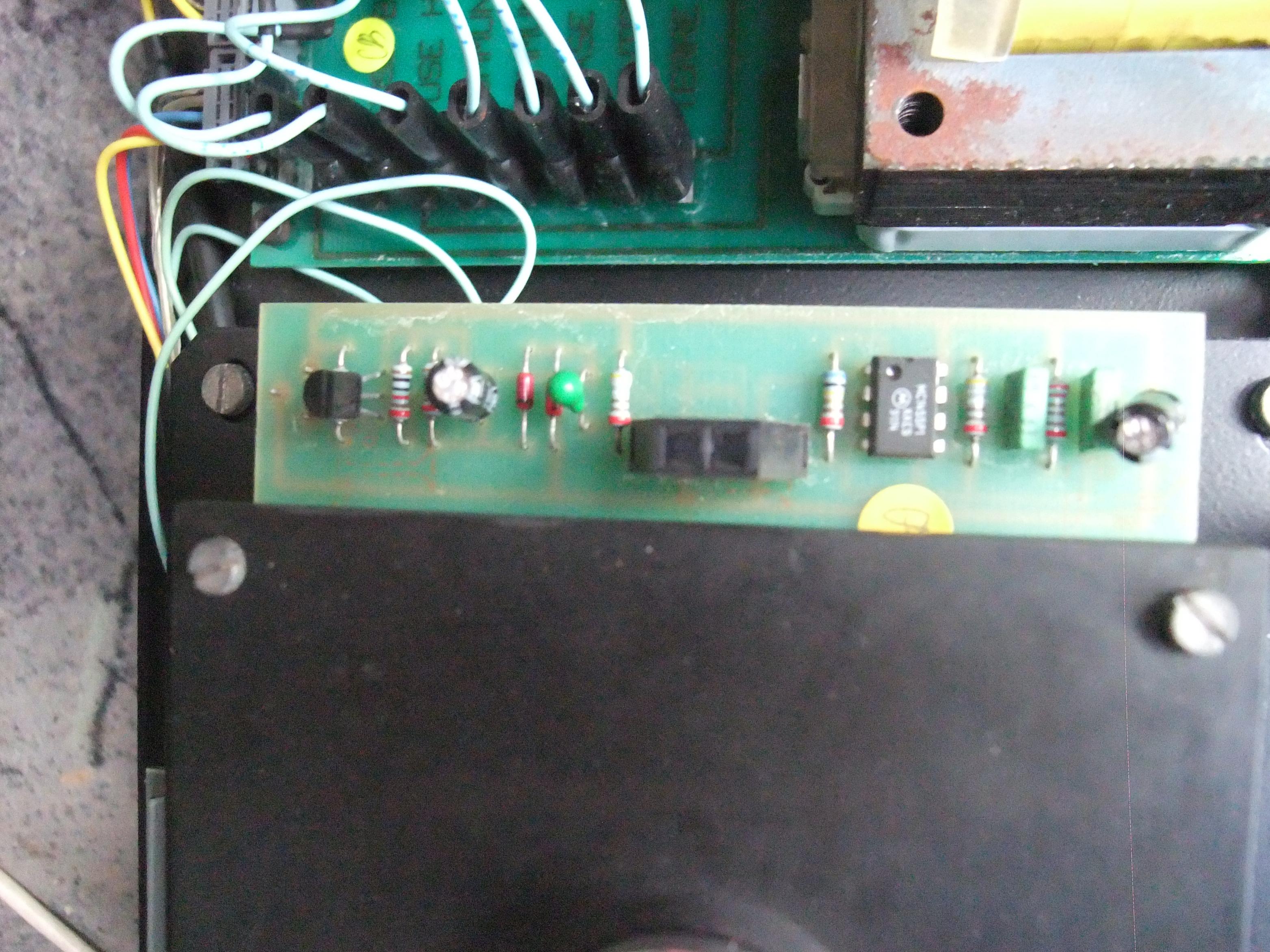

Mostly when I try and move it from service mode 0 to service mode 1, the laser tries to focus and then the CD moves slightly but it drops back to mode 0 again. Occasionally it remains in mode 1 and when in this state I have been able to measure between 48-76mV between TP1 and TP2 (across the 4k7 R3102). With 48mV there is 1.09V at across R3104 (the 18R feeding the laser supply BC338). So it looks like when it works it works (!) but I don't know why it seems to be loosing focus most of the time and dropping back to mode 0. Any suggeestions ?

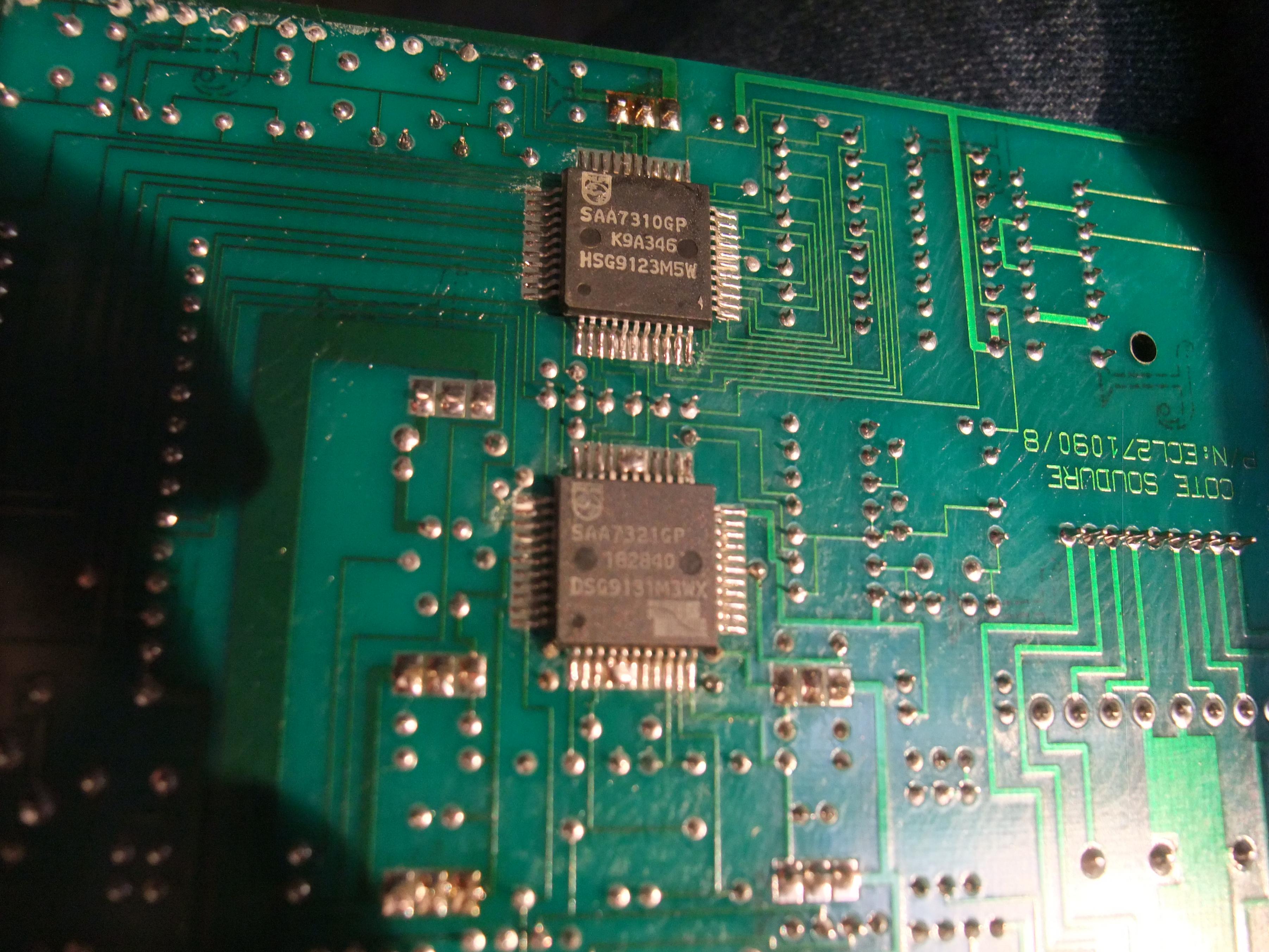

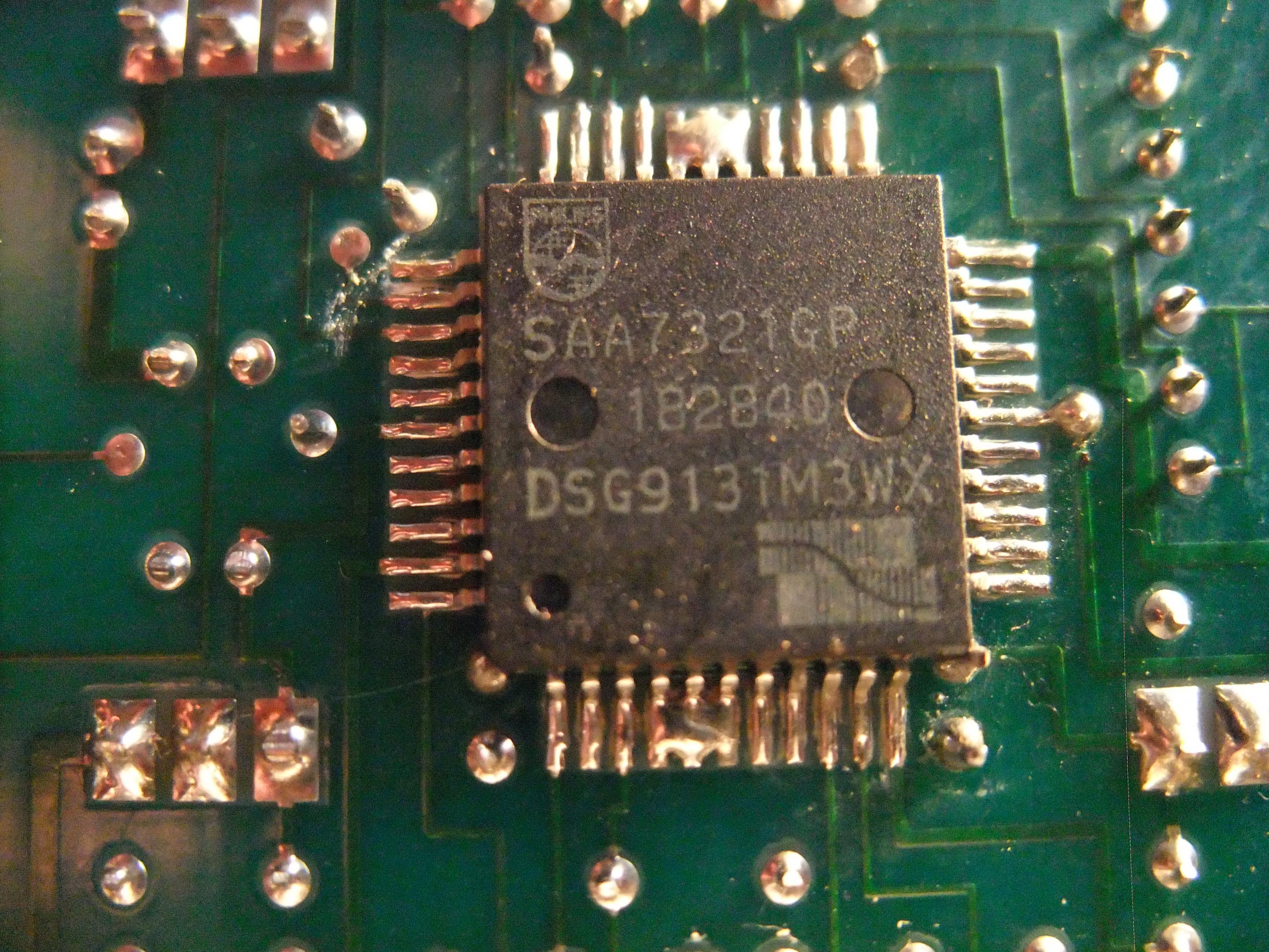

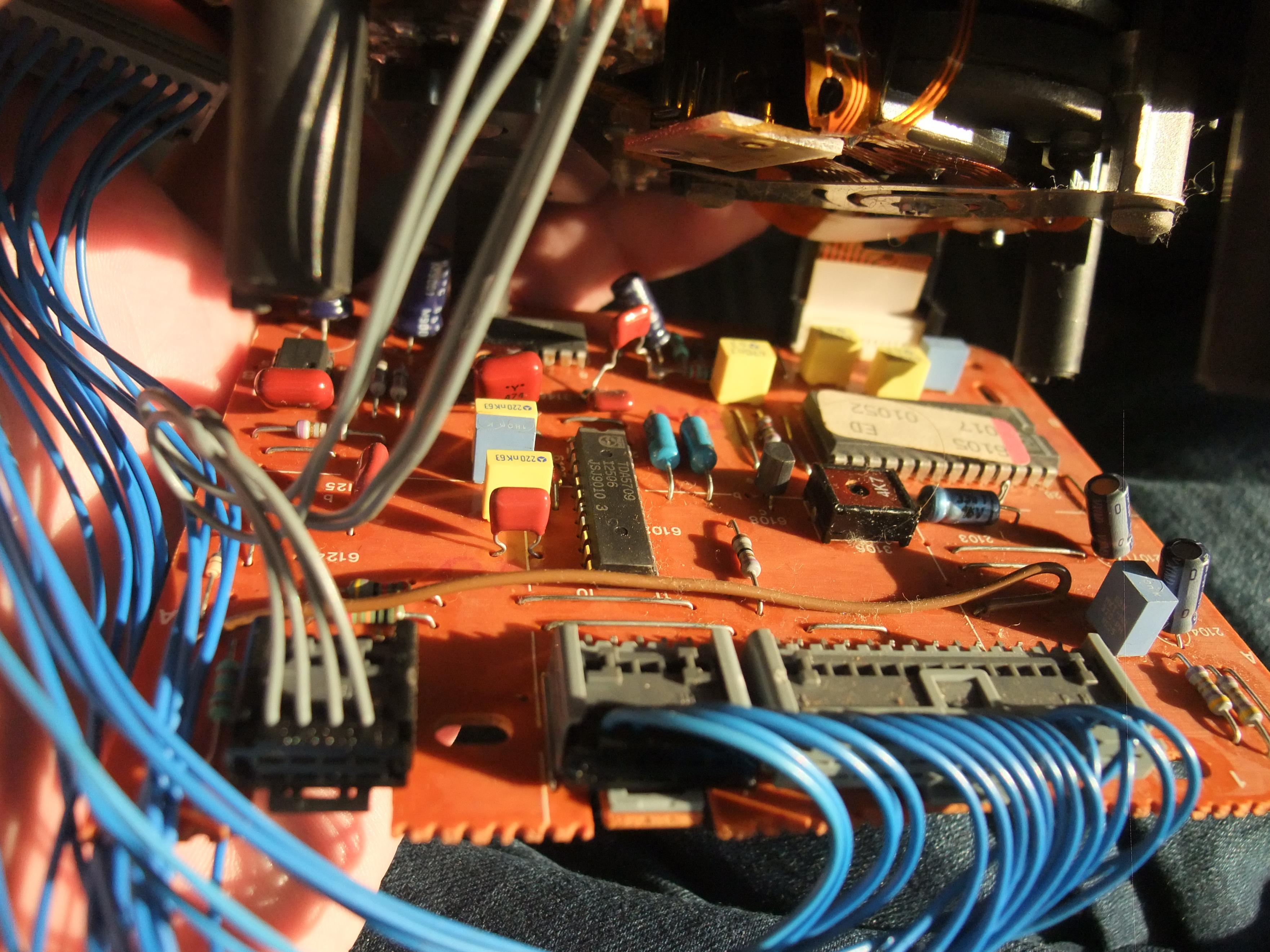

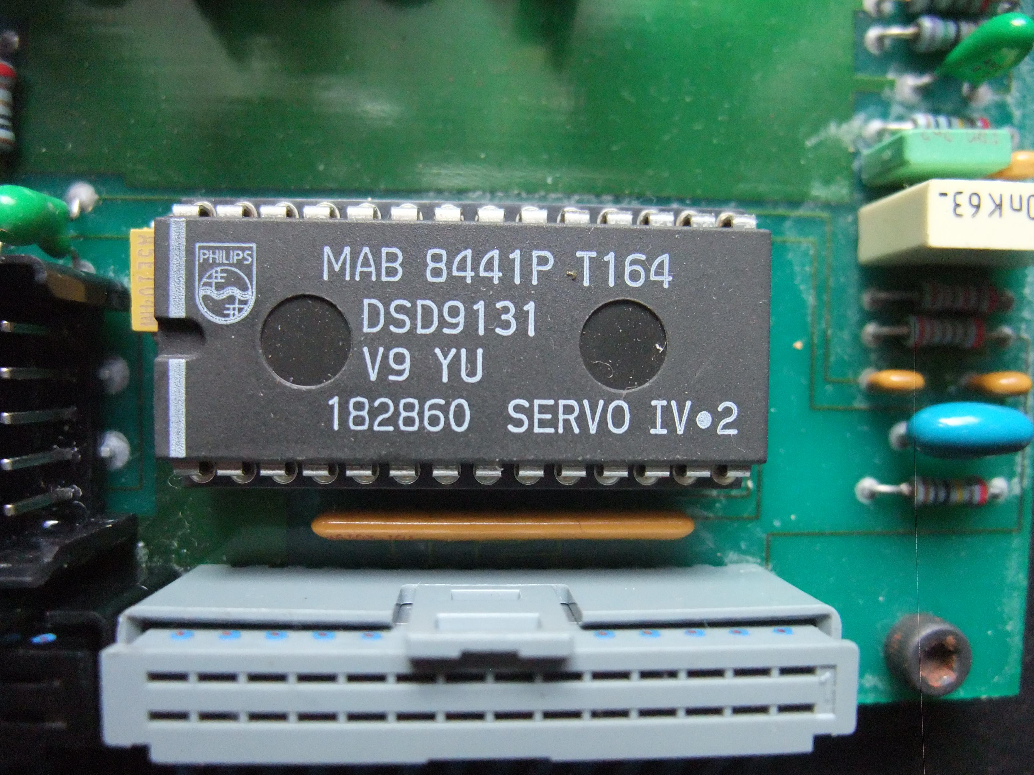

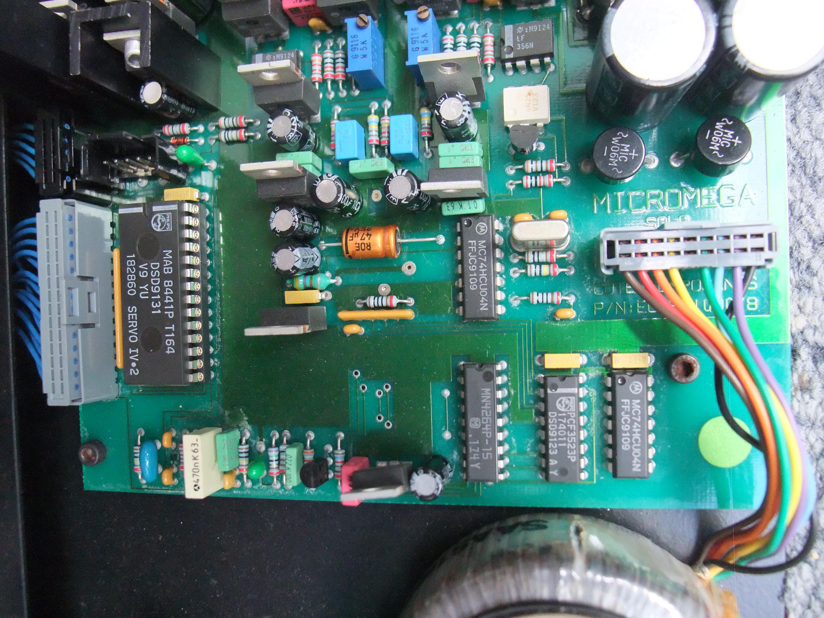

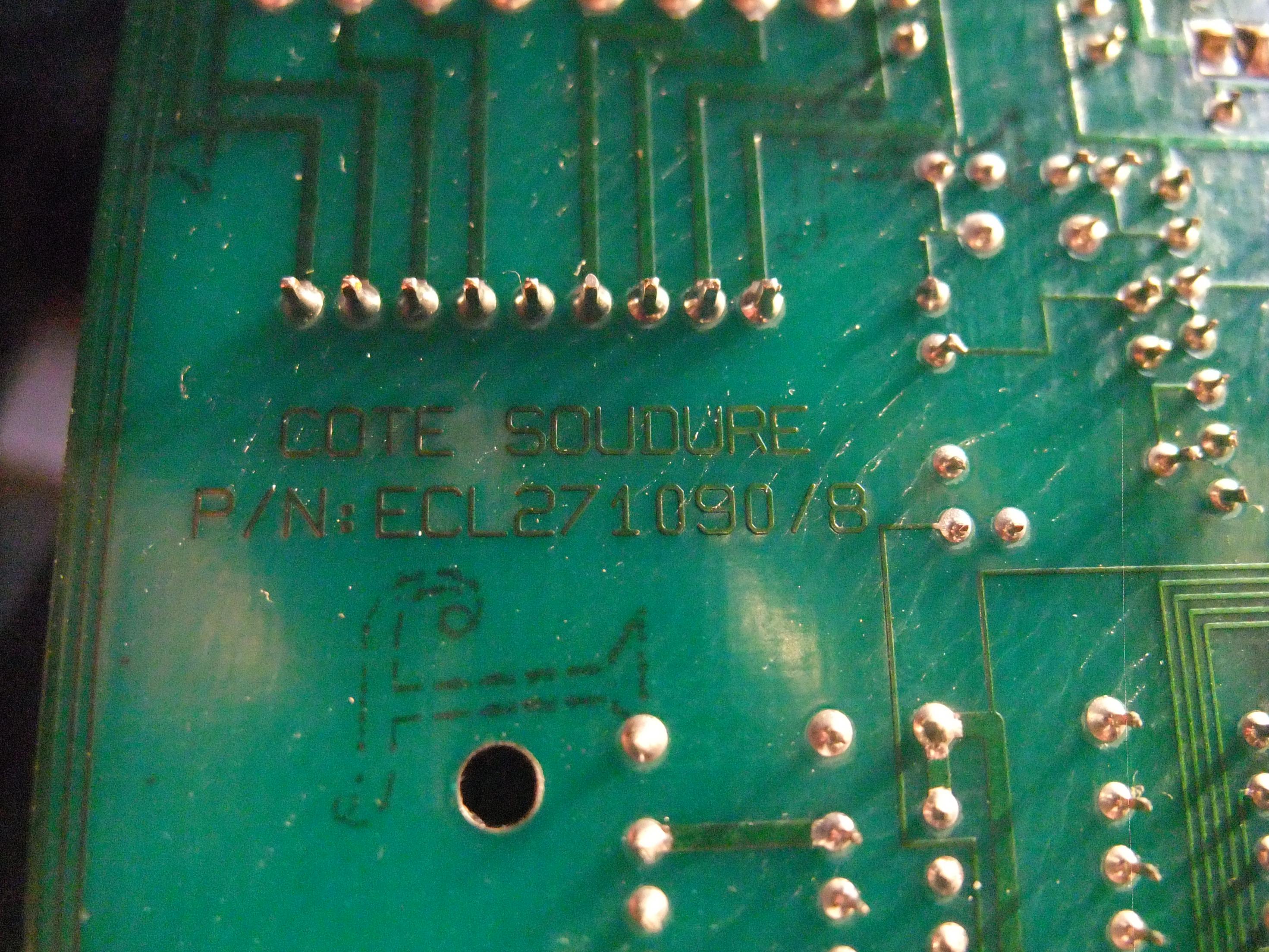

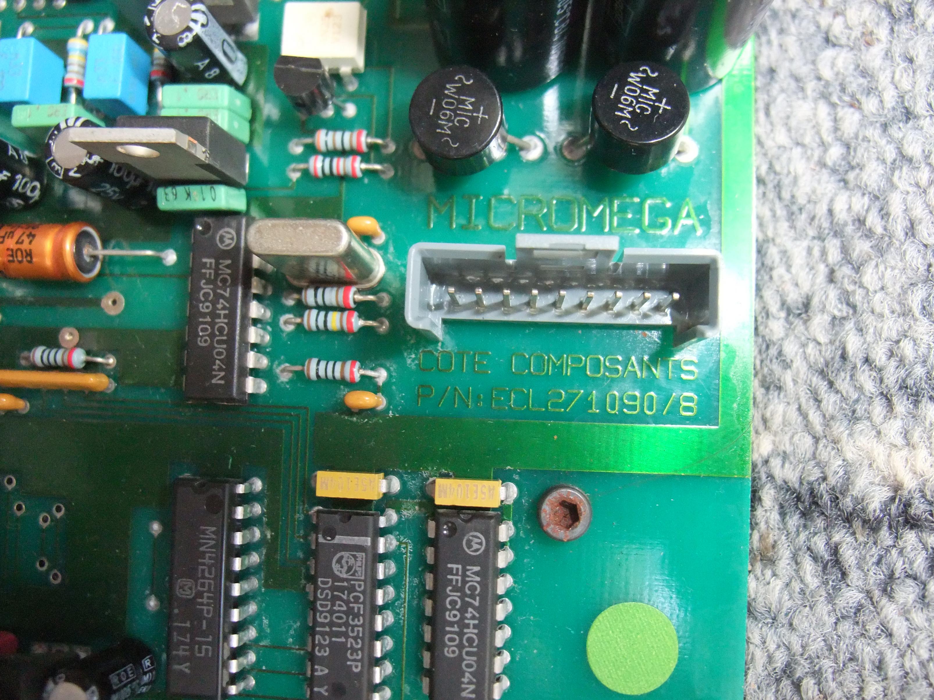

I have attached a pic of the main board - has anyone seen one before? the chips do not seem to ties up with those mentioned

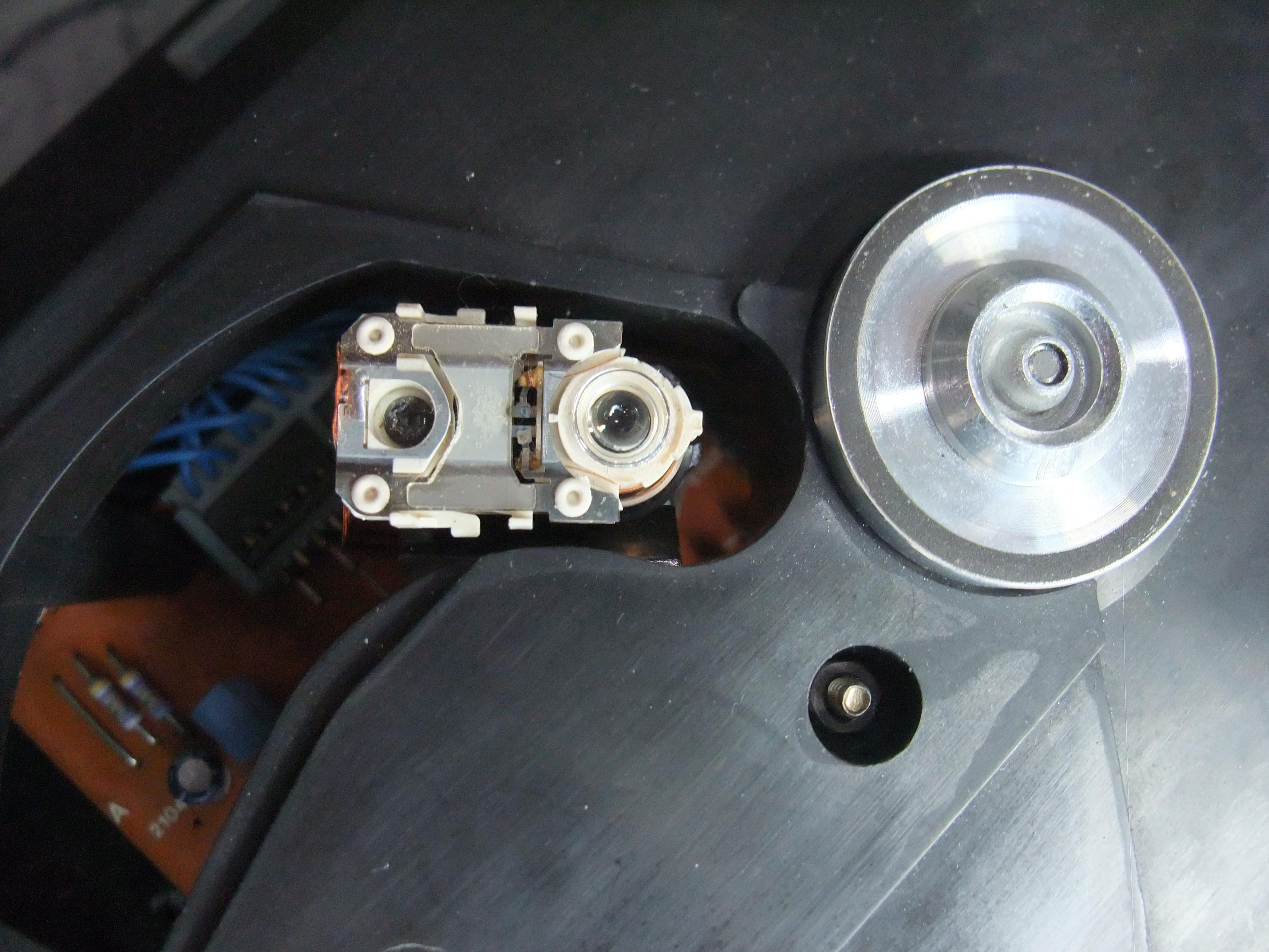

Not really. You say the motor is OK now. Maybe it is just a faulty pickup... I know they are reliable but sometimes it's easy to overlook or convince yourself it's not. If the disc doesn't even spin up to speed (presumably because focus is lost) then it doesn't even get as far as being a "data processing fault" to my way of thinking.
I had a look around the focus circuit with a scope this afternoon, there is significant 100Hz ripple on the FElag pin 😱 so I've taken the main board out and I'm going to work my way back through the power supplies next.
Having removed the bulk caps on the main pcb which are responsible for the CDM-4 supplies ...
Roederstein EKS series 1000uF/25V datasheet spec for ESR 0.19R and today's value 0.66R
Roederstein EKS series 3300uF/16V datasheet spec for ESR 0.08R and today's value 48R 😱 and as if that wasn't bad enough the other one was off the scale ! They should really have fitted 25V parts here 😡
Problem solved 😀

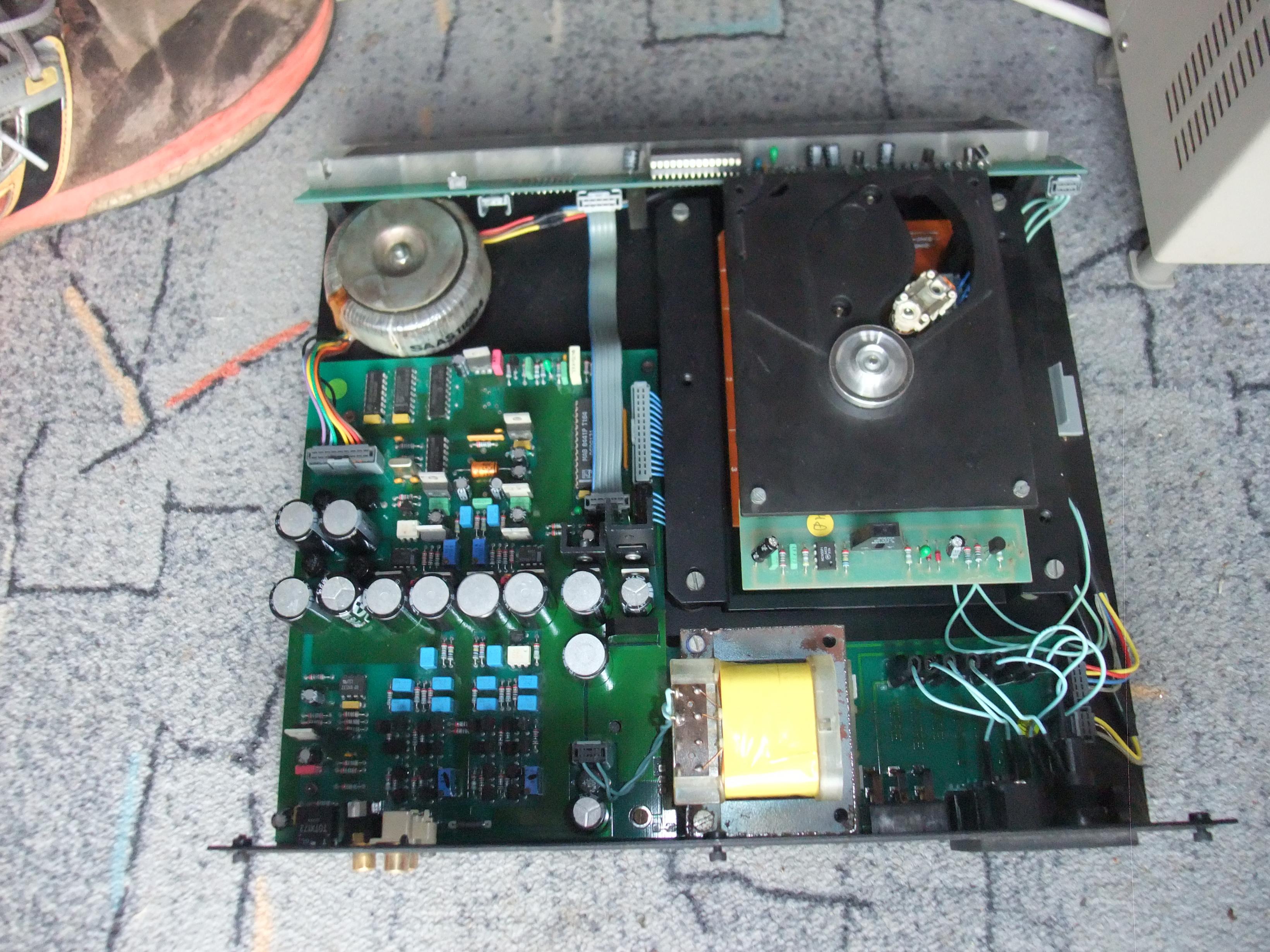

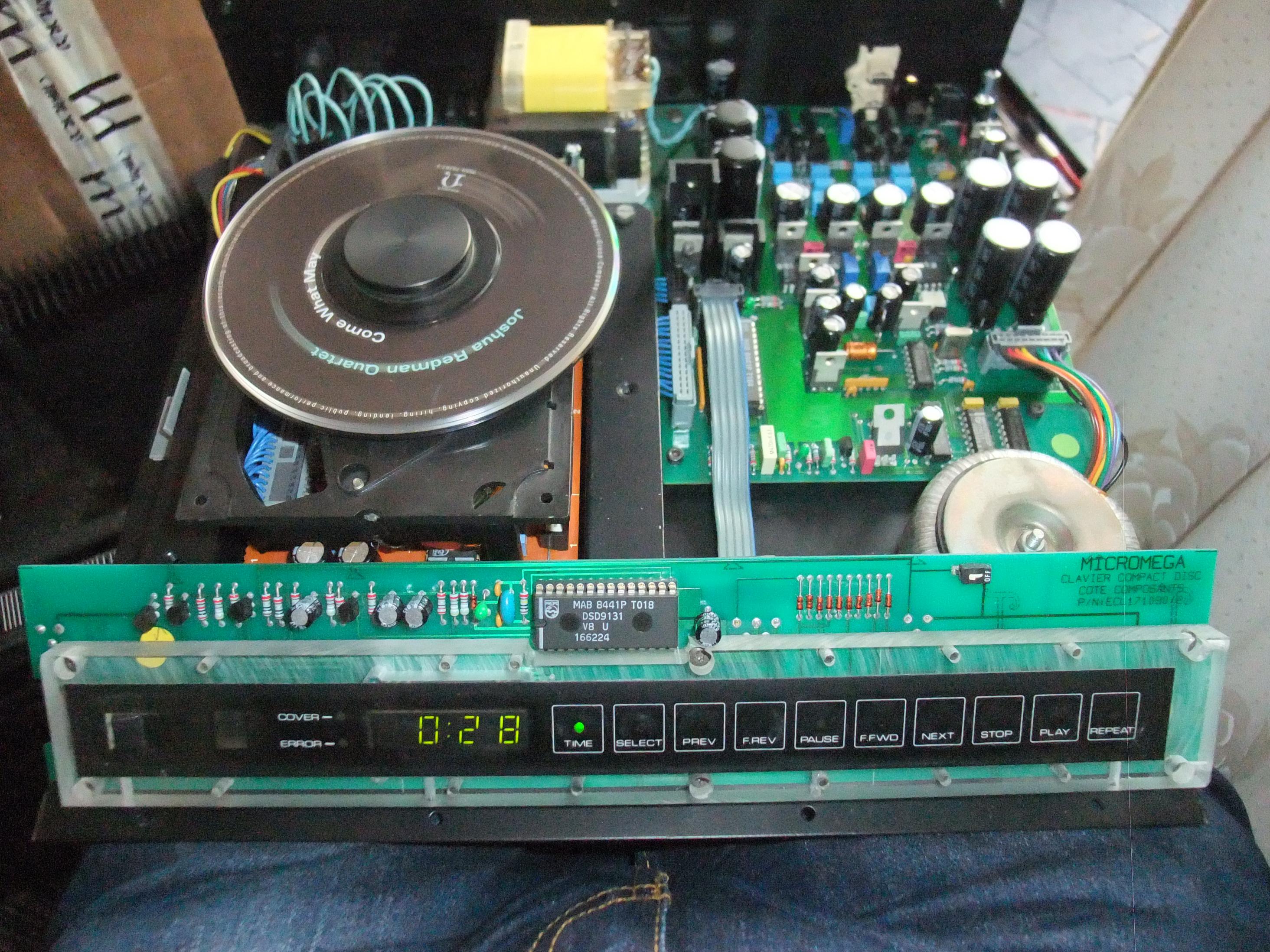

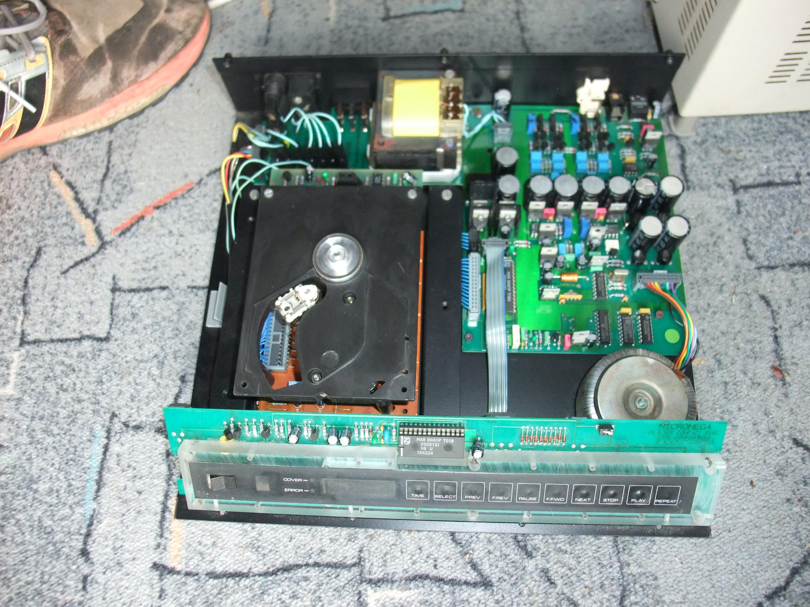

Stripdown/Clean of Micromega's SOLO

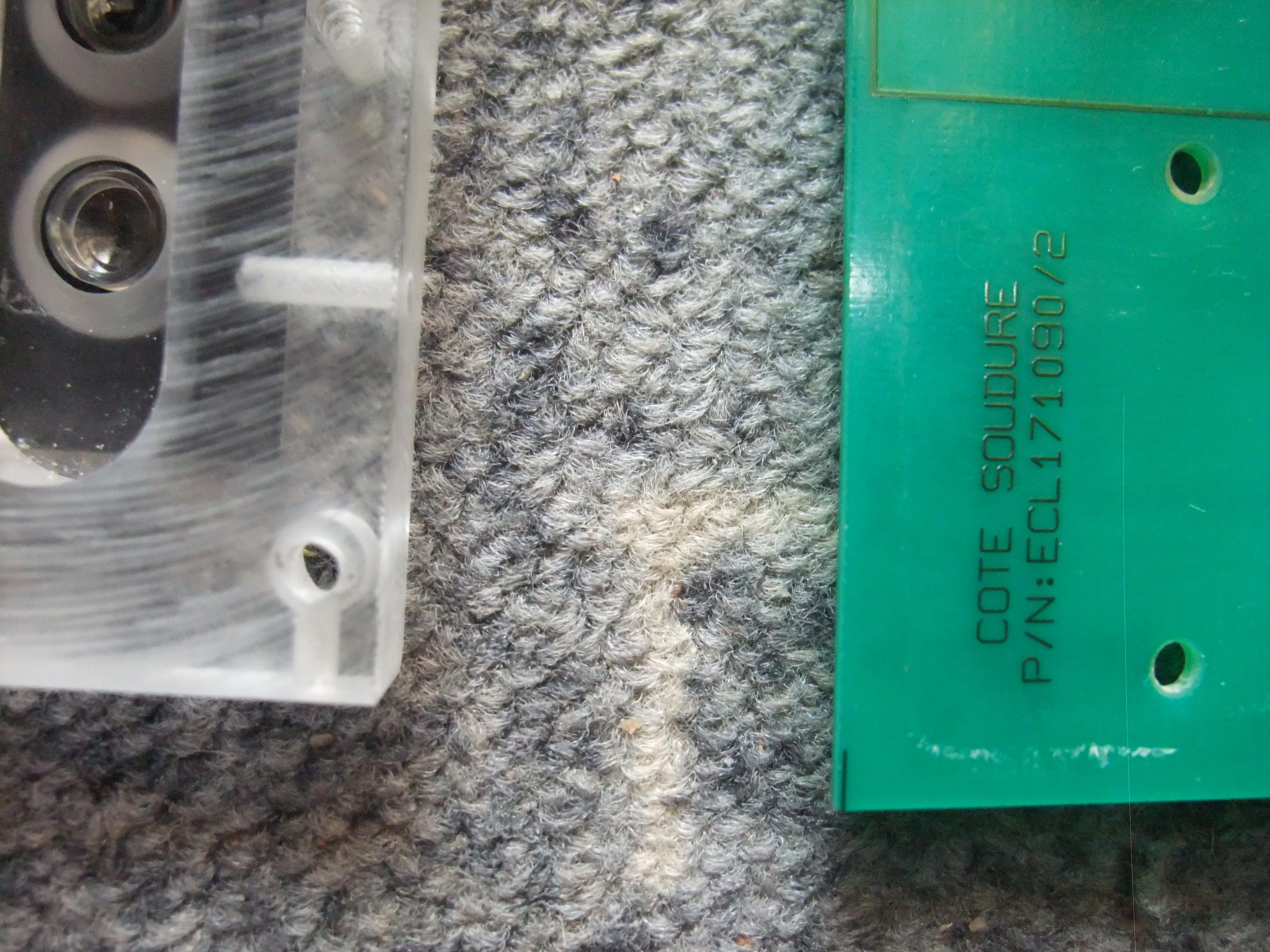

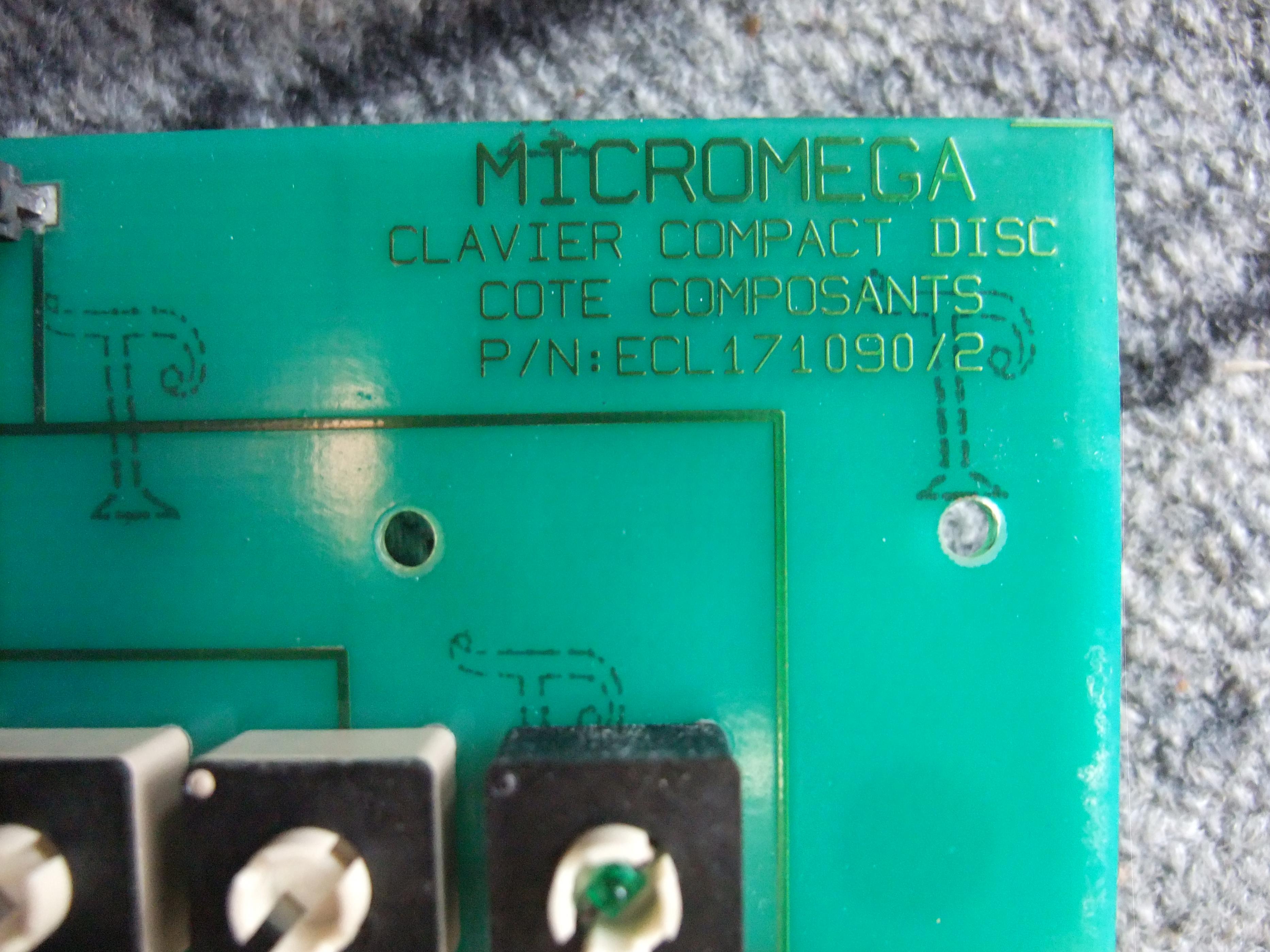

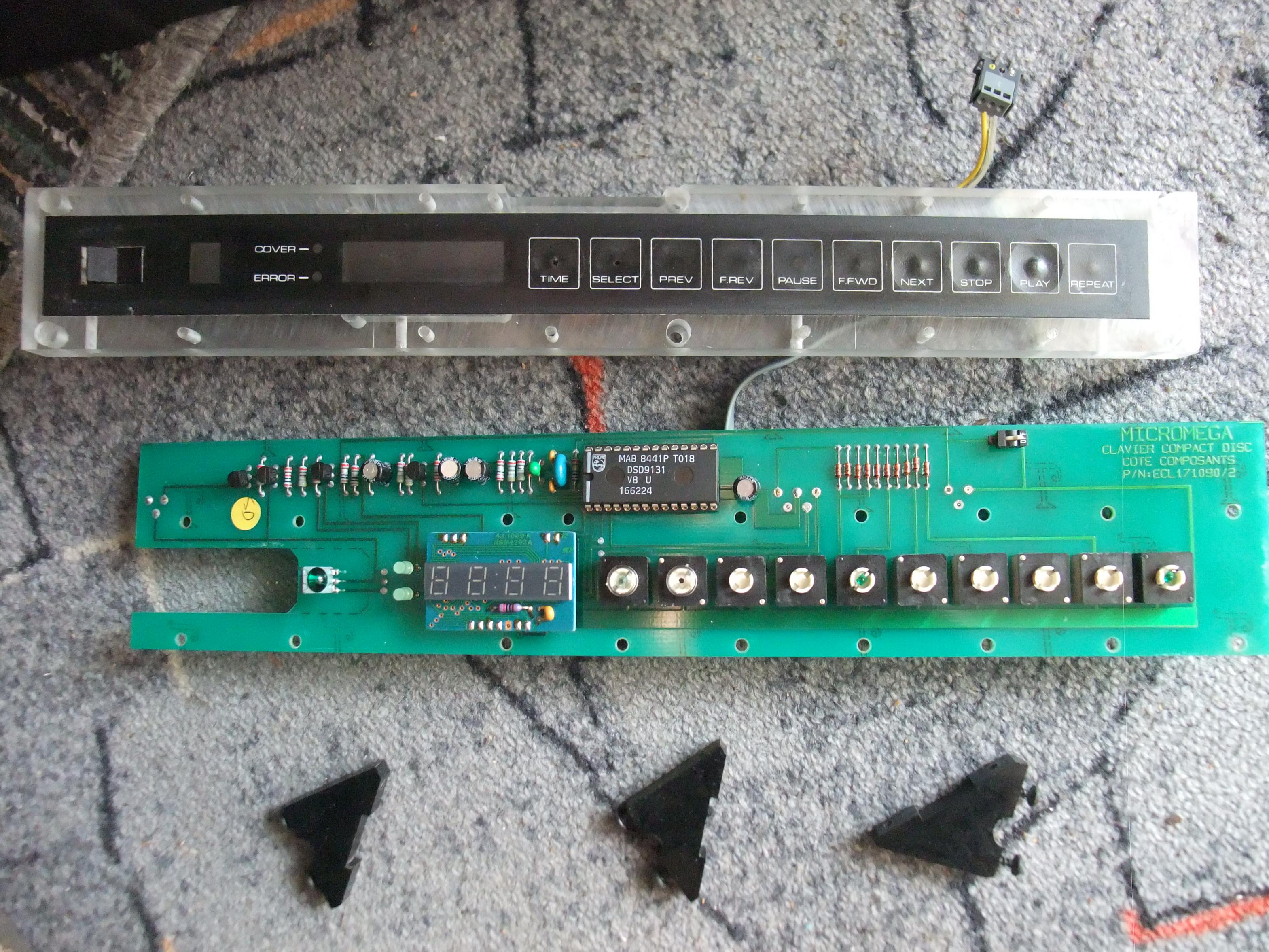

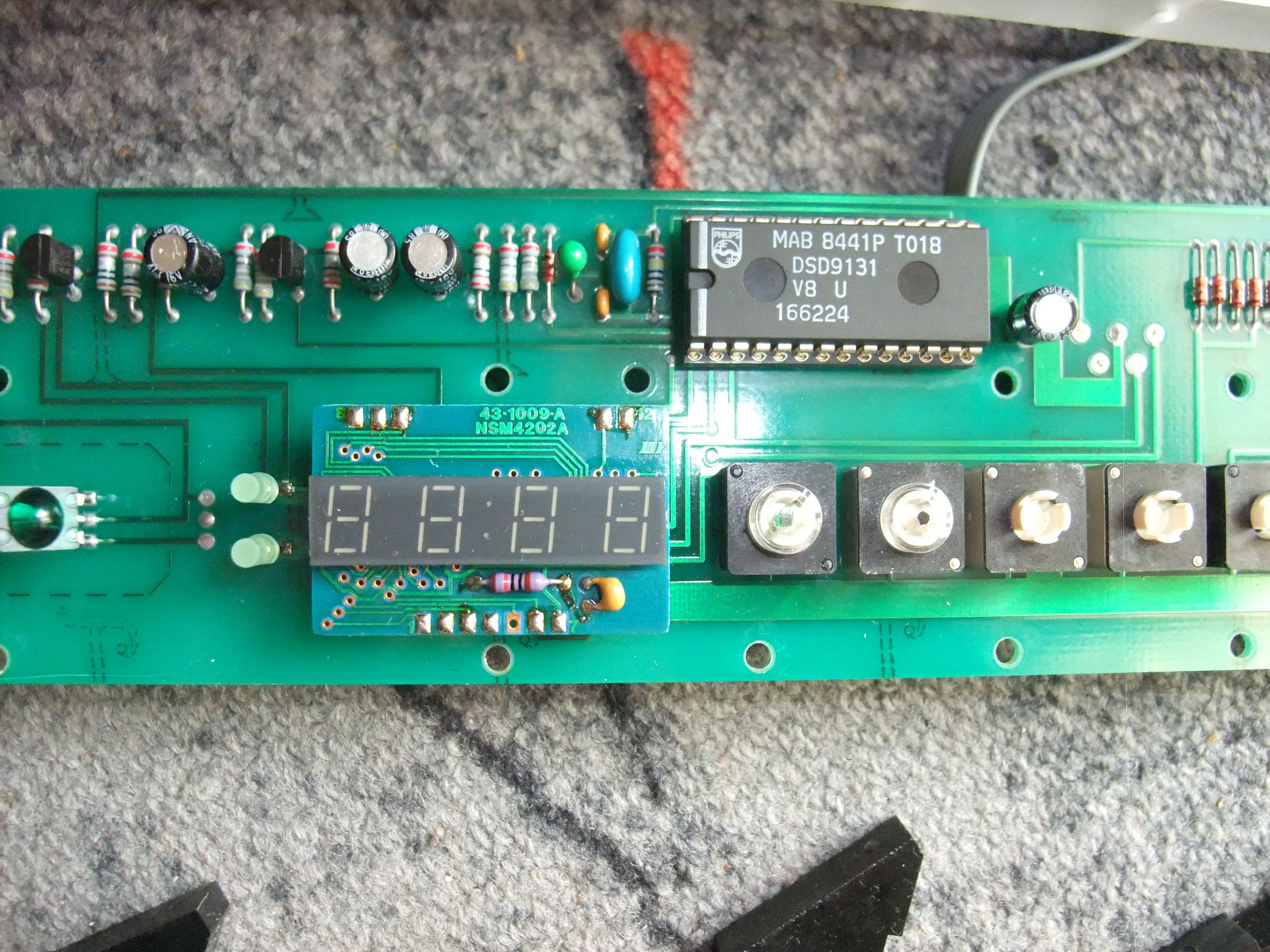

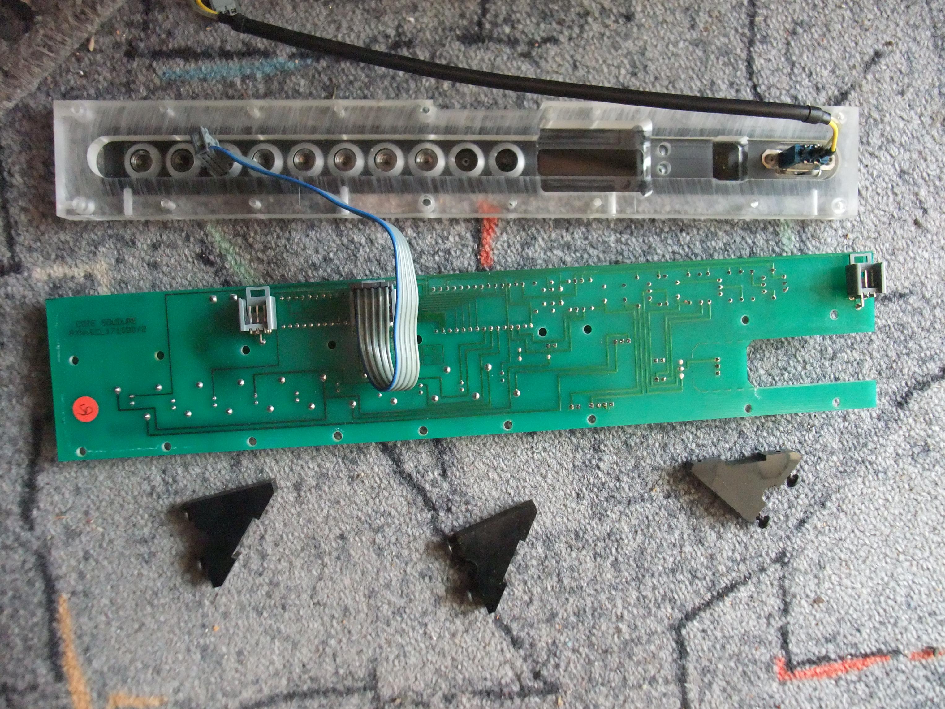

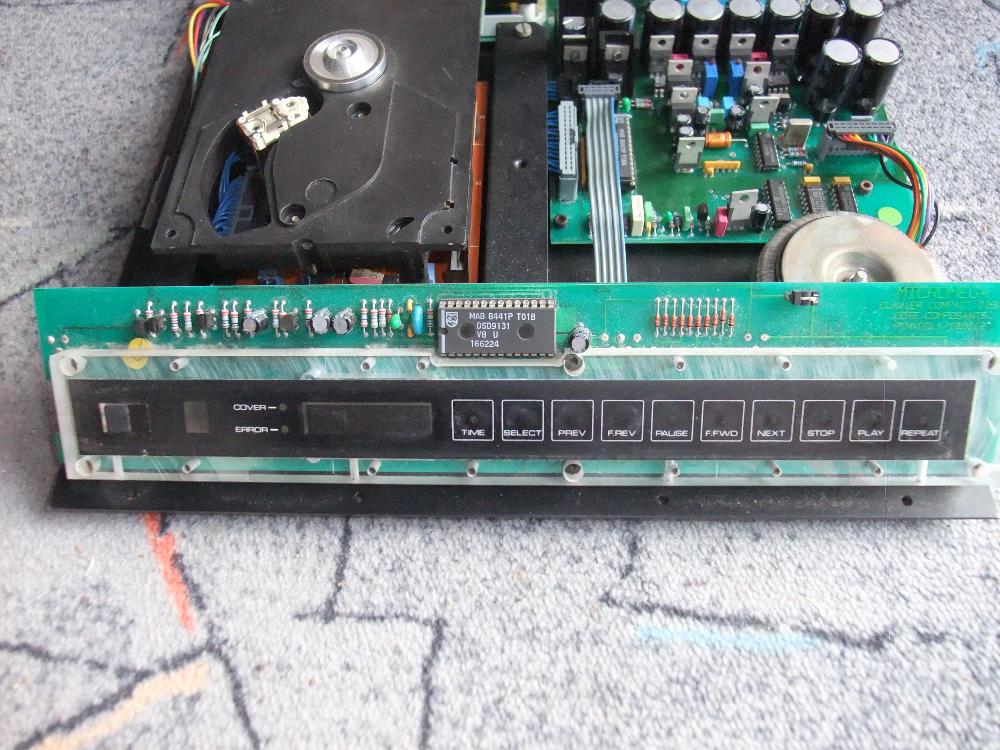

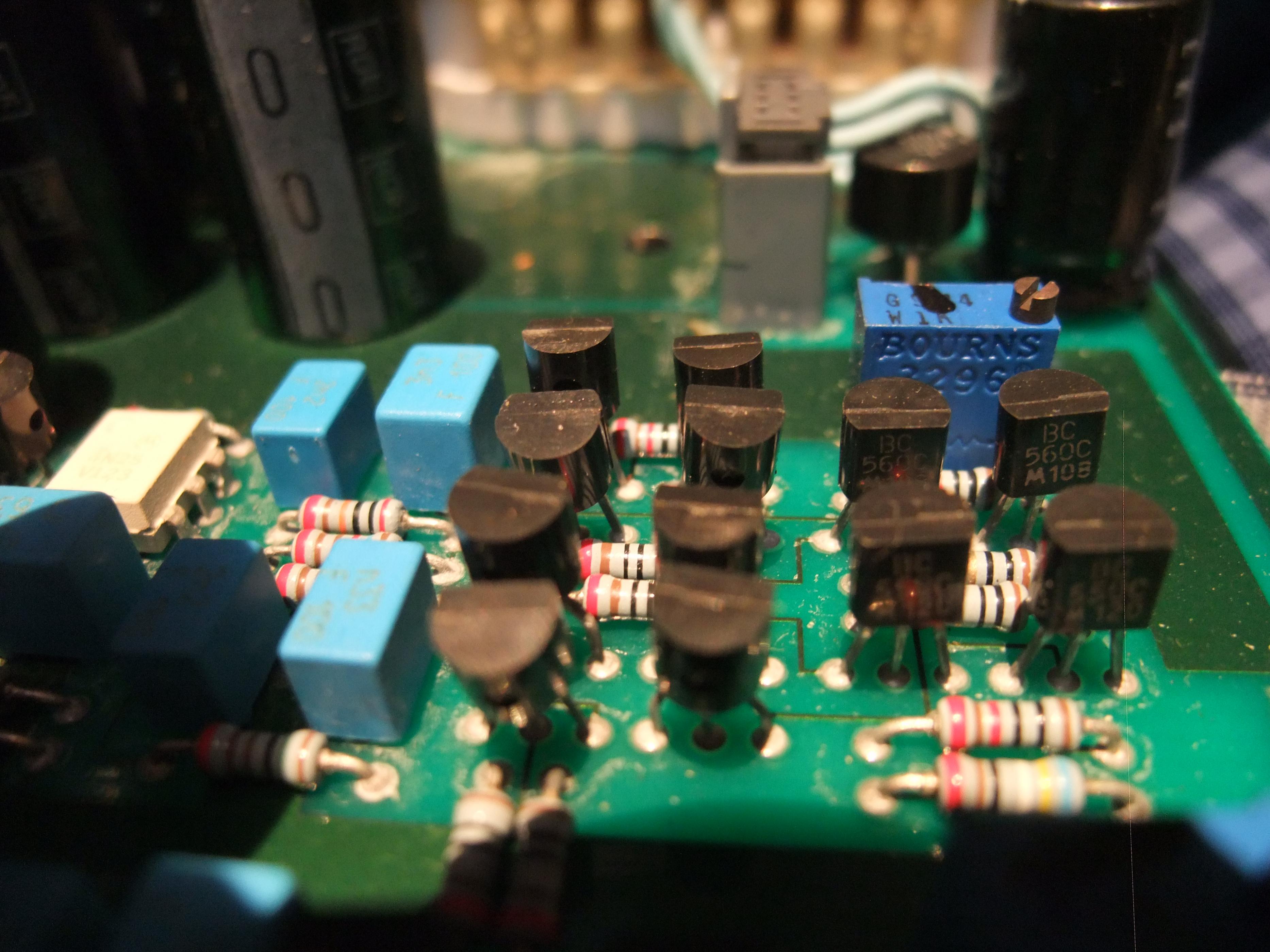

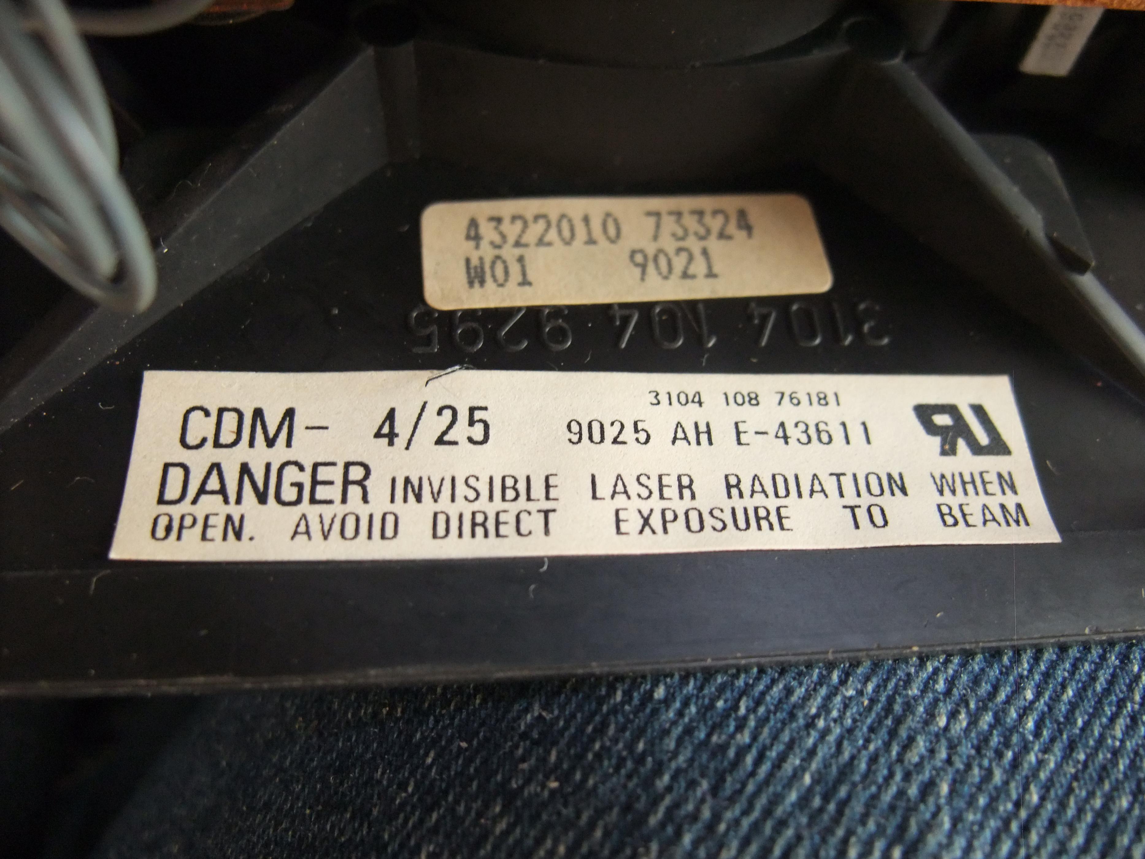

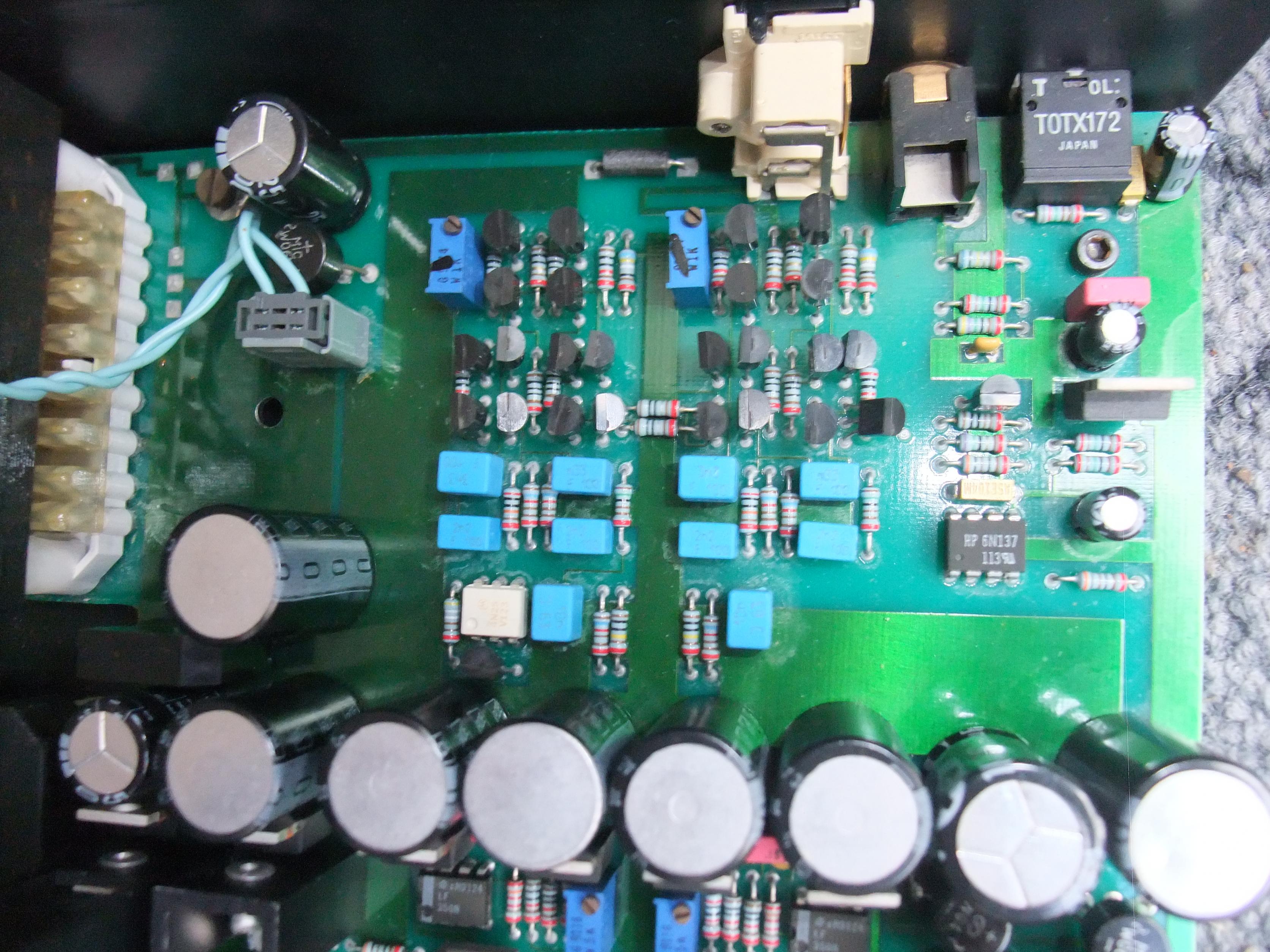

For electrolytic capacitor replacement, troubleshooting and creating schematic a device of this model was completely dismantled and disassembled. several images in follow first from the operating (front) PCB

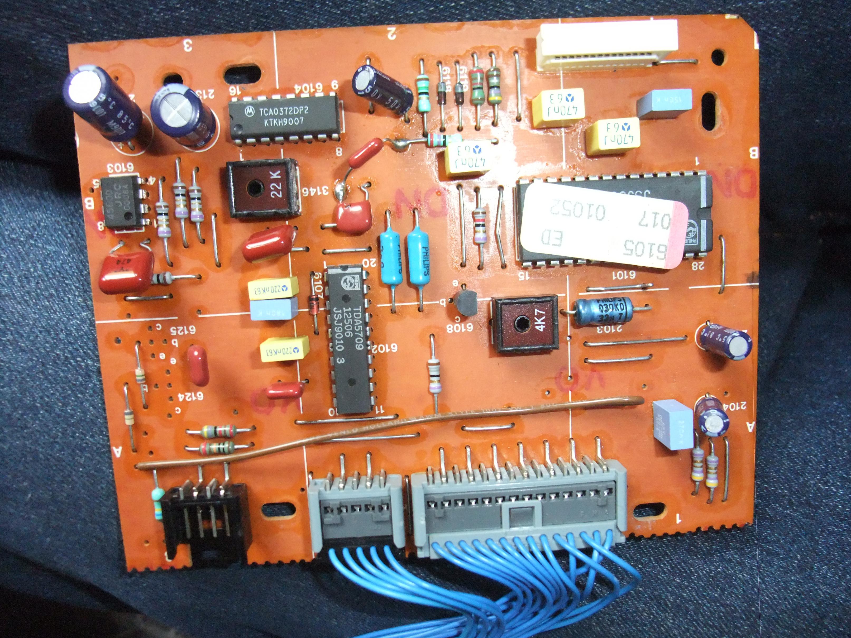

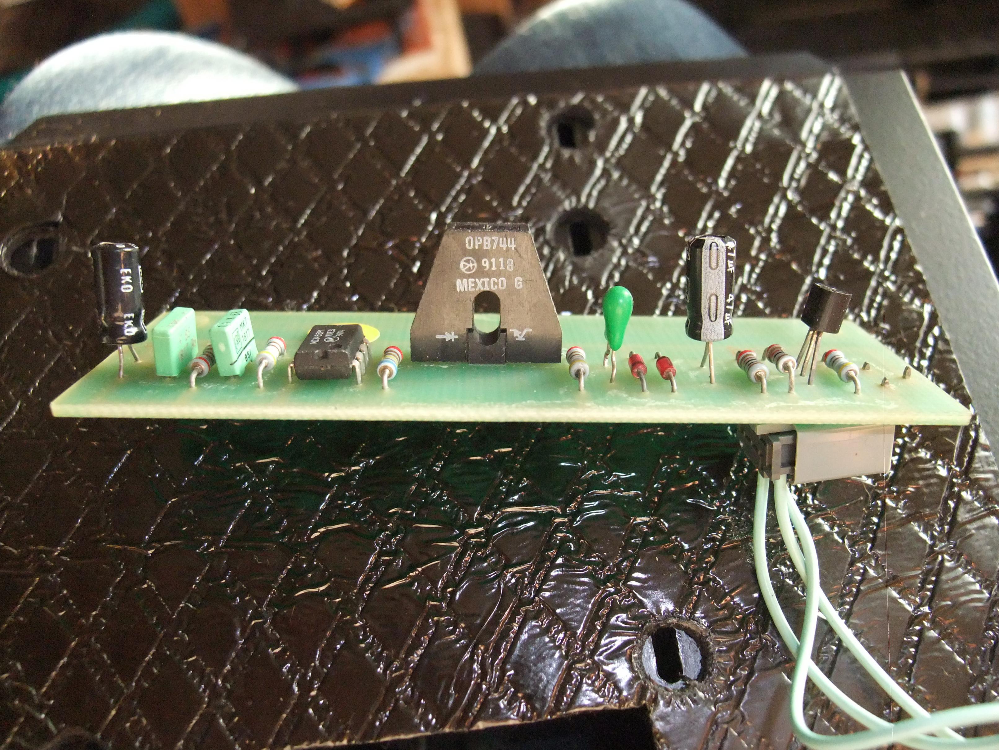

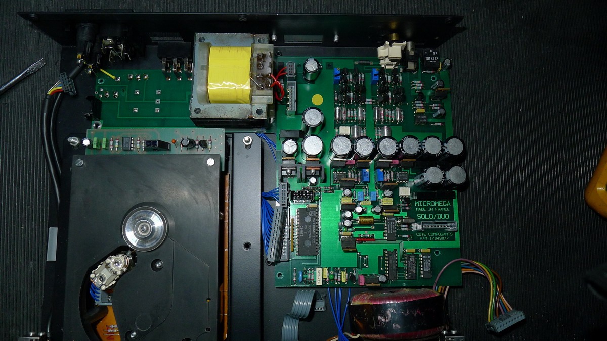

Who know the IR receiver module from image No. 6 ?
Looks similar to those under
https://www.vishay.com/docs/82459/tsop48.pdf

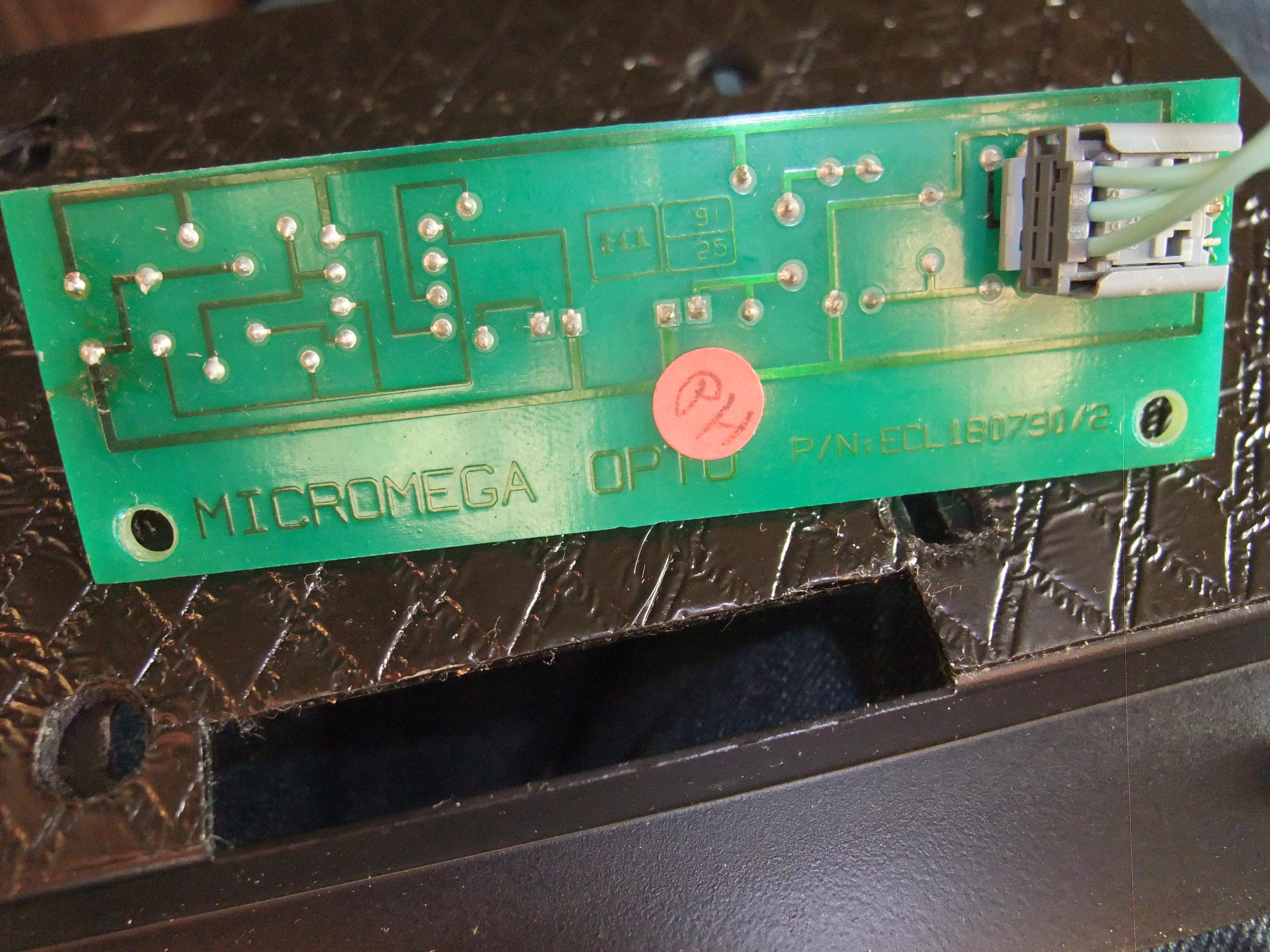

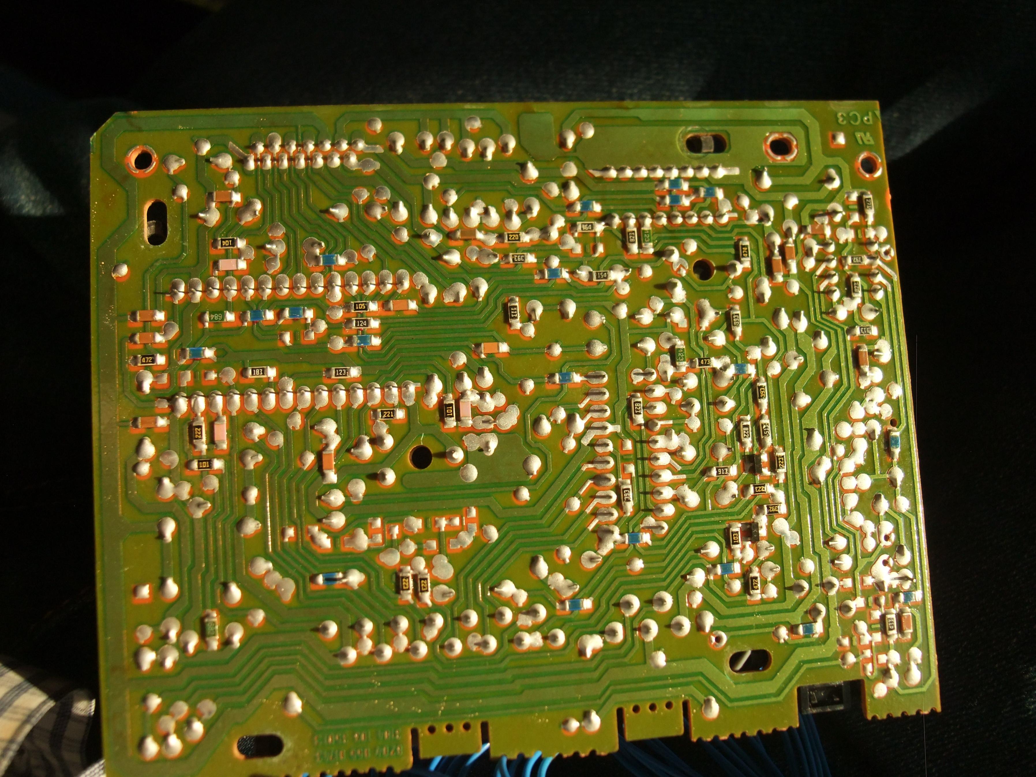

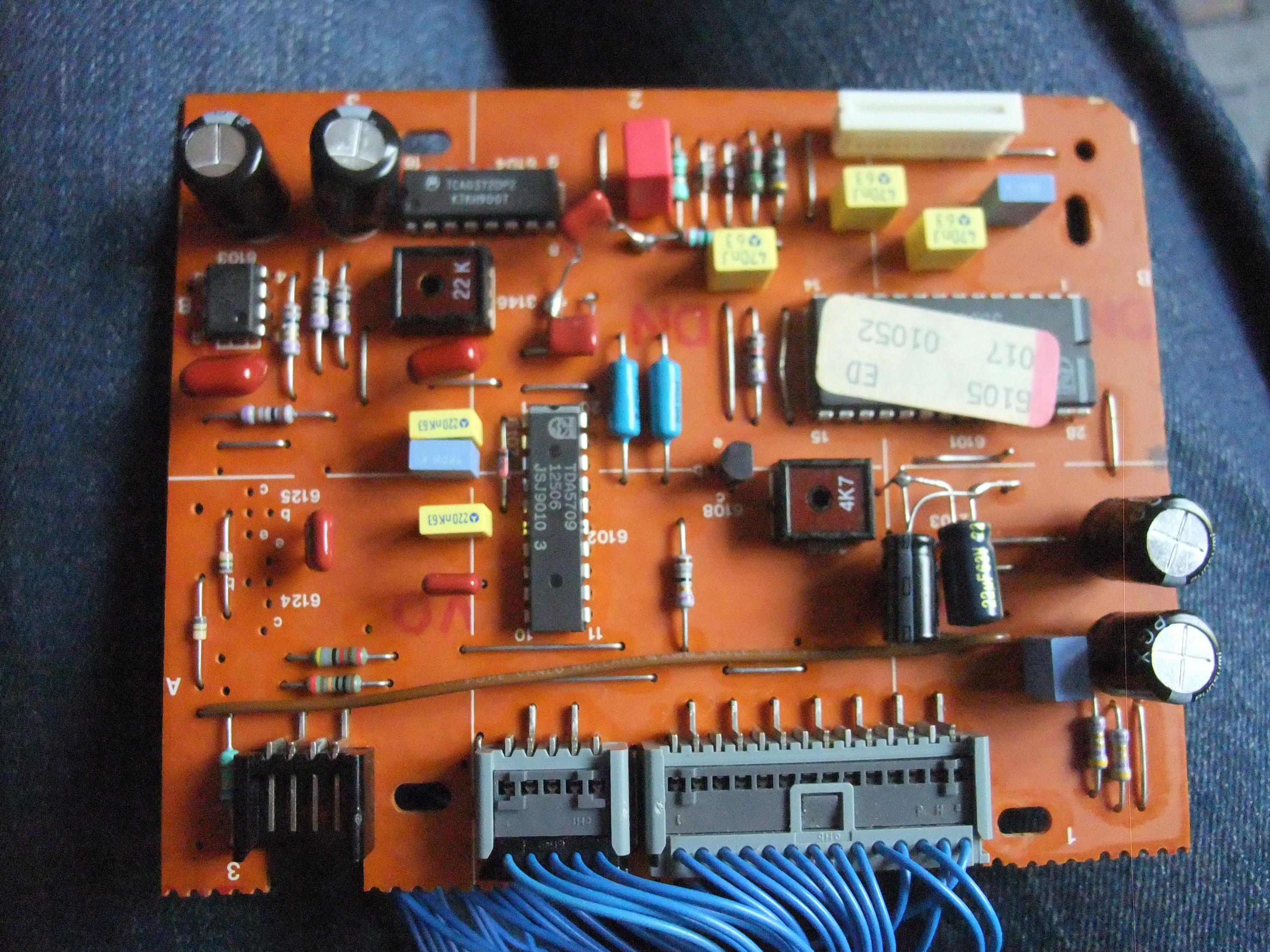

Servo-PCB, OPTO board

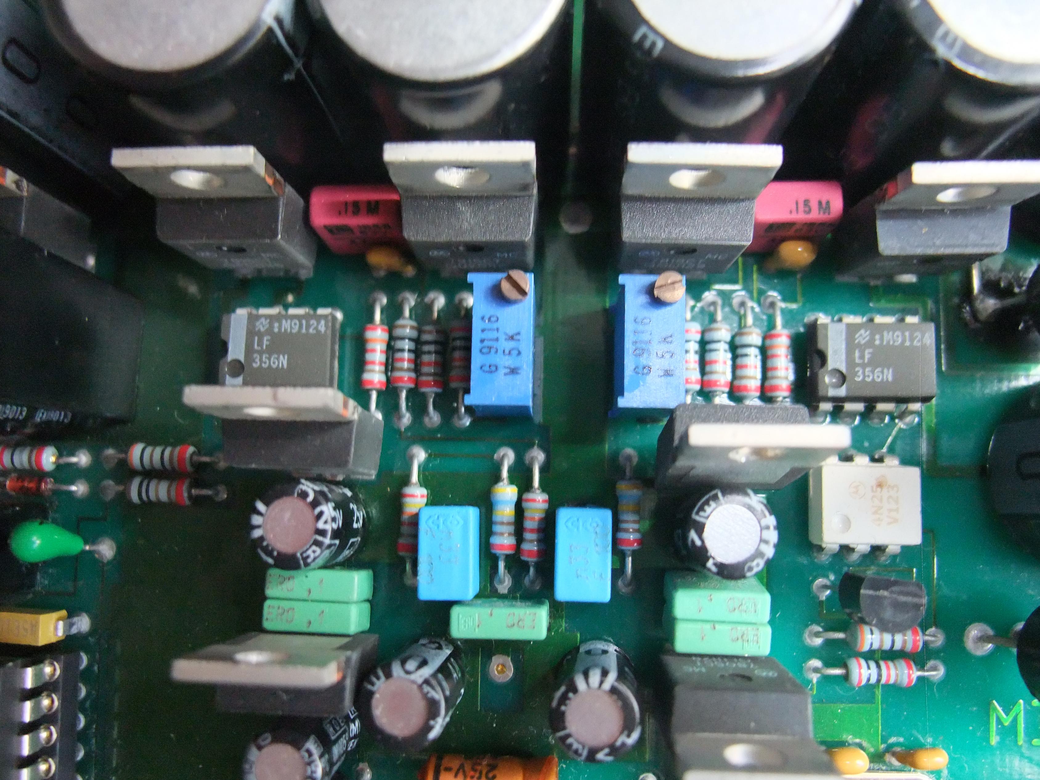

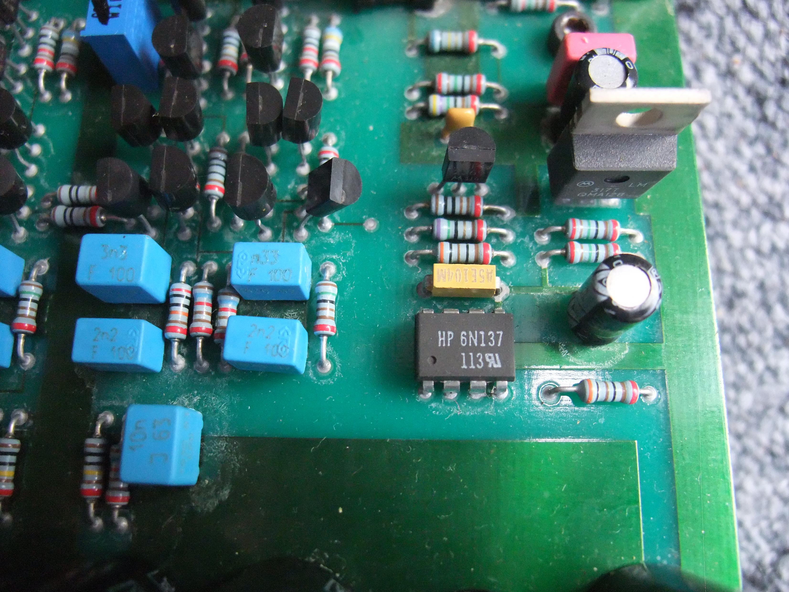

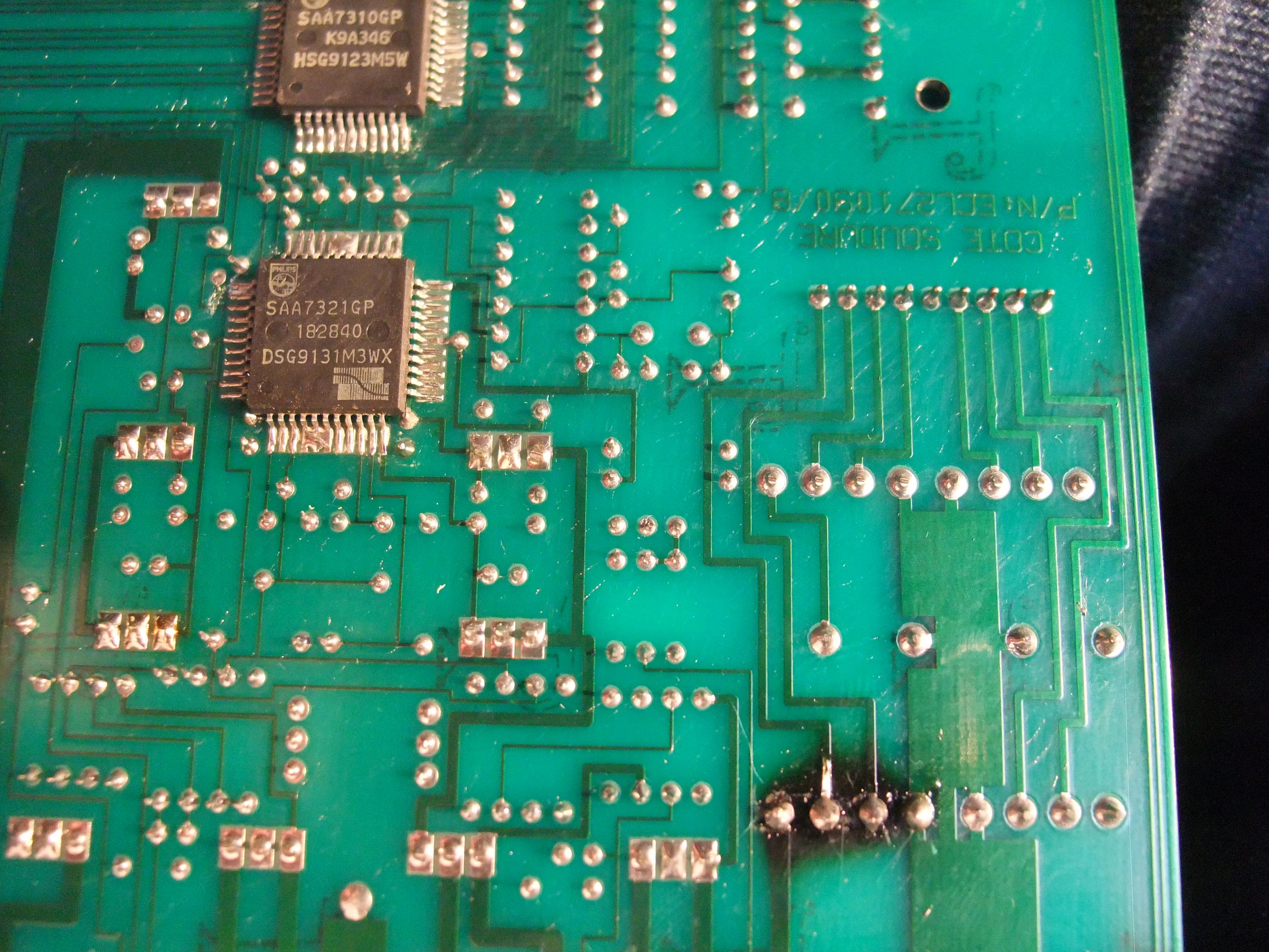

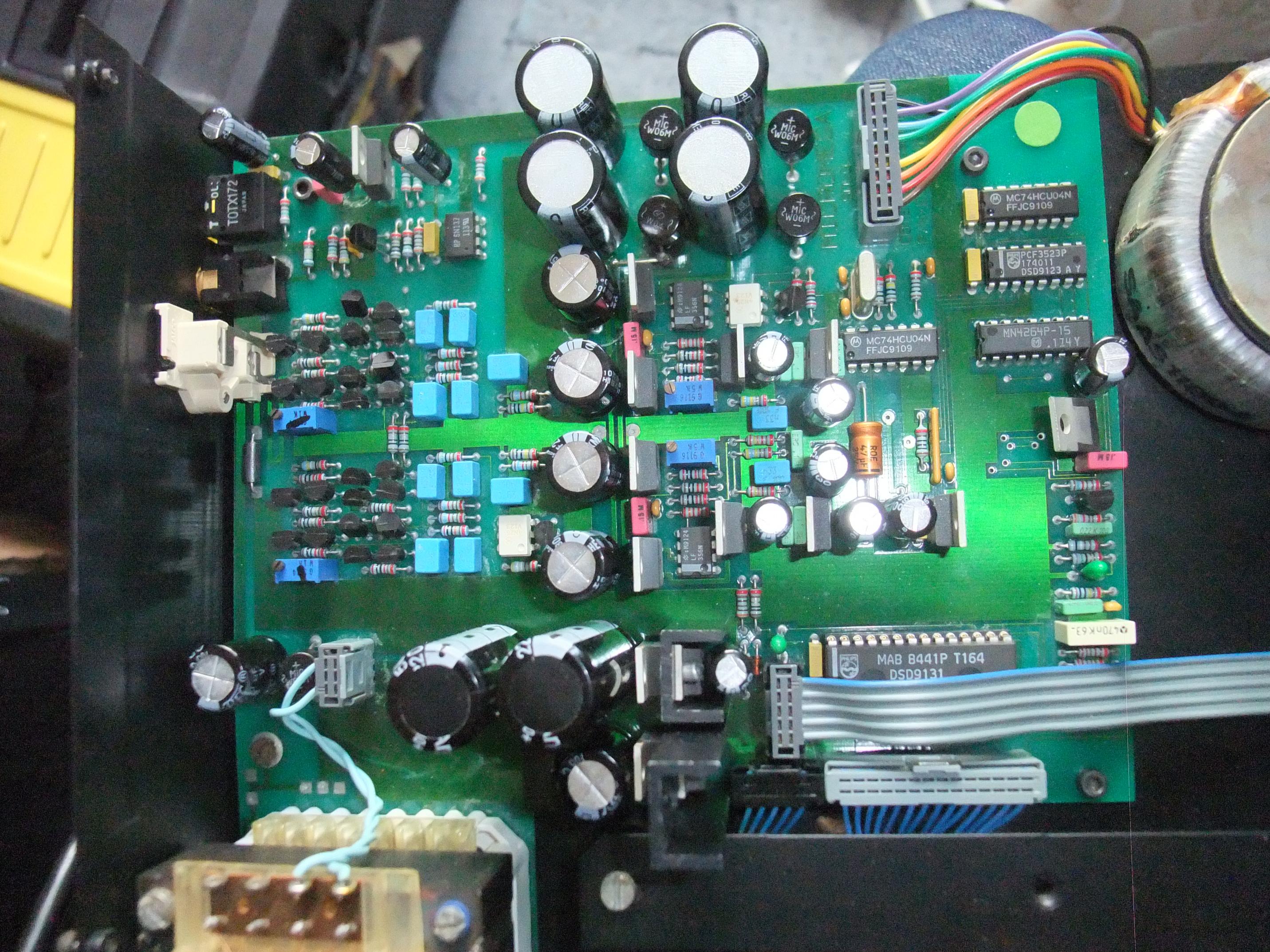

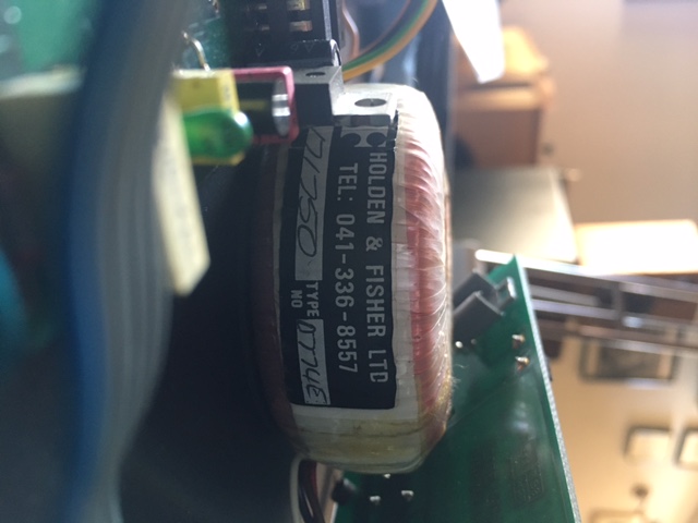

DAC and diamond buffer area incl. burned toroidal transformer for creating 4x 15VDC by voltage regulators 7815 and 7915
Who know the AC voltage (maybe 4x 16VAC) and the VA value so as the A-value of the fuse for primary winding (isn't present in the associated holder at back plate) ?
Thank you for an advice.

As a first attempt, my own circuit diagrams are present but still difficult to read and probably still have many errors. From an other friend I will receive a second device of the same model for preparing for an outdoor power supply. Then I will check the present sketch and make a second attempt for better reading and less errors (for upload here).

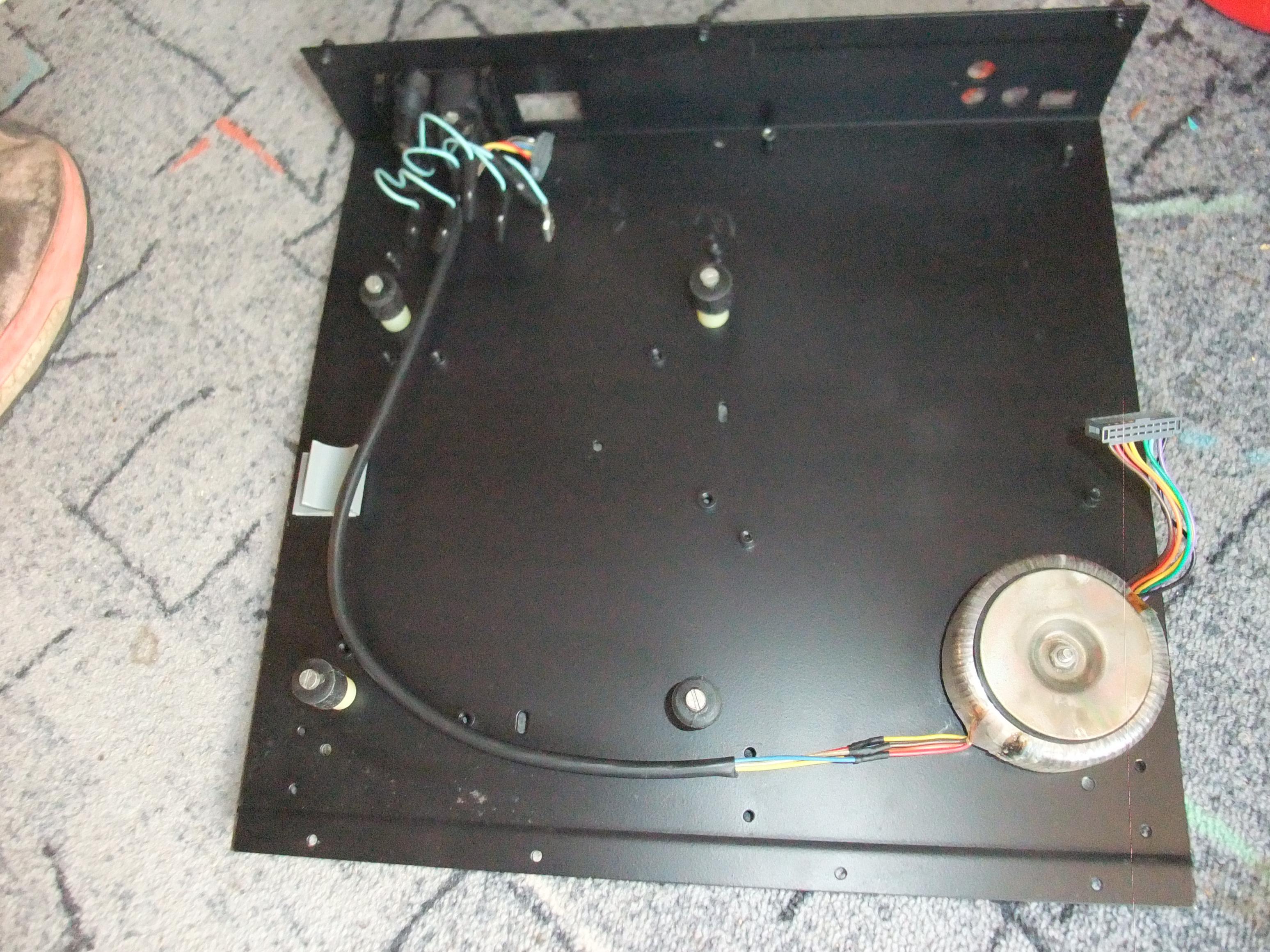

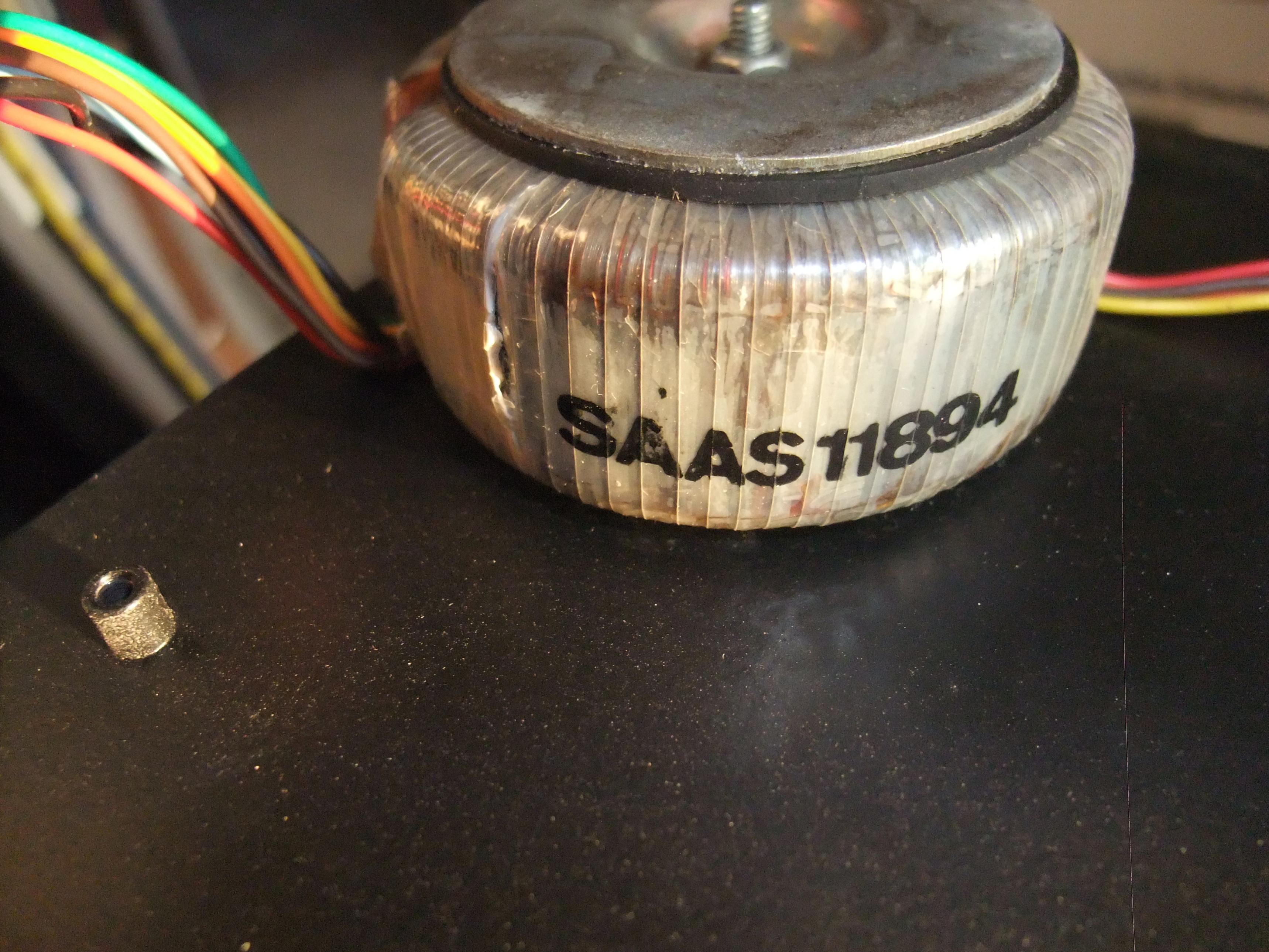

Toroidal transformer and fuses
The secondary of the toroidal transformer measures 4x16V: I can confirm it. I measured it right now. The two original fuses I have on my micromega are 2x 315mA / 250V
good advice - thank you

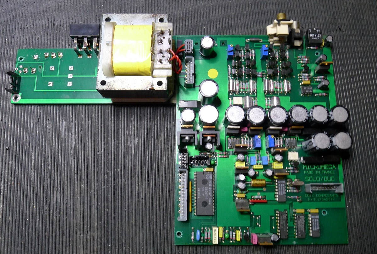

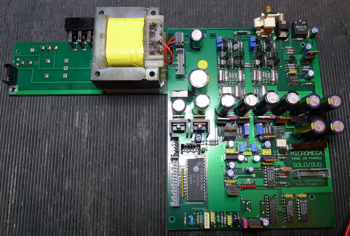

images from other device before and after replace electrolytics
