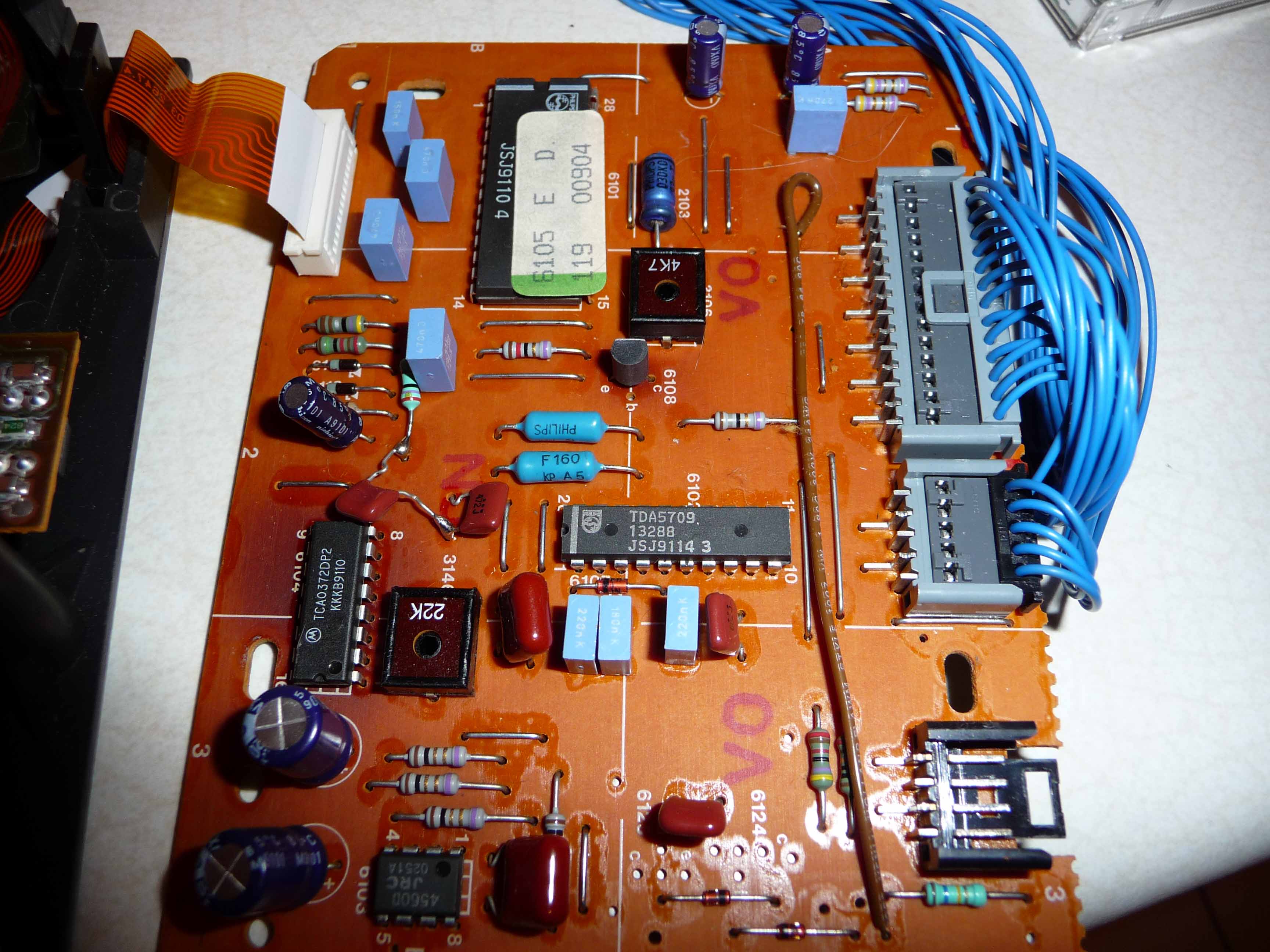

I have a Micromega Solo CD player which is not working. When turned on, it will start to rotate counter clockwise at first hesitantly and then faster. It happens with the lid open or closed ( a top loader) and also with a CD in place
I noted there is some slight vertical movement in the lens when it is turned on - but I cannot see the normal red glow on the laser when viewed from the side. Sometimes the laser assembly swings back and forth with CD in place.
I have noticed there is about 2-3 mm of vertical play in the spindle
It has a CDM4/25 transport fitted - I have tried cleaning the lens and checking all of the contacts. The 33uf cap on the servo board has been replaced - still it runs backwards!
I would greatly appreciate and advice and suggestions for sorting it out!

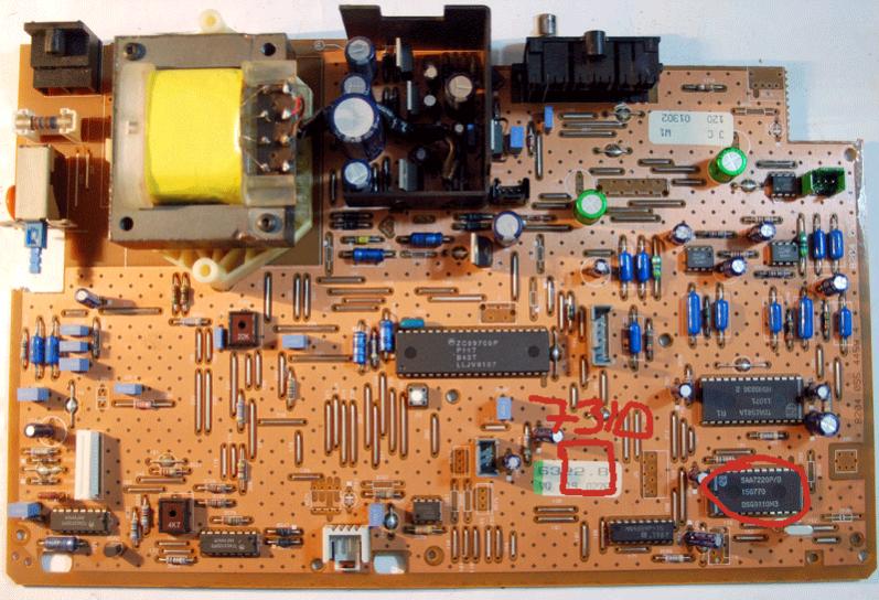

look close to the dac chip, 7220 and 7310 will be there.
I know when 7220 not working then the player just spining fast.
I dont know if it related with your problem though.
This is a Marantz cd40 just to show were you find the chips.
The 7310 is at th bottom.

They should be on the main board, not the one from the transport. If the powersupplies check out, it will be hard to fix it without a scope.
Thank you for your help - I will have a closer look to identify them. I will have another search to see if I can find a circuit diagram!

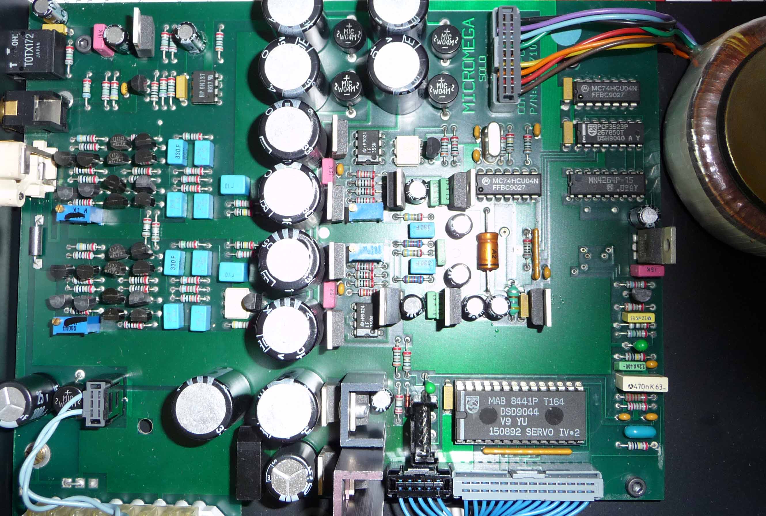

Micromega Solo Schematic
I have tried to find a schematic of the Micromega Solo and have not been able to locate one which make sorting it more difficult.
I would appreciate it if someone has one or who knows where one might be located!
I have attached a pic of the main board - has anyone seen one before? the chips do not seem to ties up with those mentioned

The large chip in the bottom is the decoder microprocessor. That's there.
There is no dig filter / dac; seems to be a transport only.
There is a memory chip on the left; MN4264. Usually used by a decoder.
So i'm guessing that the SAA7310 SMD chip is on the underside of the pcb.
The clock seems to be generated with the 04 in the middle.
The spdif out is made by the PCF3523.
There are more gizzmos visible, optocouplers and quite some powersupplies. Not easy to fix giving directions from here.
You need to find someone local who can figure this out. Should not be too difficult with the thing on the bench.

Looking at the mainboard I would say this is a full CD player, not just a transport. I can see what looks to be a very simple output stage and a pair of PCB mount RCA plugs at the back. If you flip the board over I think you'll find an SAA7310 decoder IC and probably an SAA7321 digital filter and DAC IC. I'd guess at this DAC based on the simplicity of the output stage (the SAA7321 has onboard I/V and buffer stages, no external opamps needed) and because Micromega used this DAC in other contemporary players.
I'd agree with Guido about the problem, though I'd be less specific. Loss of motor control is usually due to a fault in the decoder block. I've seen this problem caused by a loss of clock, a failed decoder IC and a failed motor driver. I'd start by looking closely at all three of these things, but unless you're experienced at troubleshooting these types of devices that's going to be very difficult.

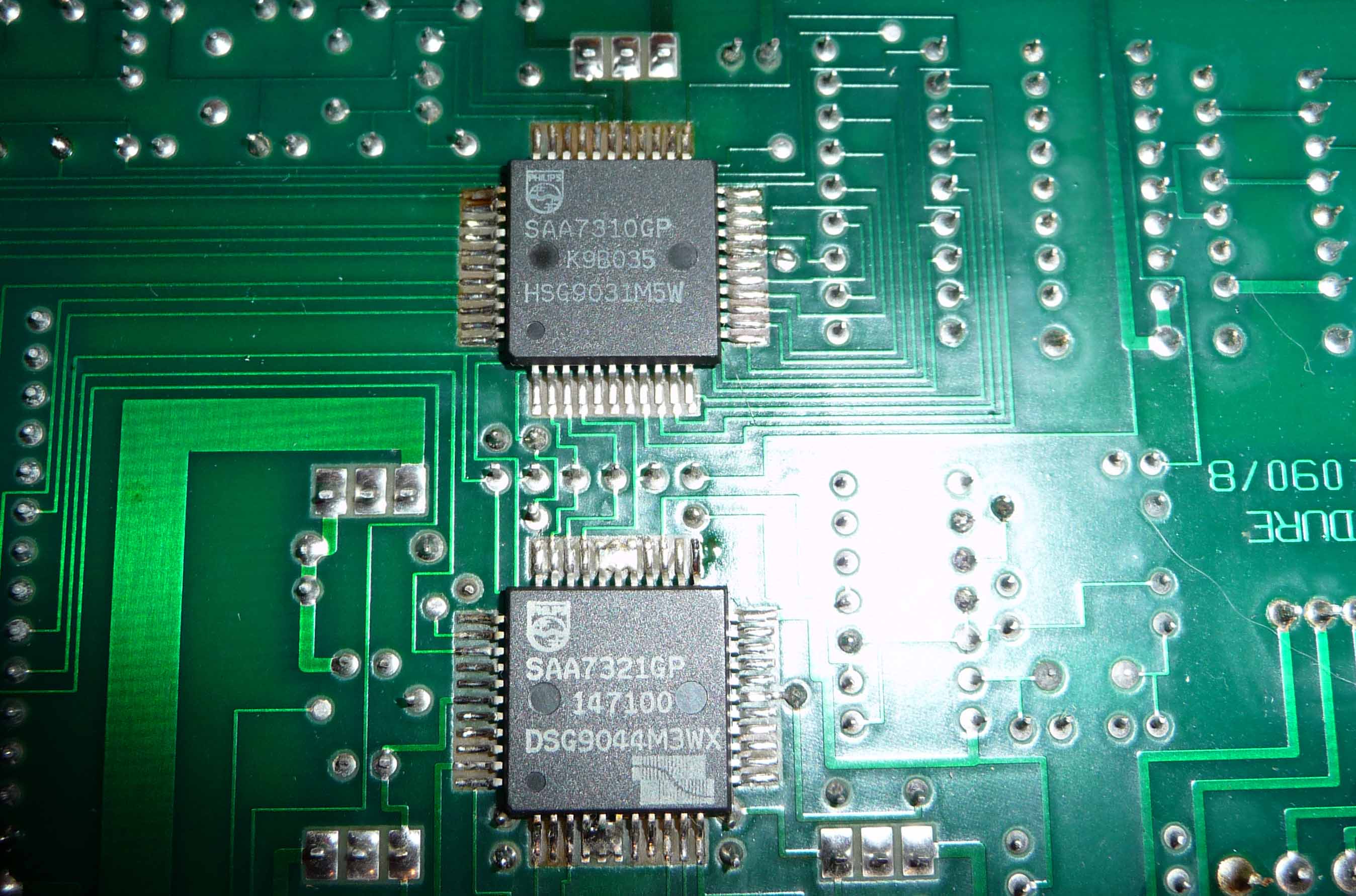

Thanks to you all for the advice you have given - there are 7310 7321 on the underside of the motherboard !
Sadly I do not have the equipment, knowledge or eyesight! to identify and rectify the problem.
