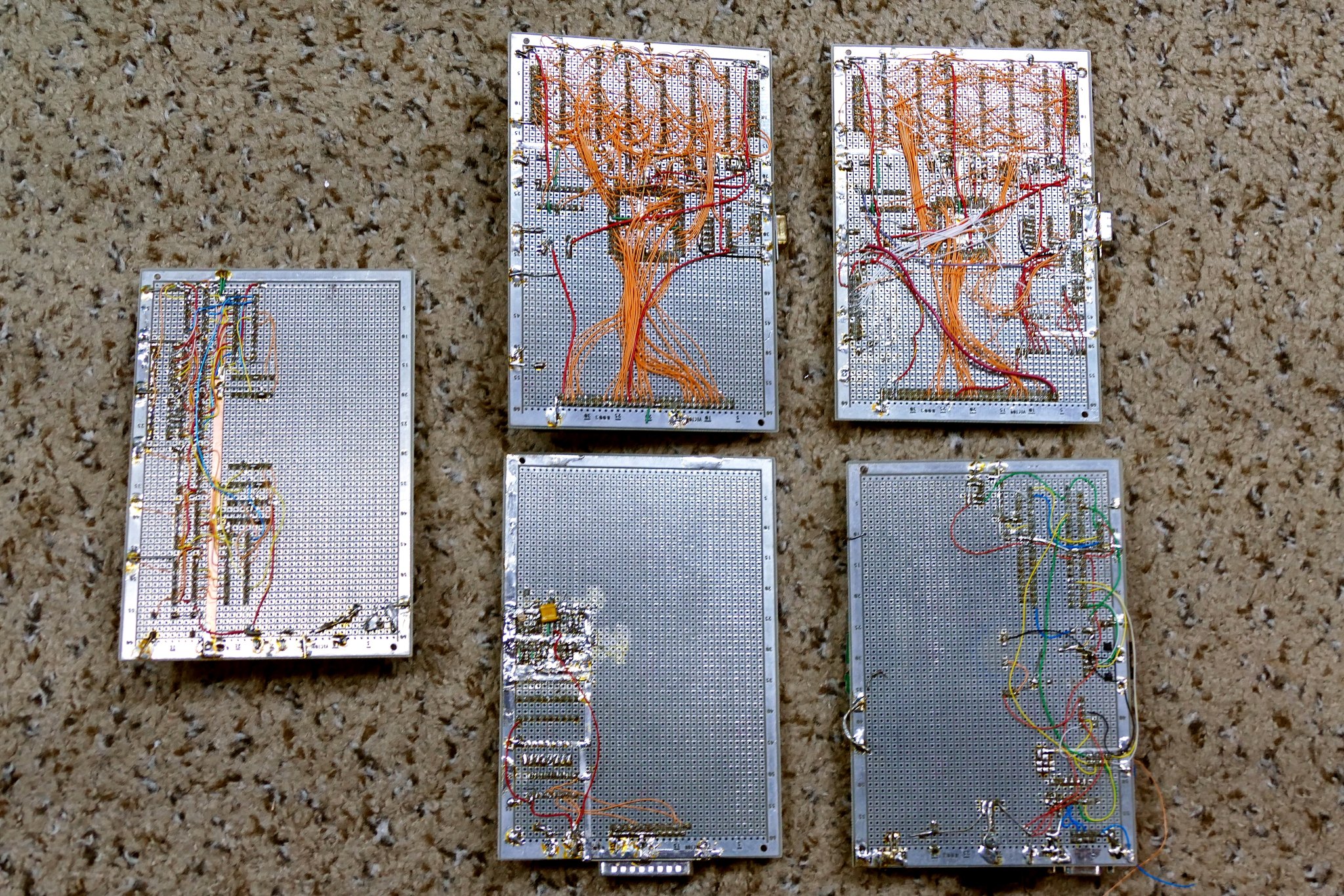

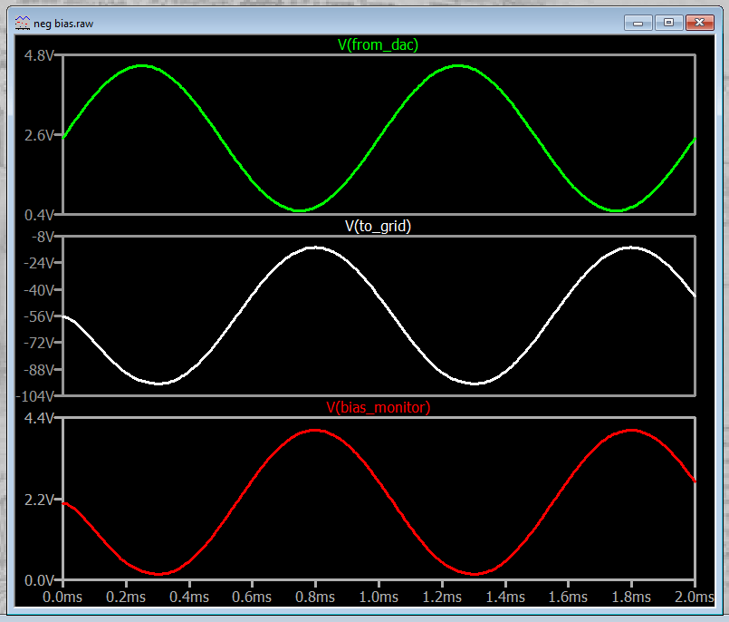

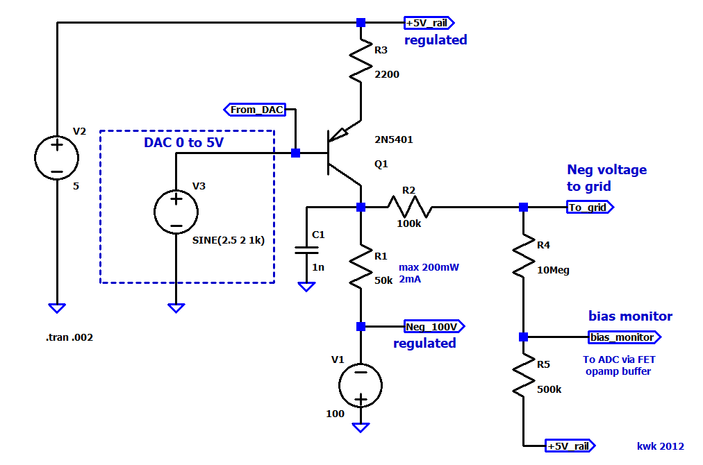

Bias of all six vacuum tube stages was generated with DAC outputs and opamp level shifters, no motorized pots needed. That stuff worked good, and I would have no issue with starting from that point with a Teensy or even a PIC chip.

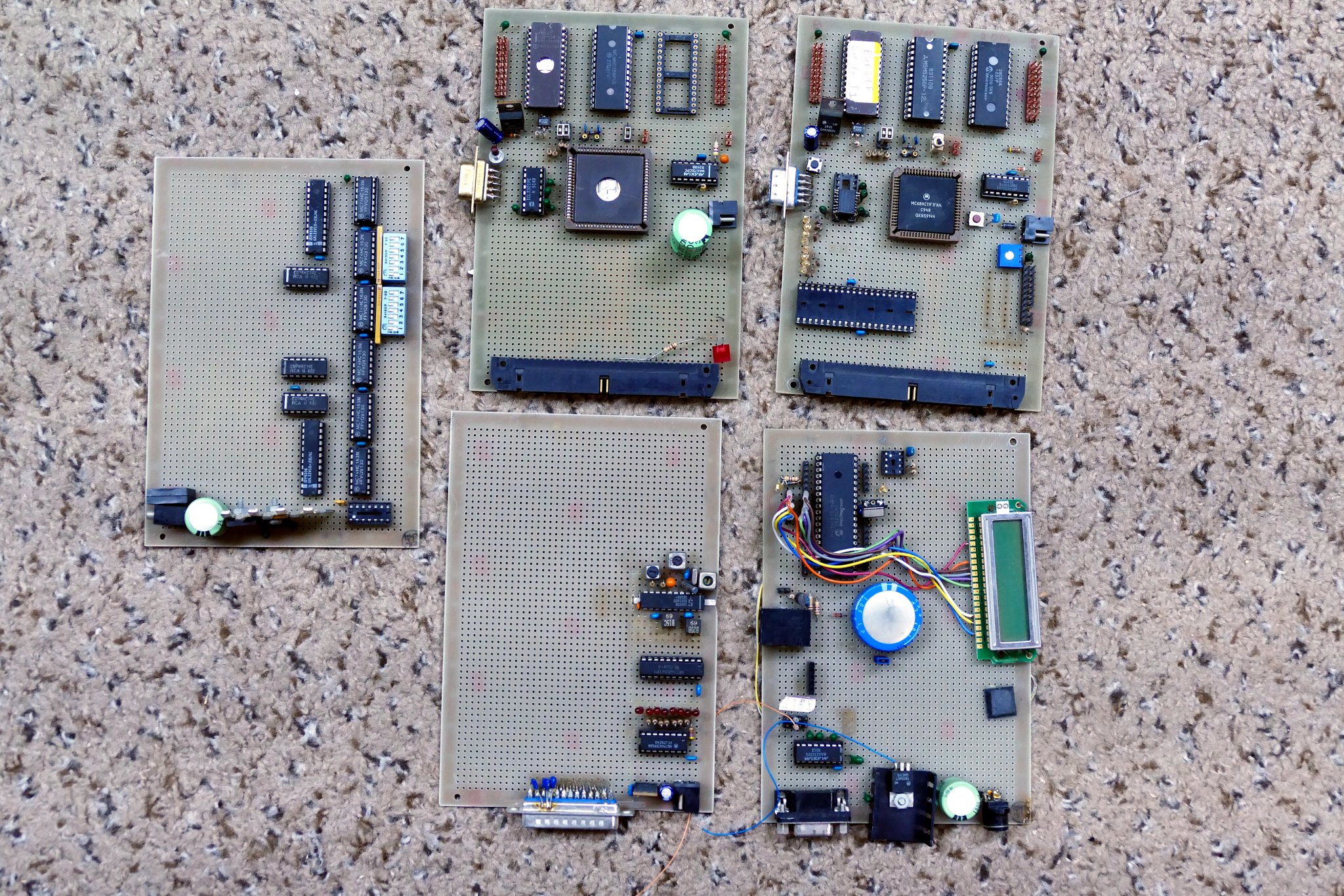

I found the actual circuit boards that were in the Circuit Cellar amp. They were tossed in a box full of miscellaneous circuit boards that were in my lab in Florida during a "we have 3 weeks to get out of a house we lived in for 37 years" moment.

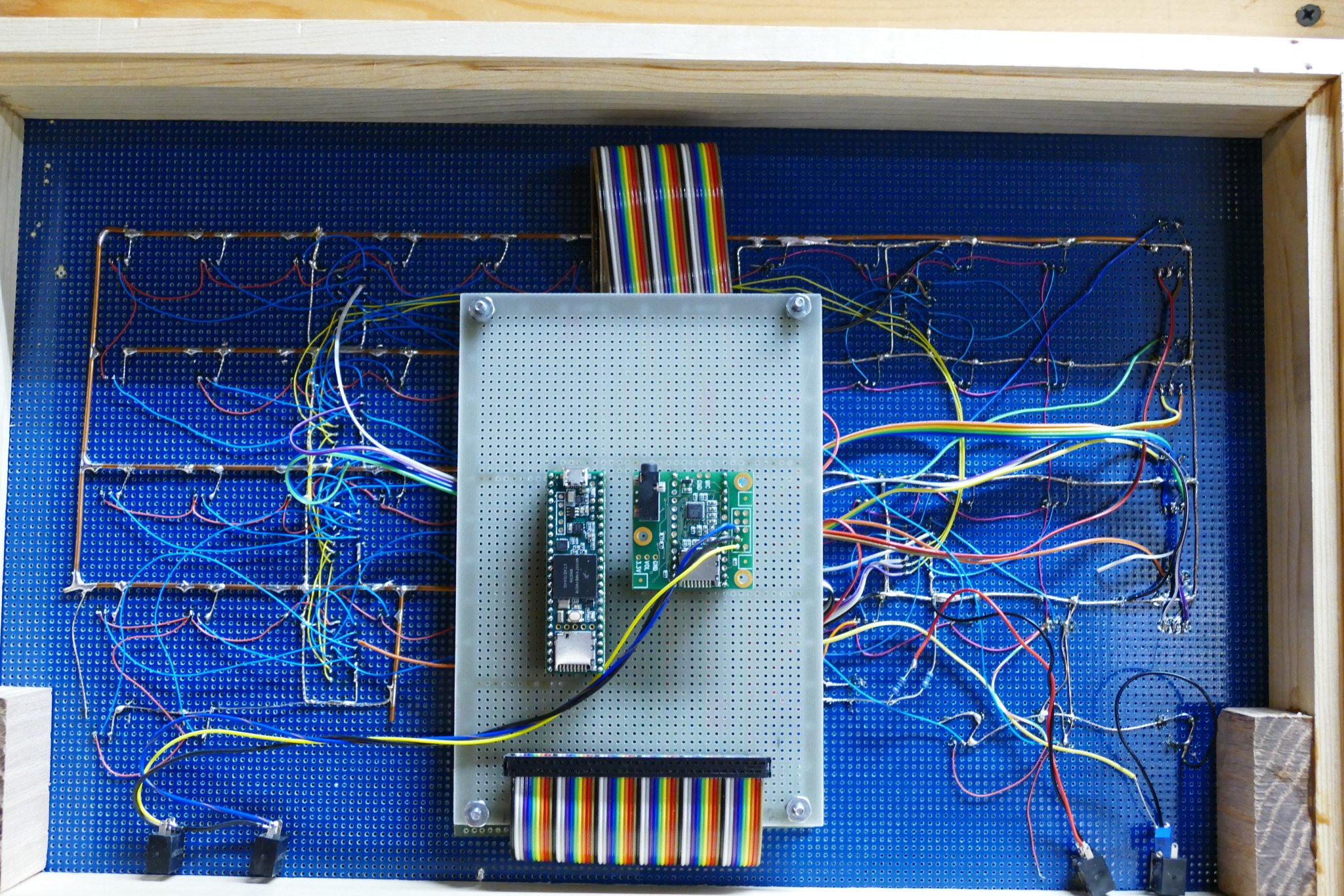

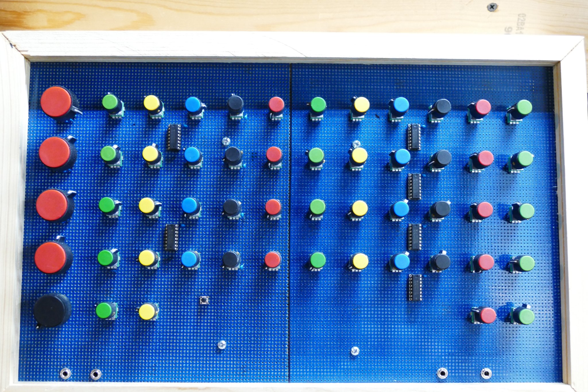

The actual Teensy control stuff is not yet completely defined yet, since the stuff being controlled is still being investigated. I will likely include the usual 12AX7 circuits with selectable parts or other means of changing the voicing, but I am also working on a couple ideas that haven't been seen yet, and I'm not afraid to mix silicon and vacuum tubes where it does something useful.
I envision at least two complete preamp paths, one following the usual FMV (Fender, Marshall, Vox) circuitry and another made from totally unique circuitry that I'm working on.....hint. no 12AX7's. Part of the microprocessor control stuff will be the ability to swap individual gain stages in and out of each path.
