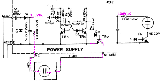

I am searching for a strobe light for my Micro Seiki DDX-1000. According to the parts list part designation is "NL-77". I was checking the archive of this forum and it looks like that this part is NLA. Does anybody have an idea how to fix this or even found a new source for this neon light? The light is internally pulsed so a direct hook up of the light to line voltage and -frequency is not possible here.

Remove the resistor from an ordinary neon lamo, and replace it with a lower value, that is enough for you to use it in the turntable.
Regular neon lamps need 60-70 volts, the drop from mains is done by a series resistor, which also acts as a current limiter.
So check your circuit, maybe the resistor is still fine.
If not, replace resistor with same value.
Or change to a bright focussed LED...

NL77LA may be scarce, but the basic NE-2 is still available.
https://www.amazon.com/s?k=neon+bulb
Yes, electrically it is "just a neon". The schematic is drawn to confuse, but it is a 130VDC source, a 22k resistor, a neon, and a transistor to make it flicker.
