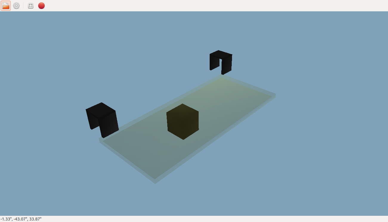

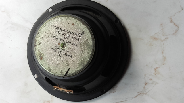

Components and layout
I intend to use the Radio Shack woofers I have, listed as having a frequency response from 50 to 6,000 HZ.
The basic layout of the system is shown below (Wings 3D). The subwoofer will be attached to the underside of the desk, out of the way, and the FR speakers will be added on either side of the desk on the wall or mounted on a stand on the desk. They will be open baffle.
