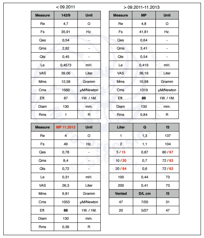

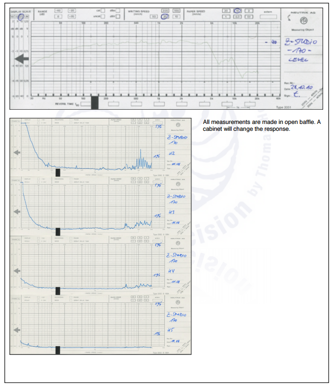

No xmax stated and recommended filter at 63hz? Even if they were $400, no thanks.
IMO, this driver will pair well with Beyma's AMT: https://www.madisoundspeakerstore.c...s-excel-w22ny-001-e0045-8-nextel-cone-woofer/
The FR does not rise nearly as much as shown in SEAS's schematic. Very smooth response and low distortion till 6K as well.
