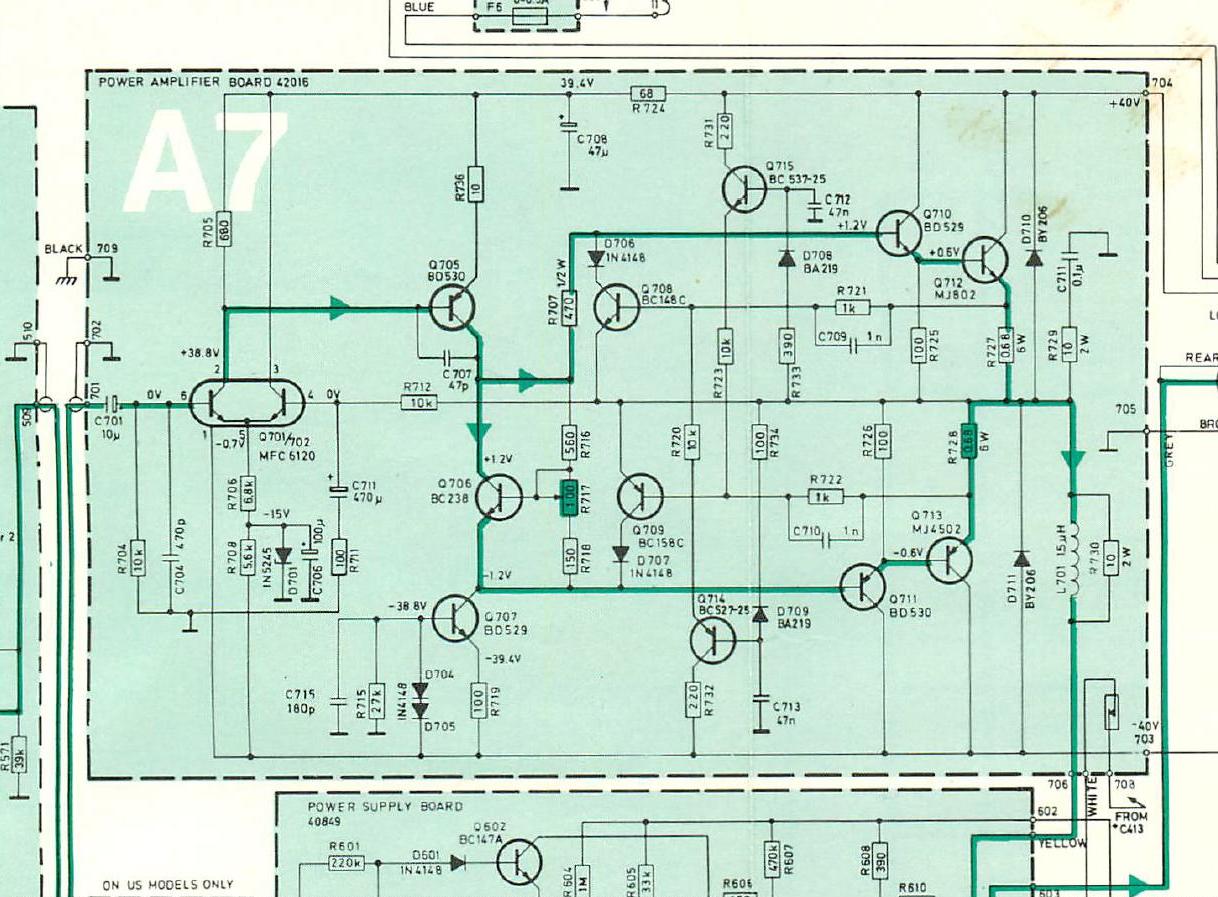

Please analyze the following SOA concept used in old Tandberg TR1040.
Thank you, Victor
Thank you, Victor
Wouldn't recommend it.Please analyze the following SOA concept used in old Tandberg TR1040.
Thank you, Victor

Please , i'm interested in a mathematical example true circut protection SOA (universal) to protect the real world real output stage of a Class AB amplifier fed to
1) + / - 50 V with two pairs of transistors end power
2) + / 60 V end with three pairs of power transistors
3) + / - 70V with four pairs of power transistors end
4) + / - 85 V, with six pairs of power transistors end
5) + / - 100 V, with eight pairs of power transistors end
Heatsink will be in the worst case temperature 90 Cesius degrades due to optimum dimensioning and active cooling with fan brushless using transistors 2SA1943 end type / variant 2SC5200 or second choice MJL21194 / MJL 21193 (if needed number of transistor pairs final could be reduced by appropriate neccesary ), active duty with at least 60 degrees phase shift between the current through the load and tension.
Thanks in advance, Victor

Hi Victor,
Just read the article carefully from start to finish and you should be able to design your own SOA protection circuit without difficulty.
I suggest you buy the Texas Instruments TI-89 calculator to help you solve the simultaneous equations that arise. It's what I use.
