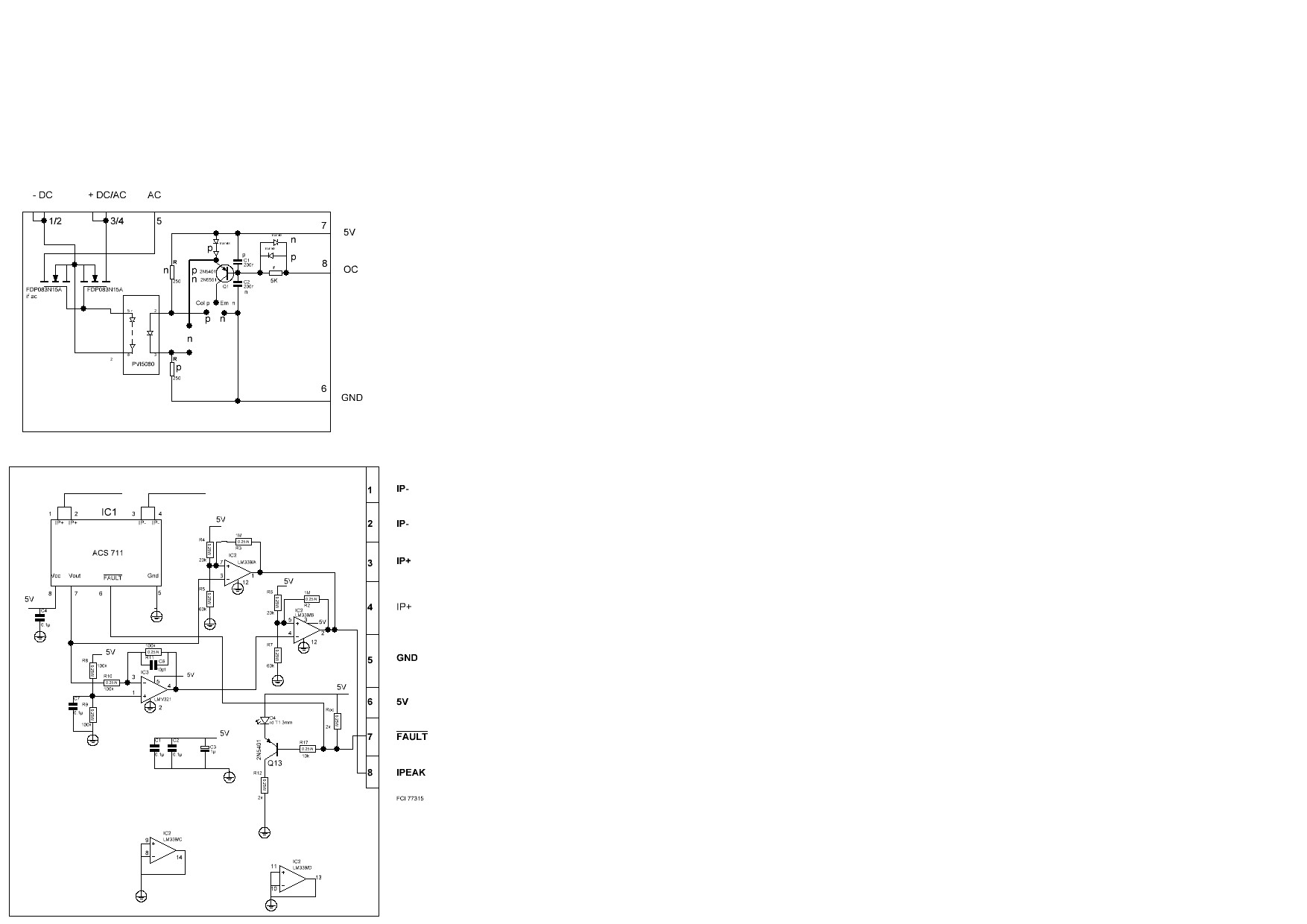

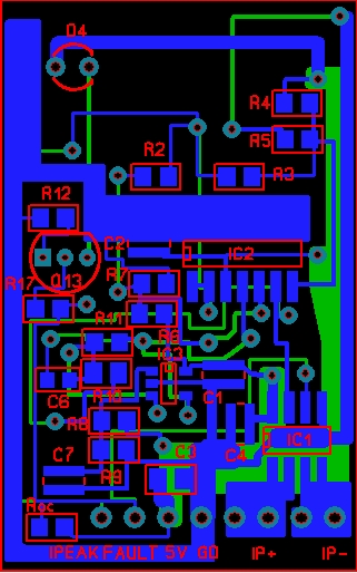

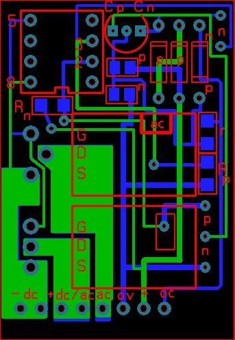

I have implemented and tested open circuit on full power 50V on 4 ohms with a short circuit on the 4 ohms, only a small spark on the shorting wire; Works great.
two circuits on switch (with pnp or npn logic and dc or ac capabilities) and one short circuit detector with latch
Can you describe what your circuit is supposed to do and how it works?
The top circuit in the schematic is a mosfet switch that can be used in serie in each power supplies (+/-) of the amplifier. It is also able to swich AC signals, then two mosfets are used. pnp or npn command can be used.
The bottom circuit uses an IC that transforms ( by hall efffect) current in analog voltage. This Ic has a preset current value that will operate the fault output pin and will latch it until 5v is reset. An Ipeak output is operated by the comparators if a current value preset by the comparator résistors is crossed. This output is not latched.
The circuit is used as a short circuit detector at the output of an amp and drives the mosfet switch circuit described above to open the dc power supply. Ipeak is also sent to a supervising microcontroller to activate a monitoring led
Then it was quite easy to integrate all needed protection(it is not current limiter but current dependent current delayed fuse).
BR Damir
