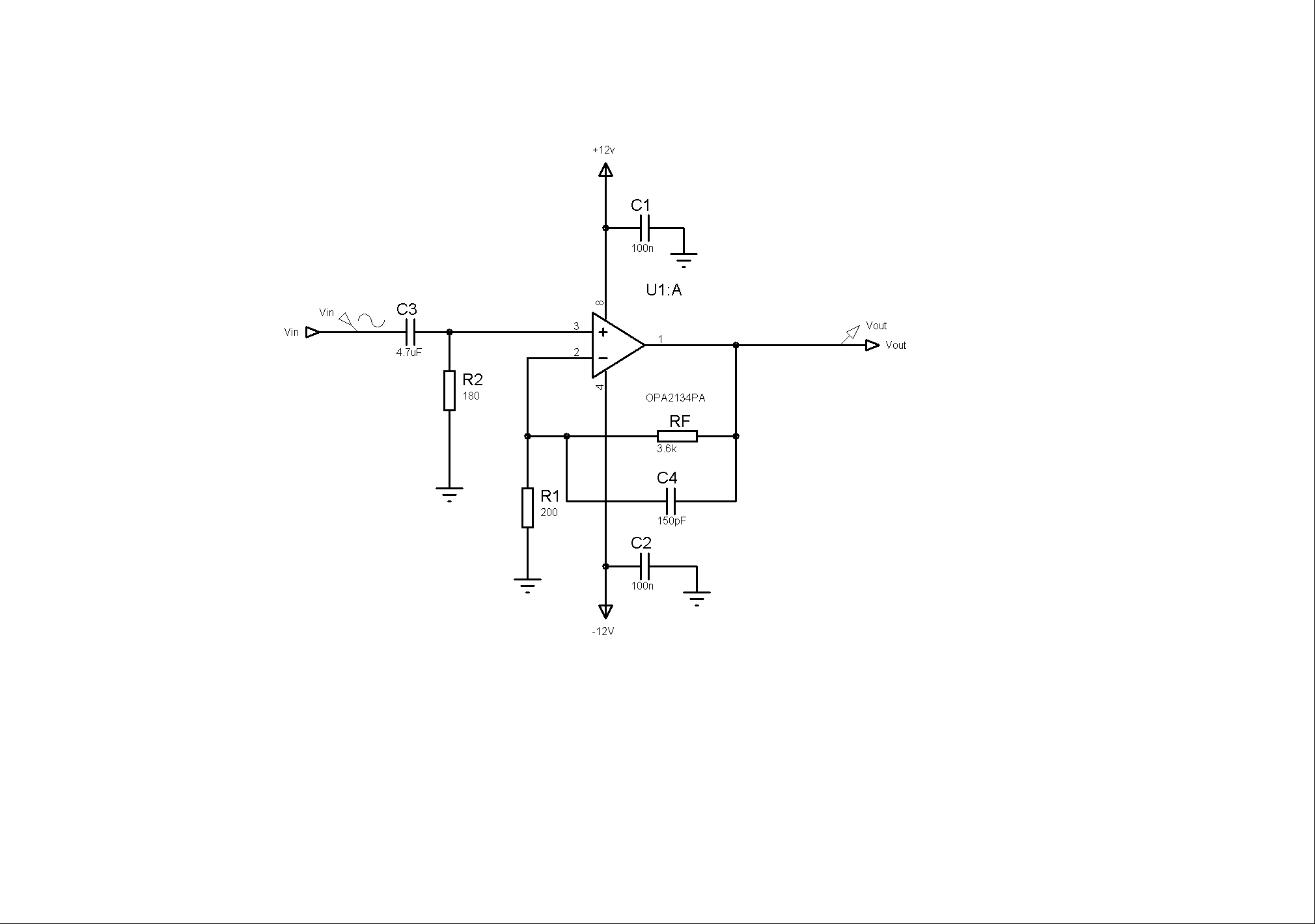

Yes I attached a repeated image by mistake.. attached is the schematic.

In your diagram R2 sets the input impedance. That means that any source component (microphone/cdplayer etc) sees that 180 ohm as a load across its output. 180 is extremely low.
I'm no expert on mics but there are two common types. Electret condensor ones which actually incorporate a FET transistor buffer and Dynamic mics which are just like a speaker or headphone driver but operated in reverse.
I think somewhere round about 1K ? is a typical value for an input resistor for a dynamic mic preamp and for a FET mic I would say more like 10k or higher.
Thats something you need to look into and specify what type of mic is going to be used.
With a FET opamp such as yours there is no need to "balance" the input impedances as seen by the two opamp inputs because there is essentially zero current flow into and out of these terminals. Its in the pico and below amp range.
If it were an opamp such as the 5532 then it would be essential to balance these to minimise the DC offset shift caused by unequal input currents. For a bipolar opamp these could be in the micro amp range... many many times larger than the FET one.

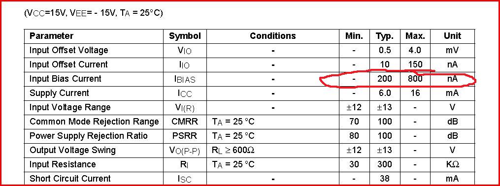

Look at this from a 5532.
Worst case and the input bias current is 800nA.
That means that 800nA could flow in the input pin connection. Imagine if R2 in your circuit above were 100K.
Using ohms law that 800na will develop 800e-9 *100e3 which is 0.08 volts. Nearly a tenth of a volt. If R1 in your circuit were left at 200 ohms then 800na would develop only 0.00016 volts.
So we have approx 80 mv imbalance at the input of the amplifier. That means that in order to bring the difference at the inputs back to zero the amplifier output must settle to a high DC voltage (an output offset voltage). That voltage of course depends on the feedback factor... the ratio... of the feedback network.
The FET opamp eliminates this problem entirely as there is no DC current flowing in the input pins to cause this offset voltage.
Hope that makes sense.

From my reading, most dynamic mics have an output impedance of 300-600ohm. It is generally recommended for the mic pre input impedance to be 5-6 times that. But, generally there is no issue with more and higher allows more usability with condenser mics. Higher also makes it easier to get lower bass cutoff with more reasonable input caps. At 180 ohm, I think you may be missing your assignment criteria, without going back to look at it.
