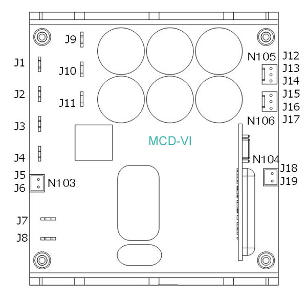

mcd-255 pins and funtions
Pin Function
J1-J3: AC Power input:
J1,J2: AC IN connect to the power transformer
J3: AC COM
J9-J11: DC power input or extension caps connector
J9: VSS , - Rail of DC power
J10: GND, GND of DC power
J11: VDD, +Rail of DC power
J7,J8: Speaker output
J7: speaker +
J8: speaker -
N103 : Extension 15V DC
J5: 0V Don't connect to GND
J6: +15V DC max cap 1000uF
N104: enable pin
J18: EN
open : power on
close to J19 😛ower down
J19: GND
N105:Balance input pin (use bb2134)
pin1: Pre-amp input +
pin2: Pre-amp input -
pin3: Pre-amp input GND
N106: volume control pin
pin1: Pre-amp output , to input pin of pot
pin2: Power-amp input , to middle pin of pot
pin3: Power-amp input GND, to GND pin of pot
Pin Function
J3: AC COM
J7: speaker +
J8: speaker -
N104: enable pin
J18: EN
open : power on
J19: GND
