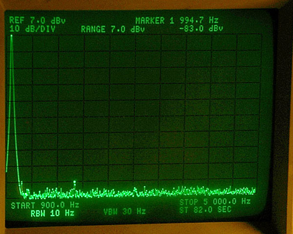

first is about 1w Distortion Spectrum
1w 6ohm 1k/7k/15k/ --3 pics
this is 1k Distortion Spectrum
2nd Harmonic-90db,0.0031%
3nd Harmonic-95db

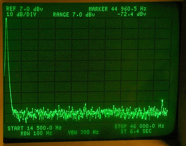

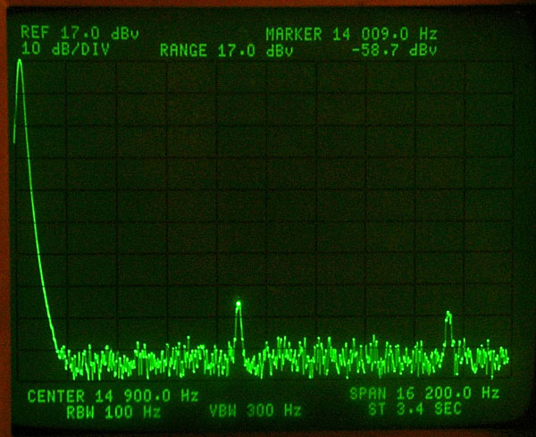

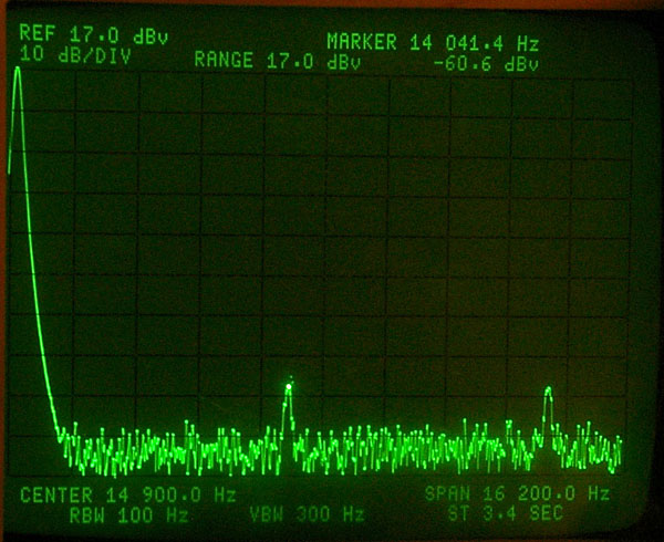

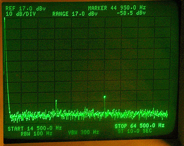

1w Distortion Spectrum at 15k
most of pdf not include 15k Distortion, because they will use a 22k or 30k bandpass filter between damp and tester.
we just con net the mcd to hp3585A, no filter .
so don't comparate this with other,
the Distortion of 15k is not true when connet a 22k bandpass filter (can be almost zero)
if they have a 50k bandpass filter that will be true.
2nd Harmonic: <-80db, 0.0099%
3nd Harmonic:-79.4db,0.0112%

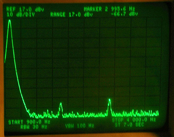

we use 5~15w in our most of time ,
a normal volume sound, not too high, not too low
this volume of this power range let us comfortable
so we test the 8w to 6ohm
1k:
2nd Harmonic: -80.2db,0.0099%
3nd Harmonic: <:-95db,0.0025%

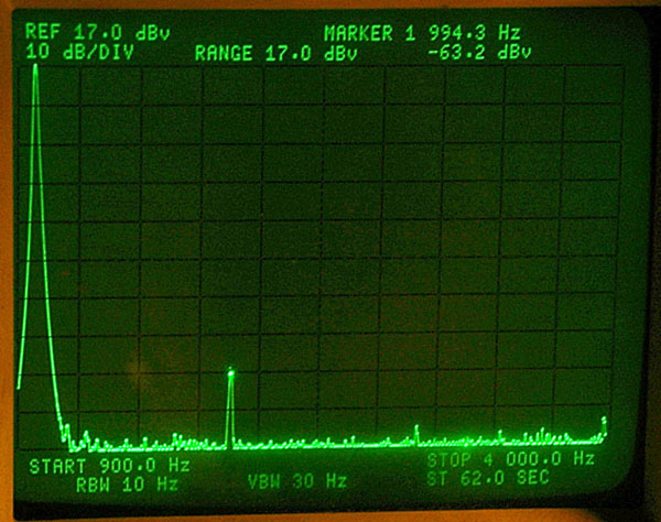

when a bass signal come in,
the power will raise very higher,
the treble of the sound are runing at a higher power range.
so the high power Distortion also very important in full range audio.
60w Distortion Spectrum at 1k
because the max input of hp-3585A is 42V peak
so we add a Attenuation(-10db),
so the output signal of the MCD is 25dbv(15dbv+10db)
2nd Harmonic: <-85db,0.0065%
3nd Harmonic:-81.5db,0.008%

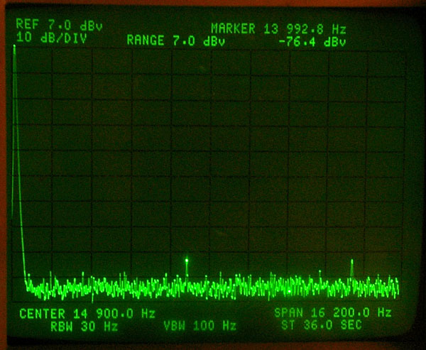

this is the 7k at 60w
all the 7k test is not the same time with 1k an 15k
most of time we just check the 1k and 15k,
because we found when the 15k is good the 7k also good too.
for some body can compared with others, we add a 7k for post.
the Attenuation here is -8db,
this is 7k Distortion Spectrum at 60w
2nd Harmonic:-75.5db , 0.016%
3nd Harmonic:-78db , 0.012%
all this test we use
HP-3585A Spectrum analysis for display
panasonic multiplex stereo modulator vp-7633A for signal generator
and just use transformer for power supply,
because we think,
most of people will use the transformer to power the mcd modules, so we need a test resume that not power by regulator supply.
and the pictures can let other to knowabout the detail of Distortion ,
anybody will get the Distortion of 2nd ans 3nd Harmonic of mcd.

Very good. Your numbers are impressive and appear to validate what you've been claiming. I'm just a little fish in the big sea of audio manufacturers, but I have full intent to purchase "a technology" that will fulfill my vision for the future of audio.
lumanauw said:
Hi, Fumac,
Do you use any notch filter or LPF for removing the carrier spectrum before entering HP-3585A?
What kind of filter do you use? Active? Passive?
I know that Audio Precission (AP) have a special filter for measuring classD amps.
In Post #83, Fumac states that there is no filter. I find this even more impressive.
