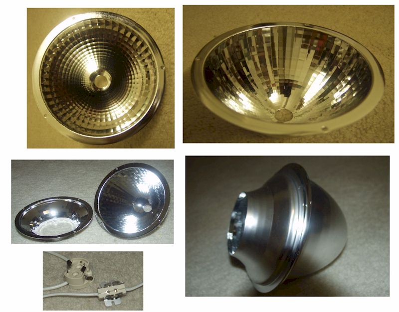

Finally, I got the reflector from the theater supply store. Its indeed a piece of art (see pics) has more than 700 flat mirror like surfaces and according to the literature can reflect up to 90% of the light. Its about 6 inch diameter and around the same height and comes with the cover with approx. 3 inch opening where the beam focuses.
They also had a glass reflector (same dimensions) which reflects all the light but transmit heat so that the bounced light is not hot -if this aluminum reflector works I might upgrade it to the glass one later. Glass reflector can transmit almost all the light and according to the theater people has a very sharp focused beam since it does not have small flat mirror like surfaces of the aluminum one.
Finding F1 for the elliptical reflector was fun. See the next post.

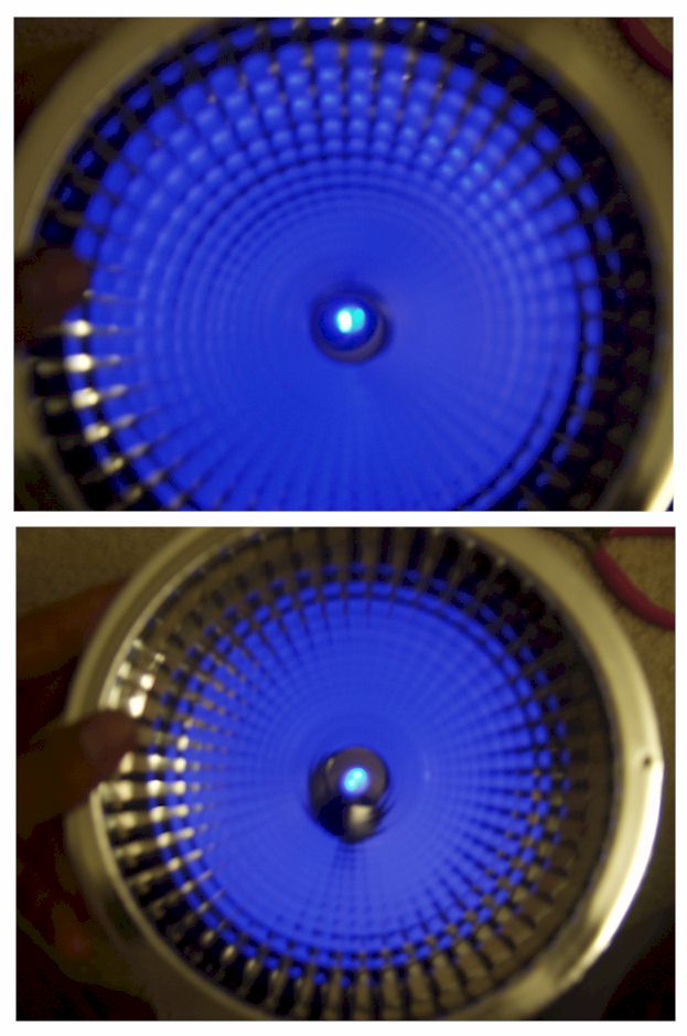

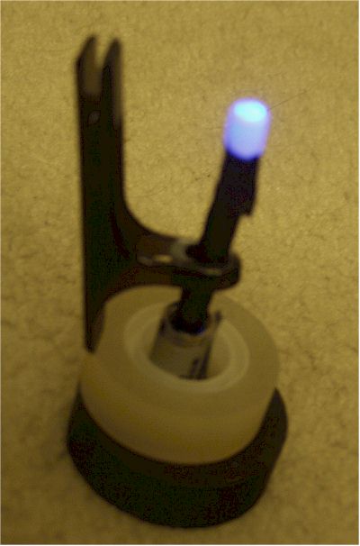

ellipsoidal reflector (continue)
To see how the reflector works and where the F1 is, I used a salvaged ballpoint pen with LED light and tryied to mimic the dimension of the MH lamp I plan to use (still have not received - more than a week overdue). The reflector is amazing - I can get a very focused beam (about 2 inch diameter) at the F2 and if I look inside the reflector from F2 I can pretty much see the LED on most of the mirror surfaces. The pictures are not sharp enough since I took them with available light holding the reflector with one hand and my heavy digital SLR on the other so kind of blurry but you can get the idea.
