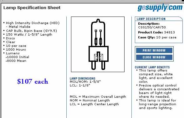

The other idea I am pursuing (in the interim basis) is to use the following lamp by GE. Its rated for 1000 hours but comes to about 12 cents an hour (affordable for watching DVDs). What I liked about it is the dimensions. Its less than 2 inch tall and very narrow diameter. My other OHP (EIKI) has a small bowl shaped reflector (i think its parabolic) sitting at the bottom of OHP and the current halogen lamp is mounted in such a way that the light center of the bulb falls in the center of the reflector which bounces it upward on the fresnel. It seems like if I use this MH lamp I would be able to use all the existing set up without twiking too many things..The lumens are not that great but almost all the light will be used so worth giving a try. Also, the lamp is very small so I can use other types of readymade reflectors too.
The ballast type is M81 so I am searching for the ballast right now.
I forgot to include this in my last post..
Now THAT'S the kind of bulb that I wish we could find, just in a higher wattage. One of my early ideas was to try to use a bi-pin MH lamp in a very small (~2" diam) conical reflector, possibly even cutting out the center bulb of an ENX projector bulb. I could never find them either cheap or of decent wattage. Which is a little odd, since they make 600w bi-pin halogens for use in stage lighting.

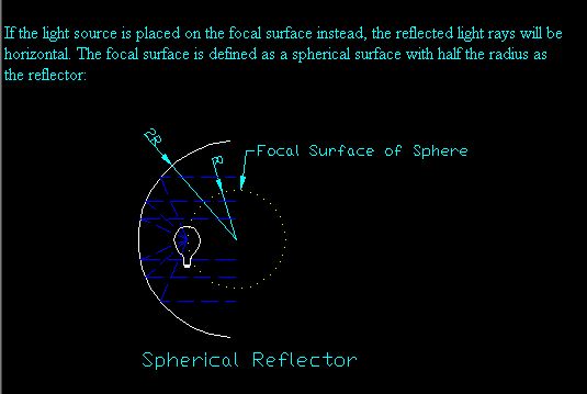

Mirror
Mirrors reflect light straight so may not be suitable for a point source light. When the light comes from a point source and needs to be equally distributed on a large surface (10 inch panel), you might be better off with a curved reflector of some sort.

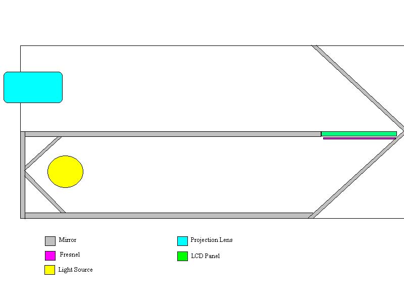

mirror
I planned for that, I have a high quality glass fresnel lens from an over head projector to distribute the light.
Fresnels don't just magically straighten out light that is not in a semi-coherent beam. First you should try to set up your light source to direct as much light as possible in one direction, and then put the fresnel in that path.
You never manage to capture 100% of the light. If you did, you would have, in effect, created a laser.
IMHO, the only flaw in your design is that you rely on the light source itself and two 45degree mirrors to direct light towards the fresnel. If you were to set up some sort of curved reflector (as we have been talking about), you would direct FAR more light than you will with flat mirrors placed at 45deg angles behind the light source.
Here's a really bad illustration of what I'm talking about:

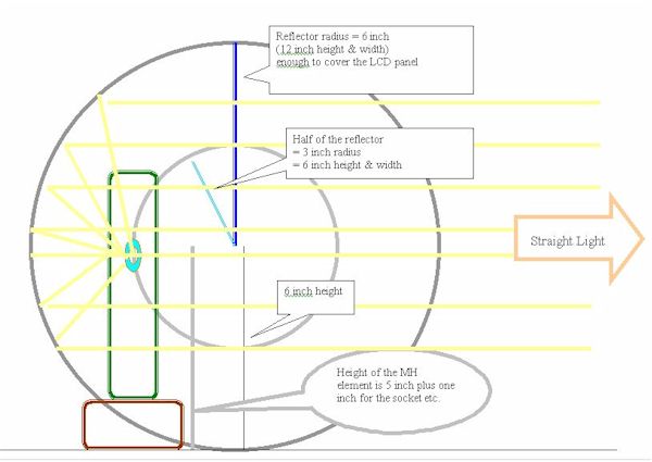

While waiting for the lamp and ballast.. I am thinking of working on the box and reflector.
Thoughts on ellipsoidal reflector.
Since I am going to use the fresnel, I think I dont need to build an ellipsoidal reflector. Let the fresnel collect and focus the light. All I think I need to do is feed straight light to fresnel.
The first diagram shows how to bounce point source light straight and the second shows my design using the measurements of the bulb I am going to use. THe only thing I can think is that I have three inch room between the bulb element and the reflector surface (see my design) - that might be too narrow.
If this design is true, than I am going to draw a 6 inch radius circle and cut a half round of the circle in cardboard. Once I have that I can take that with me and look around for ceramic/glass/stainless steel/pyrex/etc bowls that can resemble similar curve. If not, I can have a friend make a ceramic half round with same radius that I can use for the reflector.
Any input?

So, you're not going to try for the "conical" (ie bowl-shaped) reflector? By "half-round", do you mean that it will be a "rectangular" reflector (like a tube cut in half)?
If so, you might save a little time and effort and visit your local Home Depot (or the local equivalent). There are very sturdy cardboard tubes with a 12" diameter that are used to pour concrete footings. Cut one in half (you'll need a hacksaw, that's how sturdy they are) and layer the inside with aluminum flashing (also at Home Depot, comes in 12"x10' rolls, and it's usually almost as reflective as a mirror), and I think that'll be a good beta version of your design. If I understand your "half-round" design correctly, that is.
As far as the design itself, I'm not immediately aware of a reason why it _wouldn't_ work. It seems like a sound idea to me. If the reflector is large enough, and your trig is right, then you should end up with a large enough "parallel" beam. The only problem is that there's a pretty big margin of error in lining up the bulb and the reflector just so. I would make sure that I have some "wiggle room" to make some pretty large adjustments.

10K lumen seems lower but a proper reflector may help. If its three times brighter than my junky 3M projector (3K lumens), I will be happy since I dont have to build a box for the bigger bulb setup for now. I will continue working on 400W MH set up in a box with custome made reflector and a long throw projector lense.
Grrr.
I received the MH setup today, and UPS chipped the bulb. So I can't test it until I replace that.
Attached is an image. The metal ruler at the bottom of the image is 24" long, so it gives you an idea of the size of this thing.
