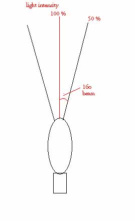

Also, AFAIK, the output is, indeed, 60K (peak). There is a pdf on the Philips site listing the bulb properties that supports this. However, there is probably a warm-up time before it gets to peak output. Usually not more than a few minutes.
I've become a little concerned that the 16deg beam may be a little _too_ tight. I've been toying with feeding different lights thru the optics of an OHP, and with a tight beam you lose the sharp edges of the projected image.
This is, of course, speculation until I get the ballast and can test it.

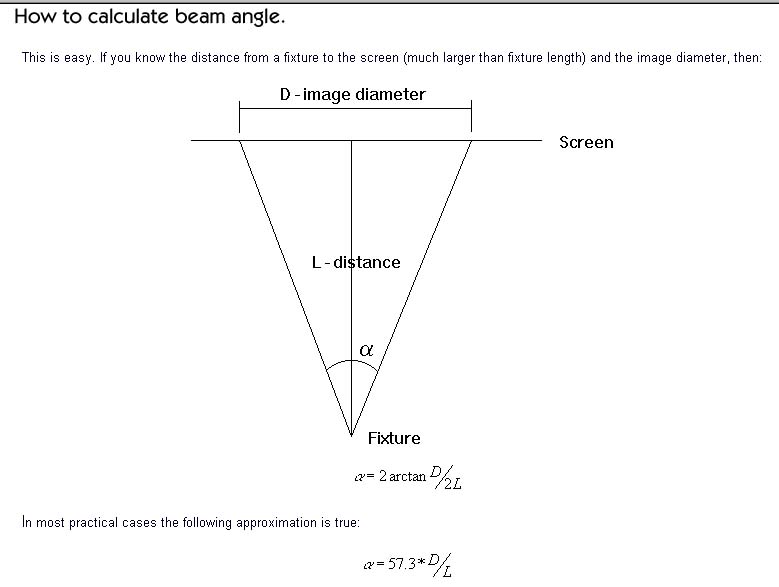

Lamp to LCD distance measurements
I was wondering about the same over the weekend. I found the following formula to measure the distance between the lamp and LCD panel based on the beam angle of the bulb. I am not good at solving these kinds of equations so need some help. Here is the link and the formula. My LCD panel is 10.4 diagonal and considering the 16 degree beam angle I came up with 37 inch distance between LCD and LAMP (if I did the correct math) - Thats too far but I think a frasnel lens can be used - dont know what kind though! Any help appreciated.
http://www.highend.com/news/lightingfaq.html
My calculator doesnt have an arctan button. You could look at it as half the 16deg triangle and just use
tan(alpha) = OP/ADJ
Since you want ADJ (your 'L' in the diagram),
ADJ = OP/tan(alpha)
or
ADJ = 5.2/0.14054 = 36.9999
So you're right.

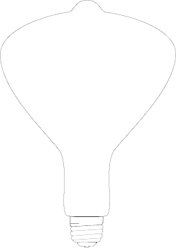

I also have a 3M OHP with the same light setup. I'm just worried that the beam spread might not be enough.
Also, I examined the bulb that goes in the OHP, and IMHO it appears to be an ellipsoid reflector. That has a great deal of bearing on what we're doing:
http://ourworld.compuserve.com/homepages/awi_industries/Optic_reflectors.htm
If it is indeed an elipsoid, then the 1" apeture in front of the light is probably roughly at the focal point of the beam. Then the beam reverses itself and spreads out.
With our parabolics, there would be no need for this apeture. On the down side, the beam may be too tight and not spread out enough to cover the entire LCD. Or, it might enter the fresnel at a different angle than the original light source, and therefore throw off the final image. I think that this could be remedied with a simple spreader lens, but I don't know. I have a number of lenses that I got in a parts auction, so hopefully I can spread the beam if it proves to be too tight.
(std OHP optics sans various mirrors)
<img src="http://members.cox.net/rolm/images/ohp_optics.jpg">
<OHP optics with a parabolic light source)
<img src="http://members.cox.net/rolm/images/ohp_optics2.jpg">
The pictures suck, but you'll probably get the idea: if the beam angle coming out of the light source in the lower image is not broad enough (or does not spread enough), it could be fed thru a lens to broaden it.

I actually just got done wiring up my test kit and running some initial tests for the lamp.
The bad news is that you are right: this bulb has a terrific hotspot at the center. In side-by-side comparison, it at first appears that the MH bulb is putting out about as much light as the 360w halogen in the OHP. But if you look closer, you can see that there is a brilliant hotspot that is about 4" diameter at 6'. This, I am sure, is where they measured the 60K lumens. If we could come up with a lens to spread this hotspot, then this might be a viable solution.
I also experimented with some masks for the bulb, and came to the conclusion that the beam, as it emanates from the bulb, is just too narrow for us to use.
My last experiment was to direct the bulb thru the optics of the OHP. This cinched it: there was one hotspot at the center of the image, and dim light around the prerimeter.
The bulb appears to put out a phenomenal amount of light for it's wattage, but I don't think it's usable without mucking with the beam.
