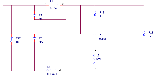

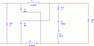

Using simple correction nettwork on DVC element and accelerometer. There is some problems onvolved:
1. above resonance the element act as spring mass load, giving 90 * phase shift.
2. at a point there is a coil making another 90* phase shift
feedback will then bee in the wrong way !
At elements resonance the load 😕 ? can i load it ?😕
Below resonanse i want to add sensitivity, at infinite i want no sensitivity.
And i want too get rid of that 180 * delayed output abowe critical freq. (at a point). I figure this nettwork will come werry close for a DVC element optimalised for feedback.
R27 and R28 beeng the terminals on the element. (Feed at R27)
