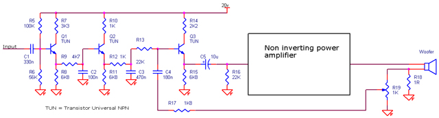

Selamat malam Mr. Hastomo
What you posted was quite often called MFB. In my opinion it is not.
It is a way to generate a negative output resistance of the amplifier. This way the Qtc of a driver can be lowered (though it would be wiser to take a stronger mangnet from the beginning).
Using current feedback, almost any output impedance (within reasonable limits) can be achieved, depending on the feedback- and forward-path functions. The ACE - Bass circuit works this way.
Regards
Charles
Regards
Charles

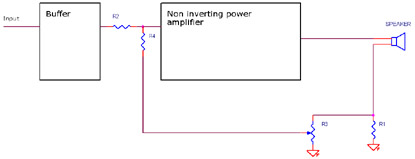

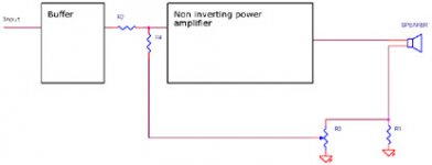

For one thing, current feedback is not “motional” feedback, no big deal though. 🙂 The real issue with current feedback is that it has a non-linear relationship with the cones motion. This is particularly a problem in the area of the drivers resonant frequency, which would be even further complicated in a vented box alignment. There would have to be some type of compensation for the drivers impedance (an therefore the current) variations over the frequency range of interest.What about this approach?? [is this current sensing?] I think this the cheapest way to applicate the MFB ....
