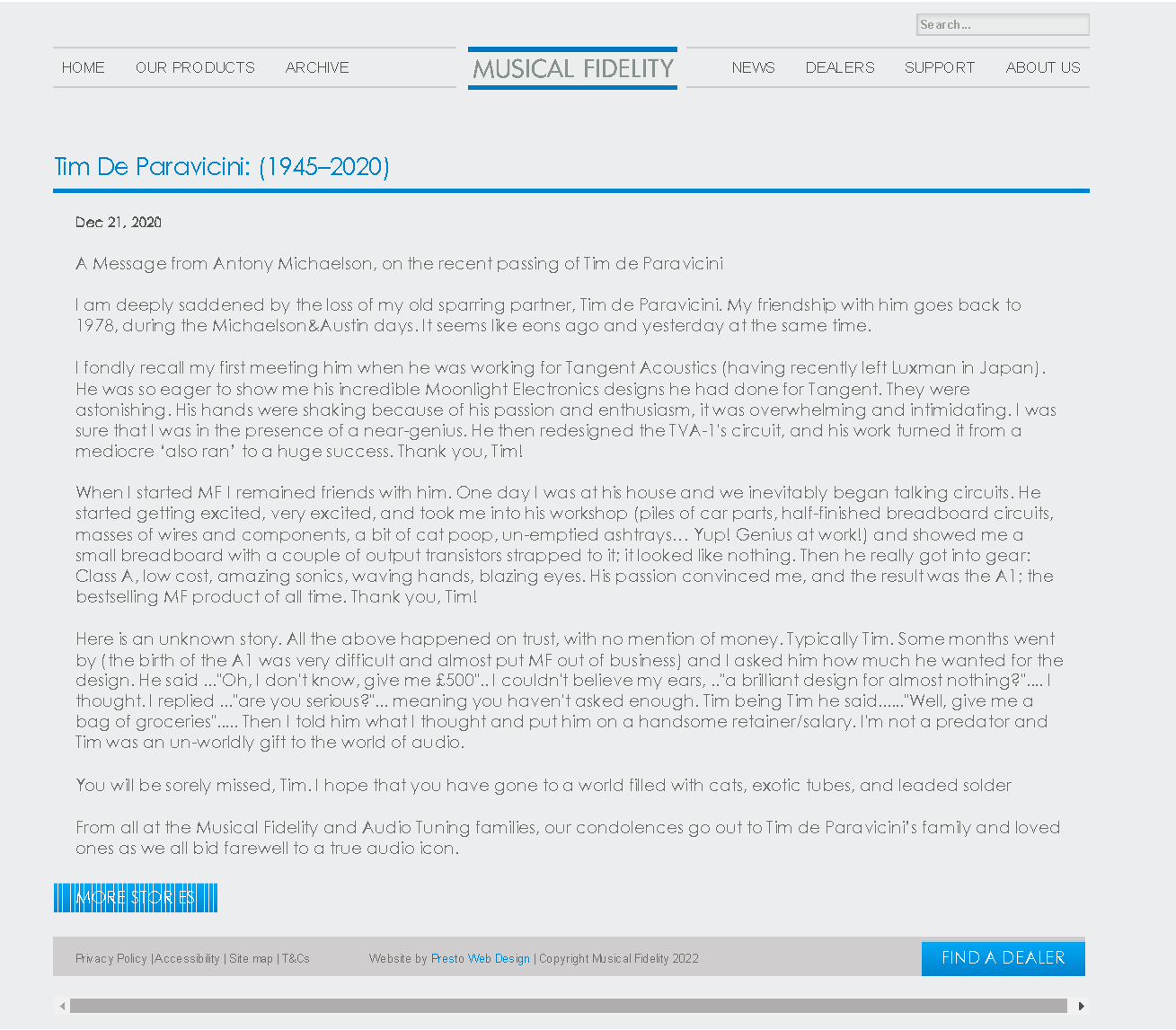

Anyhow, here's sshot of MF Web page about Tim de P.
I can't find it right now, so sshot instead of (probably more proper) link to
My friend Aleksandar RAAL gave me a story how he met Tim de P. on some FiFi Fair in Europe, spending some cozy time, talking about everything except Audio .........
There are more details to that (two of them on tobacco pauses on back porch of Fair Facility, porch oriented ditto at show-windows of nearby sex-workers Facility ...... so Tim and Alex having much better fun than inside of FiFi Fair), but I'm not going to say more

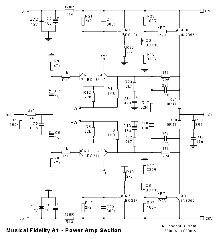

Here's schm of more or less basic MF A1, as it was decades ago; Lazy to check is it from M. Henessy's or from somewhere else

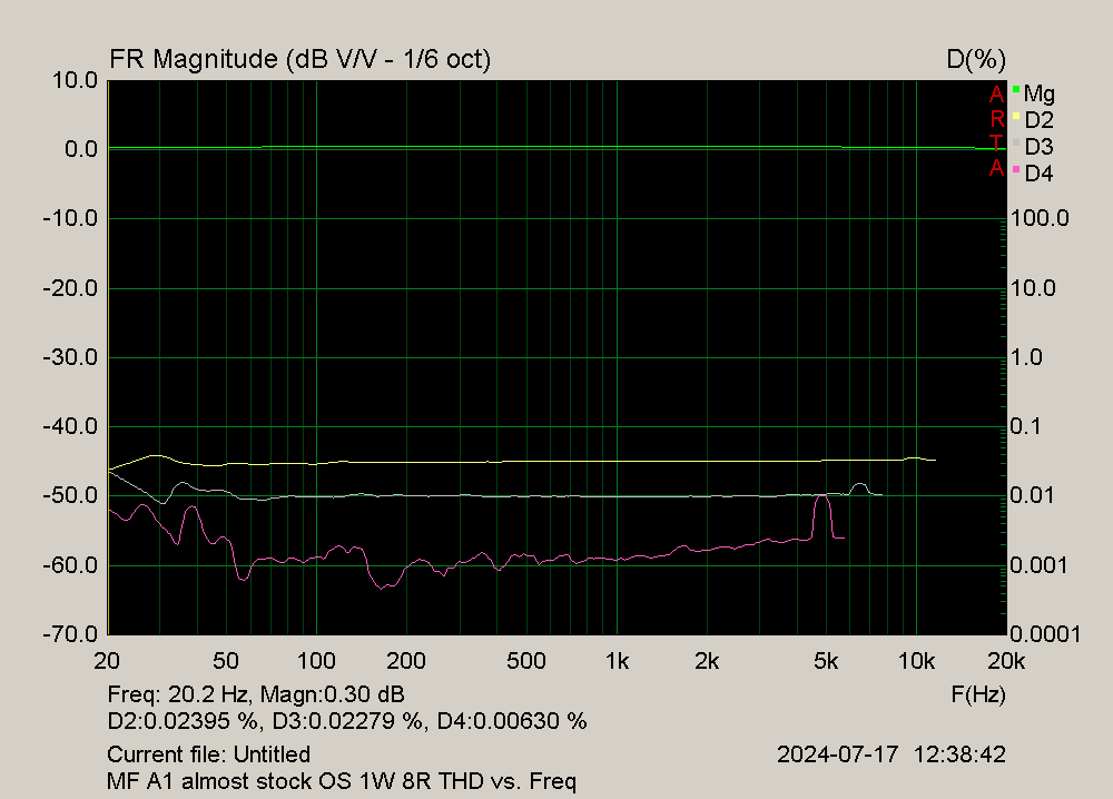

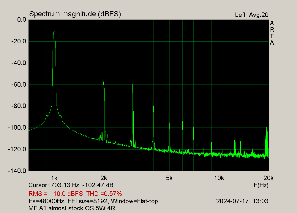

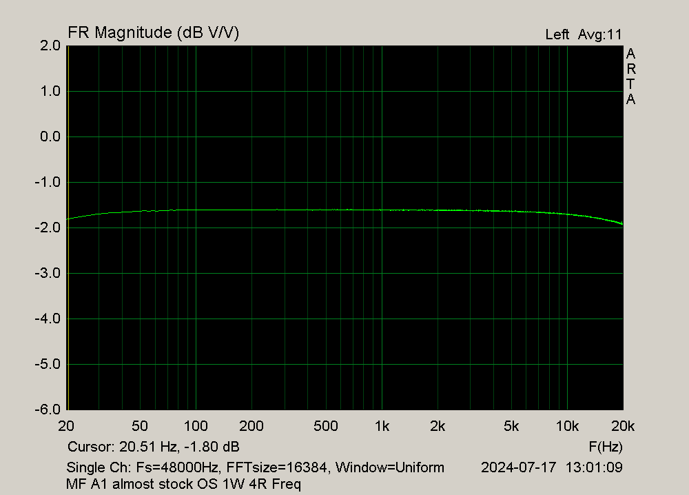

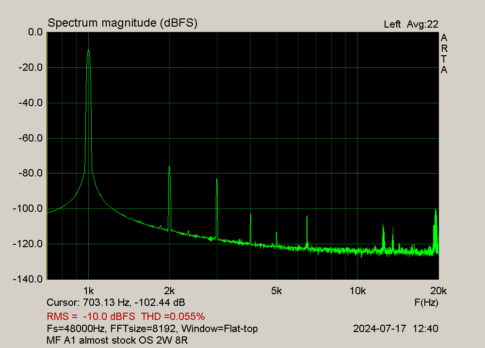

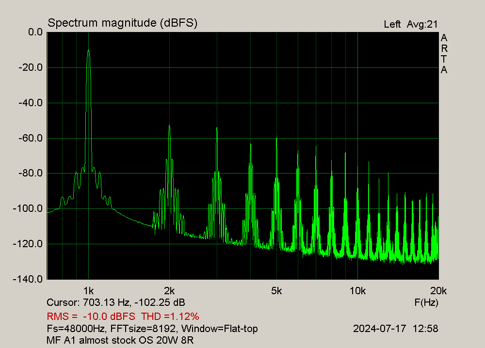

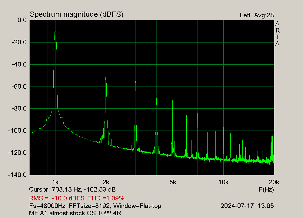

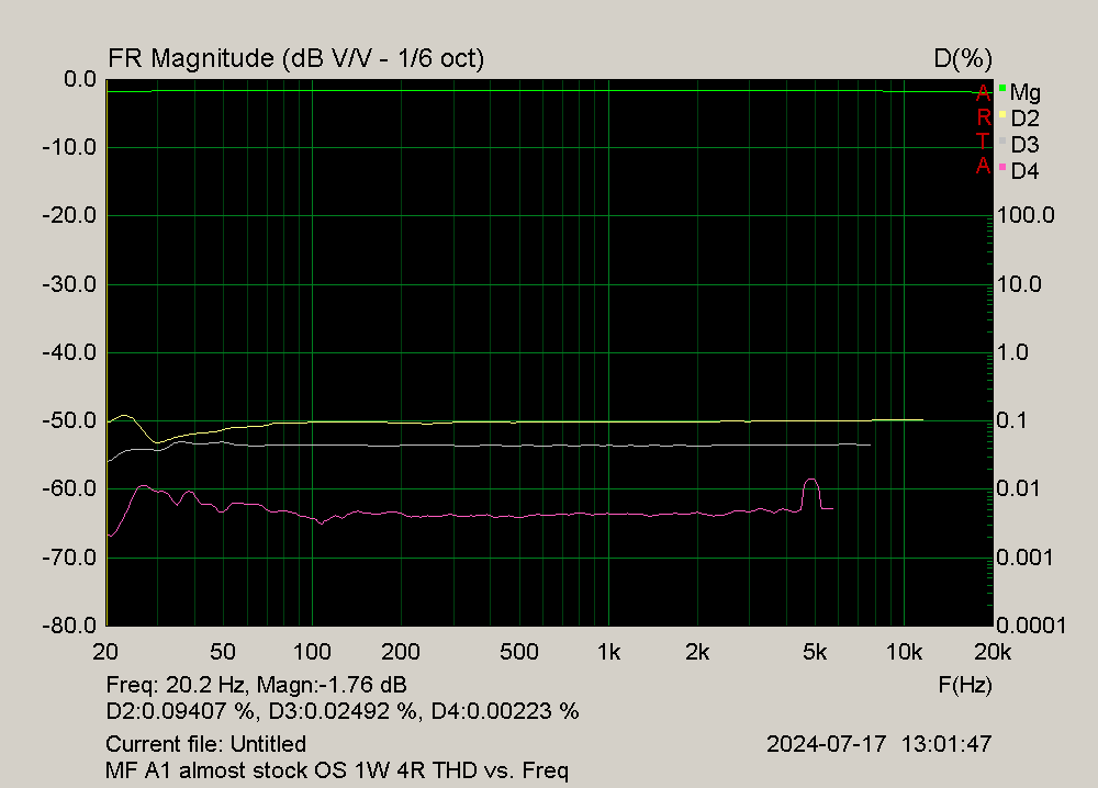

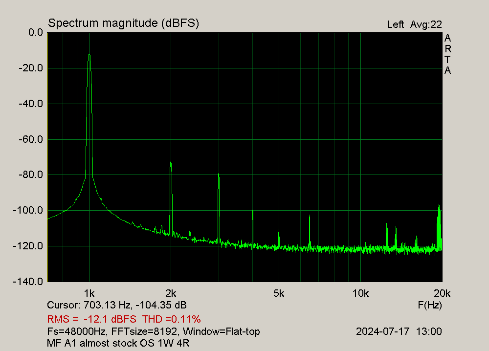

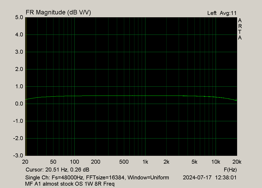

But, what I have is measurements of my own specimen, slightly tweaked
If you're in mood, compare these with those linked in previous post
Forgot to measure gain, but have this:
Vout 4Vrms@8R translates to 3V858@4R
thus Rout=0R3
DF 26@8R, 13@4R
so - pics for MF A1 Almost Stock, load 4R
- line stage tossed out, VolPot connected as usual, JFet buffer after
- emiter resistors for outputs are halved in value ......... altered MOhm resitors, to set Iq back to standard
- altered NFB to have less CLG, more proper to today's sources
- pretty much all elcos replaced with new, solid caps instead elcos where possible
thus Rout=0R3
DF 26@8R, 13@4R

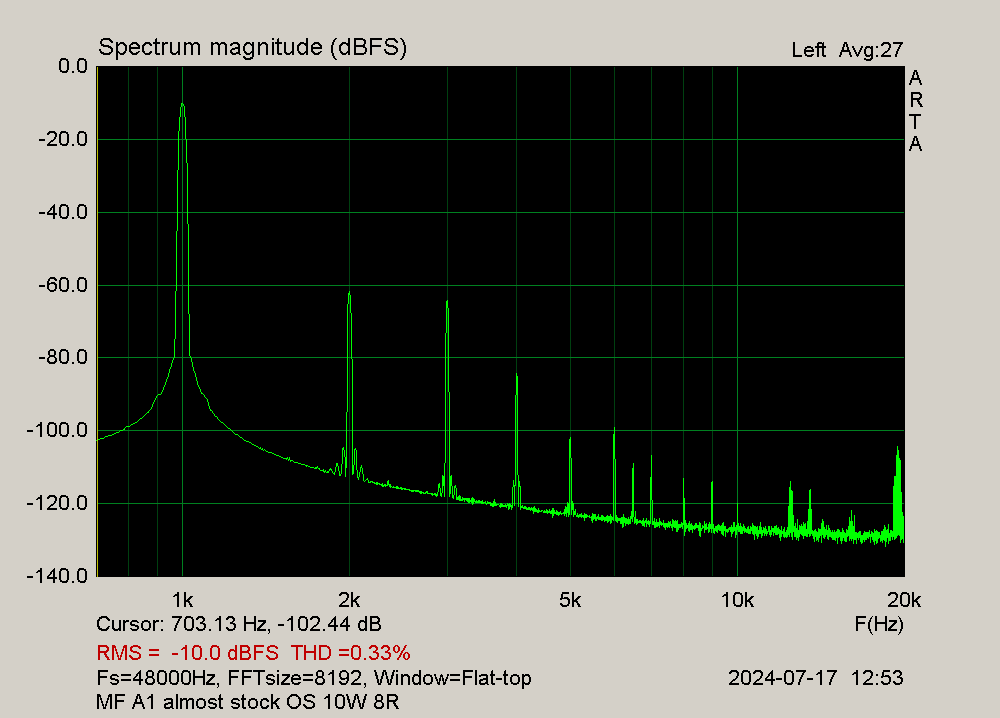

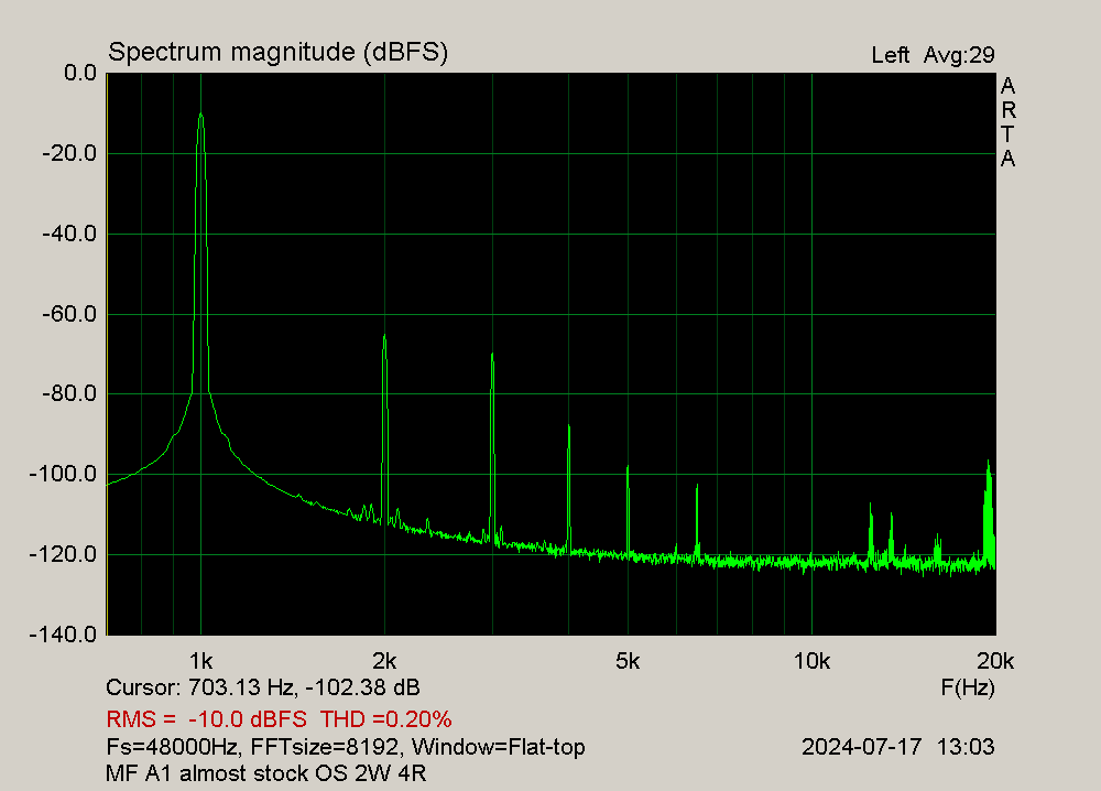

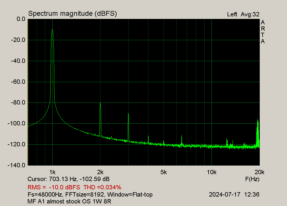

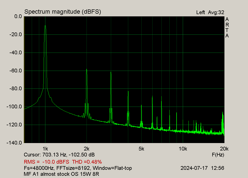

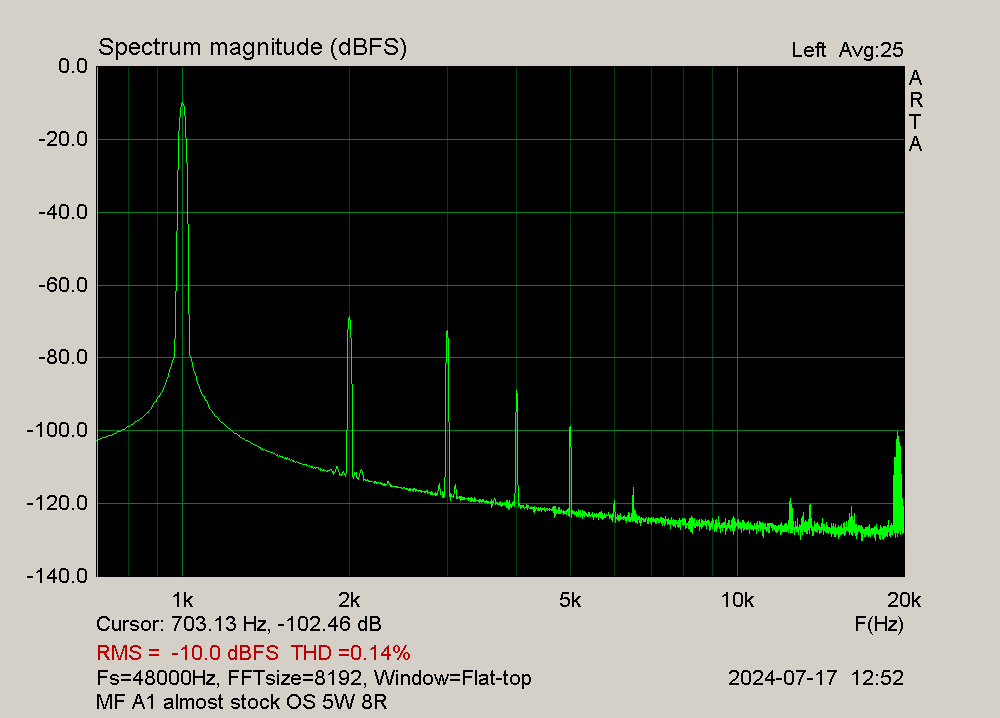

pics for MF A1 Almost Stock, load 8R

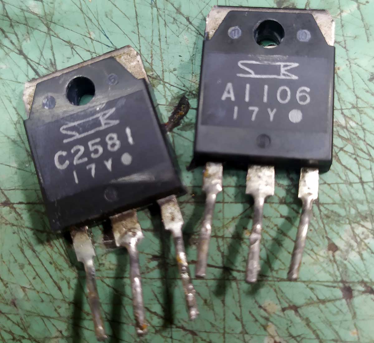

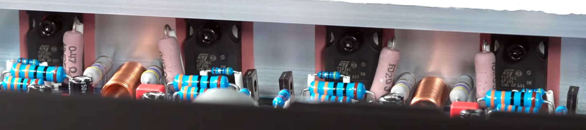

I'll just post one pic - showing type of transistors used in new one ........... just one of details showing that they had all chances to (finally) make it proper, but....
so, ZM being polite
SPh link to new one : https://www.stereophile.com/content/musical-fidelity-a1-integrated-amplifier

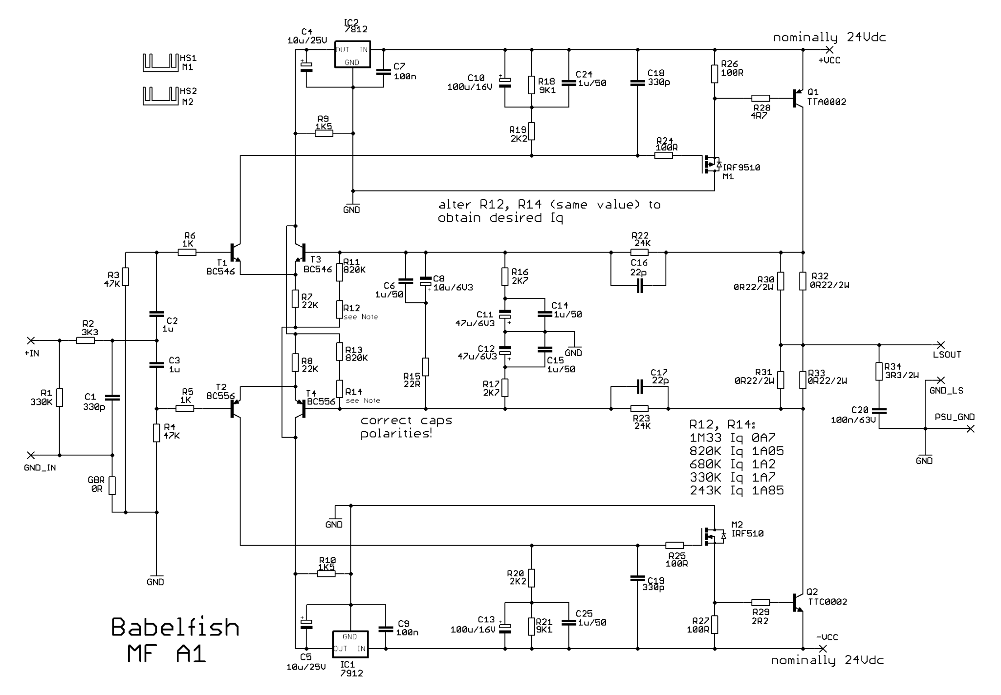

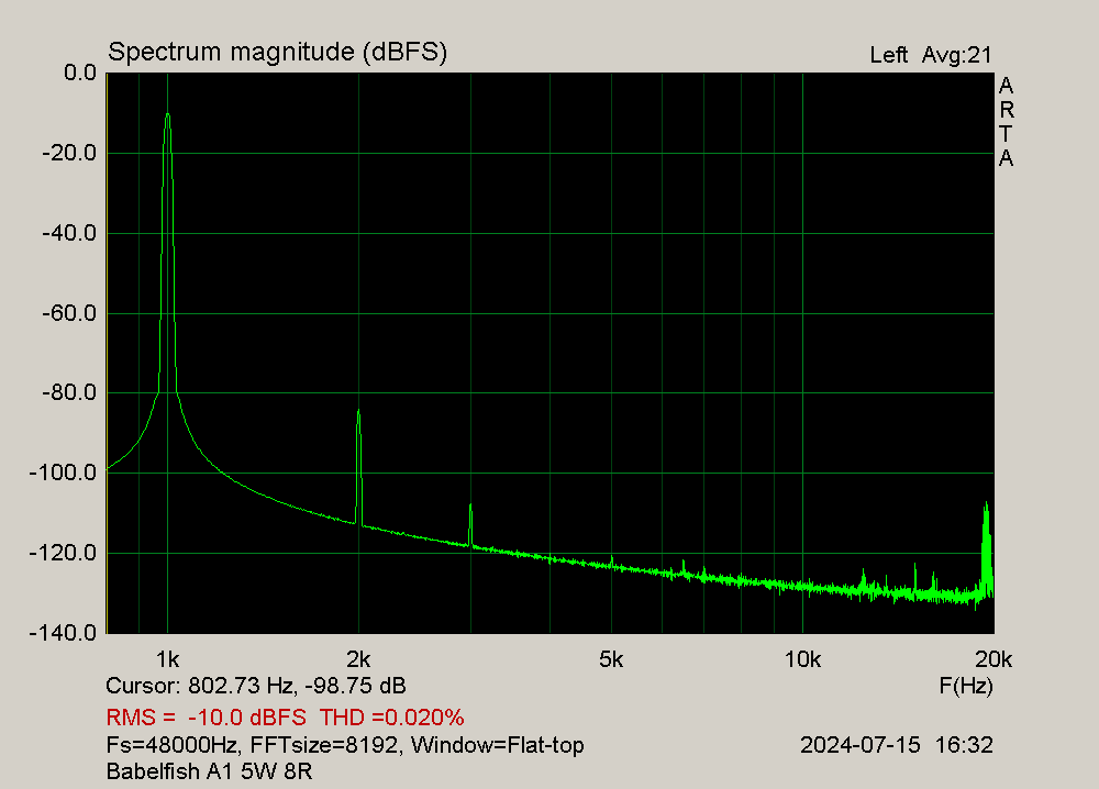

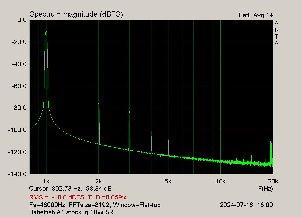

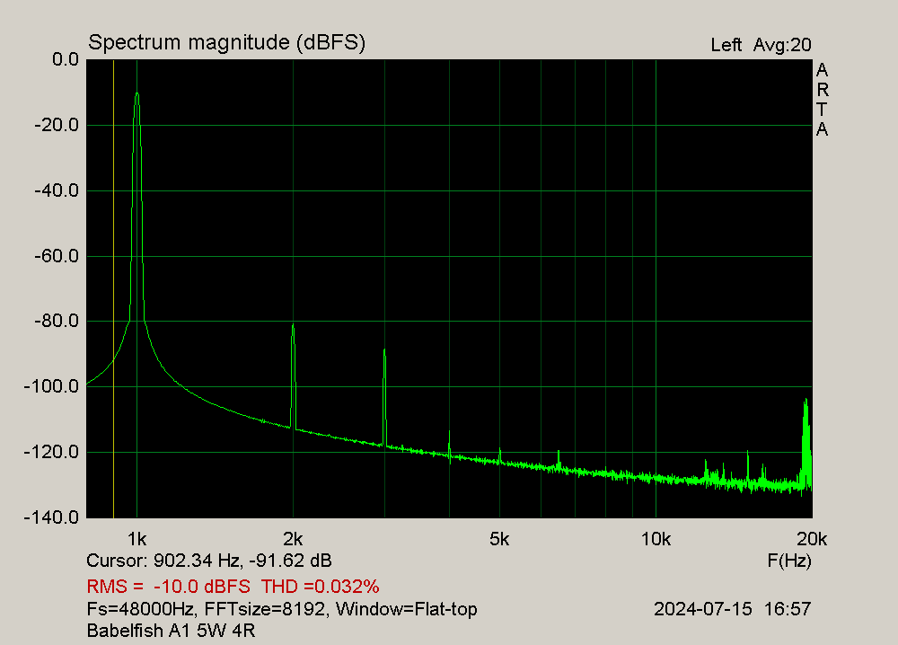

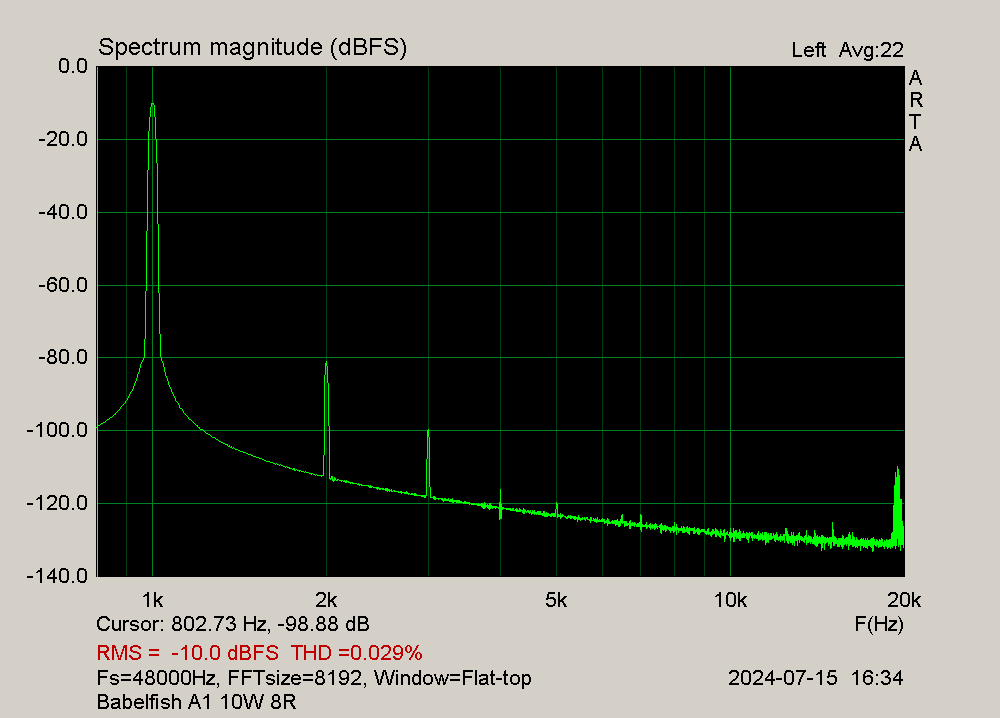

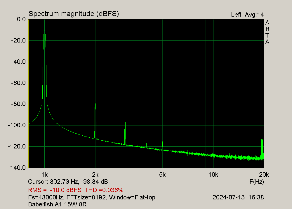

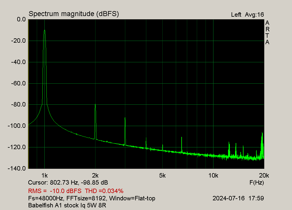

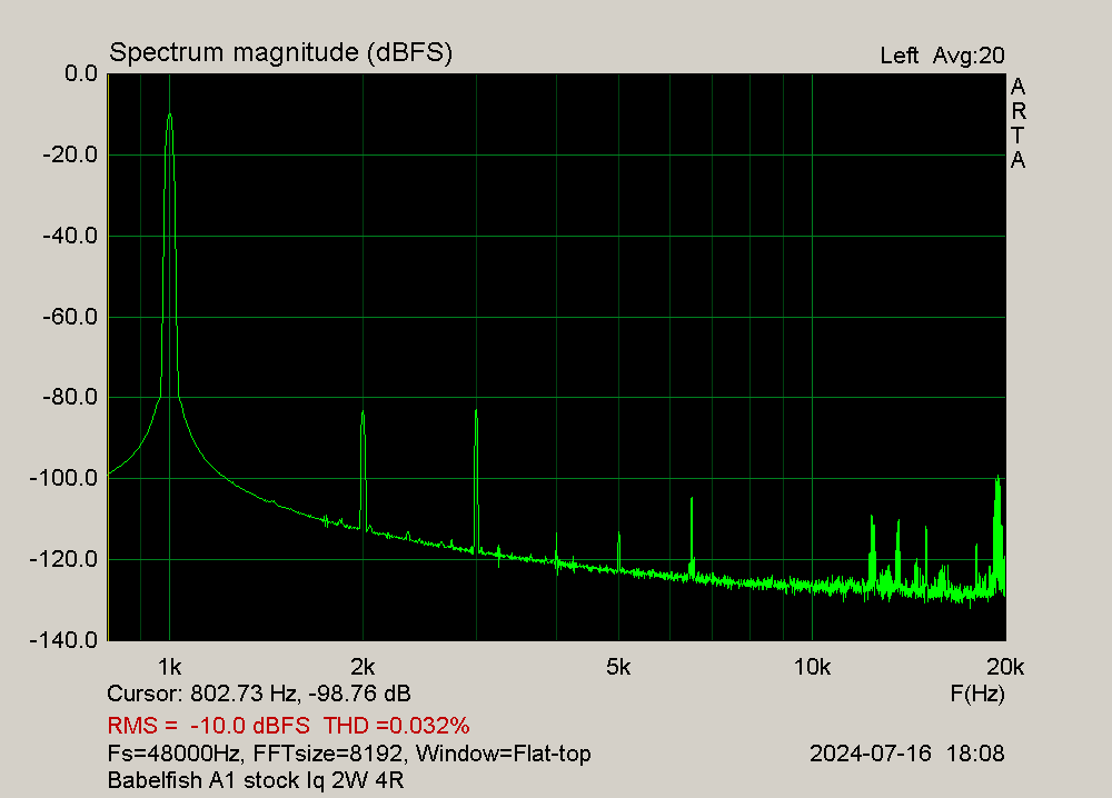

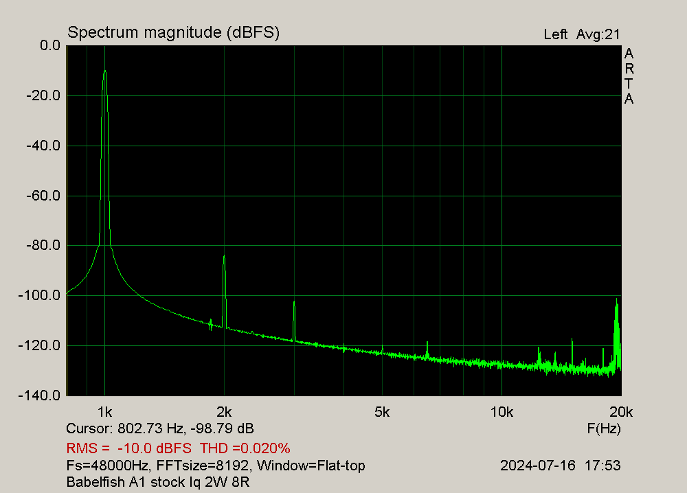

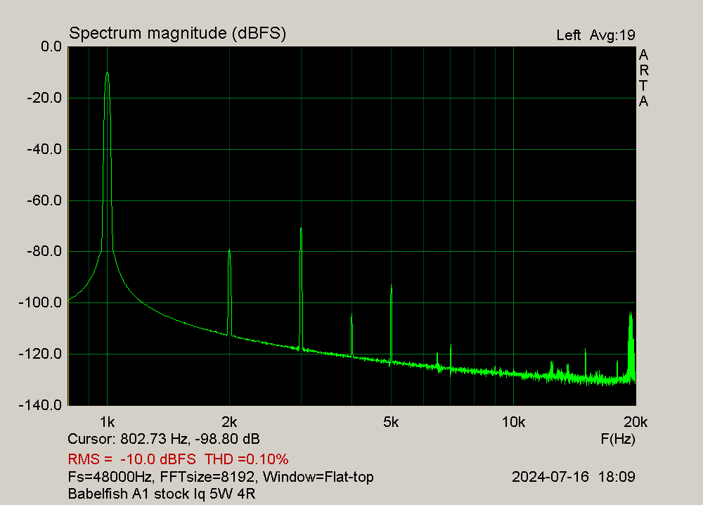

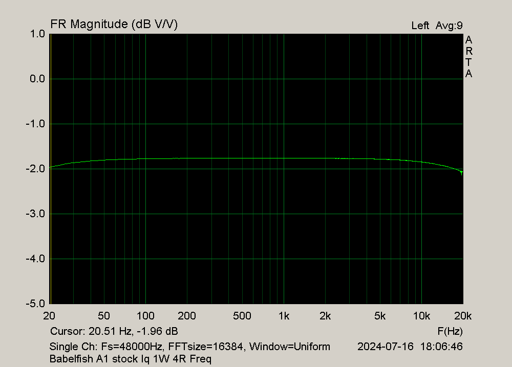

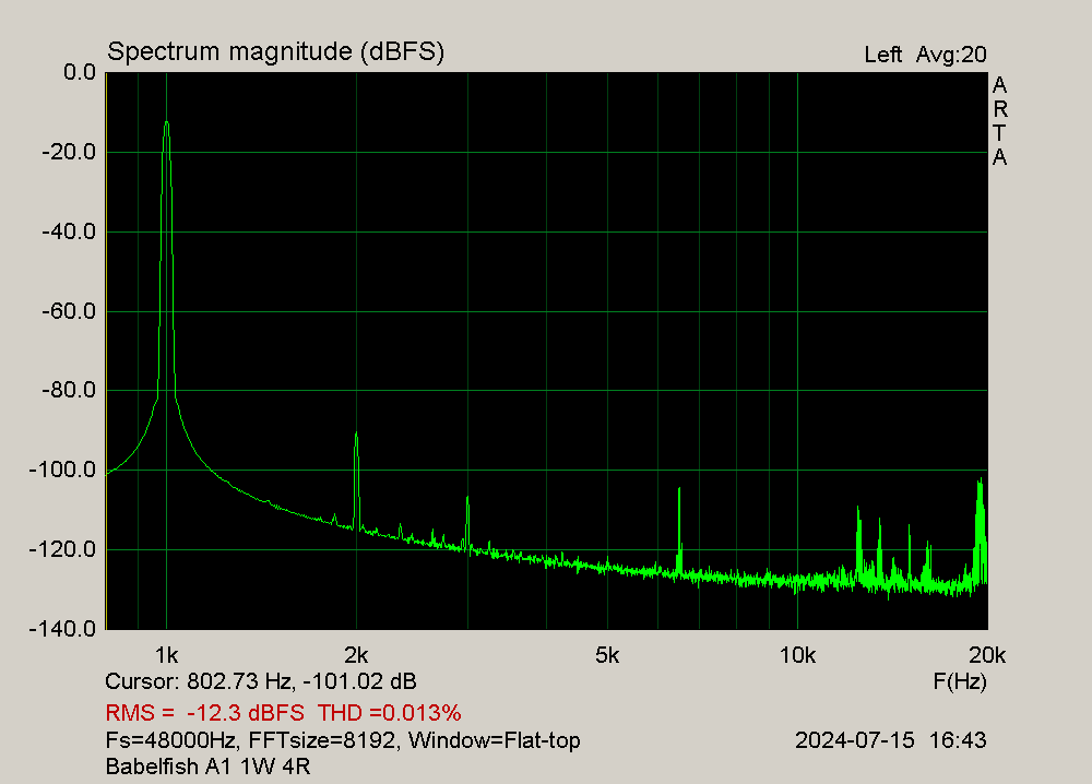

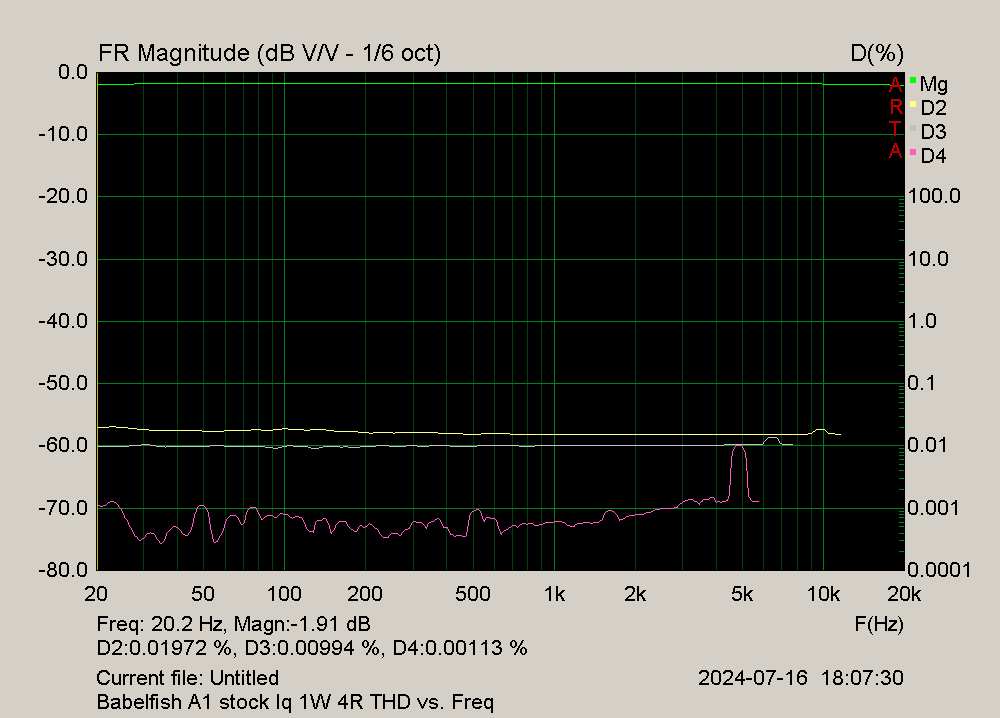

Here's what I'm happy with; darn nice singing, darn stable with Iq and Offset in both temp and voltage domain (heat and mains variations)

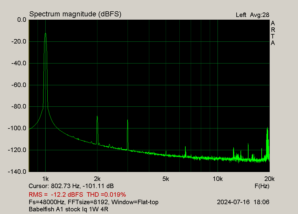

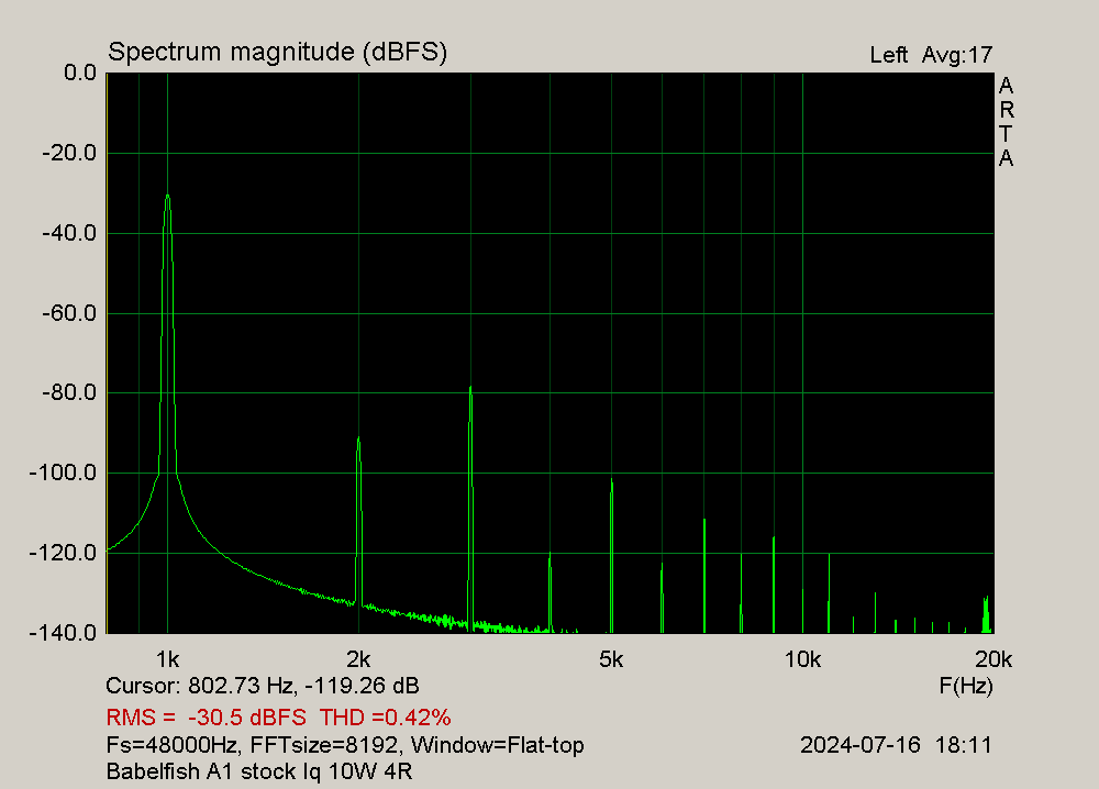

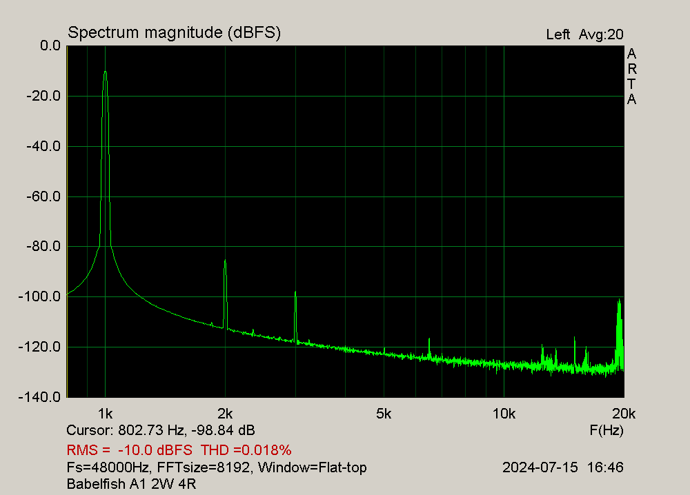

Proof is in Da Pudding
set to 700mA Iq, same as original
outputs genuine Toshiba TTA0002/TTC0002
Vout 4Vrms@8R, same Vin, Vout 3V888@4R Rout=240mR
DF 33@8R, 16.5@4R
Babelfish happily singing in 4R load
DF 33@8R, 16.5@4R

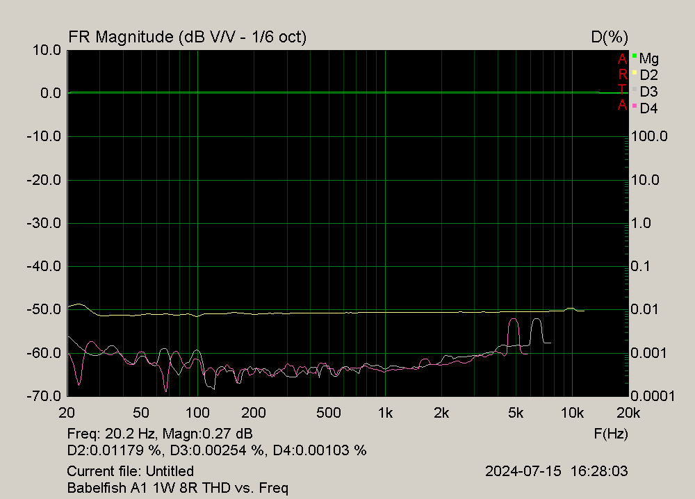

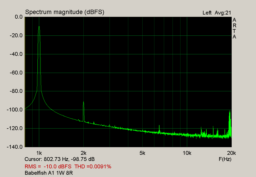

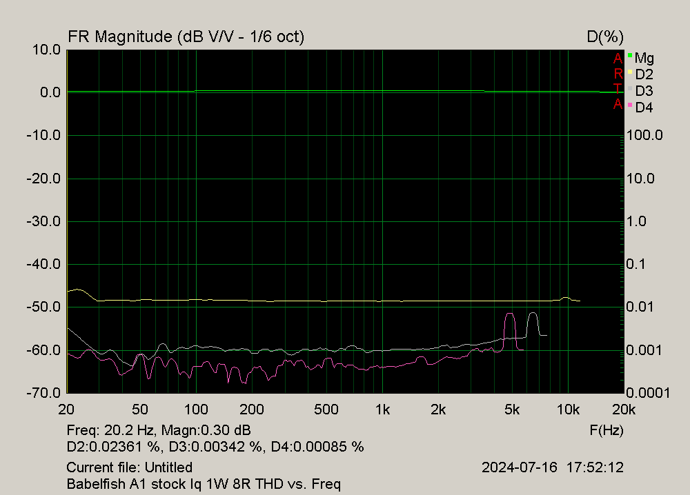

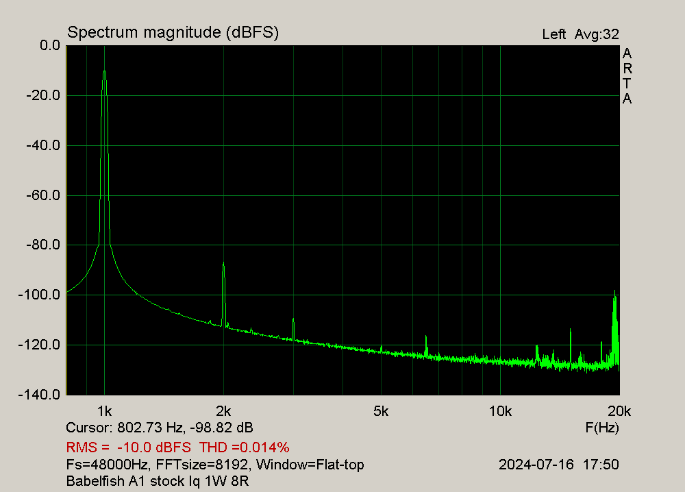

still 700mA Iq
Babelfish happily singing in 8R load

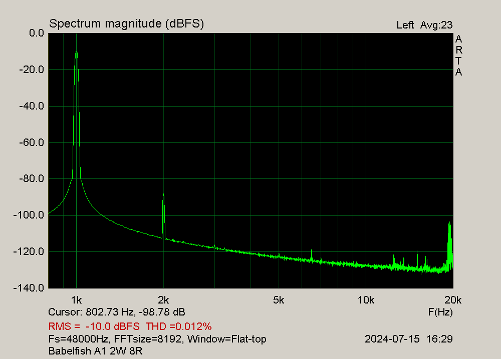

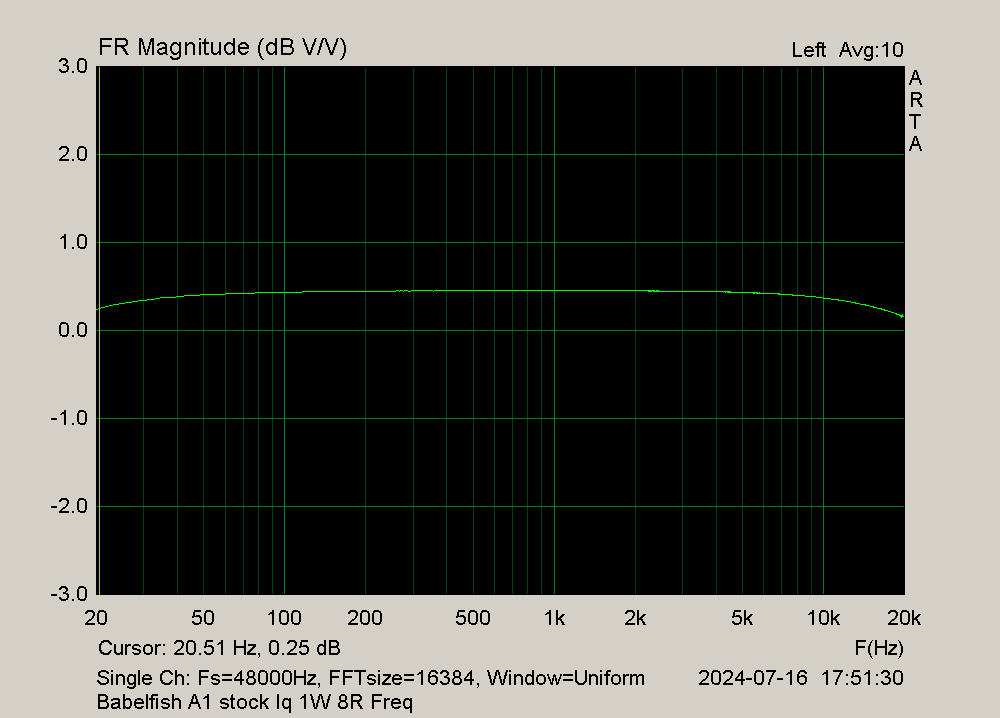

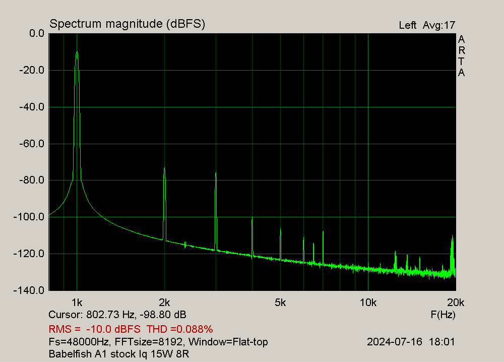

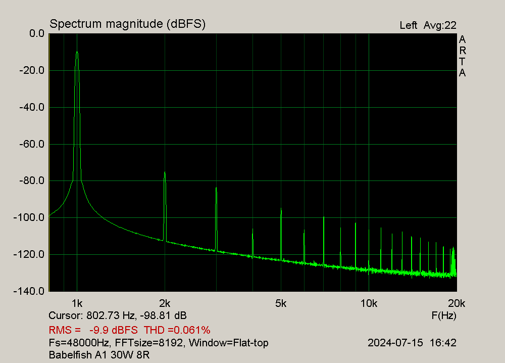

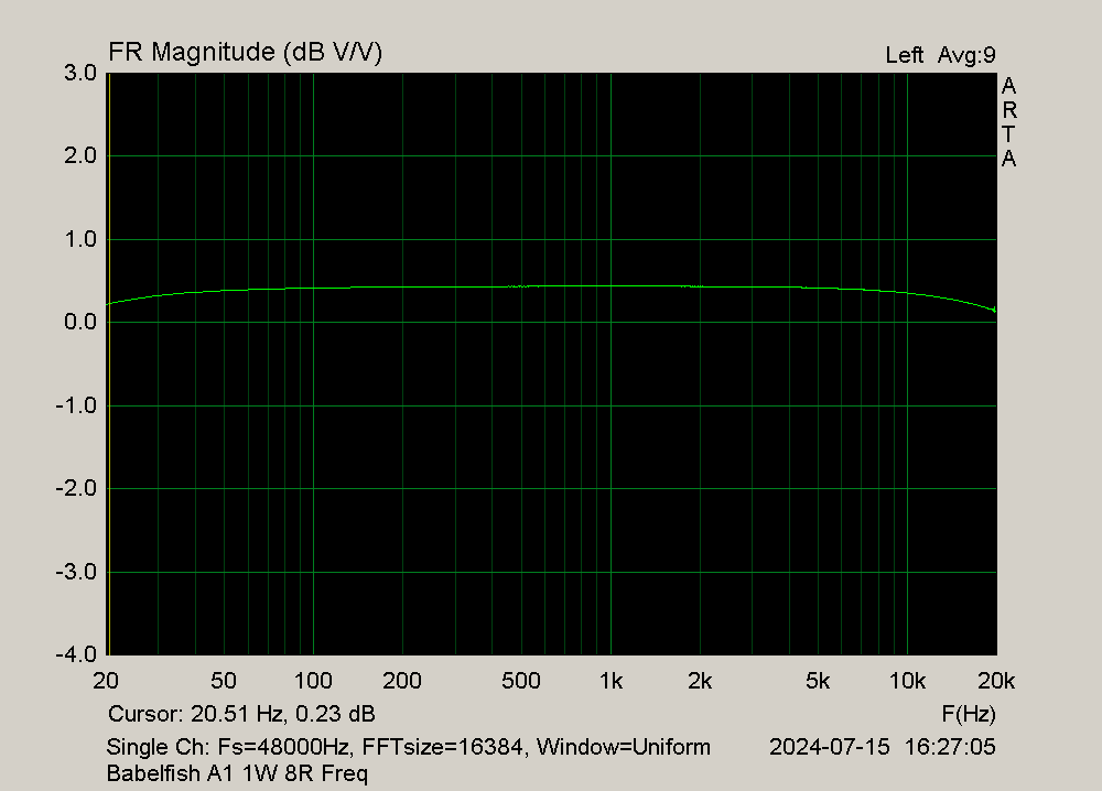

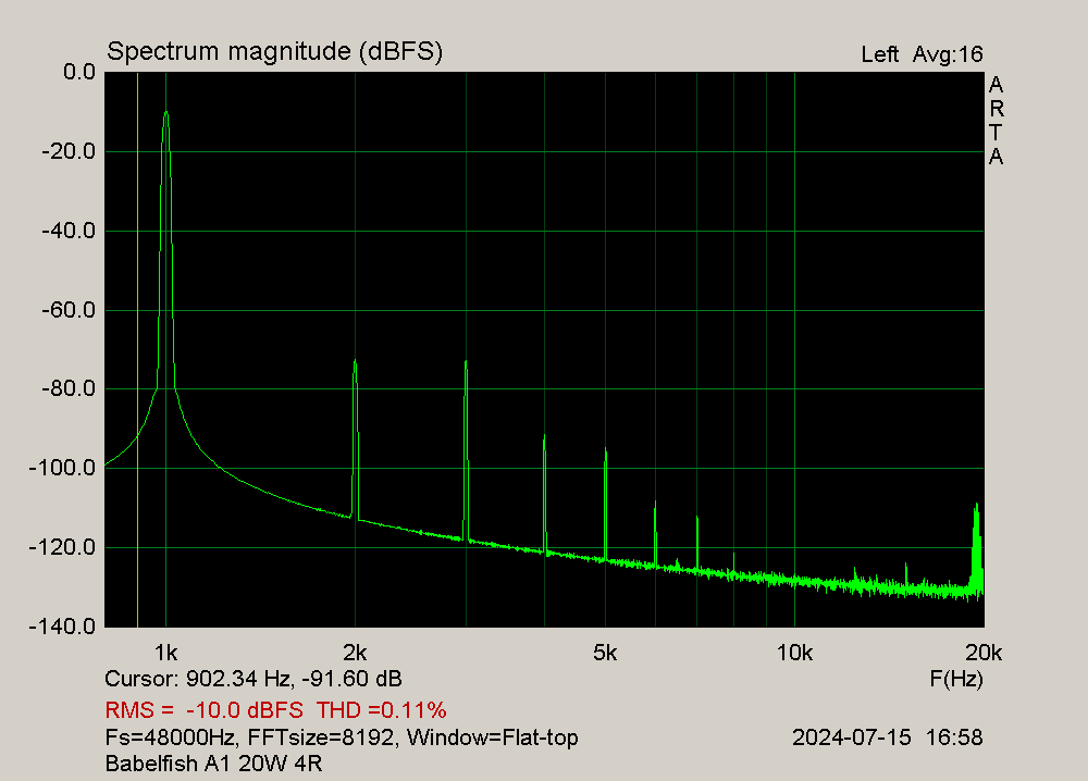

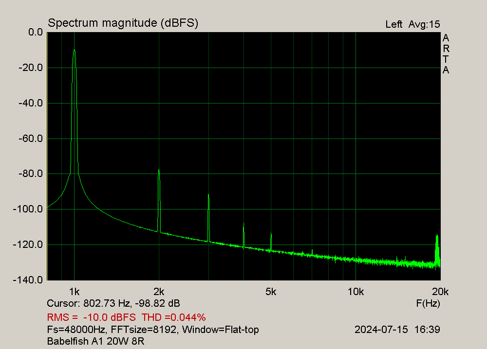

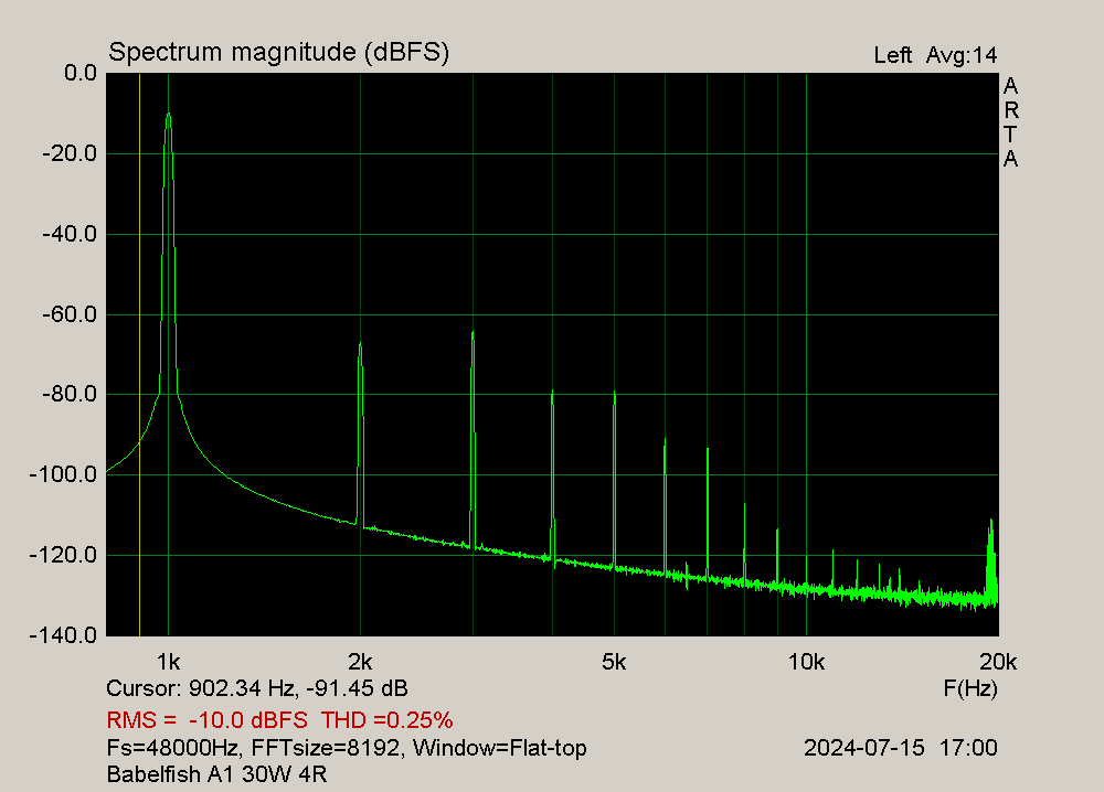

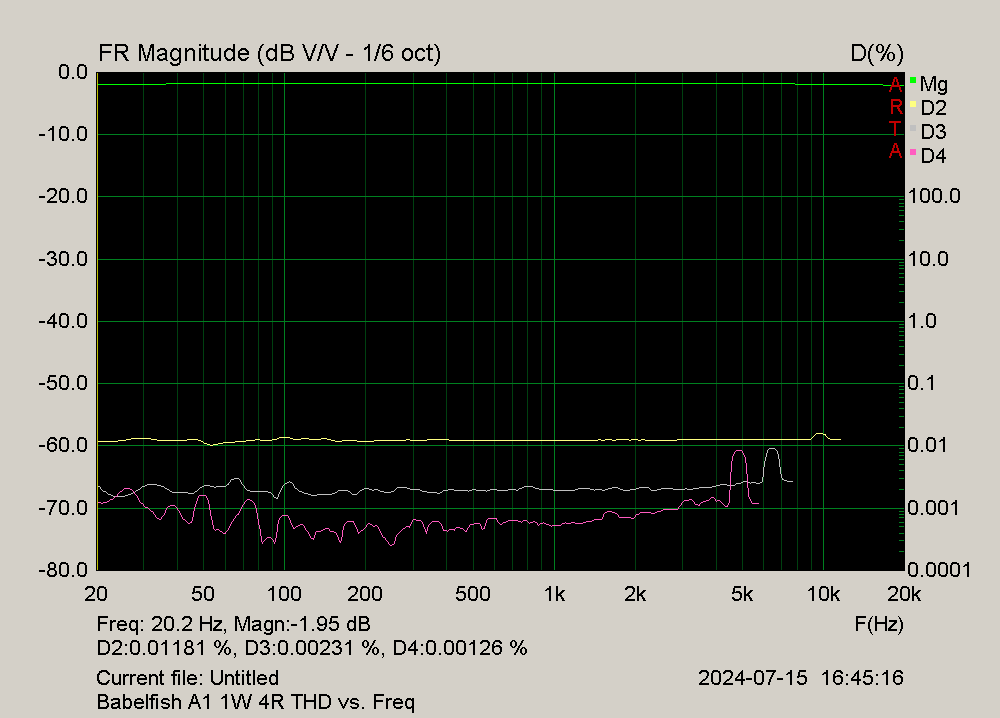

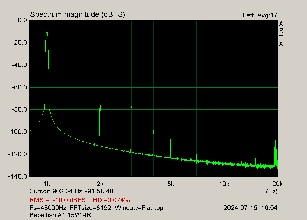

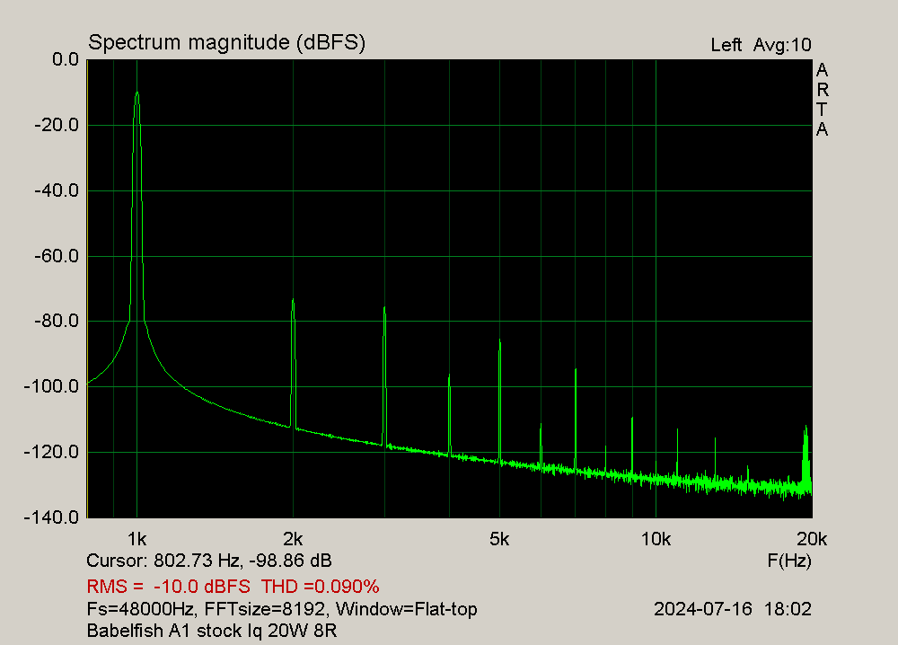

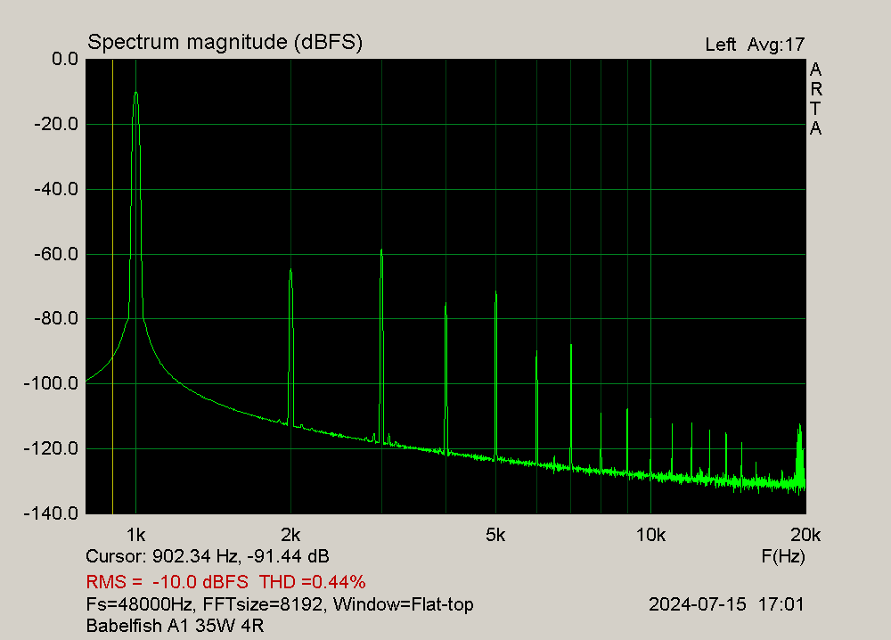

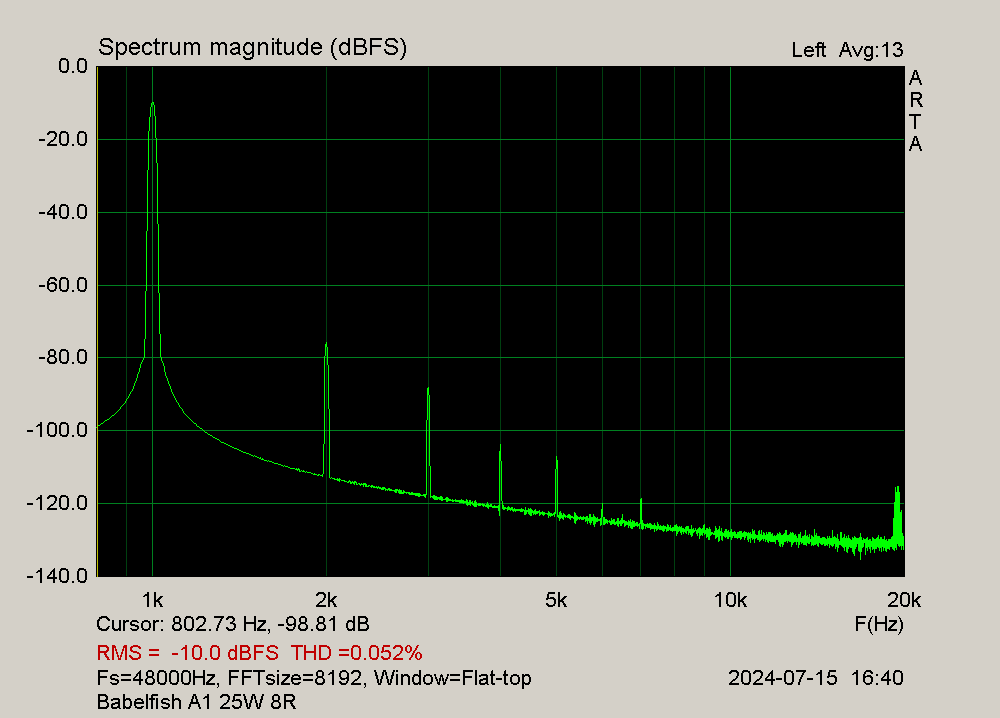

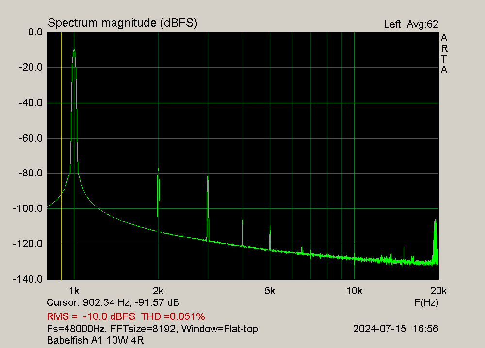

and ........ now! we are talking
funny pics with Iq set to 1A7
Vout 4Vrms@8R, same Vin, Vout 3V914@4R so Rout=180mR
Resulting in DF of 44@8R and 22@4R
Iq 1A7
Base current of TTC0002 is 9.4mA , thus Beta 181
Base current of TTA0002 is 11.7mA , thus Beta 145

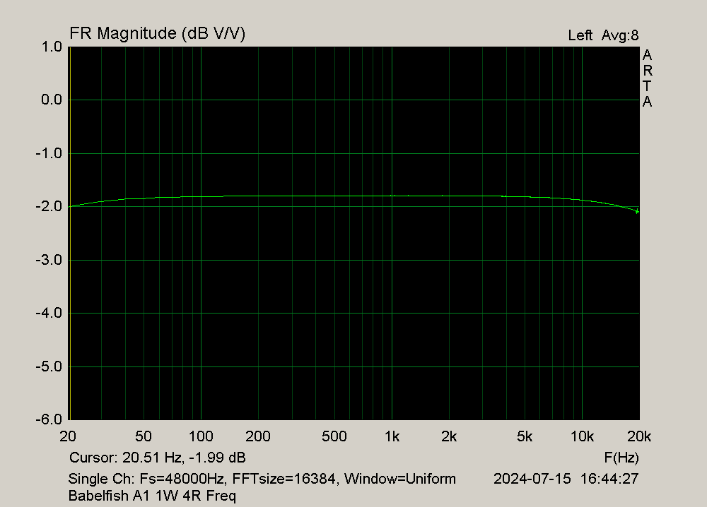

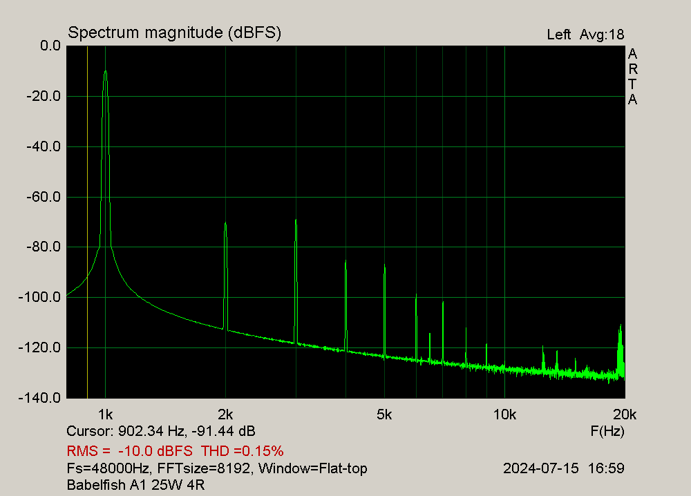

4R Load:
Iq 1A7
4R Load:
same as above, 8R Load:

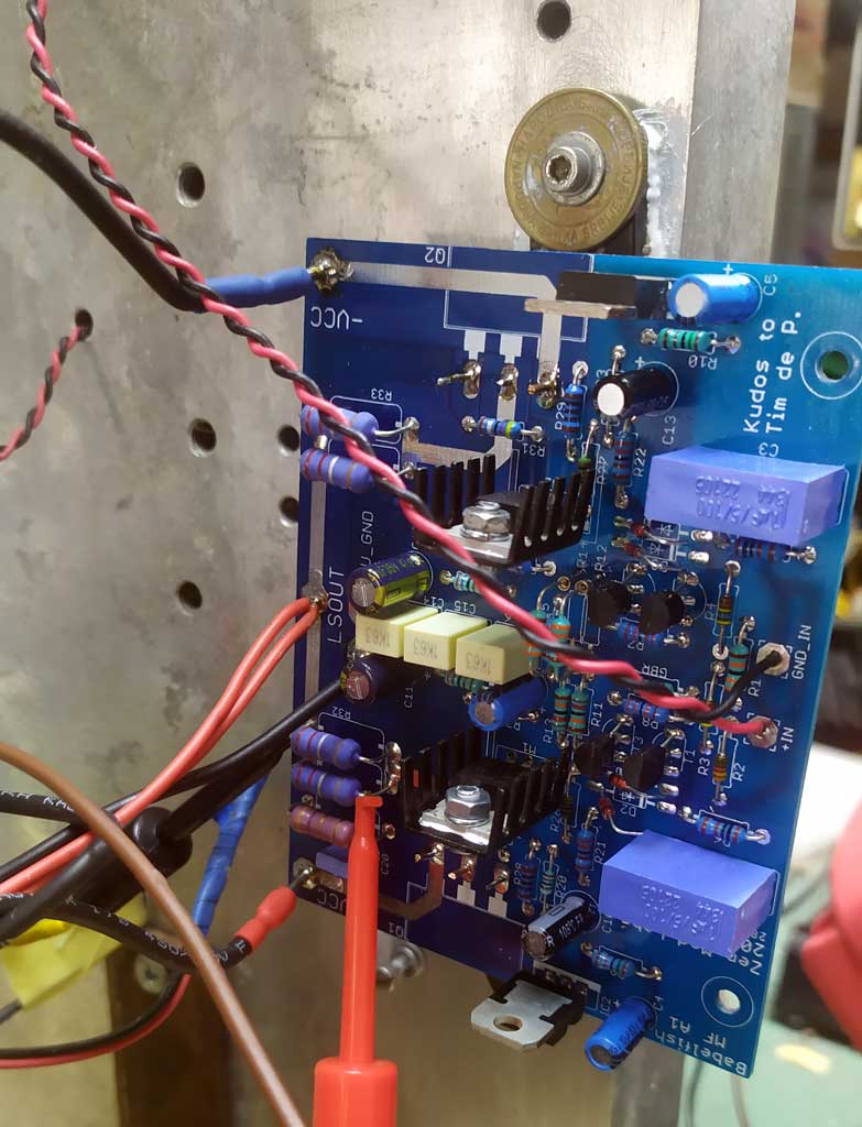

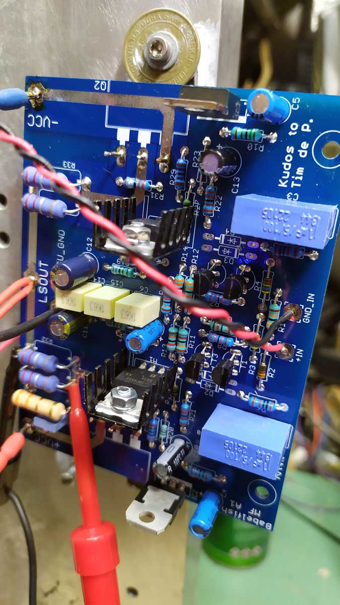

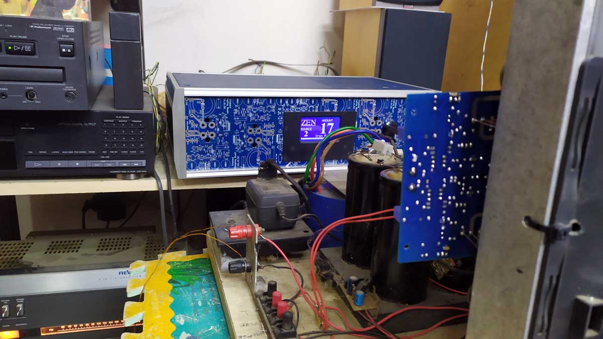

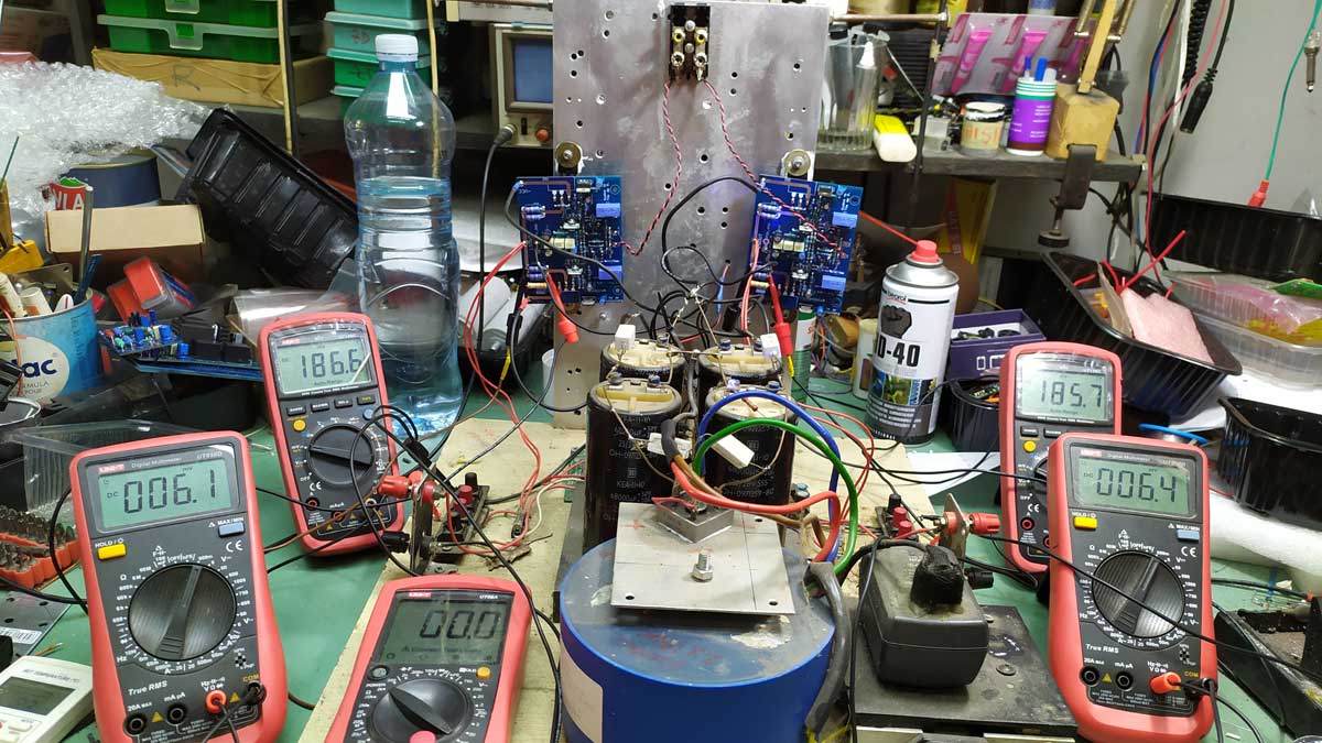

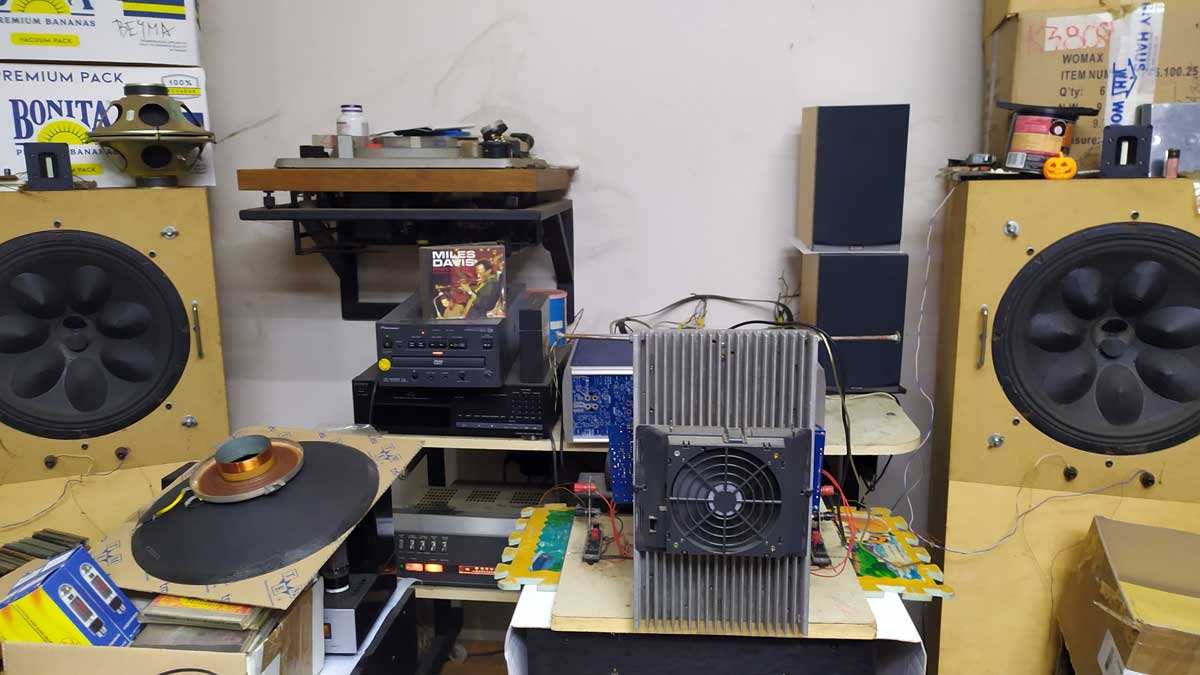

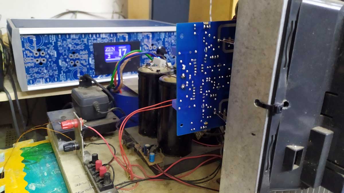

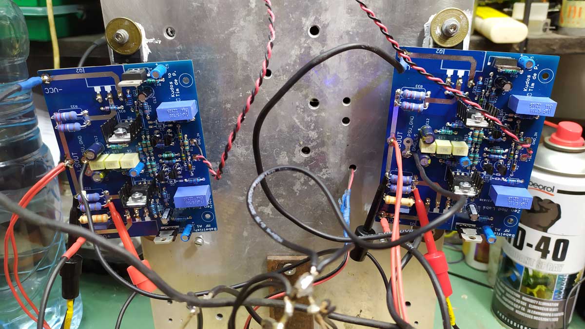

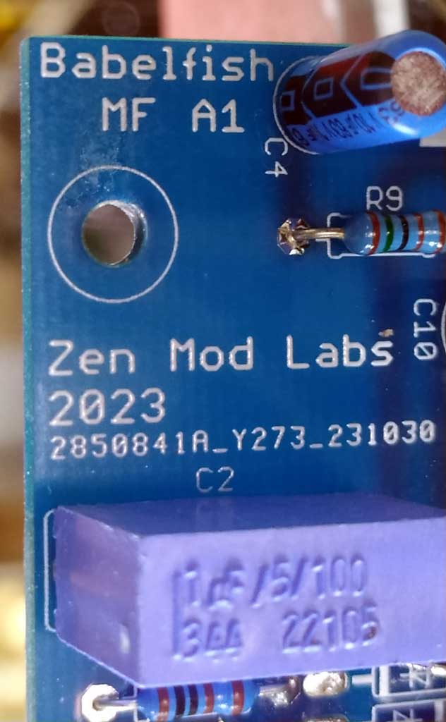

not many pics from bench, was lazy
forgot to note Gain - smidge bellow 19db; meaning ~900mV for 1W@8R

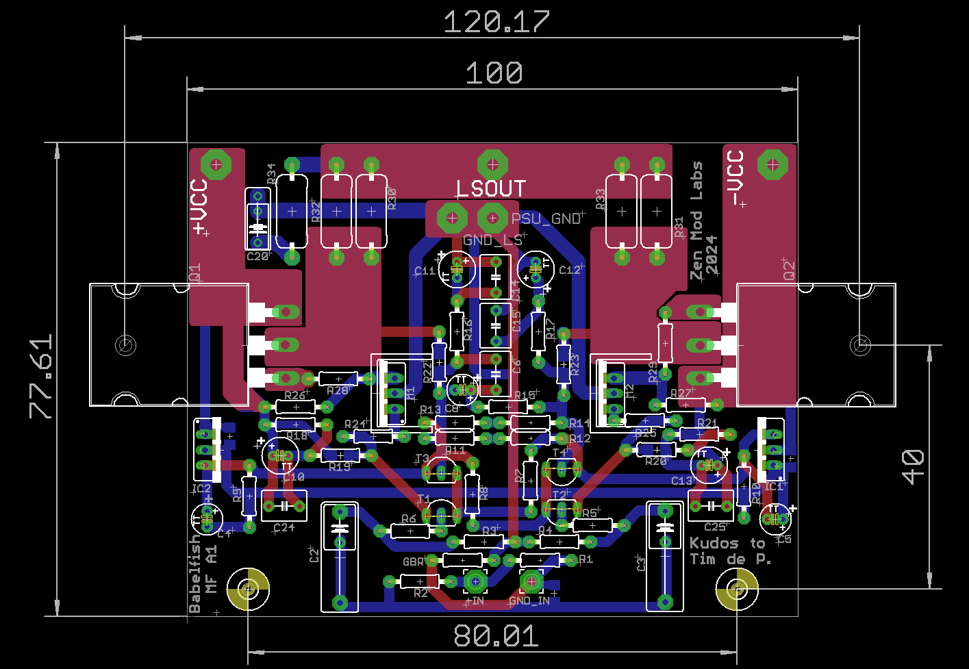

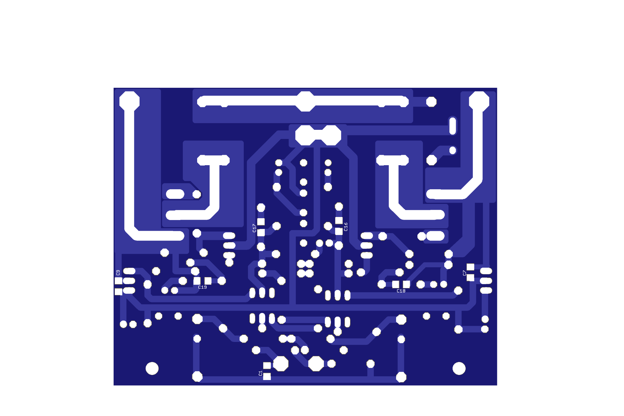

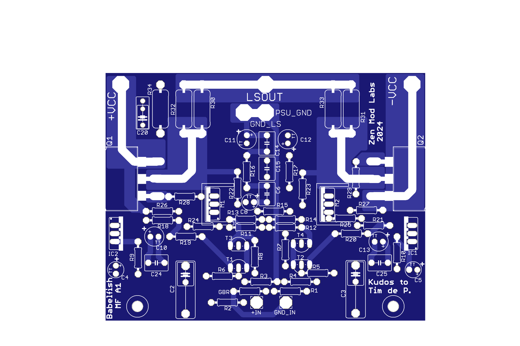

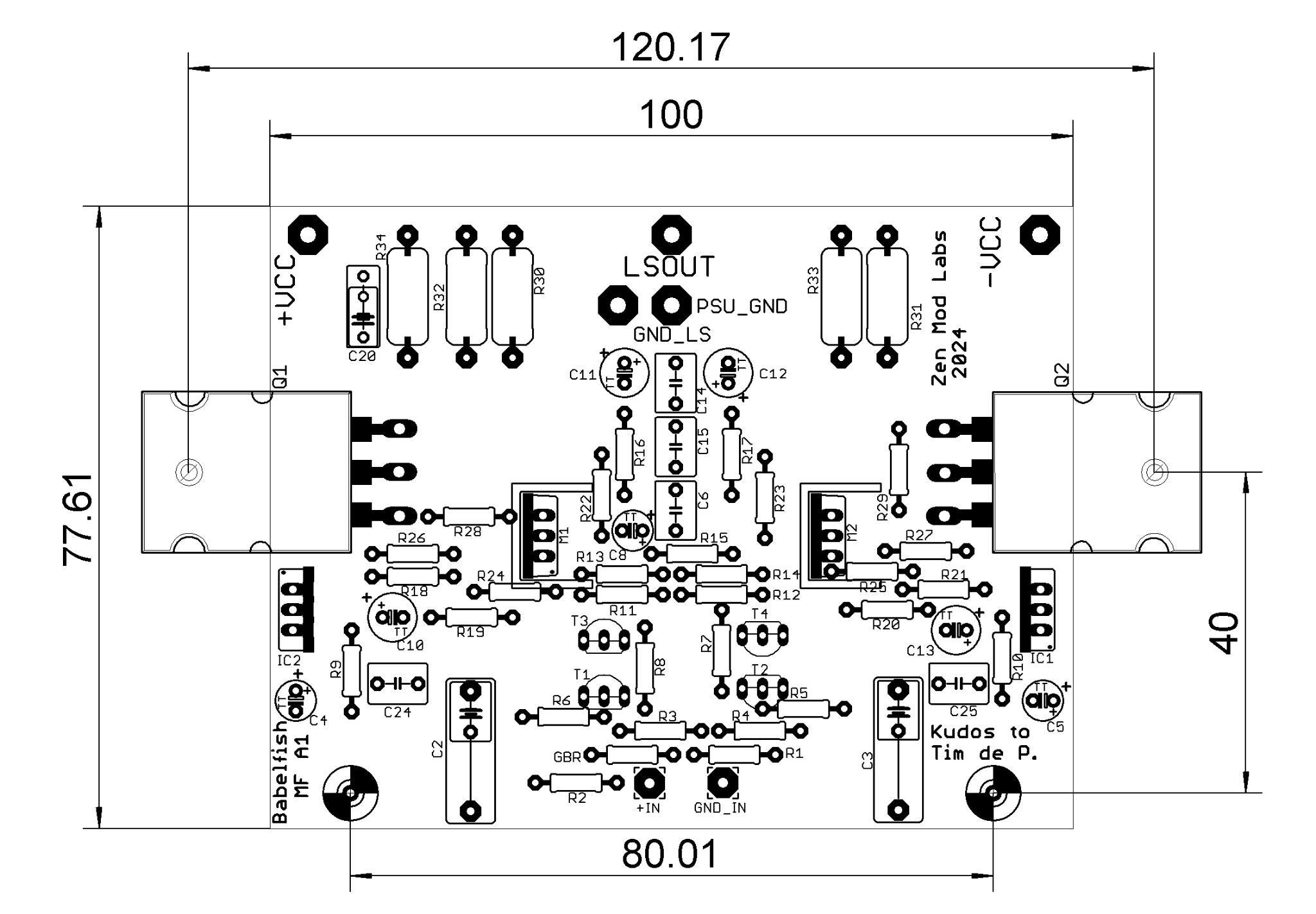

So, schmtc is yours .... go for it
I'll have full kits (pcbs with all parts, including TTA/TTC outputs) as soon I'm able to organize my impossibletoorganize Mighty MySelf

And then , when brought to our usual level of Iq ( FW form factor - rails and Iq), it finally shines in full glory
Sound - Spooky enough
Anyhow, I made some trivial but significant changes, resulting in much better performance even with stock Iq
Choky,
I like the spectra at 1W 4R. Good work.
Ha!
Contrary to usual Babelfishes of Papa's, here I Babelfished it to lesser/smaller
Ignoring fact that everything line-stage is, well, ignored ....... here are facts about number of stages of power amp (observe just one - upper or lower half; they're practically working in parallel) :
original ( post #3) - One (differential, LTP) stage + Half ( emiter follower) + Half (emiter follower) + One (output, common emiter); funny Sum being 3 stages
Babelfish (post #8) - One (differential, LTP) stage + Half ( source follower) + One (output, common emiter); funny Sum being 2.5 stages
amp itself is practically unable to get out of A Class, two halves working in parallel, with extremely graceful clipping behavior
in fact, when clipping is of long enough duration, output current just sags ....... circuit practically having self limiting function
all what's needed to recall proper function is to go back with Vol pot to sane level
