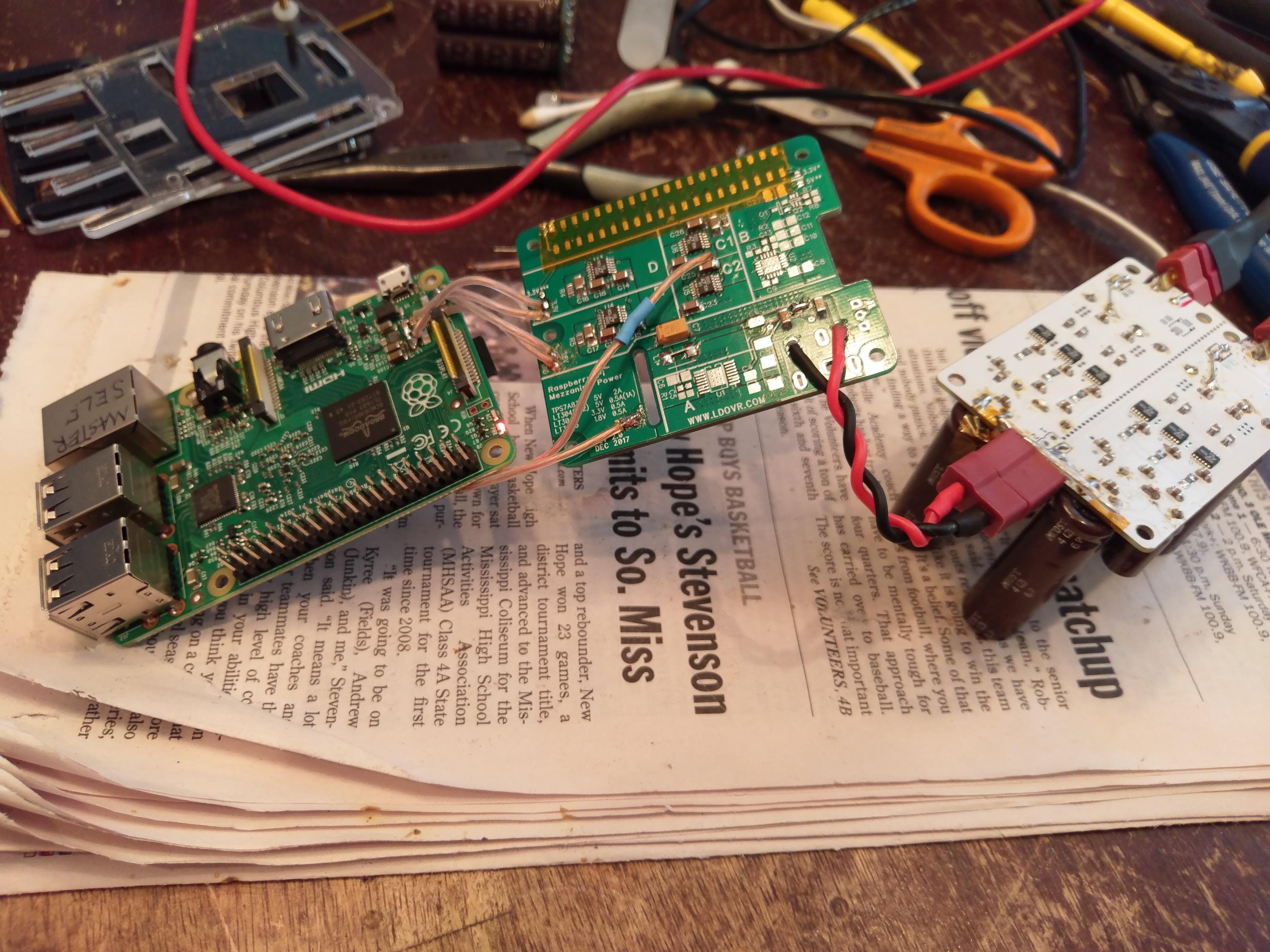

Mezzanine board designed to remove mesh of wires and feed both PI and DAC independently from single board using standard GPIO, Module B feeds Raspberry PI and Module C1 (or C1+C2) feeds DAC module, Module A used as pre regulator

I've been running an RPi source off of a Pi modified with this board to replace the on-board DC-DC switching converters for the last 3-4 weeks. NICE!
IF you want the absolute best SQ you can get out of an RPi sourced setup (at least in my experience... and I've tried a LOT of things), you need to do this to a Pi and listen.

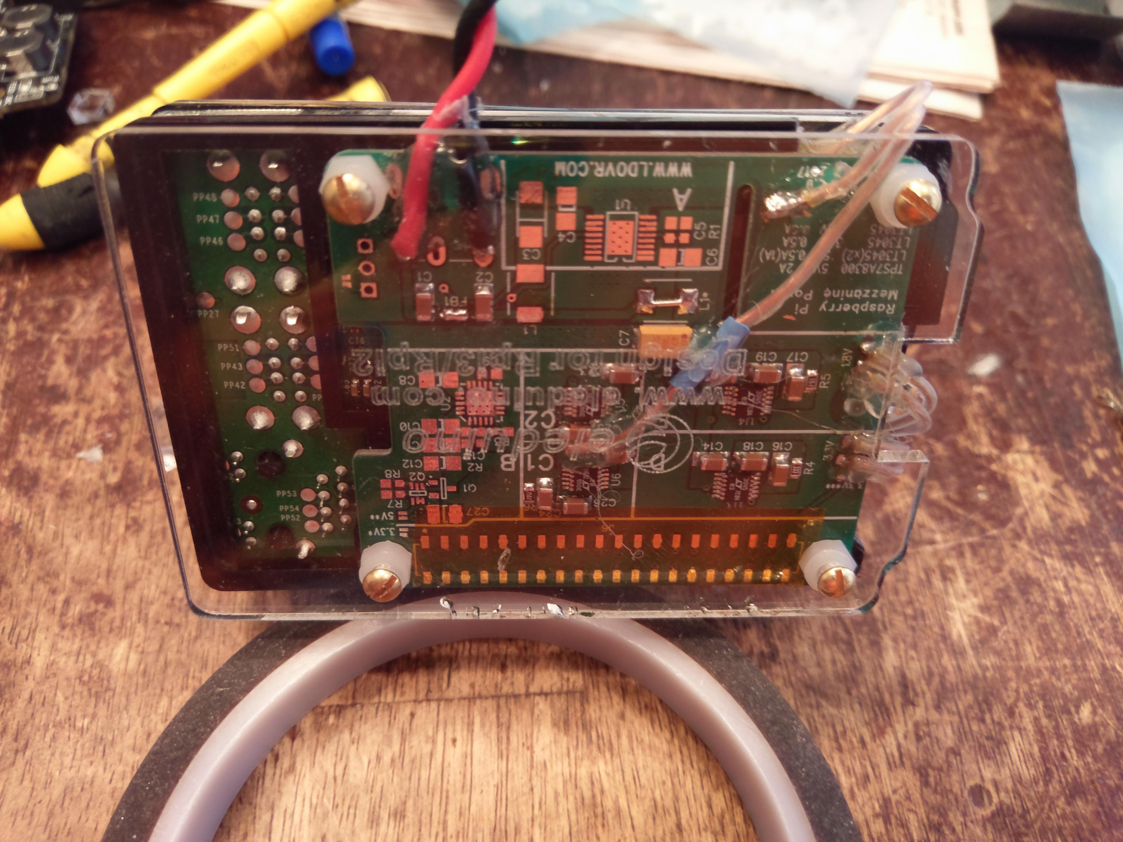

Did you disable the DC/DC convertor or RPI ? I assume you just removed the IC..or a compoenent around it. Did you test the RPI power requirements at 3.3V and 1.8V (ma) ?
Ioan,
I just removed the IC. I haven't gotten the datasheet, I suspect one could disable it too by cutting a lead... but then the rails would be driving the inputs/outputs of the chip.
It is not an easy chip to remove, as it has a large heatsink base. The first couple of times I did it I used a combination of hot air from my rework station and a large soldering iron applied to the top of the chip. The last time I crushed as much of the package as I could remove with pliers and then used the hot-air/large iron combo.
Also the first time I did one, I soldered the leads from the regulator outputs to the output end of the appropriate output capacitors of the DC/DC converter, which I left in place. The 2nd time I soldered the leads to the appropriate test point pads on the bottom of the board which made for a cleaner and more direct connection, but to make sure the leads wouldn't pull the pads, I also used hot-glue to secure the wires and strain relief the build.
I'll post the pictures I used as guides or links to them in other threads later today or this weekend.
Greg in Mississippi

I was checking the RPi3B+ and it seems that it has more power rails than RPI3B..
RPI3B+ connection is different..
Yep, was considering removing the DC/DC chip but it also outputs 1.2V 😱

Thanks to oxothuk, my boards arrived today. This looks like a very elegant solution - thank you!
Now...I would like to get this baby plugged into my pi 3B+. I'd like to replace the onboard 5v, 3.3v and 1.8v with the mezzanine board but I obviously want to leave the 1.2v supply intact - so it sounds like removing the dc/dc converter is a no-no? I'm assuming that I might just be able to lift the appropriate output leg of the chip and then replace it with the new supply?? Can anyone point me to a resource that shows me the best points to inject the 3.3 and the 1.8v? From the posts above I couldn't discerne whether the 3.3v would be supplied via the GPIO or I'd need to solder onto the pi tracks/component somewhere.
Crom
