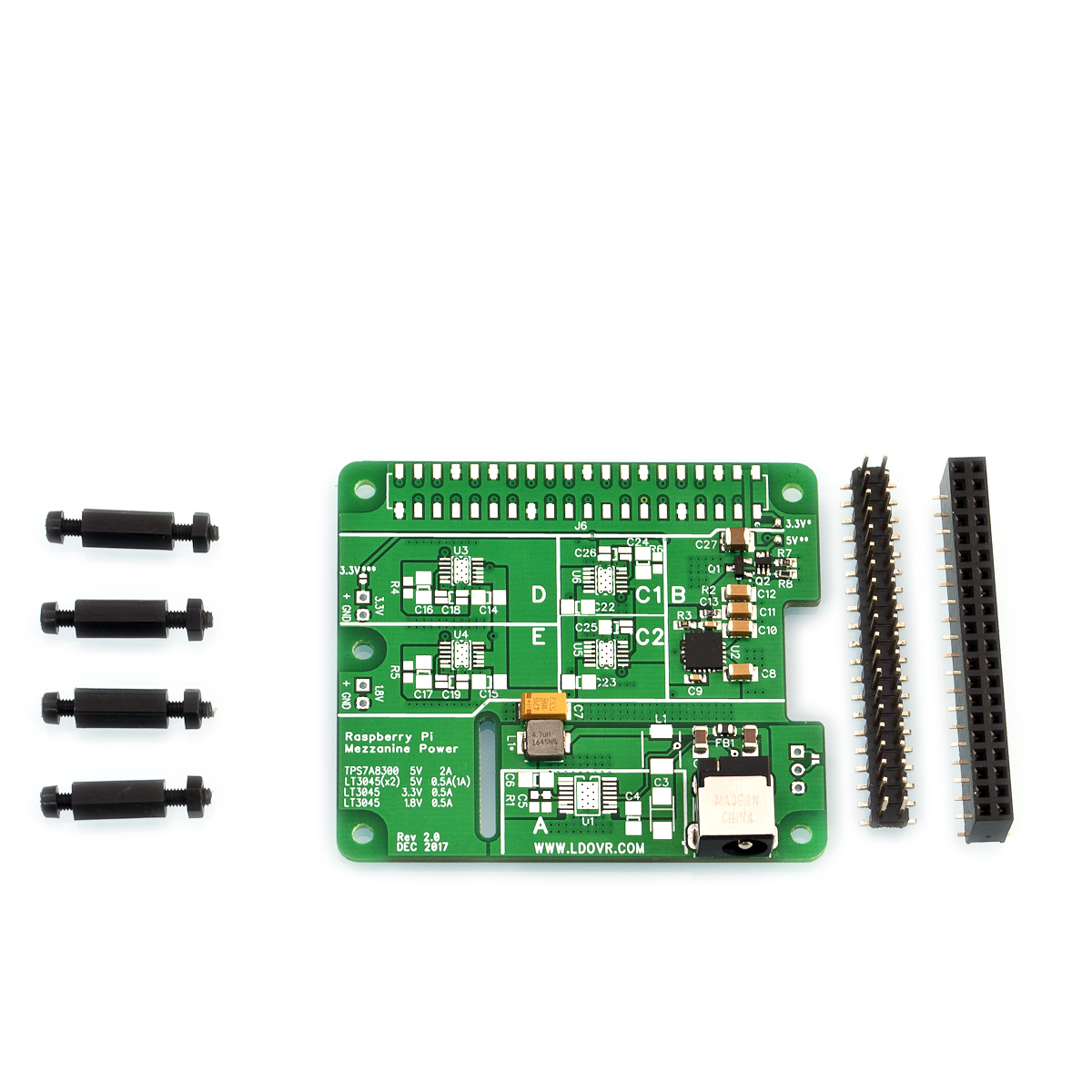

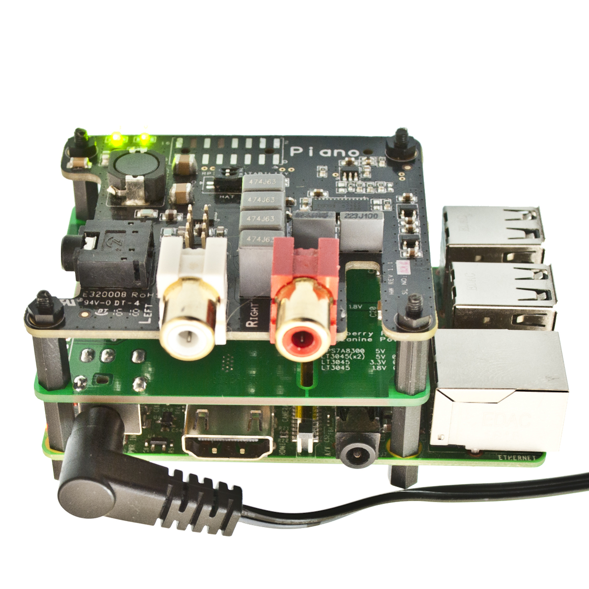

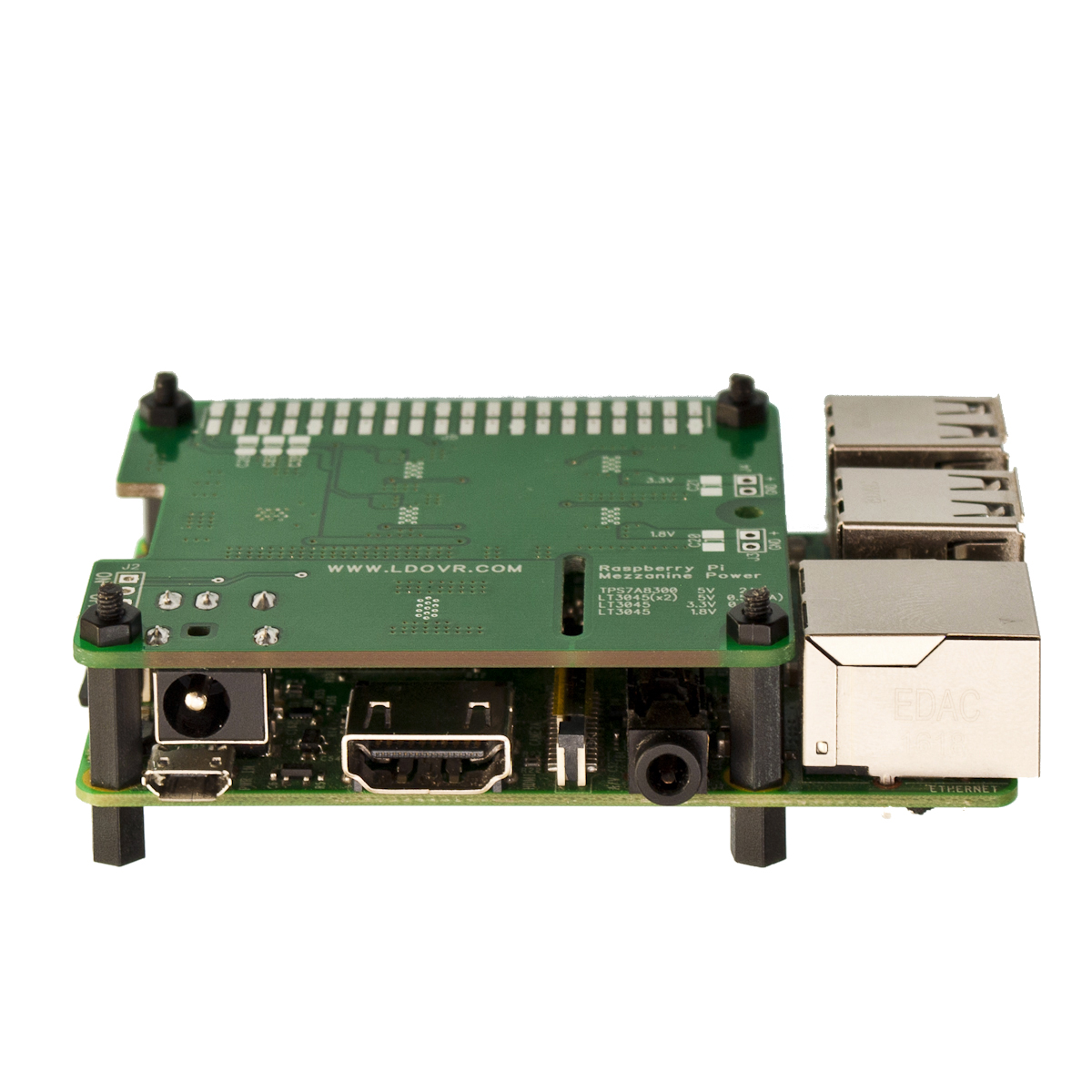

I am using my Raspberry Pi as a network media player and cannot find a simple solution to feed my Raspberry and HAT DAC with quality power. Finally I made a simple board which can be used as HQ power source for both Raspberry Pi and HAT modules, and can be configured according your requirements.

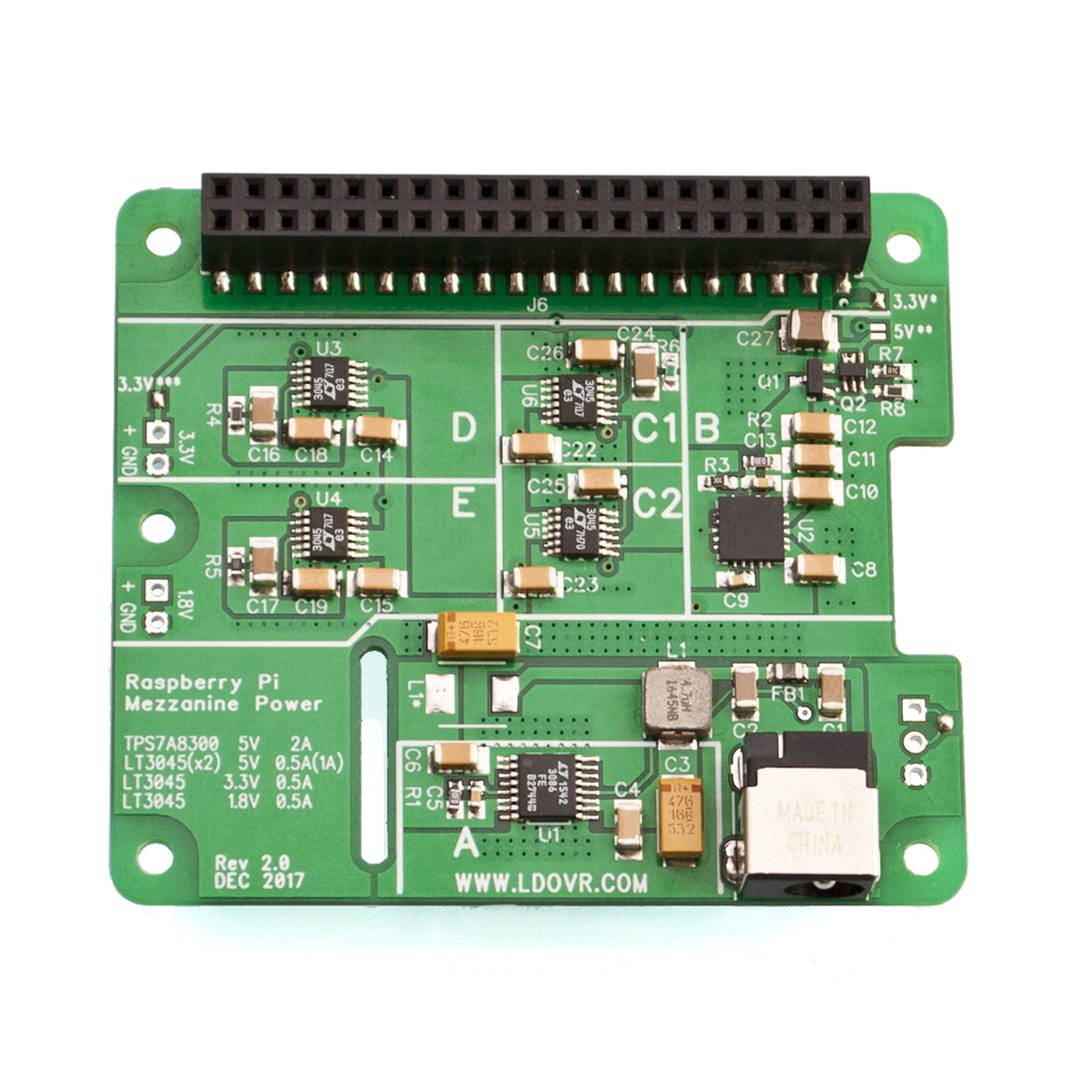

Mezzanine Power Board can be installed between Raspberry Pi and HAT module and can provide up to 4 outputs to power PI, HAT and other devices which might require quality power source.
Module A – LT3086 Linear Regulator, 5.5VDC 2.1A, used as pre-regulator for Modules B/C/D/E, can be bypassed
Module B – TPS7A8300 low-noise, low-dropout voltage regulator (LDO) capable of sourcing a 5V 2A power for Raspberry Pi
Module C – LT3045 based ultralow noise, ultrahigh power supply ripple rejection (PSRR) low dropout voltage linear regulator can provide 5V 0.5A (1A for dual LT3045 C1+C2 installed) for HAT modules
Module D – LT3045 based ultralow noise, ultrahigh power supply ripple rejection (PSRR) low dropout voltage linear regulator can provide 3.3V 0.5A for HAT modules (or can be configured for any output 0-5V)
Module E – LT3045 based ultralow noise, ultrahigh power supply ripple rejection (PSRR) low dropout voltage linear regulator can provide 1.8V 0.5A (or can be configured for any output for 0 to 5VDC)
5V PI rail and 5V Hat rail can be connected together; in this case module B (or C1+C2) can be used to power both PI and HAT boards, same for 3.3V rail (by default it is connected, but if module D is installed and connected to HAT 3.3V rail, 3.3V PI rail is disconnected from HAT rail)

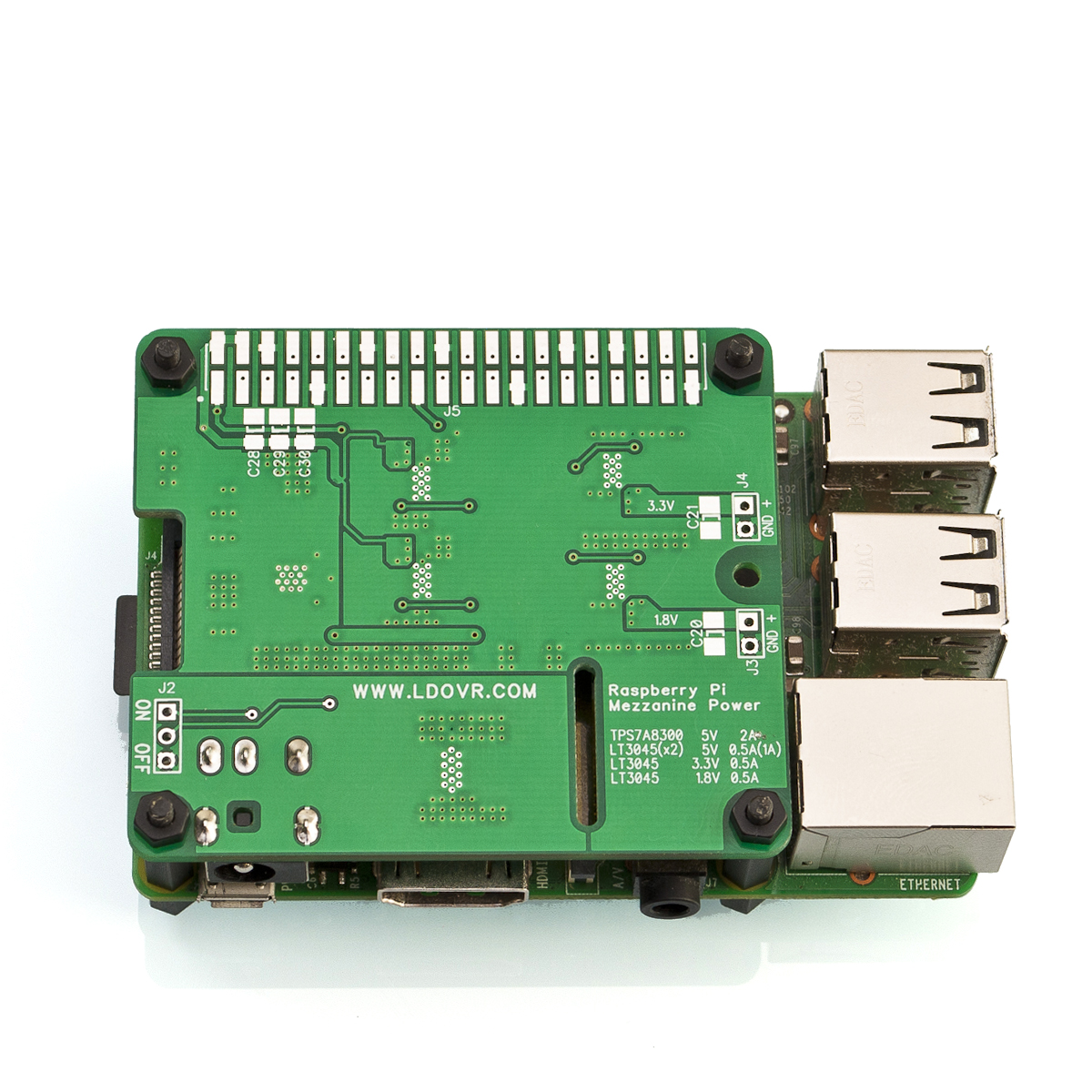

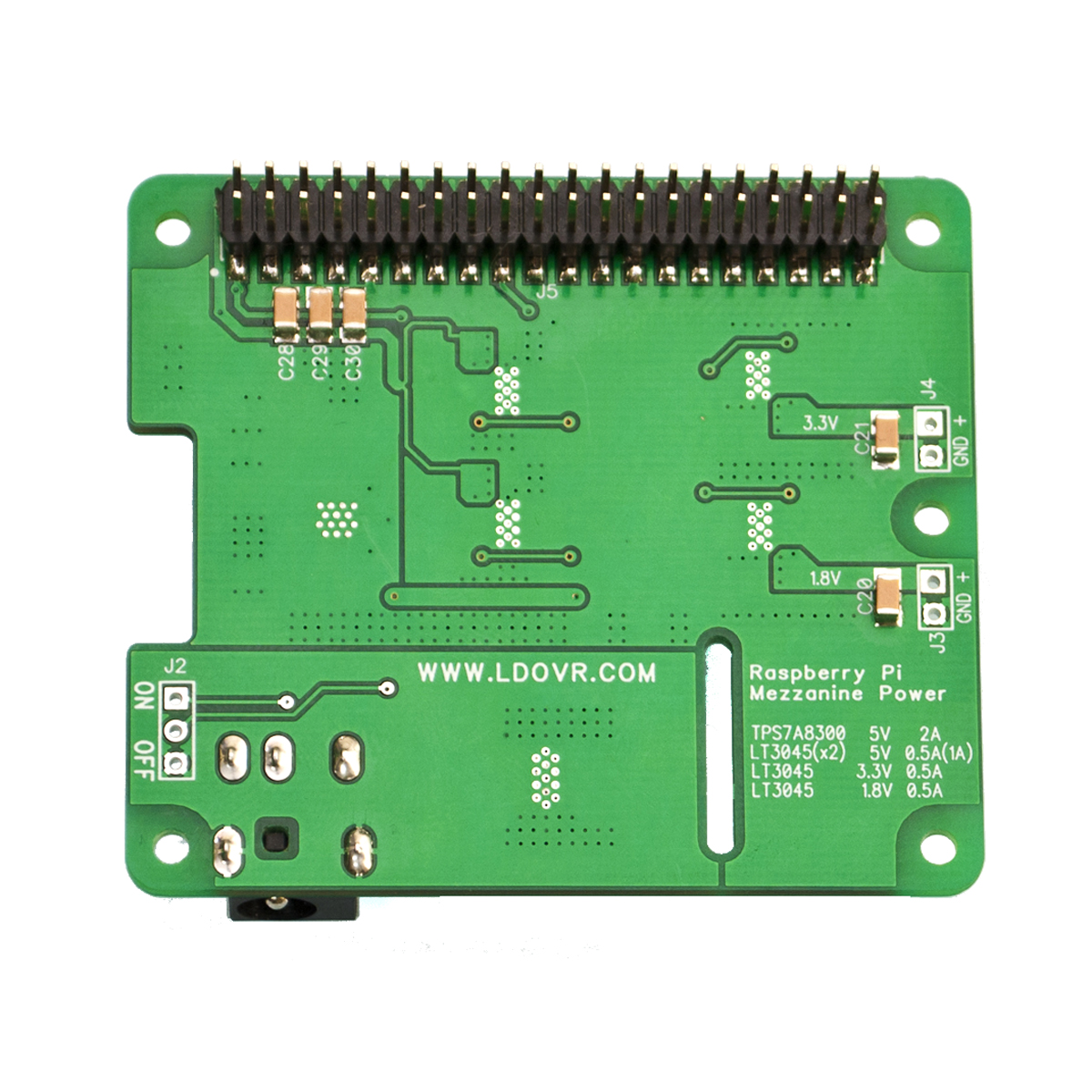

Below you can find some images for the "Light" version (only Module B installed) and "Full option" Board.

I use combo Pi3 + DigiOne, so I order 4 Modules B for Pi3 ,C (C1+C2= 5V1A) + D +E for DigiOne should be OK ?
Hi
Not sure, but seems DigiOne feeded with only 5VDC from the PI GPIO
in this case B and C1 is enough (but again, need to know Digione power requirements), you need to provide 6VDC input.
Please note that Digione have isolated DCDC converter and onboard filter/regulators.
Thanks for your help. I want to supply power for Pi saperate as picture bellow, so is this modules is better than it?. Pin 2,4 of PI GPIO is supply 5V for DigiOne. I think module C1 (1A) is ok for it.

Many thanks. But I just put this board on top of Pi or I have to connect to Pi by wire?
only 1.8V need to be soldered by wire (PP9)
5V and 3.3V connected to PI by GPIO
Sorry again, If I use B replace for C1+C2 OK, because I don't know B and C supply for which pin on GPIO! I need 2A for USB, HDD connect to Pi.only 1.8V need to be soldered by wire (PP9)
Module B connected to PIN 2&4 (PI Side)
Module(s) C1(1+2) connected to PIN 2&4 (HAT Side)
5V PI and 5V HAT rails can be connected together (need to solder small bridge), means either B or C can power both HAT and PI, but with modules current limitation.
If you need to have 2A - use Module B for PI power
