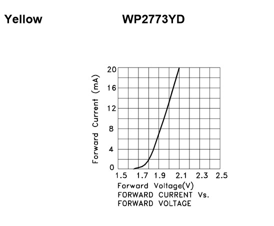

LED matching: You want the group of 5 and the group of 3 to each be as close as possible to the target voltage in the build guide. The individual LED Vf doesn't matter, just the groups.
So the sum of the Vf for the group (of 3 or 5) is what's important? What are the target voltages, or where is the build guide?
Only important thing is you end up with less than 5mV DC offset across the audio outputs. And that is mainly a matter of how close those four JFET guys near the output relay pair together. Pay fair attention to have same number groups of reds that read close in total string voltage. DMM will show less than in circuit Vf in each LED bcs it feeds very little current to save battery. If they average 1.8-1.9V at 5-7mA they are fine. Wanna check that better? Get a 9V bat and light them up through 1K resistor in series, measure VDC across each. Note them down on a piece of paper and lay them next to their numbers. Then pick em up and combine them using a pocket calculator for expected totals first.
This should be obvious but I'm just not understanding.Only important thing is you end up with less than 5mV DC offset across the audio outputs. And that is mainly a matter of how close those four JFET guys near the output relay pair together. Pay fair attention to have same number groups of reds that read close in total string voltage. DMM will show less than in circuit Vf in each LED bcs it feeds very little current to save battery. If they average 1.8-1.9V at 5-7mA they are fine. Wanna check that better? Get a 9V bat and light them up through 1K resistor in series, measure VDC across each. Note them down on a piece of paper and lay them next to their numbers. Then pick em up and combine them using a pocket calculator for expected totals first.
I measured all 50 with a 9V and 1K resistor in series, wrote down numbers and grouped like-values. I'd have to go find the paper but, if I'm remembering correctly, near every LED measured 1.74V, varying only in the thousandths digit. What are the expected totals (sum of the group?) I should be shooting for?
Again, I apologize if this has been answered but I'm not grasping the answer and want to make sure I do this correctly.
If you have any suggestions from mouser, I'm placing an order soon.9.4V for quintets 5.64V for triplets. You got wimpy reds. Try mix some greens or yellows.

Not as a rule. Take a look at the data sheet for the LED Salas referred to above, for example (Mouser part number 604-WP2773YD, Knightsbridge WP2773YD). Specs like dominant wavelength, spectral half-line width, Vf, etc are specified at If=20mA. However, the maximum DC If is 30mA, and peak If is 140mA (duty cycle 1/10, pulse width 0.1ms).

I'll try ordering 50 of the yellow LEDs you suggested, measuring, then mixing in with the reds. I took a look at my notes and all the LEDs ranged from 1.73 to 1.744, the bulk being around 1.73 V. I ordered 50 Kingbright reds from Mouser, P/N WP710A10SRC/E. Looking at the datasheet, unless I'm reading something wrong, Vf is listed at 1.85-2.5V. Mine are nowhere close to that. Did I do something wrong with my measurement? Here is what I did. 1) Fresh 9V battery. -V to Cathode of LED. 2) From +V, I attached a 1K resistor in series, the other end to the Anode of LED. 3) With LED lit, I set my DMM to VDC, ran pos. lead to Anode, Neg. lead to Cathode and noted the measurement. I could understand a few out of spec, but all 50? Surely I screwed something up.
1.73 to 1.74 seems pretty darn close standard deviation.
The range in their spec sheet is usually far wider than production.
Kingbrights generally have nice tight tolerances. If you need to get a little stronger voltage, a couple of green kingbrights will do good.
OK, I'm ignorant AND Mouser illiterate. Any suggestions for greeen Kingsbrights from Mouser would be great. Might as well add some more things to my BOM. It's only money, right? 🙂 At least the board will look cool. Like a mine Fremont Street.

dodog:
You don't need to over-think this. Using the recommended parts will yield a working preamp.
However, look at the graph Salas posted. We are running the LED's at a few mA, so they are going to have a Vf that is lower than spec (which is @20mA).
Look at the curve Salas sent to understand the V/I relationship of an LED.

yes, you screwed up.I'll try ordering 50 of the yellow LEDs you suggested, measuring, then mixing in with the reds. I took a look at my notes and all the LEDs ranged from 1.73 to 1.744, the bulk being around 1.73 V. I ordered 50 Kingbright reds from Mouser, P/N WP710A10SRC/E. Looking at the datasheet, unless I'm reading something wrong, Vf is listed at 1.85-2.5V. Mine are nowhere close to that. Did I do something wrong with my measurement? Here is what I did. 1) Fresh 9V battery. -V to Cathode of LED. 2) From +V, I attached a 1K resistor in series, the other end to the Anode of LED. 3) With LED lit, I set my DMM to VDC, ran pos. lead to Anode, Neg. lead to Cathode and noted the measurement. I could understand a few out of spec, but all 50? Surely I screwed something up.
The Vf is dependant on the current and the temperature.
The manufacturer usually specifies the current and the temperature for the specified Vf.
If you change one or both of the operating conditions then you will not replicate the specified Vf.
