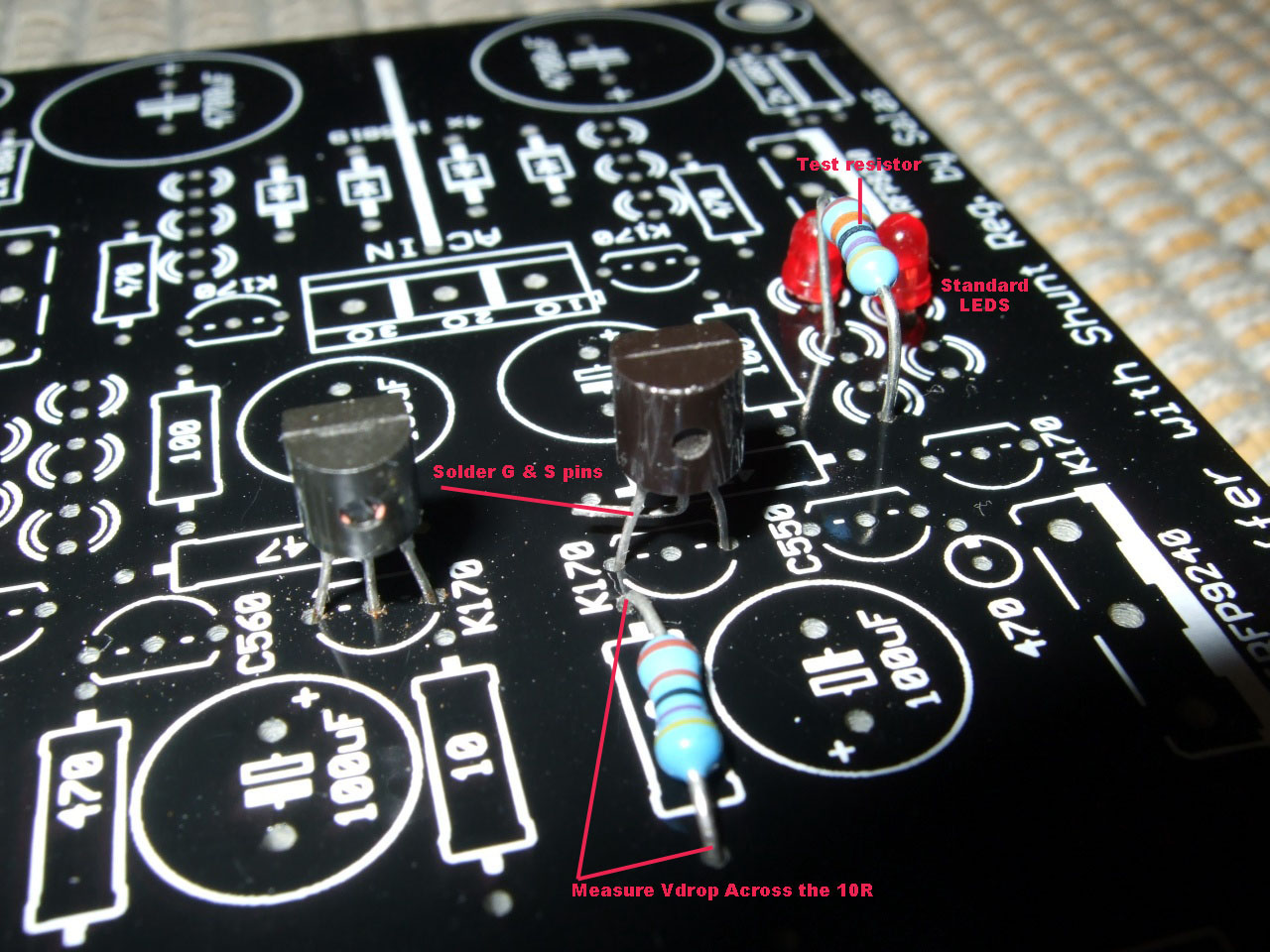

Do this first (leg trick). Only the K170 thing in the pic.

Ow, something is not ok I think:
Left signal out 1.8MV
Right signal out 35.8MV
That's not good is it??
Its not good. Lets hope its only due to the rail differences for now.
Yes, and stick it to S pin above board with little solder. Talking for only the one K170 pictured that belongs to the IRP9240s side.
One side is now 0.2MV
The other is 33.02MV
What could be the problem???
So in the good offset channel its even better but in the bad offset channel its still high. What are the DCV measurements on the power rails now?
OK, much better, keep that mod. But..the main problem was not coming from the rails difference it proves. Now the audio signal JFET pair in the right high offset channel is under suspicion. Maybe one of the two damaged or grossly mismatched. Pull them out and remeasure their IDSS.
The thing is that when the rails are good then only those two are powered by them in the audio path. So they are the ones to check now. Did you measure their IDSS before stuffing them? Because if they were matched, then only soldering too hot could damage one and the offset. One pair in left channel is champ and they use the same power rails...
