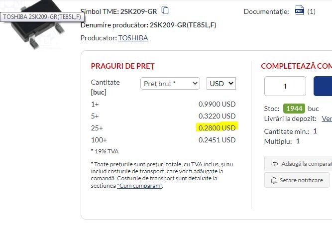

There are no differences so you can say that you can hear the colors in addition to the sounds.
It is unbeatable at this price!
