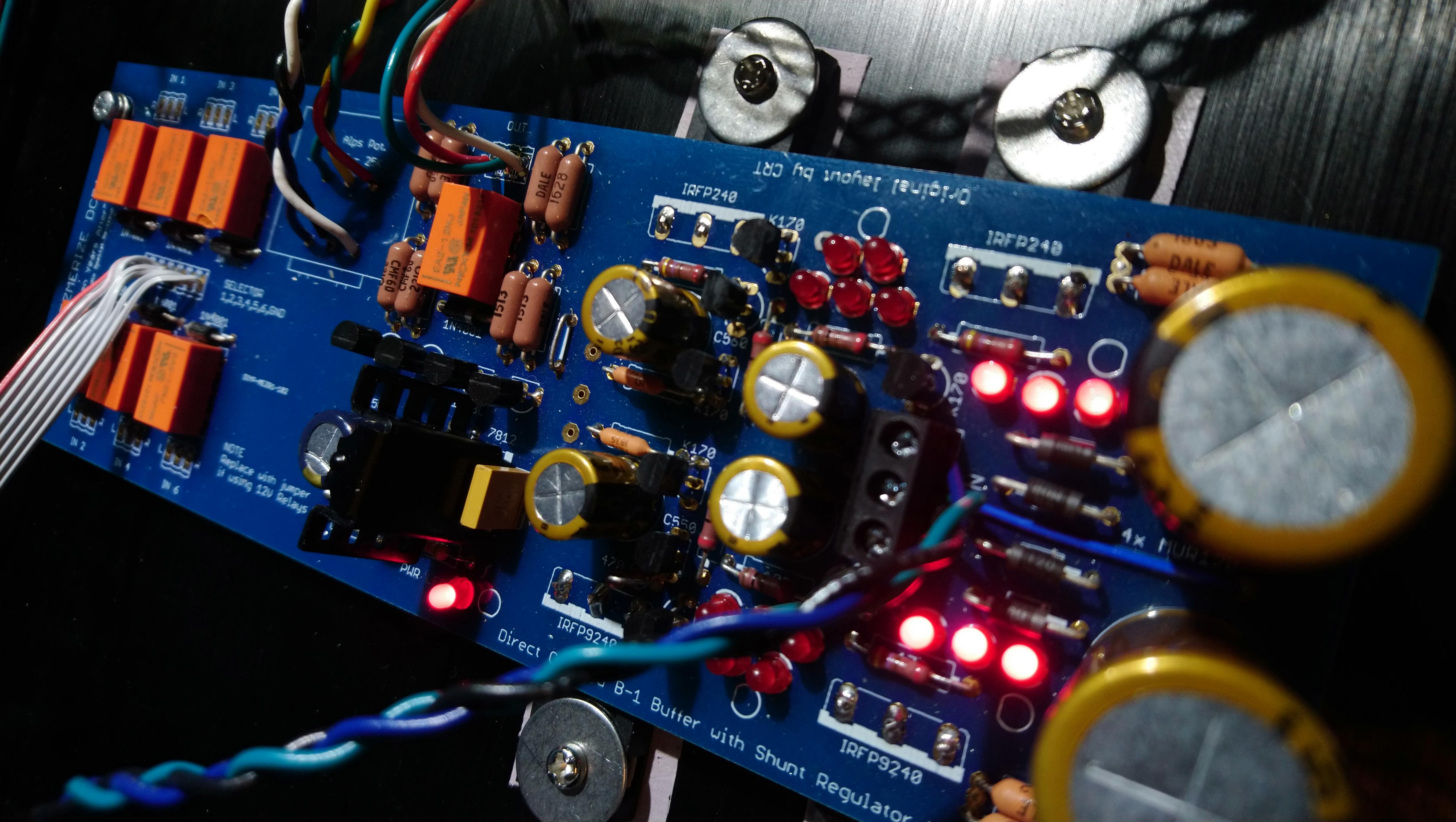

I'm guessing that I have done something wrong if the 2 x 5 groups of LEDs are not lit.
Even only one wrongly oriented or grilled during soldering is enough to break the chain. Fortunately you can test them before desoldering anything. A DMM that has enough voltage to turn on an LED in diode test mode or a 9V battery with two wires to briefly touch their pins at the bottom layer and see which ones light up and in what direction.
Also given the opportunity since you will lift the board, check again that the MOSFETS are the right types at the right sides as printed on the board near each one's pads.
Are the two MOSFETS near the lit triplets mildly warm? There should also be voltage drop already across the 18Ω resistor pairs at the sides of the reservoir caps. By the way, recheck that the BC550 is not a BC560 and vice versa while you are at it.

I think I know what I have done (at work atm and looking at the pic, I think I have one of each mosfet on each side of the board. Will check tonight when I get home.
