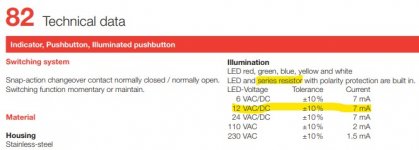

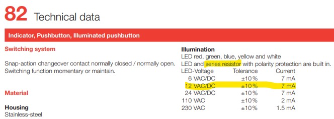

So I think I've settled on the EAO 82-series switch (model# 82-5151.2123); it feels the best of the three I ordered. According to the spec sheet it also does have a series resistor in place; the manufacturer recommends 7mA of current. (See attached.) So in theory, I just short out the 2.2k resistor near the PWR LED and wire the switch up directly? Are there any tests I could/should run with a multimeter (or whatever else) beforehand so I don't accidentally burn it up?

Hello, I don't think there are any construction videos. Yes, if it has independent pins for that you short out the 2.2K and you wire from the pwr led position which effectively becomes a 12VDC outlet. Unless it steals current internally from what it switches. If you have a lab supply set it at 10mA CC mode (current limit protection) and 12V DC to test it in safety on its + - illumination pins.

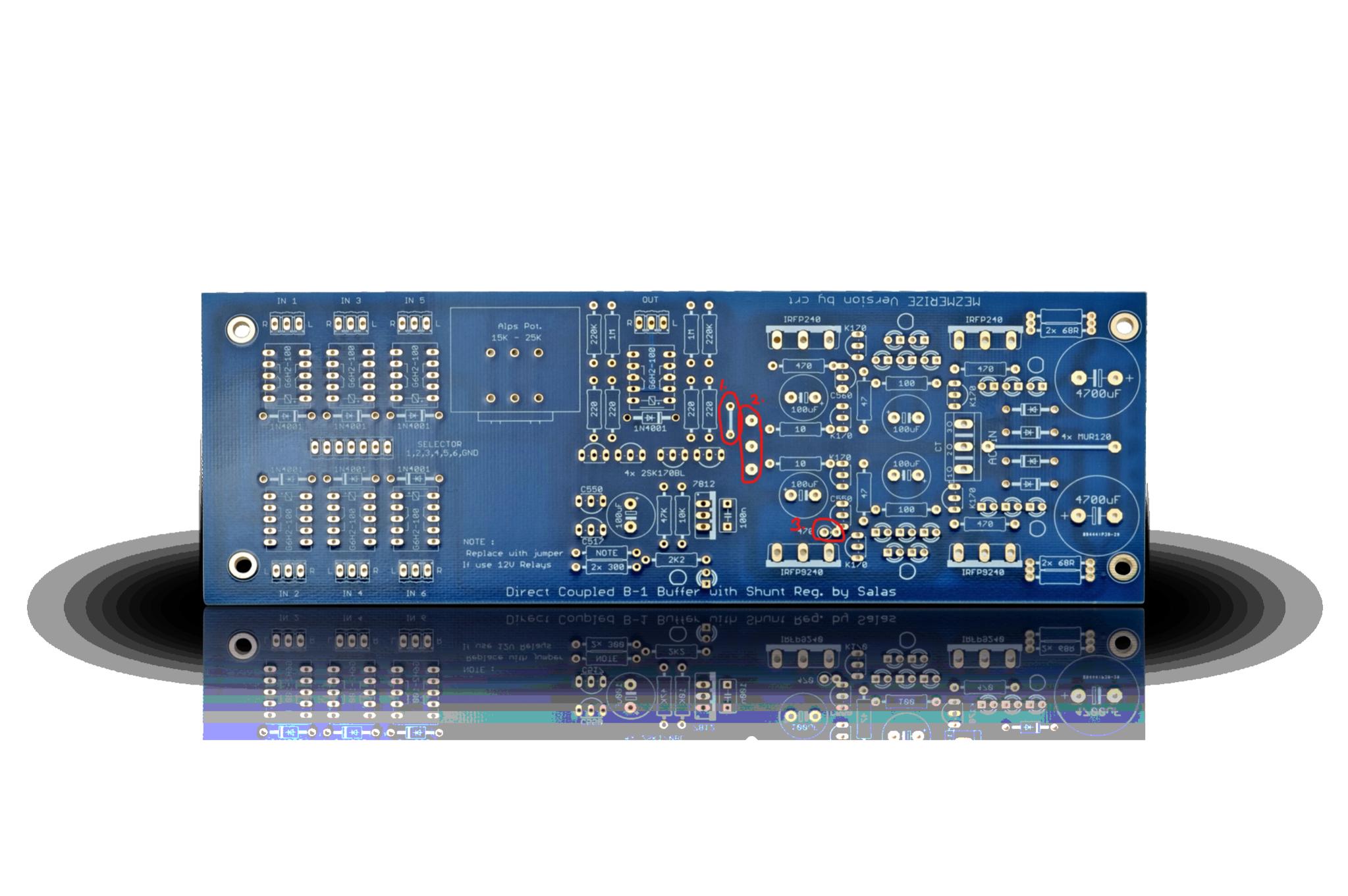

A few questions regarding the layout (#1-3, see highlighted sections in 1st image) & additional questions (#4-6)...
Thanks again as always.
- Do I just jumper/short this section (like the jumper between the MUR120s)?
- What's this for? For verifying the voltages? If so, does it go top to bottom: V-, G, V+?
- This is the vertically mounted resistor, correct?
- Is there any benefit to upgrading the 100uF caps with something like UKZ1E101MPM (I believe the original BOM said 25V caps was sufficient) or UKZ1H101MHM?

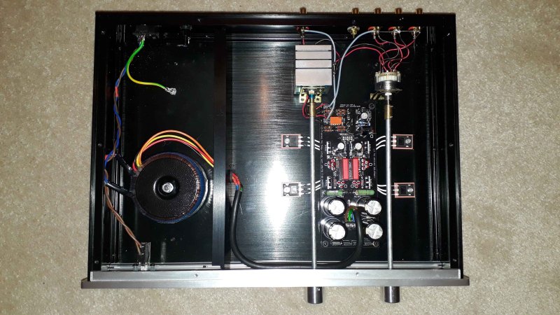

- The two heat sinks are for the 9240s, correct? What's the method to attach the HS to the chassis? (Sorry, I'm new to all this.)
- Alternatively, in someone else's build, looks like they mounted the 9240s on the chassis floor (see 2nd attachment below). Additionally, it looks like they even used wires as an extension. Will this degrade the audio quality?

@gwolfman
1. Its an already connected section in dual layer Mezmerize blue boards (not in legacy single layer black boards) but its reinforcement with wire jumper is also welcome. That portion is the ground lane's thinnest travel section.
2. Yes, its mainly for verifying voltages. Or to tap off regulated DC for low consumption utility circuits, but not recommended to do that if not having the instruments to check that no interference has been introduced on the rails.
Also, in older days before I had general use shunt PSU projects out there (SSLV1.1_BiB/SSLV1.3_UltraBiB) some people used the Mez board for its shunt PSU section alone to power other projects. They liked this shunt PSU's character in many apps, not for what it brings to the Mez only. Few left hand side signal select and JFET buffer major board areas simply got hacked off and ended up in the bin back then...
3. Correct
4. Subjective area. If keen for detail you may replace types there, then listen to your system's synergy in personal taste and decide. Yes, 25V is enough for the 100uF caps. If you have good rework skills and tools it can be a very easy and clean swapping job. Or you can put small female pins while using cut to short legs various capacitors for listening back and forth with until you decide. Mind you that's a sure recipe for developing audiophilia nevroza
5. Absolutely essential to insulate the MOSFETS for sinking in common metal between them. Else kaboom! You need TO-247 sized insulator pads as listed in the 2018 BOM or alike. Not insulated screws and nuts though because such type MOSFET cases already offer an insulated mounting eye area. In the end you better test your assembly work for there is no continuity beep with a DMM's special test mode for shorts, when touching the probes between a conductive chassis point and each MOSFET's middle pin successively (do that before powering on).
6. A substantial chassis is also good for sinking this project, (run as BOM standard), instead of dedicated sinks. If must have MOSFET pin extensions, not obvious degradation occurs before the length of extension wires passes a critical point and PSU oscillation appears. Wire self inductance is not good news there, although this design has some degree of tolerance in matters practical, its not meant to be abused either. If you have no oscilloscope and experience in its use to verify the rails are clean from oscillation, better don't modify with extension wires when avoidable.

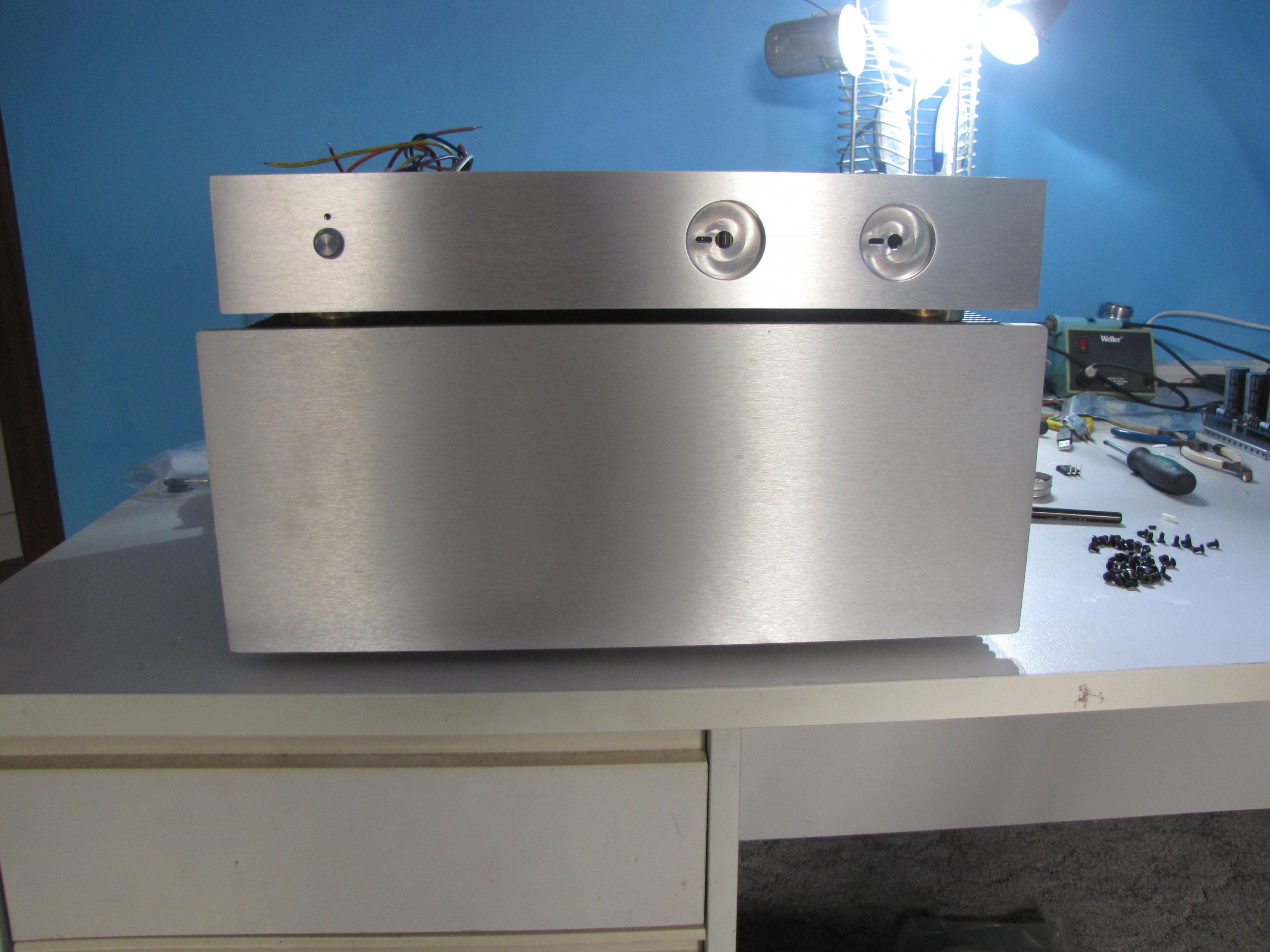

Decided to use this case for mine, should go well with the M2X.
Full Aluminum Amplifier Chassis Amp Enclosure Preamp Box 425*70*313mm | eBay
I will need to drill a few more holes for the other 2 input channels, I really like the idea that it has the shielded compartment for the PSU.

2W dissipation per Mosfet i.e. 4W per side. 3mm alu chassis floor will do, not even needing the pseudo heatsink side. Unless you must mount it on the side if it fits. Or 3C/W heatsinks like FISCHER SK 81/ 50 SA, Aavid Thermalloy 0SY76/100/N etc.
