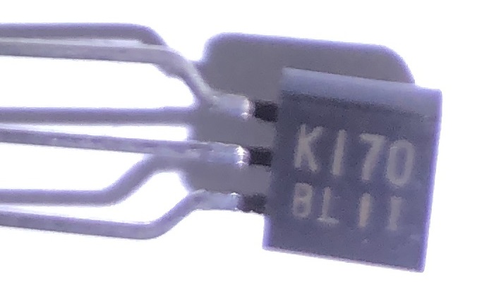

Salas i got the 2sk117gr that you mentioned for the power supply. I measured them and got four at 6.4 idss and two at 6.6 for the strongest ones. are these good enough?. I have found some 2sk170 and can get them if they will be better. Thanks bubba177
himmel_shop in Germany as previously mentioned on ebay supplied me with a quad of 2SK170BL said to be Toshiba which were claimed matched to 1%. They are marked k170BL1I (I think). I don't know what this means but the packet says they are 7.43mA.
I have just tested them as suggested they are 3x 7.43 and 1x 7.50 so that sounds good.
I don't need to use them because I sorted my original set out.
I am just posting for information - does anyone have an opinion on these?

my macro photography skills are challenged - lets see if this attachment works
