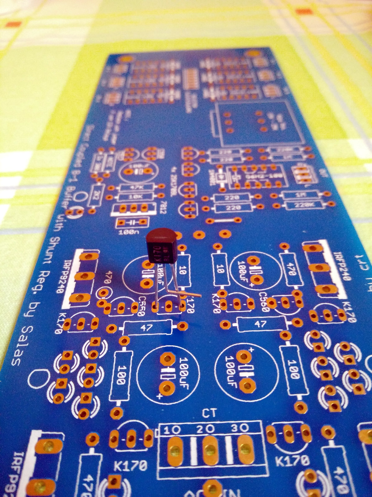

6. the LEDs are all lighting up at a reasonable intensity, but the positive set are noticeably (but not worryingly) brighter. I assume that's just the difference in the supplies and to be expected?
6. That's normal. The Mez is rigged to do that. Plays better now that it runs low CCS mA with that planned asymmetry. When you will go higher mA with lower Ohm setting resistors its no longer necessary, and you can perform this "leg trick" to restore equal LED currents. Lift the middle leg of that JFET only, bend and solder it to next leg on its right, as in the attached picture. Actually since almost everybody uses higher than lukewarm CCS setting I will be undoing that inherent asymmetry in LED currents on next opportunity of a newer diyA boards batch.
I've been continuing to tweak my build. I'm a little embarrassed to post pics as the wiring isn't all tidied up yet and I've had to shoehorn it into a grubby salvaged chassis until I can stretch to a new one and all the associated metal working kit. It will come though.
I did the leg trick, but I'm concerned I've damaged the transistor. Everything tests just fine except I'm now seeing 1.75V across the negative shunt resistor and 2V on the positive. That ok or should I replace the transistor? I've read many millions of posts on the Mez and related boards but I never did find the leg trick info, just references to it, so I'm flying a little blind.

Its due to different VGS between NMOS & PMOS. Higher VGS leaves less voltage across the setting resistor when subtracted from the three LEDS Vf total. You can use a lower Ohm setting resistor or combination in the lower achieving side. Like 8.2R vs 10R on the higher side. But 25mA difference does not change the transconductance of those big MOSFETS any significantly. More a matter of matching measurements aesthetics.
