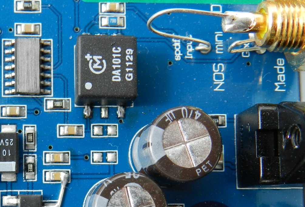

That's a helpful pic, thanks. I note a couple of things - the tracks to the Murata trafo run close to the ground plane - there will be some stray capacitance there to the plane. I don't see where the secondary of the trafo goes to - is it going to a differential input receiver? Or is one side of the trafo secondary going to the plane? If so, then that's one point to lift from the plane and wire back to the input 0V.
Here's a pic from a different angle. One side indeed goes to a plane. But this is a six layer pcb, so it might very well be that it's star grounded after all. Lots of layers to put planes in.

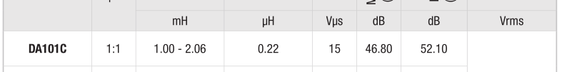

Murata doesn't tell us what the interwinding capacitance is in the datasheet. Lower is better when considering CM noise.
Well, here it says 52.1 without unit but I'm guessing it's pF. With respect to the SC937-02 that would seem excessive...
Yes but the point is - its noisy. Keep it to its own dedicated ground wire or the noise spreads around. Its via'd into the top ground plane - a big no-no for noise. Lift the right-most pin on the trafo and install a dedicated ground wire to it.
It says dB just above 😀
