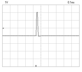

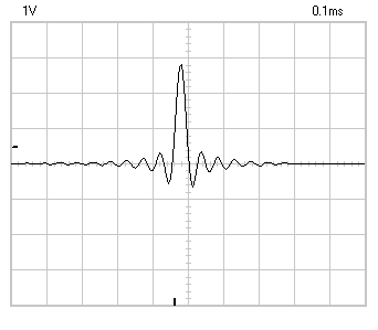

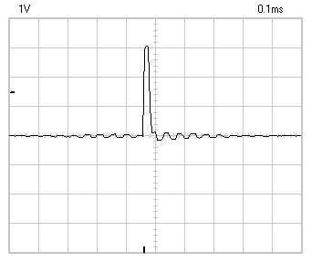

Interesting, time to take out the DSO again see if I can measure any difference.

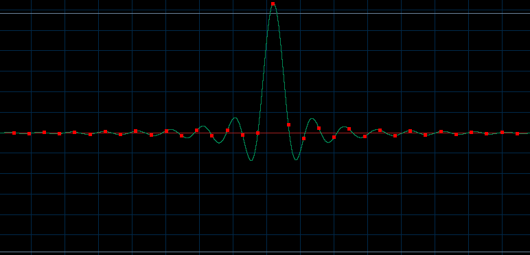

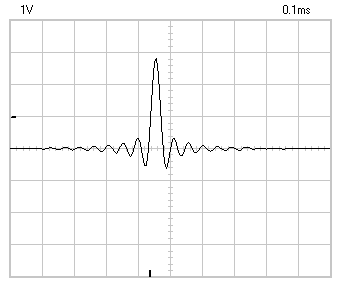

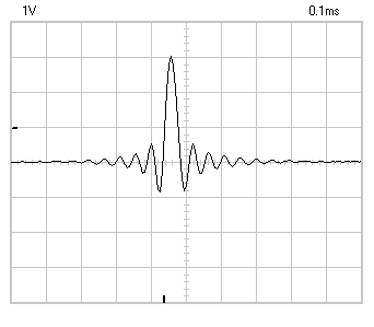

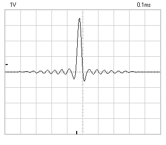

I have a 99 track Denon Test CD from 1993 (EC 3991-2), track 59 features an impulse recorded at 0 dB.
I ripped it to HDD and looked at the waveform in an ancient version of Cool Edit. At first it looked like there's indeed a lot of ringing in the waveform, but then I realized that the red dots are the samples and the blue line is what the waveform would look like after DA-conversion. Cool Edit shows the reconstructed analogue waveform with the dots where the actual sample was. Double-clicking on a dot shows the sample value of that dot in the decimal system.
So, if you ignore the blue line and connect the dots with straight lines, there's still ringing, but the amplitude is nowhere near as high as it would have been after DA-conversion. In other words: AD-conversion does create ringing, but not as much as DA-conversion. This should show on a measurement with my DSO.
It does, look at the results. It think this might answer the question why NOS may sound better despite (some) ringing in the AD-conversion stage.
From left to right:
- Waveform displayed by Cool Edit as if it were already DA-converted the traditional way;
- Octave, 44.1 kHz, only the ringing from AD-conversion;
- DAC1, 44.1 kHz, added ringing from DA-conversion OS-style;
- PDR-555RW, 44.1 kHz, added ringing from DA-conversion OS-style;
A bit off-topic, but I found out this way that the Micromega DAC1 has phase inverted on the unbalanced analogue output. To correct, I used the digital phase inversion-fucntion on the DAC1.

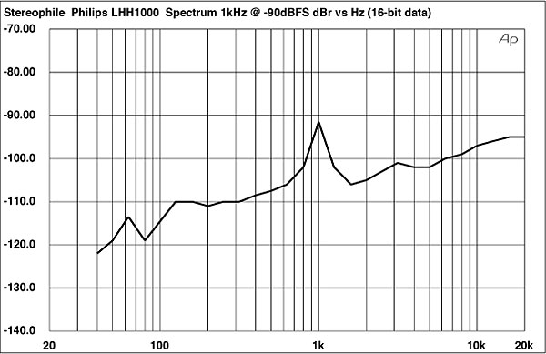

Here the graph from the same test set at stereophile you appropriated yours from:
I do not wish to to be rude, but looking at this I though to myself: "W. T. F. is THAT!?"
The first thing we observe is that there is actually more HF-Noise (HF here used in the technical sense of "High Frequency" as compared to AF which means "Audio Frequency") than there is signal. At least I personally would call that "Lots of HF noise"...
What you should really see is the same plot at 0dBfs. A beaut, 10dB more HF-Noise than actual signal! I know a fair few Amplifiers that will not be very comfortable with such a signal. In fact almost any Solid State Class AB Amplifier is going to have a hissy fit if you feed it THAT kind of signal. My own Amp's actually would not mind, but that is another story.
Another way would be to call all this HF stuff "200% added HF distortion". Of course, added HF distortion of as much as 30% is the very crime that "Non-OS" DAC's are routinely charged with... :D
The second thing we observe is the shape of the -60dB Peak, which is smeared all over so that -100dB it already covers well over two octaves. I like to call the cause of what this this graph shows "Fuzzy Distortion" (as opposed to the distinctly separate phenomena of jitter) and it is indeed inherent to the use of a 128 Level at 44.1KHz (that is a system that without noise-shaping is equivalent to 7 Bits sampled at 44.1KHz).
To be honest, any PCM System that measured like what is shown above I would consider "defective by design". Of course, it is not "revoltingly bad PCM" but instead "Super Audio CD", so it has to be good, after all it SO SUPER compared to CD with it's 16-Bit's at 44.1KHz and anyway, what is a 9dB shortfall among friends?
Let us compare this with a "State Of The Art" result for CD standard PCM, that is state of the art in 1989, in the form of the TDA1541 equipped Philips LHH-1000 (which is incidentally one of my references):
While this shows -90dBFs, the noisefloor of this system does not change with signal levels above 1LSB, we can see it offers around 6dB improvement over SACD at 20KHz. Moreover, we would find a much, much narrower peak at -60dB than with SACD,
This should actually not surprise anyone who understand a minimum about digital audio.
