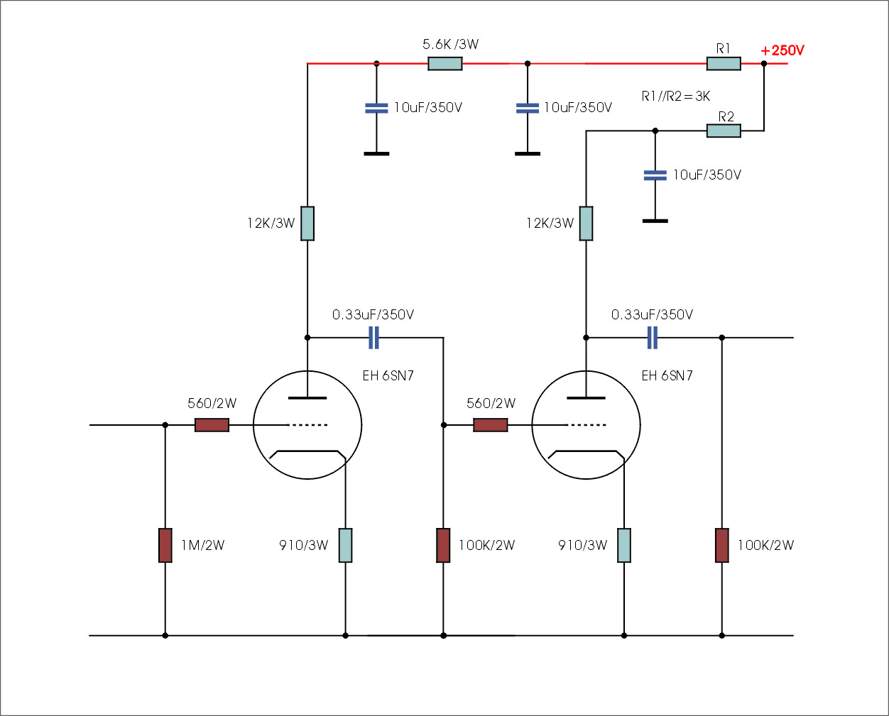

Thank you David, if you can design the automatic computing program to the more complicated ones, there is a circuit diagram with two-stage power supply coupling for calculation, then almost all problems are solved. We look forward to your new version of calculation tools.
In the following circuit, I can only perform approximate calculations at present, and I haven't found a method that can be calculated accurately.
This is just an example for calculating the work point of DC, which does not mean that there will be such circuits in reality。

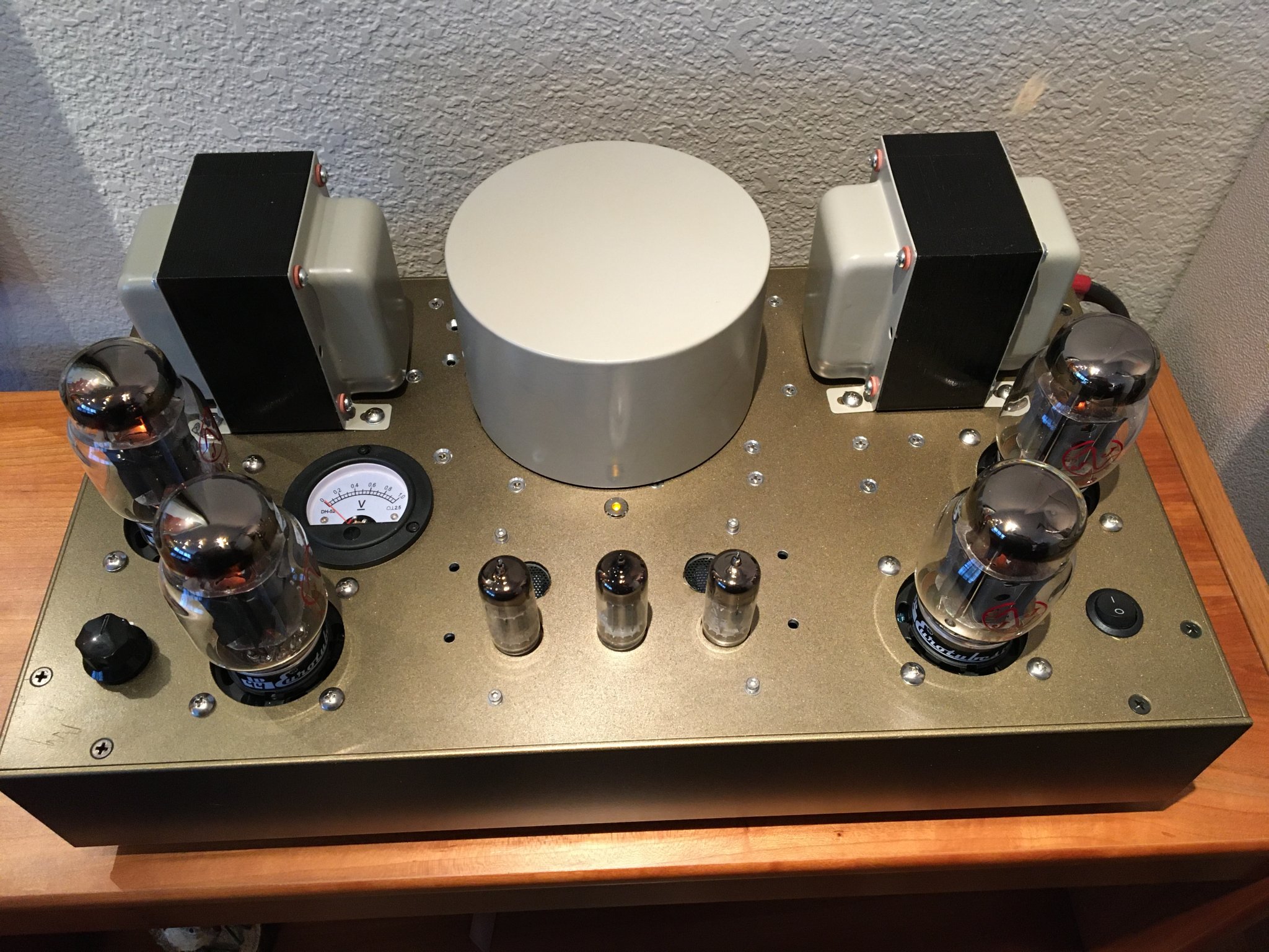

I apologize for my lack of clarity in writing. I am not the designer of that clever simulation program, only a user of that program, like your club members.
My understanding of tube design is very limited, and I learned just enough about tubes to build an amplifier that is a modification of an existing design.
It is the only work I have done with tubes, and my wife is glad I did not electrocute myself!
Your circuits look interesting, but I do not have enough knowledge of tube design to make educated comments.
Glad to hear you and your club members use that program as well. Hopefully, the user group at that website can discuss your interesting ideas to further the development of that program.

it is my mistake. I didn't read your text carefully, please forgive me. I believe you will make perfect amplifiers for you.
Yes, it is a very cool program. It brings me and my friends with high efficiency and simplified design to DIY so many tube amps, which brings us a lot of fun. I hope they can improve better program.
And your amp looks so beautiful!

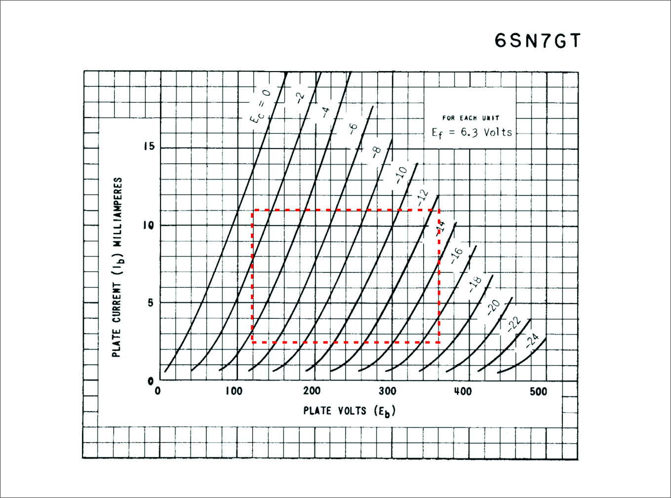

After a long time of experience, we believe that choosing an anode working current value in the red line area is easy to get accurate results. Below the red line area, the magnifying curve is bent. On it, the width of the voltage is not enough, and the working point may fall outside the work area. You may need to re -select the point again. On the left side of the red area, when the grid voltage is lower than -1V, the grid current will appear in 6SN7.

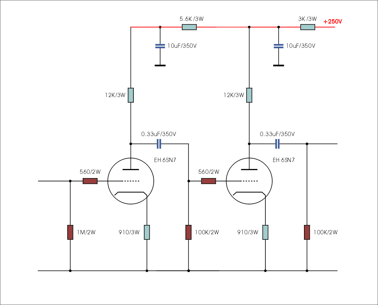

Now, our calculation method is to decompose the above circuit diagram into an equivalent circuit below.
The illustration method can only be calculated here, and the current in the first two graphics methods is decomposed into equation variables, and the interpretation of the equation group is to obtain an accurate first and second -level anode current value.
