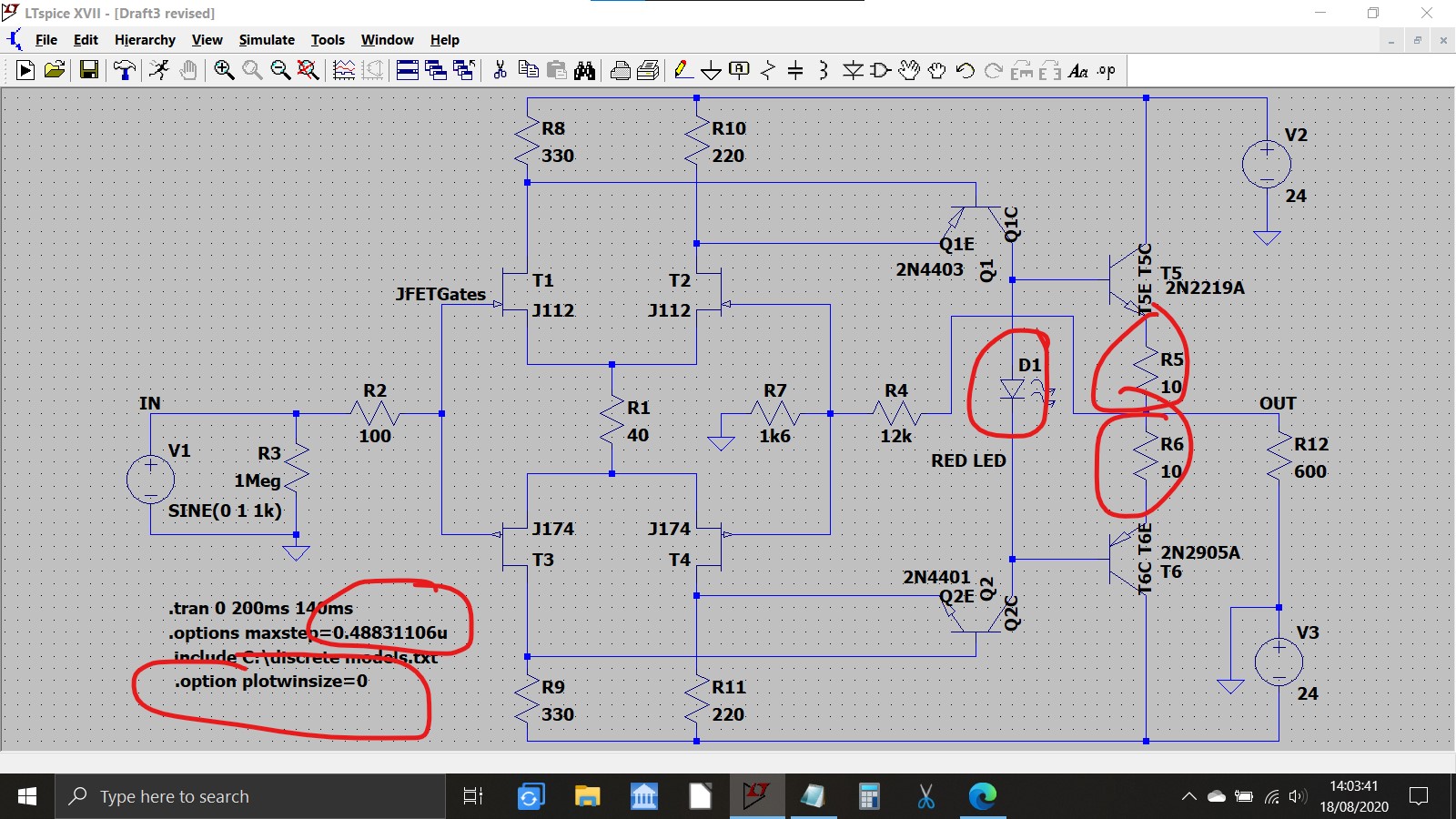

You need to look at the distortion with a realistic load. A single diode will not allow any quiescent current to flow in the output pair.
The two diodes are to reduce the take-over distortion.
If possible try to reuse the original fets, they need to be matched.

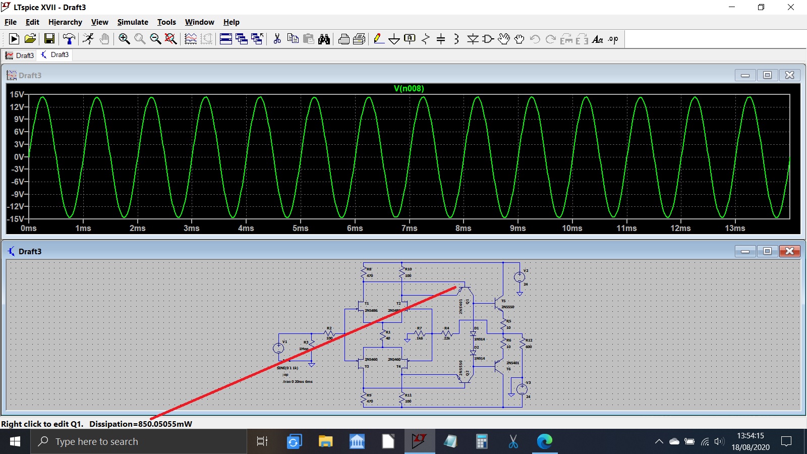

I tried the circuit as a sim and you definitely need to look at the biasing of the output stage. Two diodes give around 8ma current in the sim which is still not very much. Another option could be LED and tweaking of the 10 ohms emitter resistors.
Q1 and Q2 are the devices seeing all the dissipation 😱 nearly 1 watt each. That would be hot in an encapsulation and seeing that could well point to those devices being the original issue in practice. Those FET's could be mission critical on the original design to get the currents the designer intended.

Changing R8 R9 to 330ohms, R10 R11 to 220 results in Q1 Q2 running at about 135mW dissipation. (no signal applied)

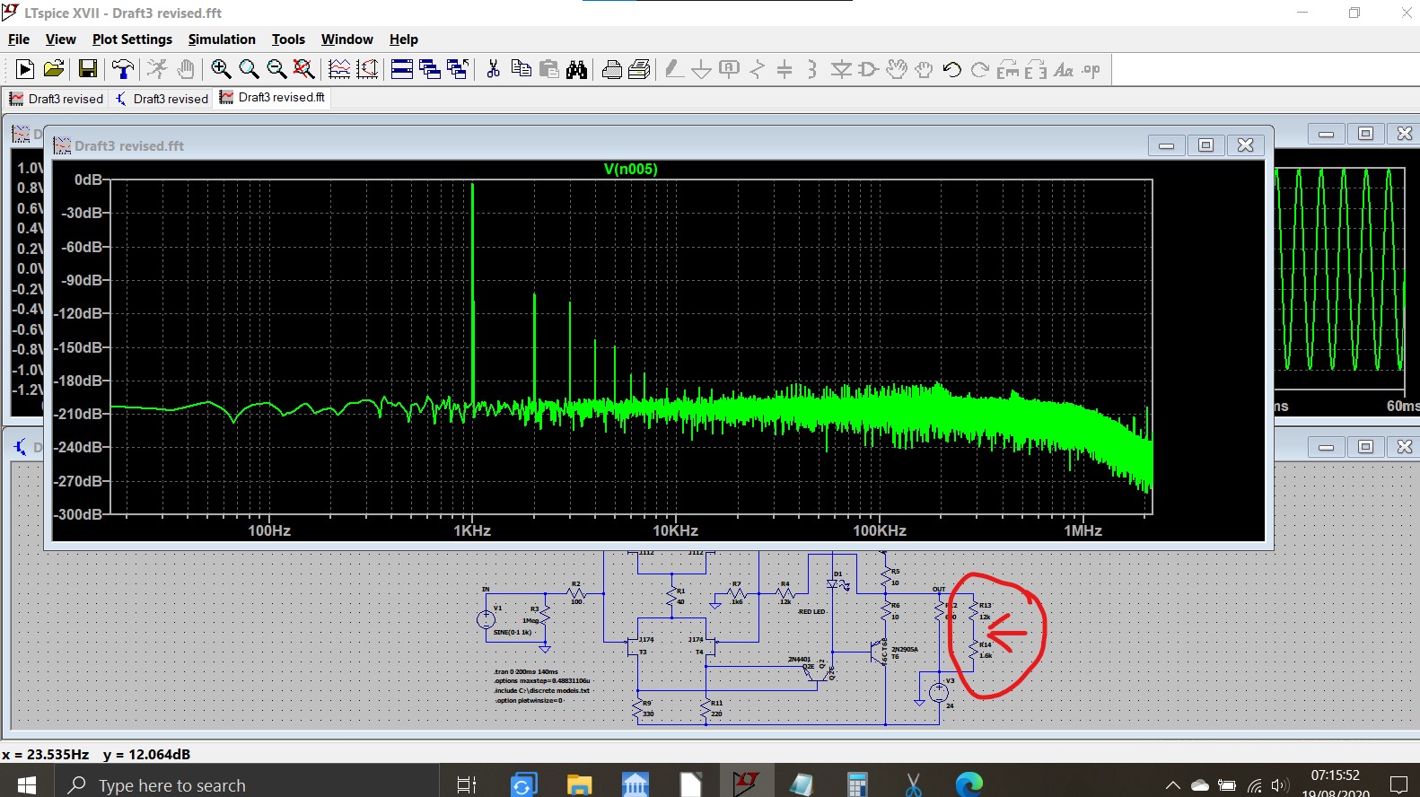

Changing the diode to a LED (Vf=3.6V), changing R5 and R6 to 47 ohms and back to the transistors i ordered, the output transistors run at 450mW dissipation (or 19.6mA)
only downside, theres a -16mV dc offset at the output, but since its ac coupled anyways...
changing the feedback resistors R4 and R7 changes its gain, it wont go above +-14V before it starts clipping

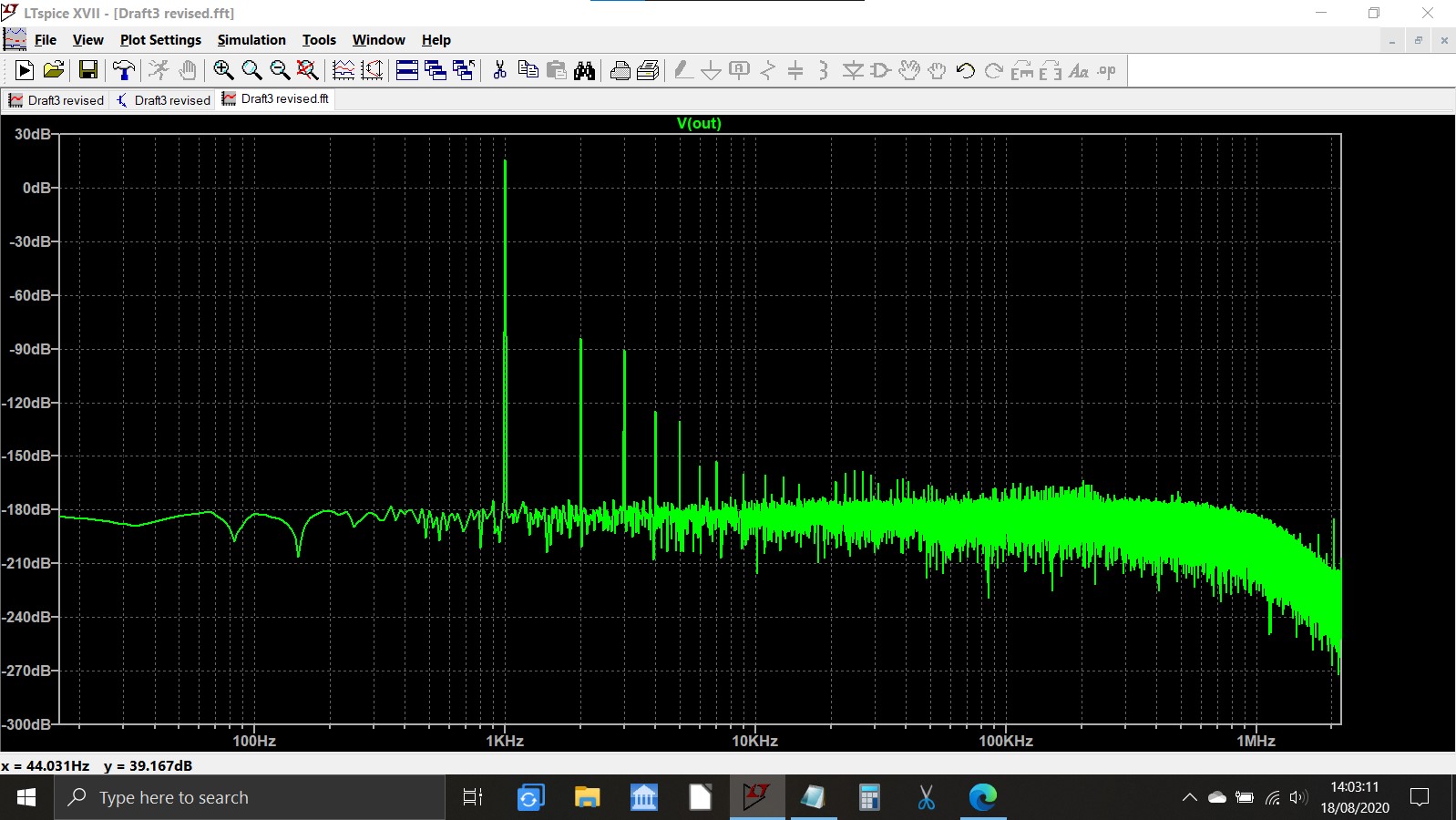

gain is a bit reduced from the file Mooly uploaded, but FFT looks alright

Mooly, the fundamental in your spectrum plot is roughly around +15dB, correct? Thereby pushing all spur level indications down by that amount.

It is yes. If you want to see the output fundamental at zero we can take the value of 1.414 volt peak as an output voltage and divide it by the voltage gain of the circuit (8.5) to get the required input level to do that (0.166 volt peak).
This shows the distortion in that condition but of course it is lower now because of the lighter load current.
Or...
We can attenuate the original output by the gain of the circuit.
Last image is back to the original and showing the FFT values of the harmonics referred to the input signal.
i might have messed up a bit,
few points i gotta improve on..
1. flip the pcb lol i had to put the components on top where the copper is since i first had smd parts in mind.
2. adjust circuit.. a rail got stuck at 24v.. and ive blown both output transistors, the led i used might not be suitable for setting the bias current. at 25mA it had a 3V drop across (white led)

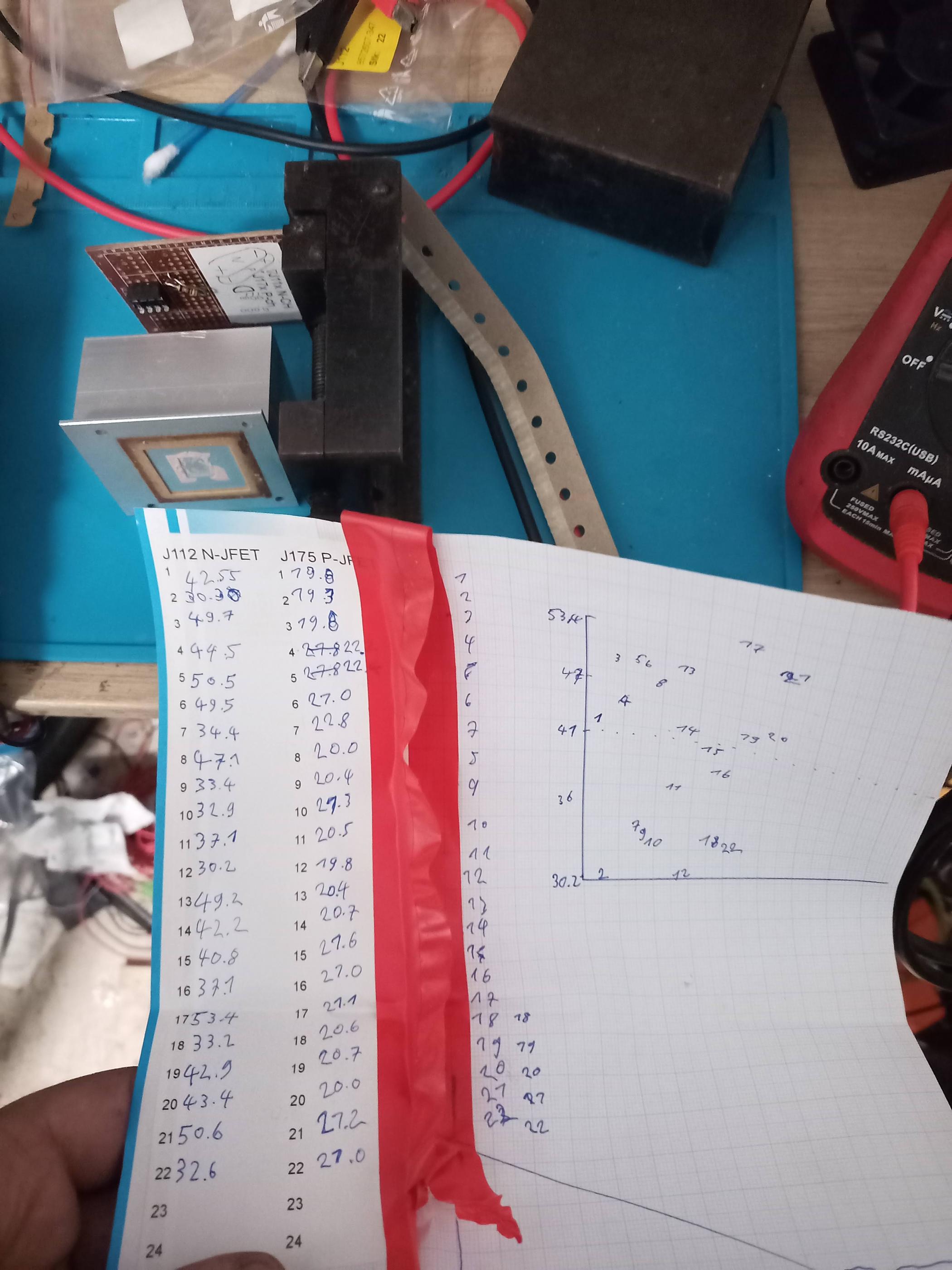

3. the jfets i had (ordered 5) looked quite good matched on the cheap component testers, but it turns out they are bad testers. it was "within 0.1mA"... in reality.. well i guess way out.
i now ordered 24 of each to find 4 matched pairs using the 10 ohm resistor method. described here JFET matching information – diyAudio Store
Can i adjust the offset to compentsate for not perfectly matched JFETs by altering R8 and R9 ?

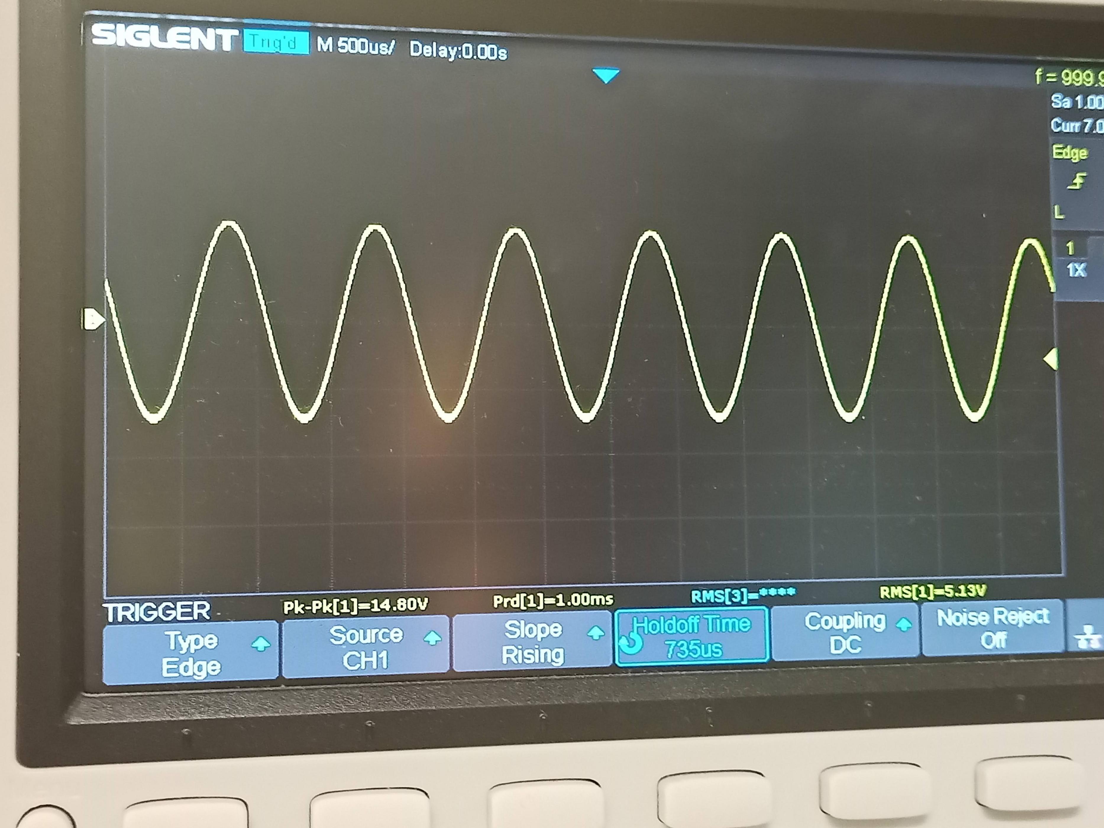

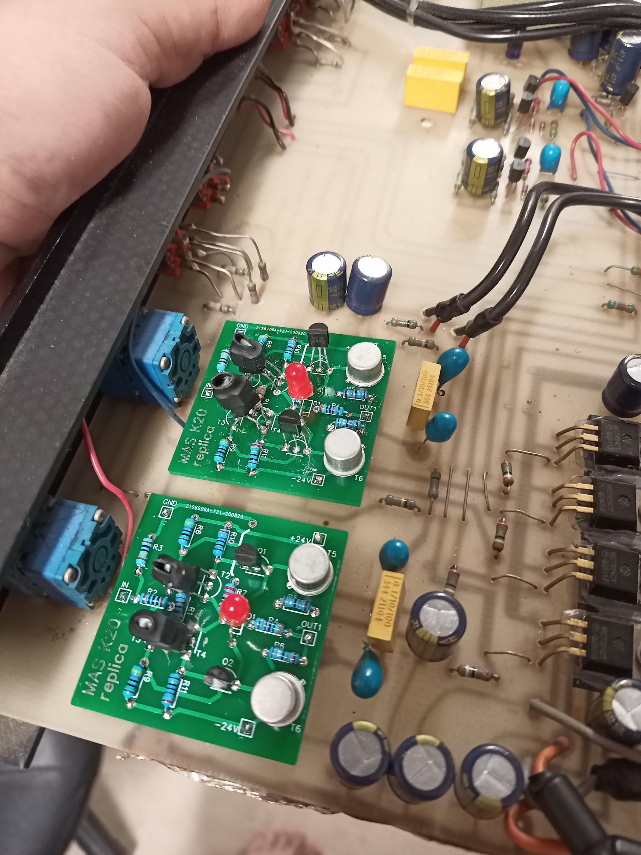

im back... hours and hours of troublshooting for a tiny mistake i made.
i tried my diy milled pcbs.. didnt work, i ordered profesionally made pcbs.. didnt work. maybe something isnt matched right..
i purchased many jfets of p and n channel and matched them with a current meter to be within 0.1mA or less. and got at least 5 matched pairs of each that were within 0.2mA worst case.
i put everything together, changed values, burned the one and other transistor in the process.. added trimpots to see if its not tuned properly..
it turned out, when creating the pcb in the easyeda editor, i changed the footprint to match the J175, but it only applied it to one of them, t3 instead of t4 too.
after flipping the legs.. it did work lol

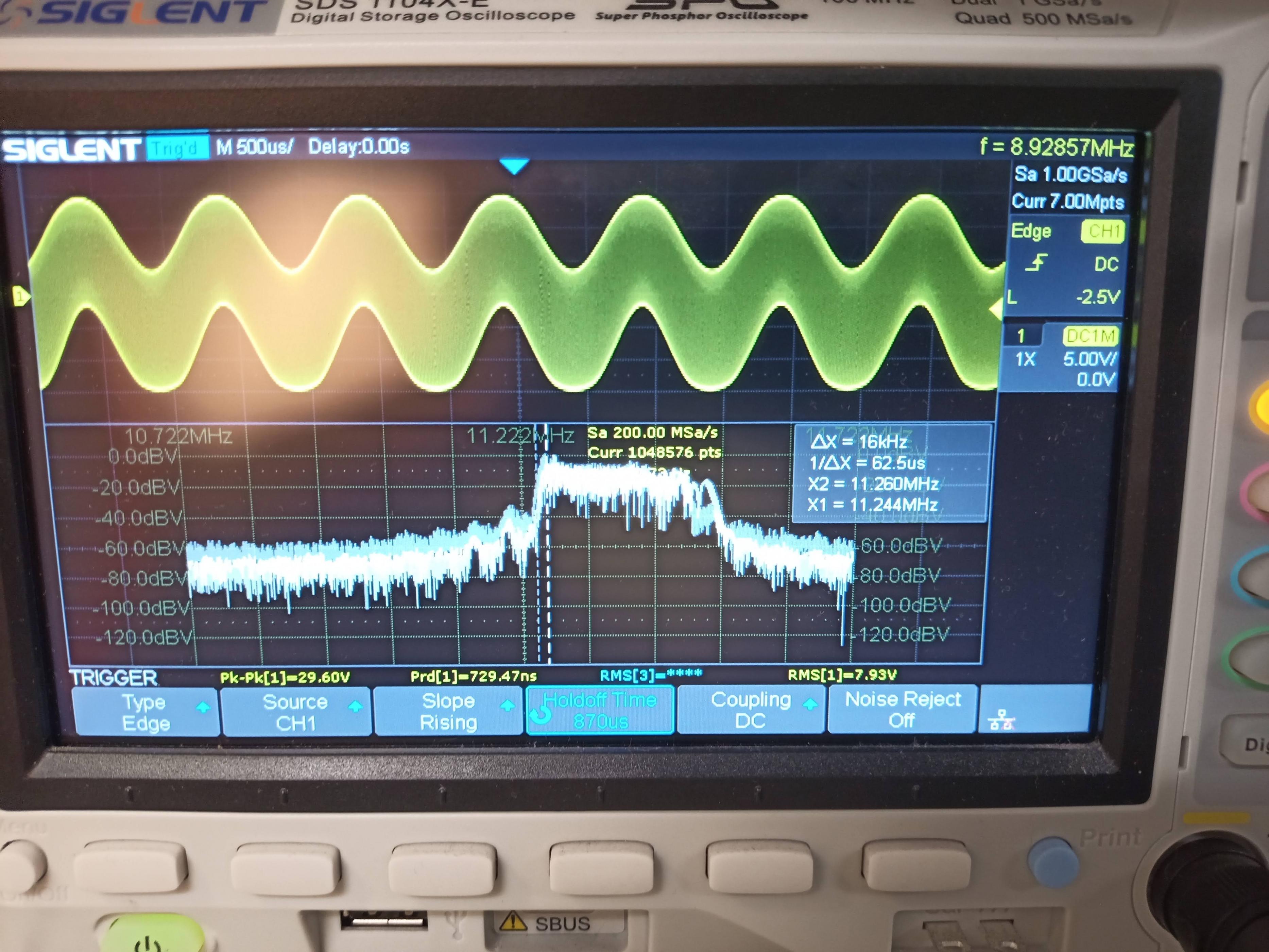

but for some reason i get a very high frequency content when using my signal generator ( i dont get this on the original module) either i got a massive bandwidth or its self oscillating.
it goes away when i put a ferite choke inbetween the signal gen and pcb.
outputlevel is about 0.2V lower than the original at the same input level. good enough, also it wont clip as quickly as in the simulation so more overhead.
the whole thing runs at about +40 and -40mA on each rail.
