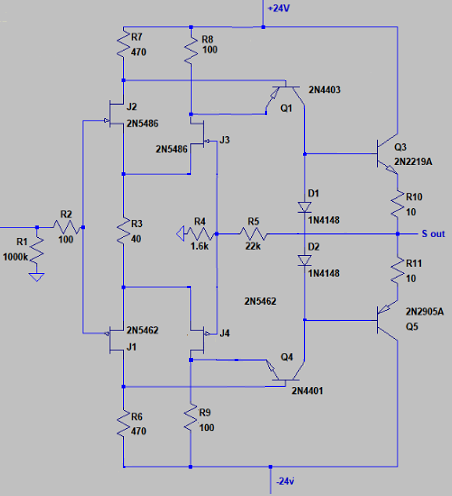

Please check the supply polarities also. They don't coincide with the semiconductors besides Q1, Q4 😉.

i updated the drawing, i desoldered them and checked in a transistor tester, turned out to be both jfets p and n channel.
also found all resistor values.
but one diode cracked, couldnt measure if its a zener or not.

i think i got it,
the circuit seems to produce a clean signal, (i had to change some components since ltspice didnt have them)
and Gain is about the same as with the working module.
and thanks for pointing out the wrong polarity.. i just checked with the working unit, it was indeed wrong.
yea, that will be it. im gonna make a pair of identical pcb's and this preamp should be as good as new. i wont pot them obviously, just thermally connect all transistors together.
simulation vs reality, about the same Vin to Vout ratio at 1khz. im happy.

Compare this circuit to the output module of Mark Levinson JC 2
(John Curl) and you see that Metaxas in fact had something to hide.
Hi gamerpaddy,
I might be nit picking as many jfets are symmetrical meaning that drain and source can be swapped. However, I don't know if that's the case for the jfets used in the module besides making the drawing somewhat clearer. Looking at the pictures you posted of the module it seems that the jfets aren't used with drain and source swapped.

And here ML JC2 for comparison (feedback resistor pair not shown) :

not quite identical, is it...

thanks Ketje, i redrawn my schematic before i saw your post, turned out to be almost identical
i also flipped T2 & T4 as mentioned by mkc simulation was still fine with it.
also removed the second diode which i dont even know what it exactly was (no markins on the original part, and it was cracked) but it doesnt seem to make any difference in the simulation.
i hope the parts i ordered are roughly matched, i dont wanna spent too much money on lots of jfets just to find 4 pairs that work.
