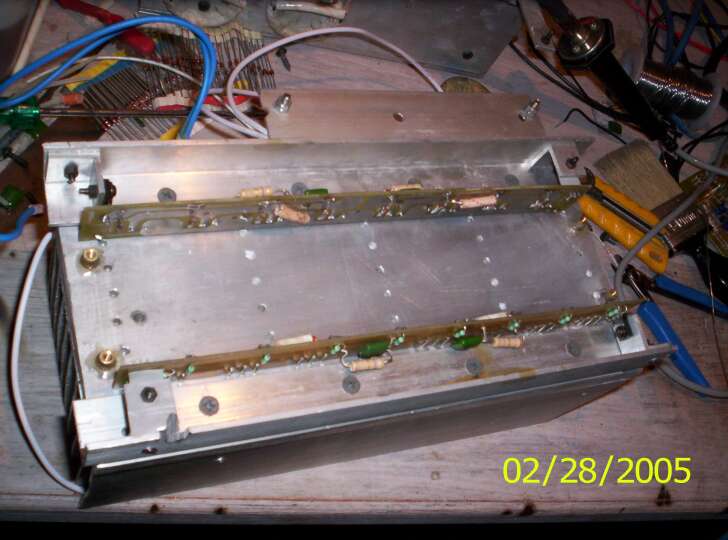

You must use more screws ( one between each pair transistors ) - on other case ones in middle will be fitted wrong.
Reply
hI UPUPA EPOPS,
the screws you see are not for mounting purposes they are for mounting driver trannies.
Instead we use 4 screw mounted to the base plate for proper tightening.
regards,
kanwar😀
Upupa Epops said:You must use more screws ( one between each pair transistors ) - on other case ones in middle will be fitted wrong.
hI UPUPA EPOPS,
regards,
kanwar😀
