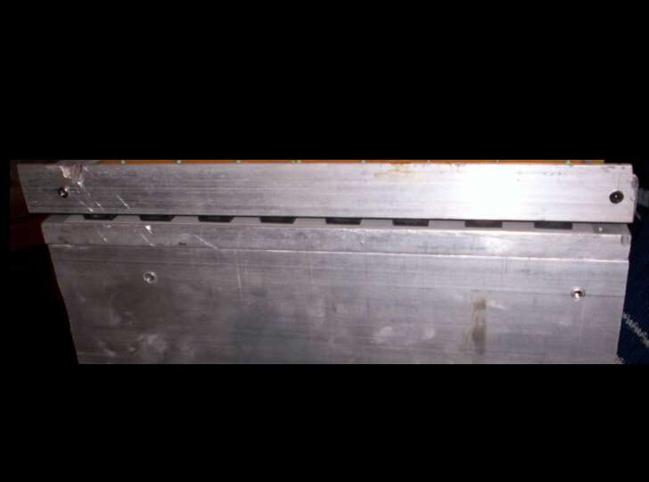

Not at all, U-papa Epops.
How are TO220-TO247 etc. case sinks nowadays ?
A single sink with a machine pressed surface for die mounting or a case sink with a die mounting plate attached to it ?

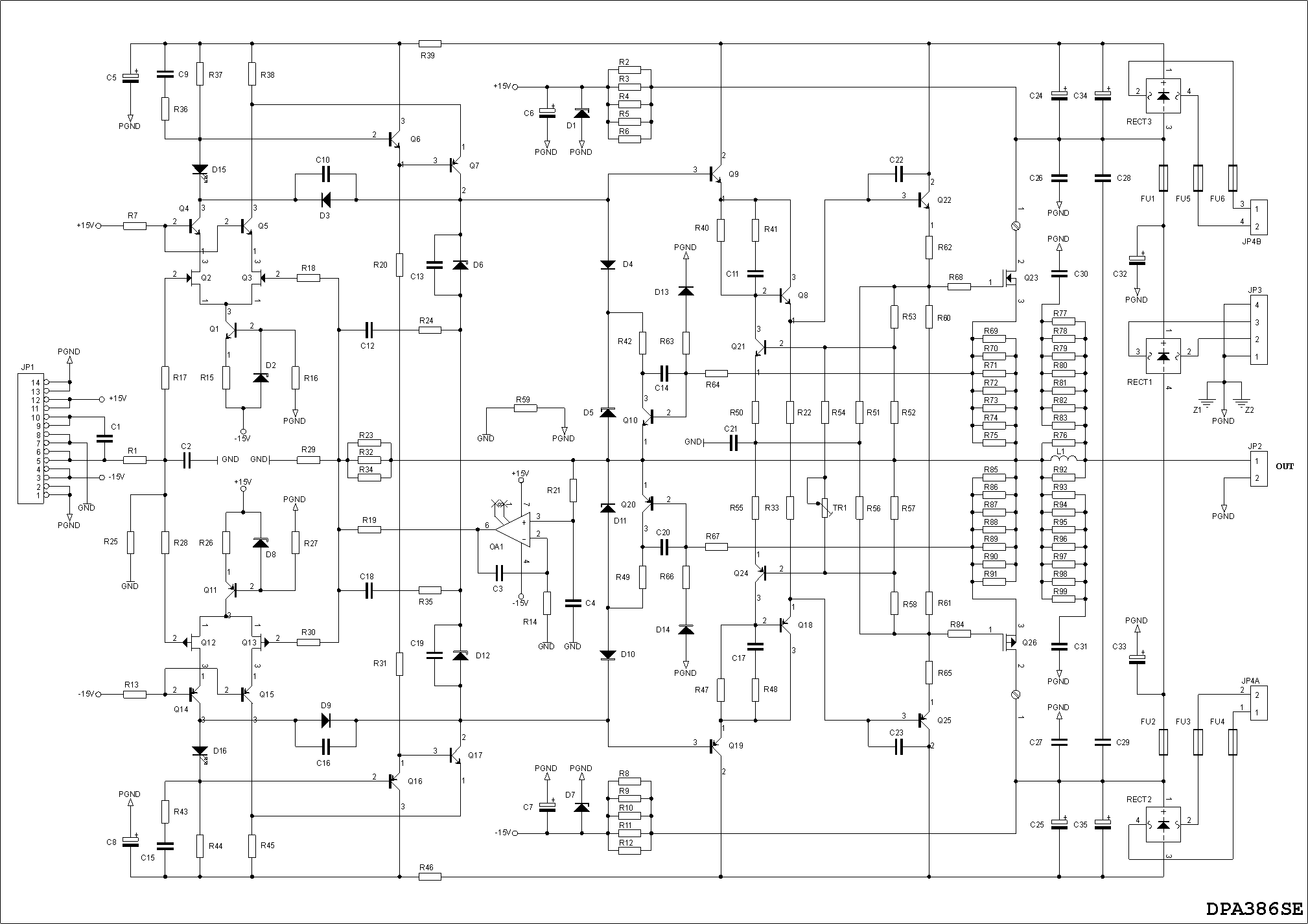

Upupa Epops,
I figured as much already from the 1-2, and symbol, in the schematic for Q23,Q26.
The reasoning for using the sink directly as collector?
Reasoning ? " Superwire " as rail line ( prism 10*20 mm, copper ). Precise thermal loop ( thermal sensing transistors Q 21, 24 are on bottom side, bolted from side to prism ). Easy mounting - block is fully functional without heatsink, which caused also very friendly repairing ( what is offten forgoten by DIYers ).

Upupa Epops, do you mind if i ask which kind of Mosfets are used in your design for Q23,Q26 ?
