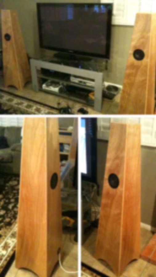

Dave, I'm attracted to the shape of the Met and it's fairly straightforward to cast. Do you think a midsize Met, 3.5' to 5', would be a good design to demonstrate the idea? Are the TL models and drivers proved out enough or do we start a new design? I can make the detailed solid models from the basic geometry.
frugal-phile™
Joined 2001

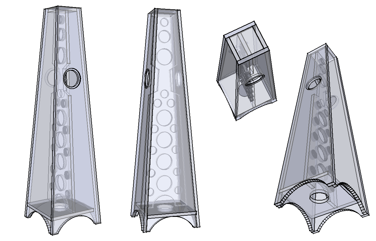

There are some pretty solid mets in existance. If we ever get down tobuilding a set, they will likely be bipola EL70eN (with the 2nd driver side firing).
http://p10hifi.net/tlinespeakers/FH/download/bipole-EL70-Met-0v9-090210.pdf
Bad cel phone pics of 1 of 3 sets made by one fellow.
attachment.php
attachment.php
They are of the smaller variety so will likely pose less difficulties as a test case (there is also a single driver one, plans mostly done)
dave

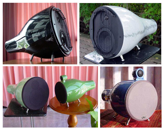

I know of two speaker companies holding the patents to this design. Therefore, you may want to consider licensing the technology for commercial work. Attached: some implementations using marble, ceramic and synthetic marble. Do write to me if you want to know more.

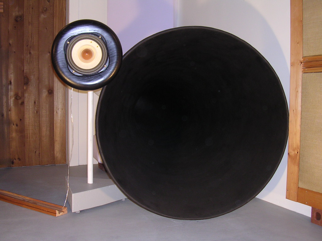

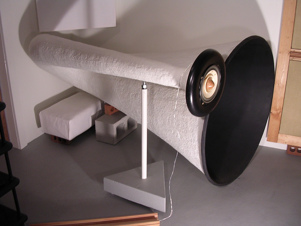

Another choice is composite material. I designed my own “heavy brew” doable at home.
Each of my BLH contains 100 lb of metal powder. The powder (55%W, 40%Cu, 5%Pb) forms micro boundaries in polyester/fiberglass base. Micro boundaries of various densities absorb sound waves traveling in the composite, so there is no ringing, sound energy storage is low. The composite is stronger and stiffer than wood, it can be formed to any shape and size, so you can eliminate interior resonances haunting boxes with parallel walls. Curving flat walls also tremendously stiffens the enclosure and limits mechanical resonances. The high density non ringing material absorbs sound waves lingering in driver basket. The high density material reflects (does not absorb) sound waves traveling in air contained by horn …
The science is all there – material and enclosure is in public domain…
Warning, Lowther drivers sound good, but materials and workmanship are shoddy; mine warped and fell apart after seven years. Avoid them!!!
Marek
On one hand you say metal is not suitable, but then you use it for yours? It is in the execution.
dave
planet10,
Yes, my statement is too general; I was referring to cast iron, aluminum, alloys etc, I thought that all of them ring more than wood.
Knocked on fiberglass canoe sounds terrible to me, so I made my horns different way. I used heavy metal powder in the composite to change its acoustical properties; the composite containing metal powder does not behave like solid metal. I got the powder for $200, using it was less expensive than executing thicker horn walls.
The point is that with composite materials one can execute any shape and size, acoustical properties of a composite can be altered to your liking.
