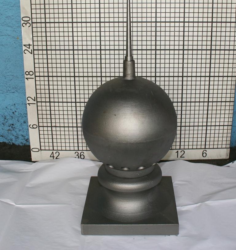

Example of cast hollow shape. One off ventilator ball for roof pinnacle of light house.

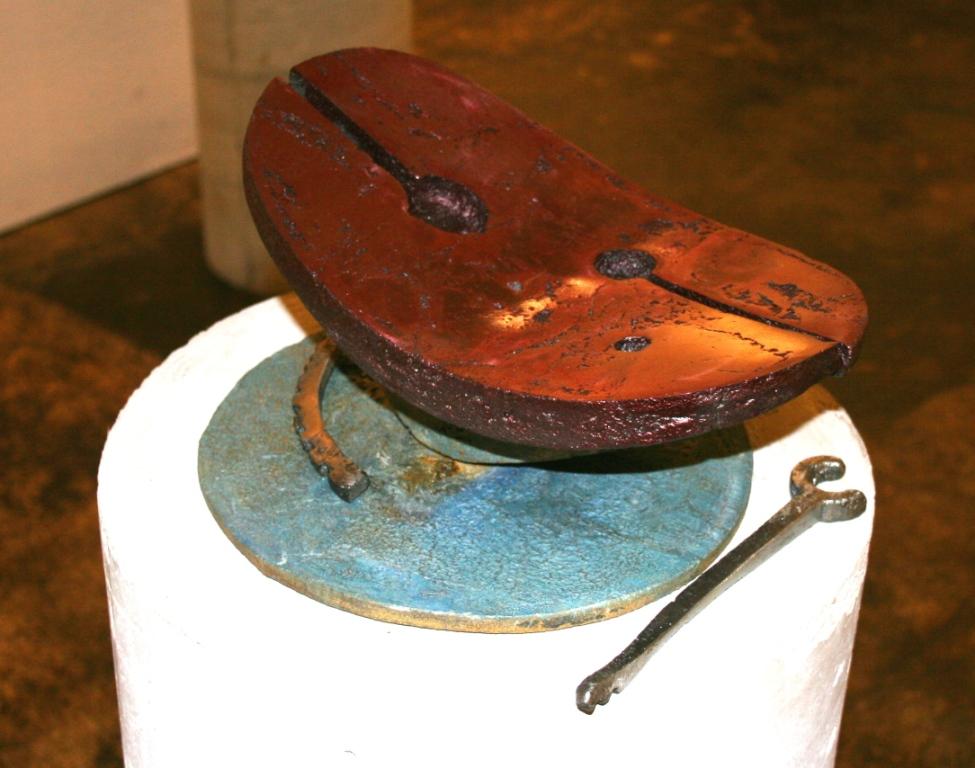

I guess it's really time for me to put up, or shut up. With all the work Dave and the other folks have done designing enclosures and matching drivers using the latest quarter wave, horn, and driver loading models, I guess I have all the potential enclosure designs I might need. I'm still liking the Metronome design, but now I can't find the plans.
It would be interesting to see some more organic shapes modeled that could be cast, but maybe I'll need to do that myself as until I do something, why should someone bother. Or I'll see if the for hire designers might help me with the modeling.

Go for it, I'd be amazed if someone didn't want to help with the design, they could be in on something historic, the pictured sculpture is very cool. has anyone ever built a cast iron speaker?
