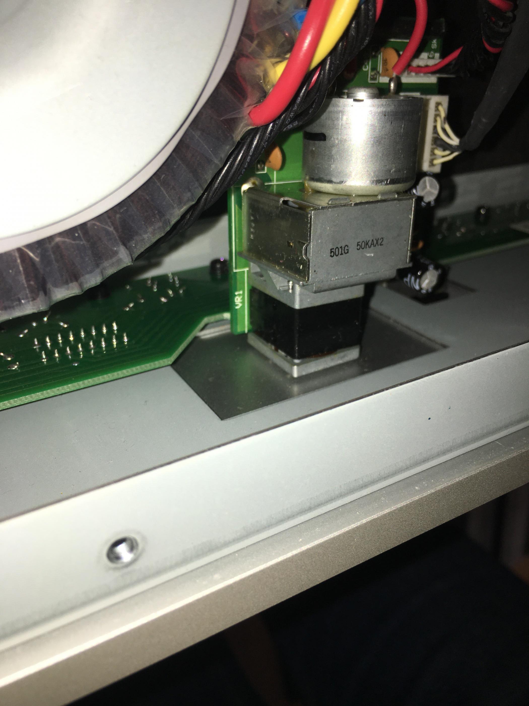

Hmm... so pot can't really influence the bass but what you describe as hearing is a really common observation and quite possibly related to the fact that you fixed it yourself.
Never under estimate such observed effects, it does happen a lot.
From a technical perspective the pot is just a resistive element and does not alter the overall frequency response in any way.
Chasing something like the microscopic whine you can hear could be fraught with difficulty, not least because you are now hyper aware of everything and it is quite possible it has always been like this and is just a 'characteristic' of the design. A motorised pot means there is some digital processing going on for the remote receiver and its microprocessor and so it is possible that is being picked up.
An experienced tech might find what the whine is and where and how it originates but it may be inherent to the design and so not fixable in the sense that something is faulty that wasn't before.

Possible reason for the slight change of sound is that elegantly or not, it is now correctly wired. As mentioned, the other guy had wired one leg of a capacitor onto the body of the POT possibly to get around the broken ground issue.
When last I heard the original POT, the power leads were Nordost as was the IC. I since changed the power to Oyaide and a pure silver IC.
In any event, I am thrilled.

I think a new PCB isn't viable tbh.
Although it could be copied and done using free PCB software such as KiCad which would produce what are known as Gerber files that could be sent to a PCB production house it would be an undertaking that only a very keen diy'er would do.
What I can tell you is that the PCB as shown in your pictures could be brought up as new in five minutes.
A cotton bud dipped in meths or isopropyl alcohol would remove all that burnt flux in seconds leaving it 90% perfect. The finishing touch would be to brush on some 'clear conformal coating' which is the posh name for clear lacquer used for PCB production and rework.
The little brown cap I can see in your pictures looks like it connects the body of the pot to ground (via that cap) and that is to provide shielding from stray pickup... so woth looking at... it should be there. It also will help supress noise from the motor on the pot from being picked up by the pot internals.
That said the flux is causing no issues but is just unsightly.

So Mooly- you were bang on. I earthed the pot body to the small cap and bang, whine gone.
