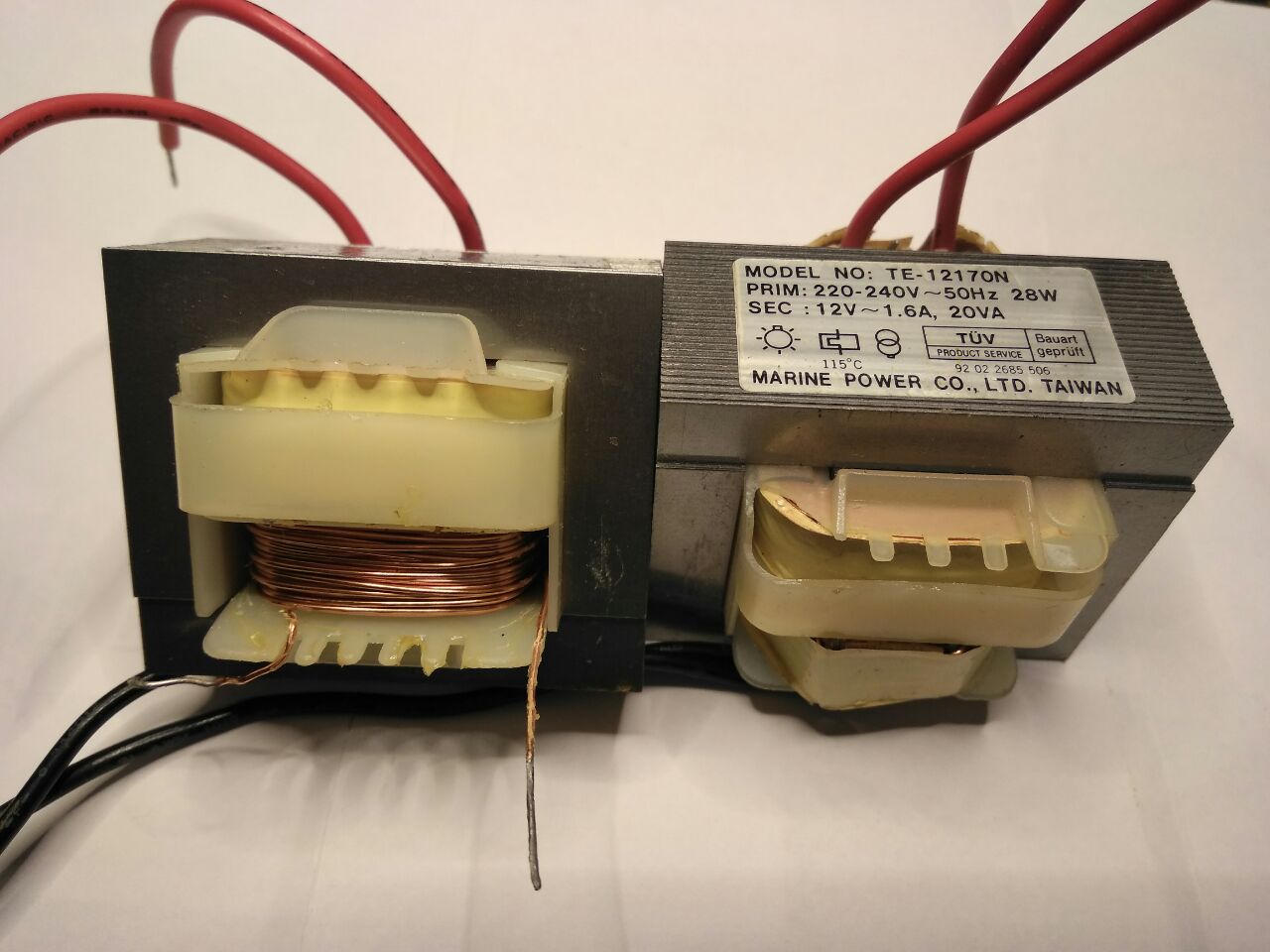

free heating transformer: you can find heaps of 12V halogen lamps at the recycling center,
as they are usually replaced by energy-saving led technology.
the transformers installed in it can be used very well as heating transformers by unwinding the secondary side.
but be careful, connect a load from time to time, otherwise you can easily unwind too much! 😎

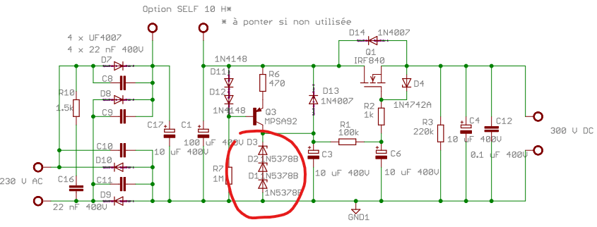

Some parts arrived from Mouser last week, and I started to look at populating a couple of boards. I ordered some silly 47uF/400V caps that are 1cm wide and 4cm tall since I had not looked at all the details closely enough. and the raster of the 220uF/16V caps I have is 5mm, but is 3.5mm on the board, so they are not flush.

So far the only issue I have come across is the holes on the PCB are too small for the 5W zeners, used to clamp the 330V on the PSU. Maybe it was the zeners I bought, but they will need an improvised solution to be used. I am thinking the wattage my be greater than needed, but I am yet to check that.

I am not aware that such diodes are installed in the RIAA power supply!"for the 5W zeners"
Correct, I overlooked😱
5W z-diodes have legs with a diameter of 0.94-1.09mm, so a 1mm hole could be tight !
I also think 5W is oversized, I know of several other identical high-voltage power supply circuits
and they all have max. 2W Zener diodes of type ZY installed in this place.
It will probably be difficult to design PCBs that fit all the NOS components that people still have in their inventory. If you tell me special requests before production begins, I will be happy to take them into account 😉I have a lot of very nice NOS 7 pin sockets, but the leads are just too wide to fit in the holes on the board.
The ones I ordered have 1.2mm legs, but I have other 200v 5W zeners with narrower legs. I think I will solve it with a little daughter board. I wanted to simulate the circuit to get a value for the dissipation. It does seem to be a bit overspecced.

Too complex, since the conductor tracks for the Zener diodes only run on the back of the board, no through-plating is required there, so simply drill out with 1.3mm.The ones I ordered have 1.2mm legs, but I have other 200v 5W zeners with narrower legs. I think I will solve it with a little daughter board.

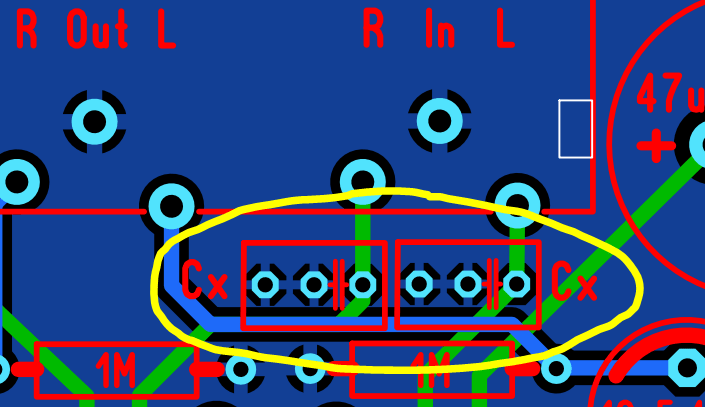

There is provision for two small capacitors in parallel with the RIAA input and the 47K load impedance. I tried to get an idea of what to shoot for for those, and I think 200pF came up a few times.
It is meant to be optimised for the cartridge and I suppose that will be for an Ortofon OM cartridge, although I am looking for a general option for other turntables. I looked up the cartridge data on the Ortofon site, and 200-500pF is recommended.
Wondering if there is an optimum choice for this capacitor?
Yes, you are right! Good to have a place to find the voice of reason!Too complex, since the conductor tracks for the Zener diodes only run on the back of the board, no through-plating is required there, so simply drill out with 1.3mm.

For input capacitor loading a cart basically you should know the following :
Capacitance of the cables / tonearm + IC + rca plug
Capacitance of the input stage + strays from socket, rca connectors and cable from rca to pcb input
Cart manufacturer recommendation
P.S. My choice for this are Wima FKP2 capacitors
