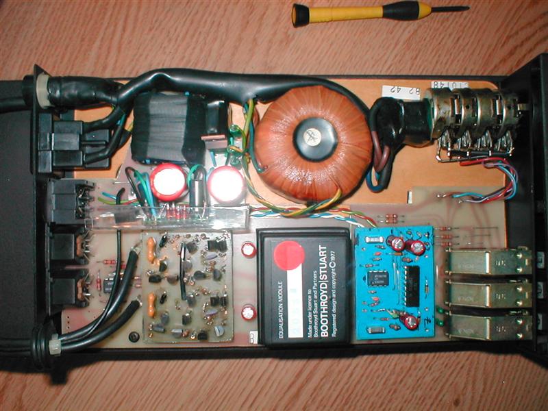

Following the general ideas from this thread I decided to upgrade the Meridian instead of replacing the power amp.
I already recaped the 103 psu, made a dedicated direct Mains cord and started to mod the 101b pre.
In this case I replaced the regulators and rectifier by a 317/337 / hexfred setup and recaped the psu.
In the output module, I have replaced the stock opamp by a LM4562.
Now I would like to replace this opamp by a buffer stage. (Pedja...)
As I am a bit confused about the idea (a buffer should be used to couple between different impedances)
My big question is:
Do I need a gain of x 6.5 on this buffer ?
Regards
Ricardo

Hi Andrew
So you mean I can replace the LM4562 by a pedja buffer (o gain) once I figure the pin layout ?
Well I know this opamp is arranged to have x6.5 gain.AndrewT said:
Then arrange for either a 0dB buffer or +xdB discrete gain stage to fit the opamp pins.
I could replace it by a better opamp (like the new metal can available) but I know that a discrete design is much better, particularly if it is built with jfets and no feedback.
So I decided to build a pedja but I am afraid this kind of buffer is a pure voltage follower (0 gain).
Can the pedja be modified to have some gain ?
Regards
Ricardo
Hi Ricardo. Are you sure you need any gain in the pre?
I built a Pedja buffer and I still have more than enough for loud volumes.
Cheers, Lee.

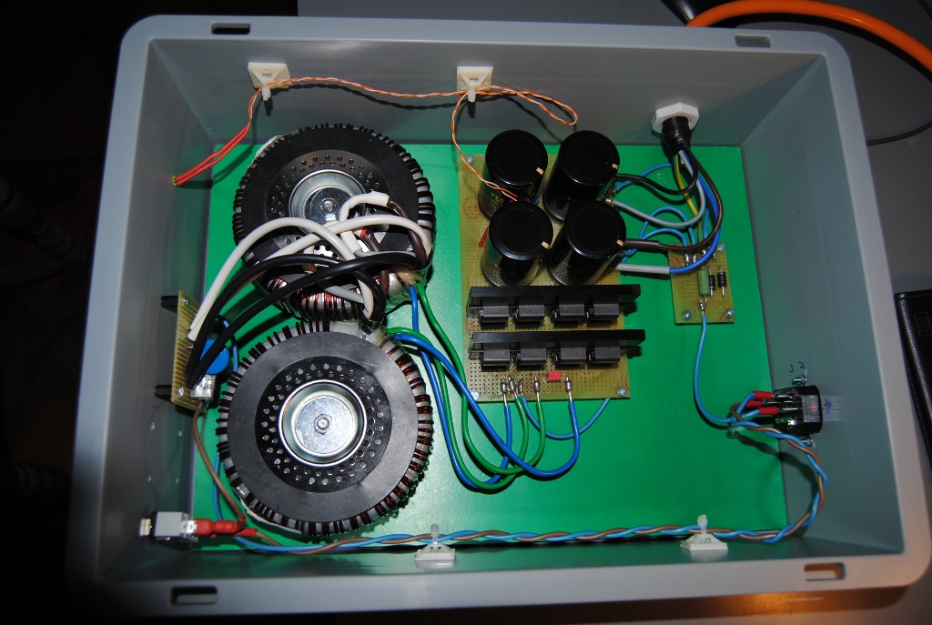

Now I would like to know how to determine the Meridian 103 power amp gain based on it´s specs:
Output: 35W/ch in 8ohm
input: odBm (775mV) over 10k for 35W (Does it mean the input impedance is 10k?)
Now I want to replace the Meridian 103 PSU but I do not know what are the specifications of the toroid... anyone ?
After a long search for suitable transformers I found the FEAS 26V 250VA.
Due to sme T$me constraints I could only buy two and as these have single 26v secondaries, I could not implement a true double mono setup, so I used them in series to feed dual rectifiers as in the schematic.
So far so good.... sound is much more open and detailed with the new setup.... but I am having trouble at power on. My house has an old electrical instalation that can not withstand too much inrush current.
Every time I power the new psu and have other appliances running, the mainsboard fuses trigger.
How can I limit inrush current during power on ?
