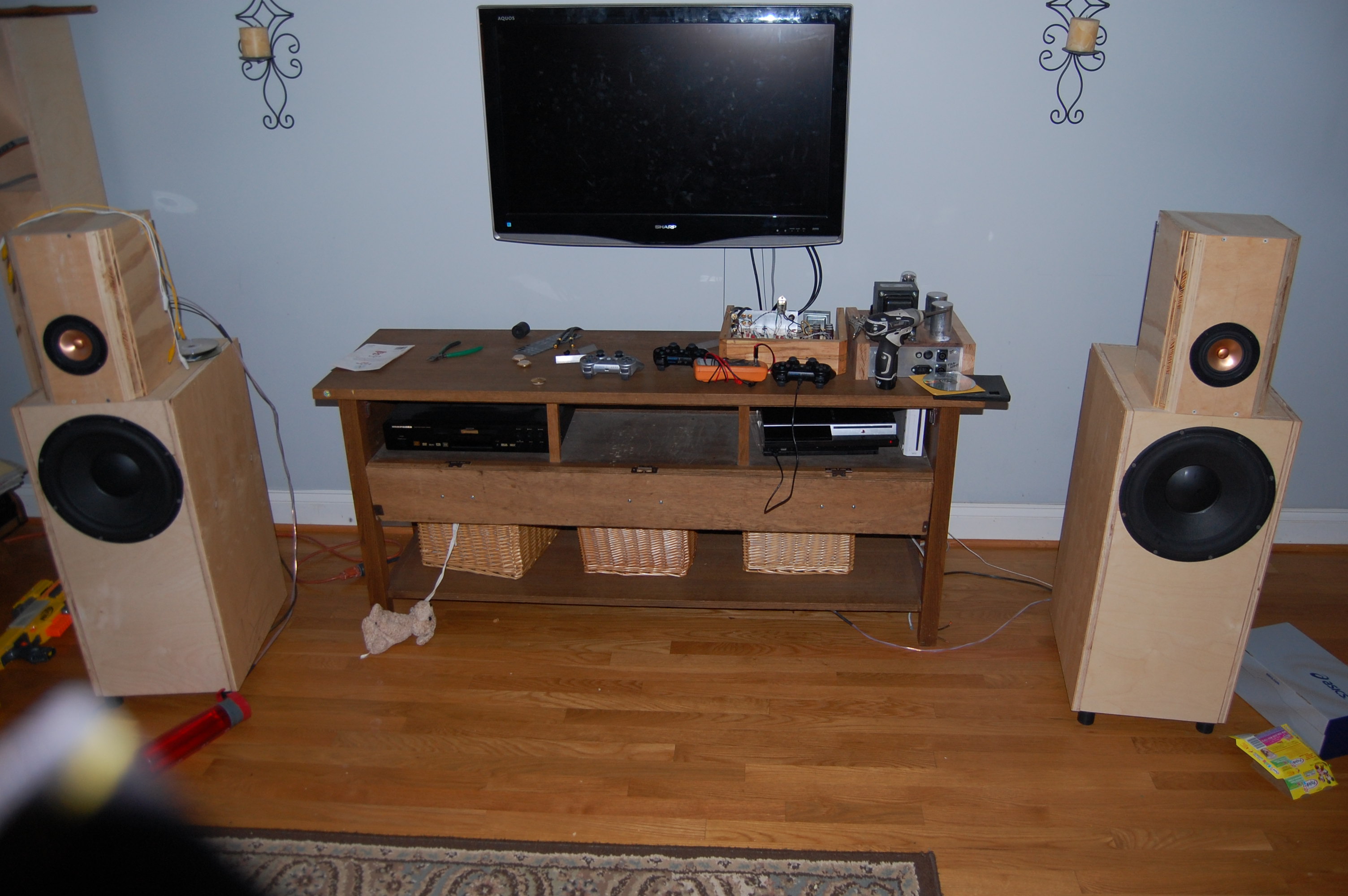

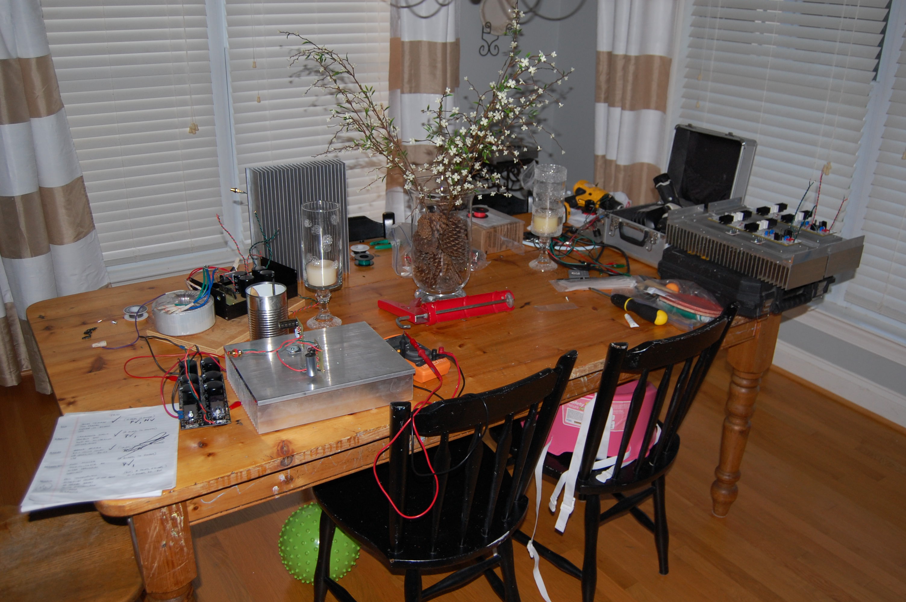

Melon is not the only one busy. First pic is two amps that will be done by the end of the day. Second pic is current woofers in box. I have talked to Calvin about a OB ripole, dipole options. HE said my XXLS would go too low in a Ripole, as they add about 10hZ to bottom end. May just throw these in a Sealed PP unless you have other suggestions. Of course i am gong to try them OB with my smaller FR drivers, as they have they efficiency to do pretty well. They are Peerless 830845. Also have some Seas CA22rnx. They have the same linear Xmax as the Peerless. I have wondered how they would sound?

You have been busy - and I can see from the pics that you are a true DIY guy! let us know how the amp works out.Melon is not the only one busy. First pic is two amps that will be done by the end of the day.

I have not lined it yet. I want to measure the effect of each change.

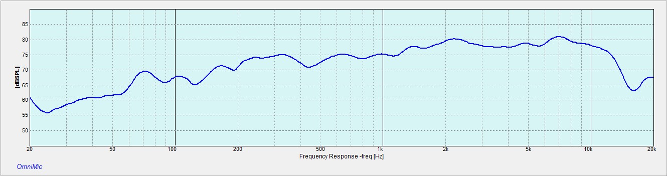

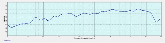

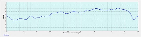

Here it is full of acoustic foam (Sealed 5.6 Cabinet).
The response is a little smoother in some areas. Mainly 100Hz to 200Hz
